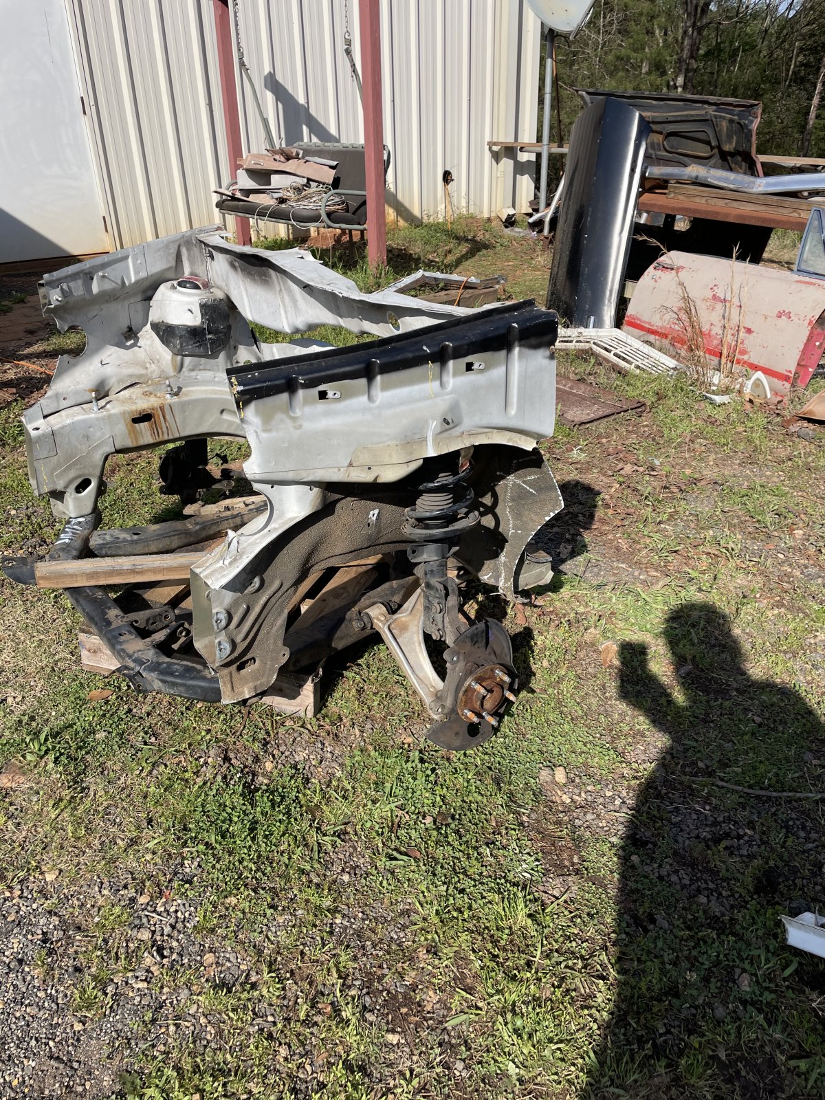

On second viewing I guess that does look a little scary:eek:, but there is still some whittling of this part yet to be done. The big panel and piece of floor between the strut towers is only still there for dimensional support and much single thickness steel is yet to be carved off, due to the late hour we finished our primary cuts. CAUTION: FLUFF ALERT(Last night I re-attached the subframe and lo and behold one of the caged nuts has gone missing! We did flip this bit over and maybe it just wasn't trapped enough? Time for the metal detector?{or another trip to the junkyard} or maybe just a thick "wing" welded on a regular nut. I'll tack a washer on the bottom of the nut, for max surface area clamping support.)

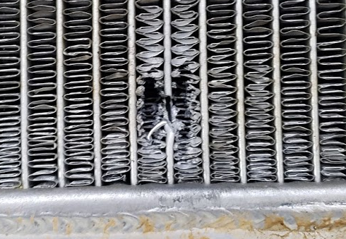

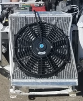

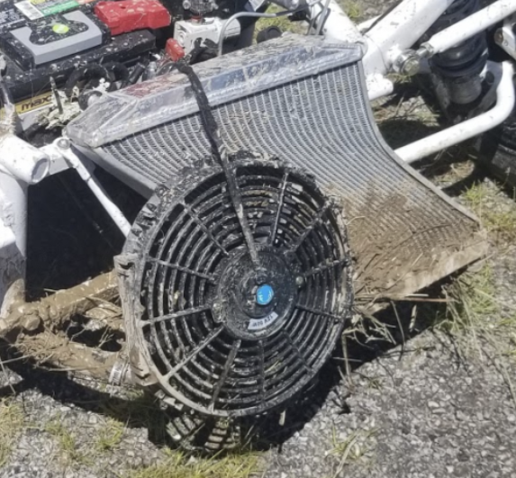

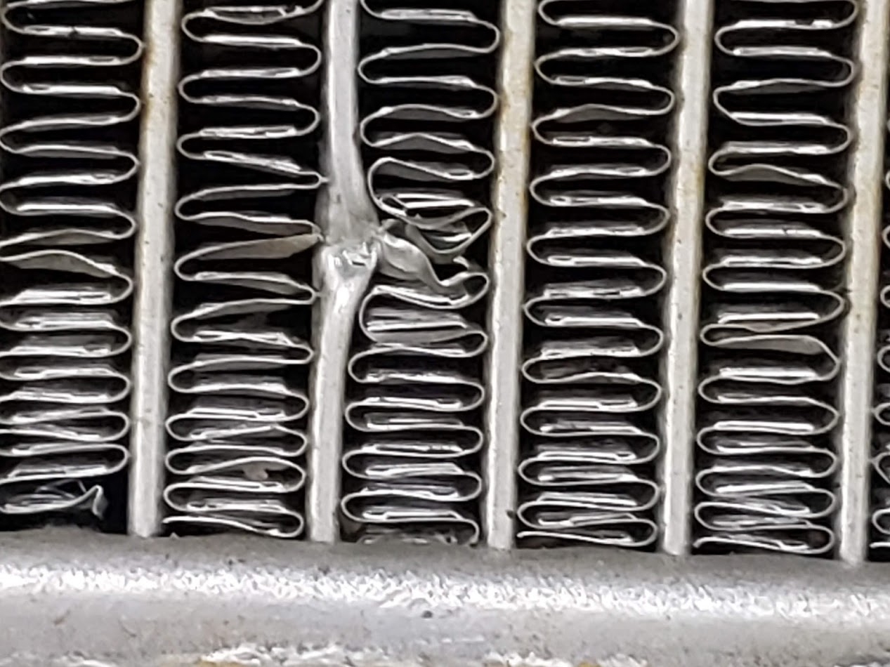

If done carefully, radiators can be straightened... with about 50% success rate... depending on the damage.
This radiator got straighted in my press, and after that last pic was taken, I pushed on it more with a 2x4 and a hammer, so the sides were straight. Drove with it for about a year, no issues.

This radiator is an example of rock damage, that I was unsuccessful at repairing. Probably could have epoxy repaired it, but I didn't want to test it, so I bought a new radiator.

I have straightened out quiet a few dirt motorcycle radiators back in my motorcycle racing years. At $400+ for a new motorcycle radiator, I was more motivated to try to repair them. The goblin radiator is cheap enough that I don't worry about buying a new one.

There much to be said regarding the dynamic of cost vs effort! I'm not one of those constant "gloomy gus' " types but it seems radiator straightening and I just don't get along any more. Back in the good old days of brass/copper rads I got out the solder/propane torch and saved many. Fortunately, since this is Cobalt parts, they are cheap and readily available! I bought a used one that appeared to be almost brand new, with fan for $75. I'll be driving a Cobalt with a geographically relocated power train, where as Goblin owners are driving a Cobalt power train that has relocated to another planet!

Ross, I recall seeing the after photos from you minor off roaring excursion. I figured it was a here goes nothing moment and was pleased to hear it actually stayed in one piece! Any victory, no matter how small, goes in the win column! I’m just being a tad pessimistic, so later I can be surprised by any level of success! We are actually wasting our breath nattering over a $75 radiator, $85 shipped to the shop by noon tomorrow! These are real first world problems, Mon Ami! Still if it wasn’t this, it would be something equally earth shattering! NOT! (CAUTION: Long story ahead.) 2017 I watched my family’s 5,000 sq ft house virtually burn to the ground taking 3 vintage cars, two trucks and a class A motor home with it. BUT when it was under control and the Fire Dept was packing up the three Captains met with me. I asked, was anyone hurt?!! They said nope! I said Great! This is an excellent day! People safely doing dangerous jobs and my neighbors houses have only superficial damage! One, a woman, piped up with, but your cars, your stuff, this place is a wreck! I told them we all got out safely, we stared in the face of destruction. Disaster may look like this but only the survivors get to rebuild anything! (Several firefighters cried over the Nova’s and the trucks and RV. I told them to laugh, no people in them!) I hope no one I know ever has to wade through a mess like that! Me? Worried about a bent radiator on a $500 car that runs AND drives, Naah! As I mentioned before, I could scrap this entire project and still lose only half of my investment!
