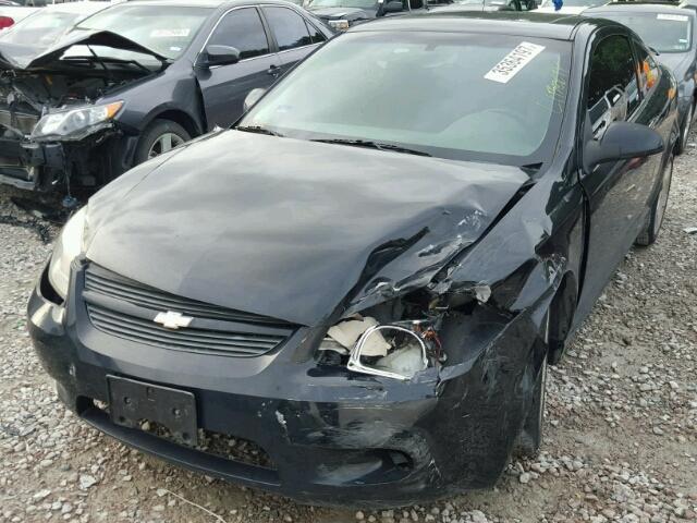

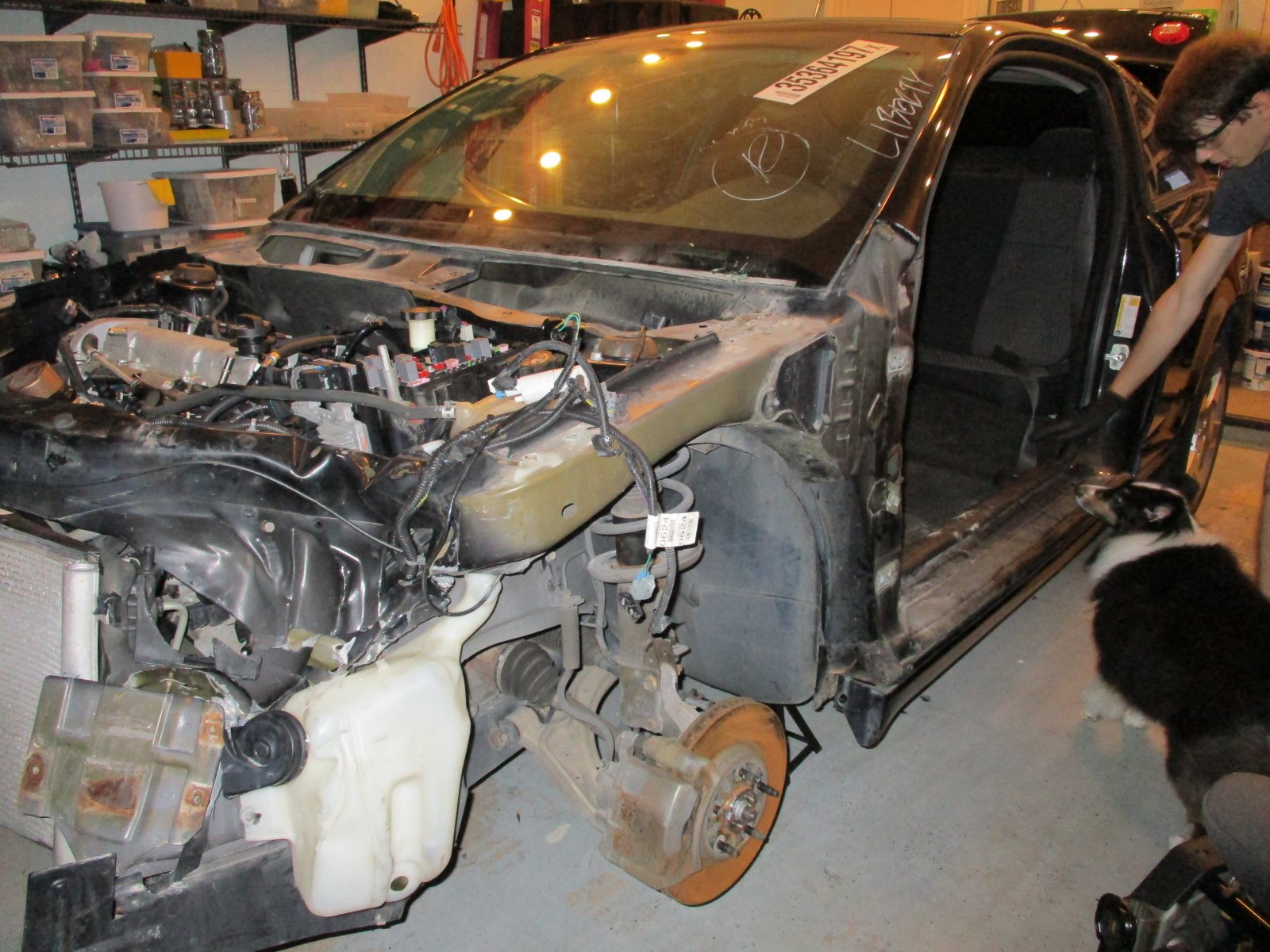

After several weeks of searching craigs list and copart, we settled on a donor with nose damage, and a sport model with slightly higher HP rating and near enough for us to go pick up. With 85k miles and a sport edition we were ready to start!
After getting it home and a new battery, we started on the initial testing of the vehicle. We could confirm the turning signal arm operation, but not running the engine and as it turns out, the gas gauge accuracy. We could not get the car to start with the key - every time we turned it to the start position, the electricity died and no engine turn over. With help from Lonny and Adam, we managed to determine that the starter does work and does turn over the engine - just could not get it running. The working theory is that some critical wires were cut in the accident and we should pull away damaged portions to get a better look inside. So off to the garage and tear down!
9/24/17 Build Video 1 Complete

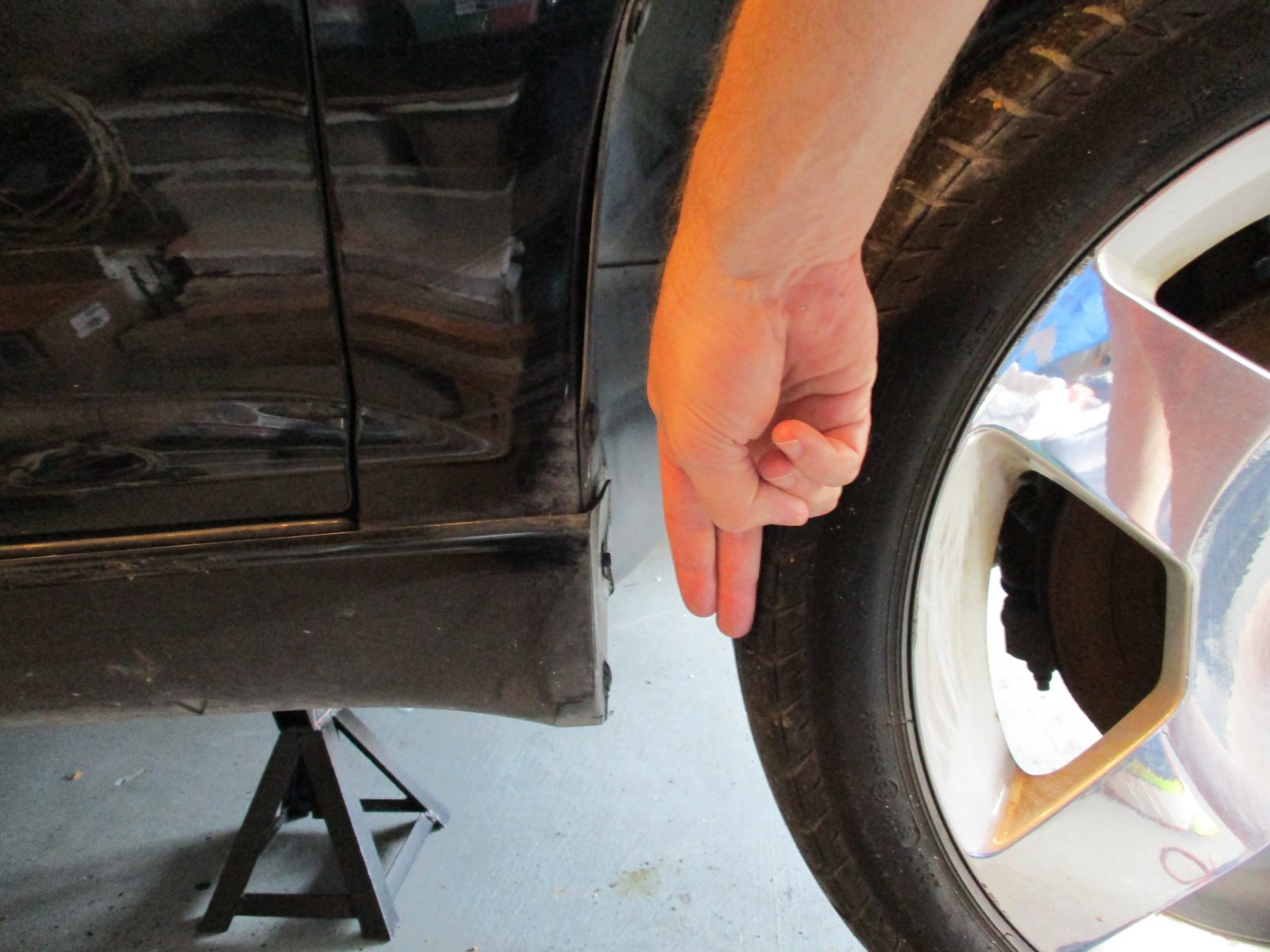

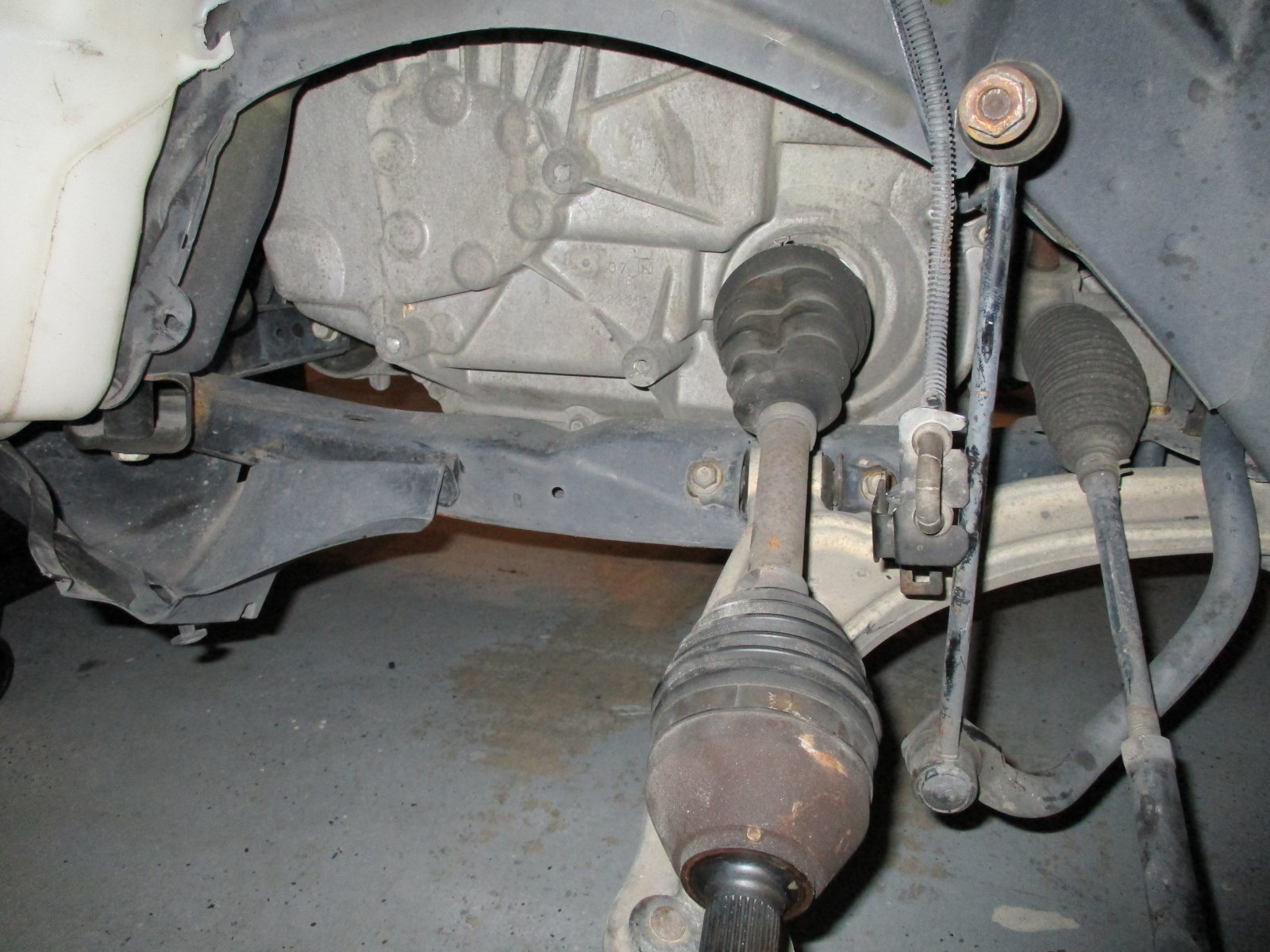

Another clue to the potential broken/cut wires is that with the key on, the gas gauge showed empty. When we drained the fuel tank by jumpering the fuel pump relay, we ended up taking out ~7gal of fuel. With a fuel tank at 13gal capacity, the gauge should have read over 1/2 full. Ah well - more investigation required there.
Also, it appears that there is more undercarriage damage than originally thought. From the below photos, you can see that the right front wheel has plenty of room behind it to the wheel well. Whereas the left front wheel has less than 1". Also, it looks like the engine is not square with the car - it is angled with the firewall and the right side engine mount definitely shows an angle. Something or more things is/are bent - we are hoping that the sub-frame is OK but we will get there to see.
9/24/17 Build Video 2 Complete

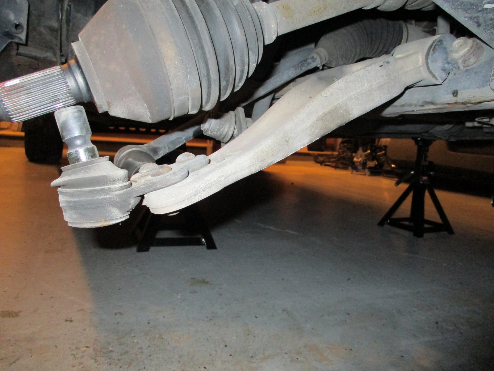

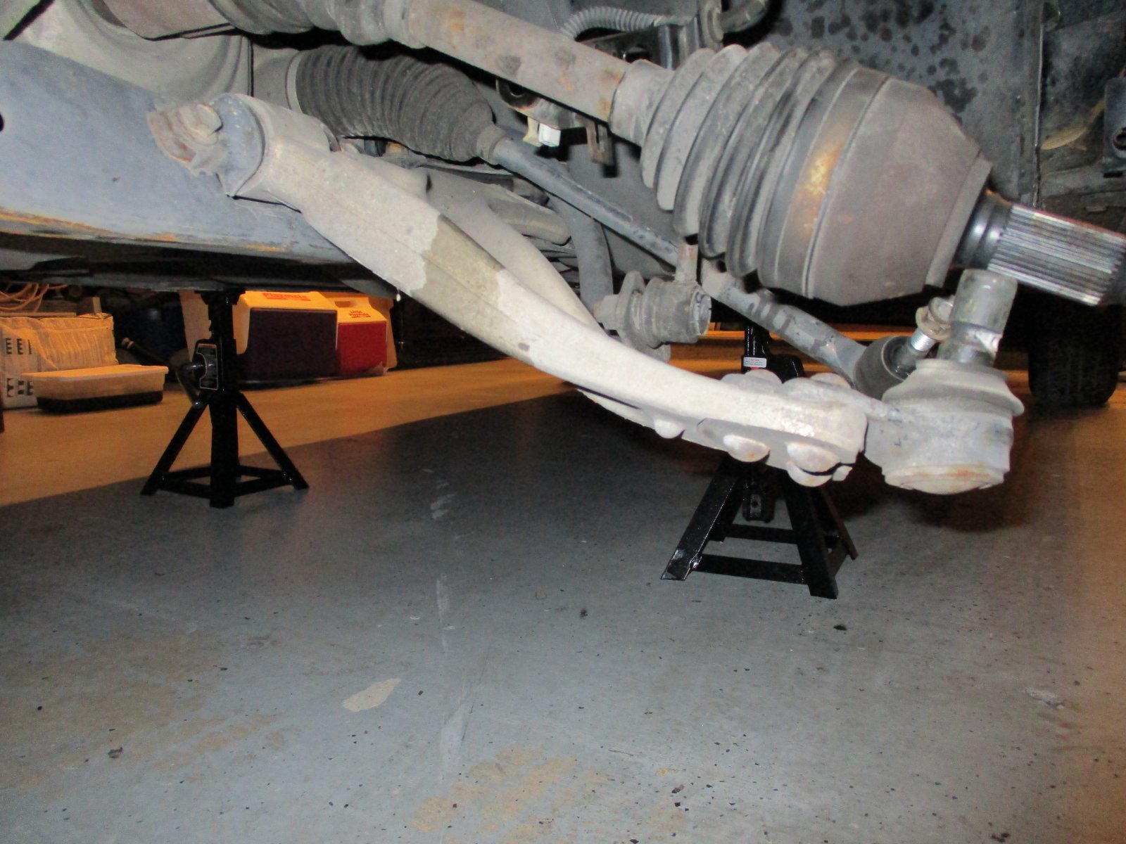

It looks like the left control arm is bent. You can't tell from these pictures so I will try to post more details tomorrow. We are more hopeful that the sub-frame is not bent, but it is hard to think of a way that the engine can be ****-eyed like that and the sub-frame to NOT be bent - keeping fingers crossed.
10/7/2017 Started Build Video Number 3

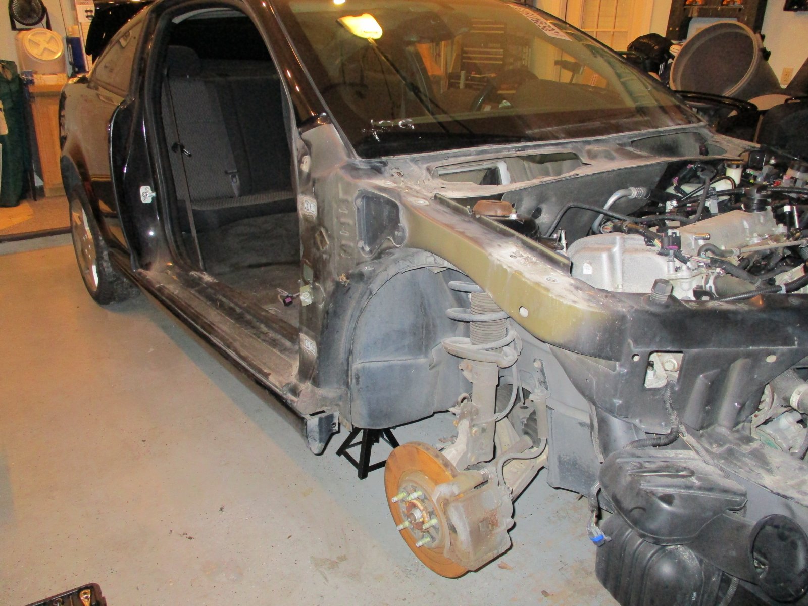

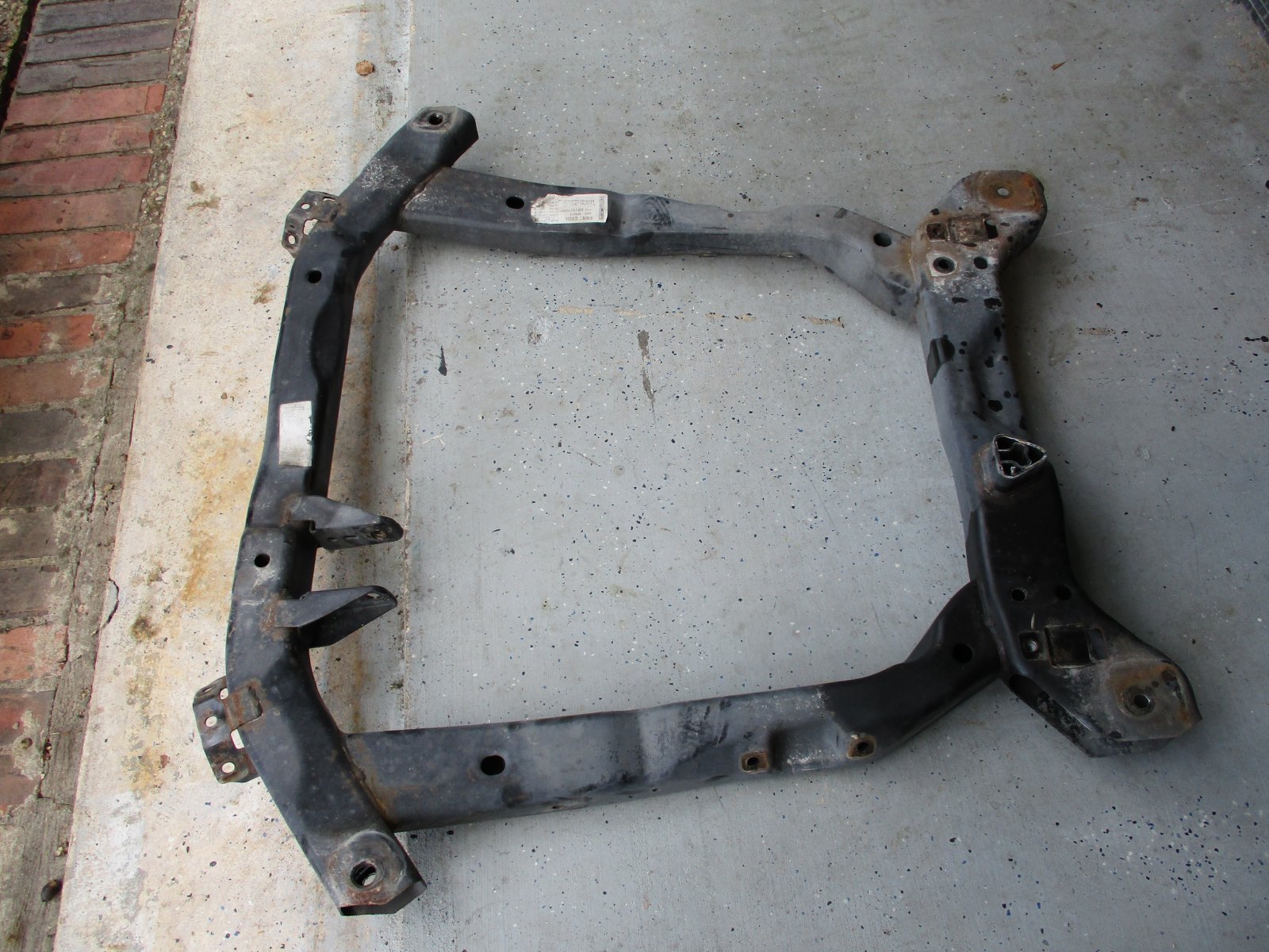

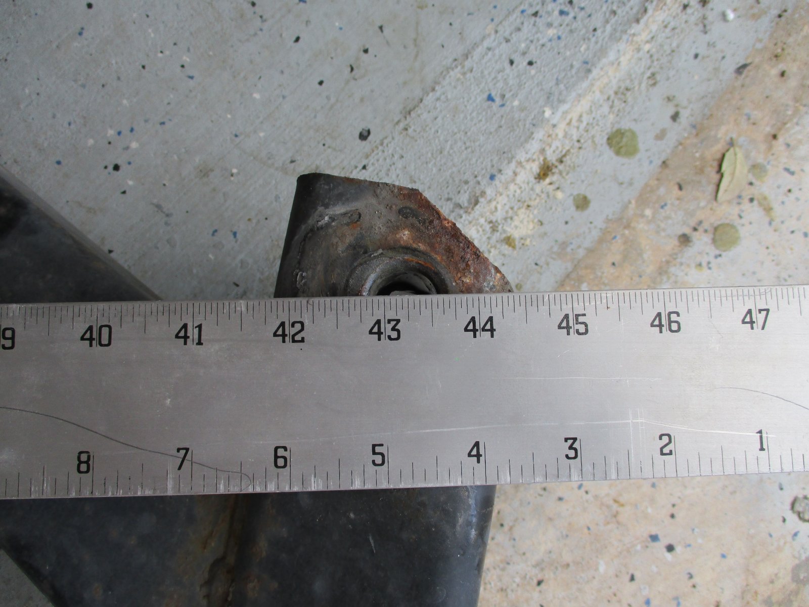

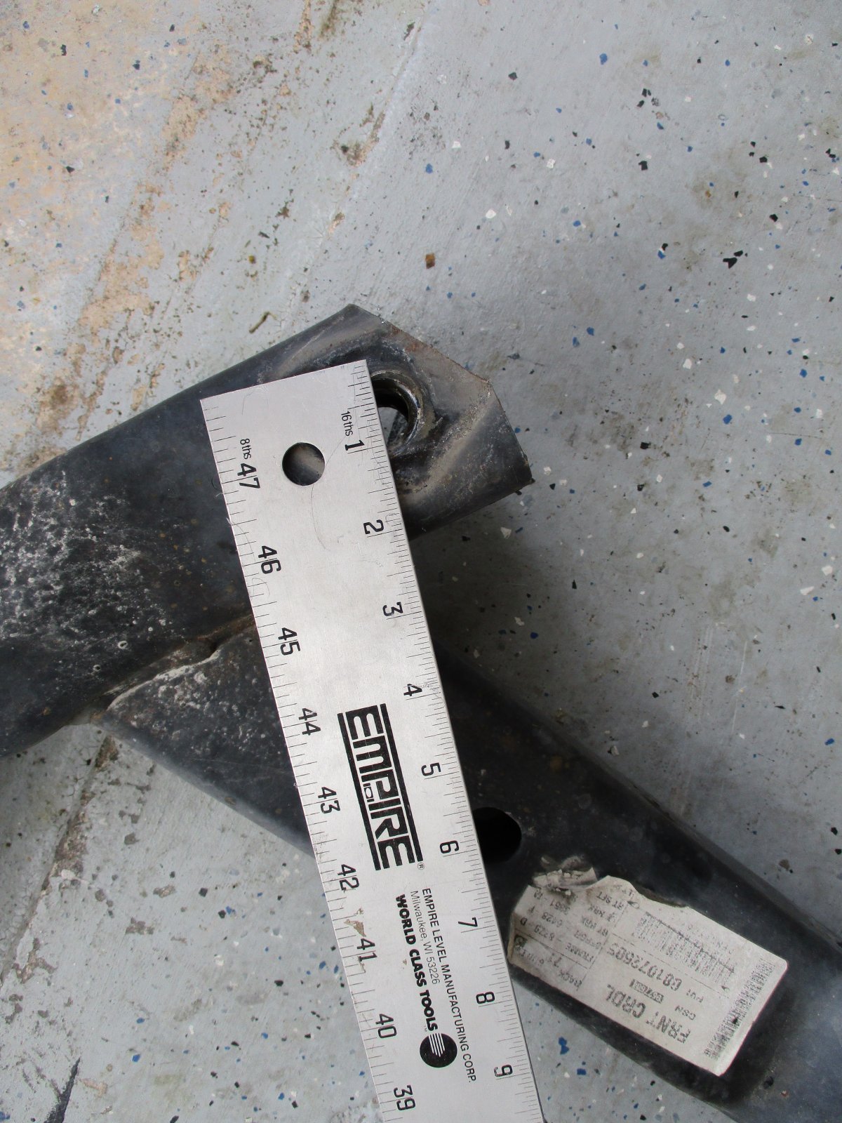

We got about 1/2 way through number 3 today and some things are resolved:

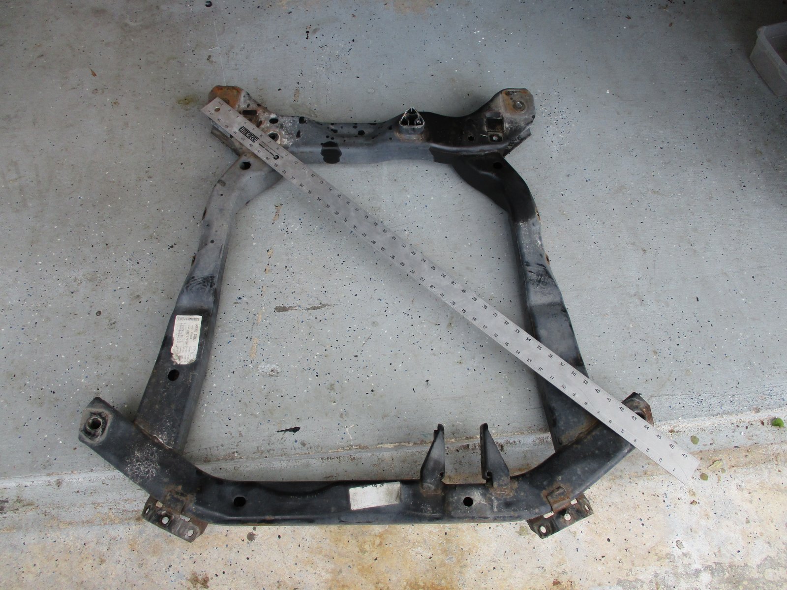

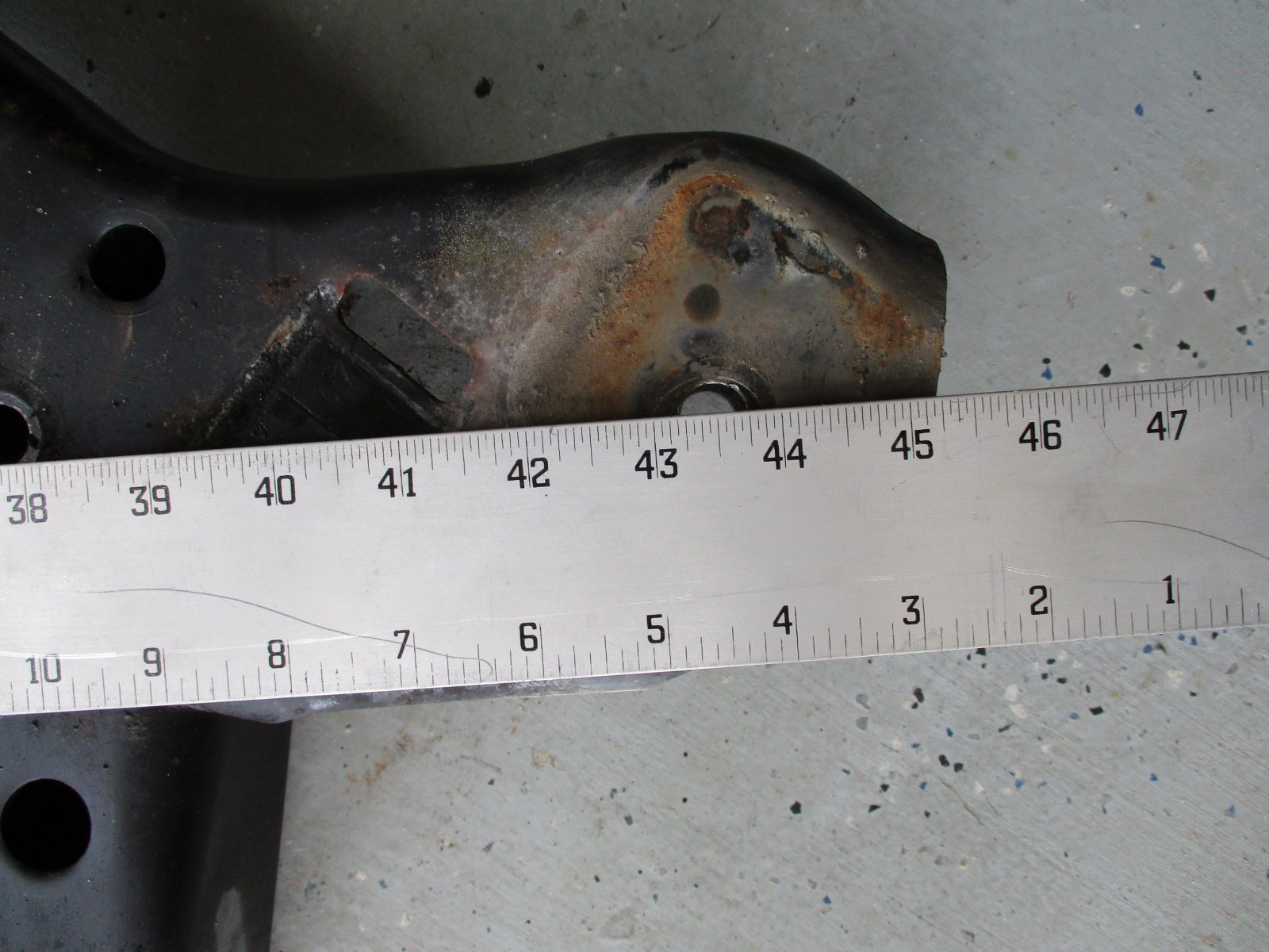

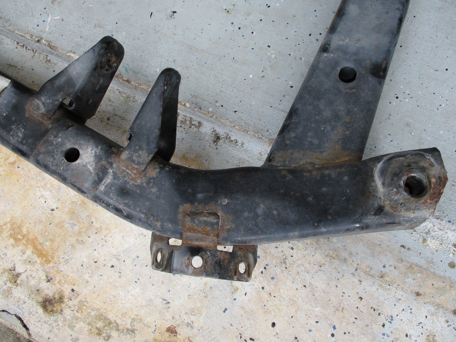

1. Left front control arm is bent. In looking at the subframe, it may not be bent which we are hoping for!
2. Front bearings need replaced - have to decide if to stay with 5 bolt or move to 4 bolt for more choices on wheels.
Bent front left control arm
Front right control arm looks OK.
Subframe on the driver side looks OK from here. Still need to get it out to confirm.

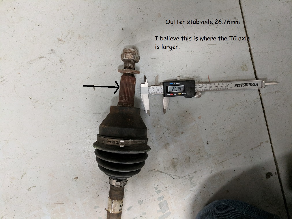

3. Knuckles are the same on every suspension up through 2007. In 2008, the FE5 knuckle was updated with various improvements for bump steer. It is NOT interchangeable. You can still use the GM Racing knuckles for those earlier years

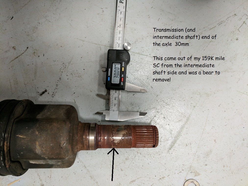

At one point, I thought that I read that the axle was a larger diameter for the sport/SS vs the LT/LS. But, I can't seem to find that post right now. And in the discussions with several people including Adam, they have said that going to a 4x100 is OK with just replacing the hubs. Can someone please confirm this is true? i.e. no axle differences between sport/SS vs LT/LS and that the standard 4x100 hub will work with a direct replacement? (and my plan would be to replace all 4 hubs to get to the 4x100 for all 4 wheels)
Thanks!
TheNuker
The 4x100 hubs are a direct replacement for Sport/SS-SC NOT TC models.
I used an 07 SS/SC donor myself and switched to 4x100 hubs without ABS. Working great.
Nuker-
P
Yeah, I believe the only options for the SS/TC are stock or redrill to 5x4.5.

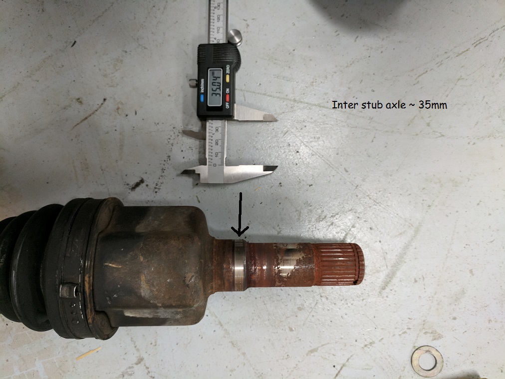

One other option is to replace the axles with the bearing hubs back to the SC version of axles and the 4 lug hubs. Especially if you are needing to replace the axles due to mileage! YMMV.
Nuker-
That was the missing link for me. All I remembered was that the 4x100 hubs didn't work on the SS, but now I see that it's the SS/TC!
Nuker-
Nuker,
We will probably do the same - have to do some more research on wheels etc. but looking good for going to the 4x100 plan. I will look through your build docs, but what did you do about the brakes? i.e. from the post above, the brakes are a different size for the JL9 package compared to others - i.e. did you get calipers etc. for smaller discs?
P
As far as I can find, the transmission is the same so the input part of the axles has to be the same and I am thinking that the "intermediate" shaft (used to keep both axles the same length) would have to have the same input as the transmission.
Best test would be someone who has a TC pull the axles from both sides (not the "intermediate" shaft which is discontinued BTW) and measure the inner side of the axle stub diameter so we can compare it to a SC axle. Here is an example of my SC axle. Both sides are the same with the intermediate shaft making up the difference between the transmission and the engine pulley side. This axle came out of my 159k mile donor and is being replaced. It came out of the intermediate shaft and was a bear to remove! Both axles should be the exact same with only the spline ends that go into the bearing hubs a different size.

We have the subframe out and from what we can see, it doesn't appear to be bent - i.e. the bolts came out OK without binding and looking at the subframe, I can't tell immediately that it is bent. The engine is still ****-eyed, but that appears to be the main frame and the engine mounts. So, I took some measurements to see what we have - if someone can confirm whether they are correct or bent would be a great help!
The subframe seen from the side:
I put the strait edge with the 1" point being on the inside of the corner bolt hole:
Back right (passenger) to front left (driver) reads ~41-13/16" (I had to subtract the initial 1" from seen below):
And Back left (driver) to front right (passenger) reads ~42-3/16" (again subtract the 1" start point below):
Obviously not square, but we are not sure if it is supposed to be or not?
Also, any concern with this amount of rust on the subframe? From here it looks like just surface rust that will get cleaned/blasted off before painting, but how does this compare to the experience of others?
