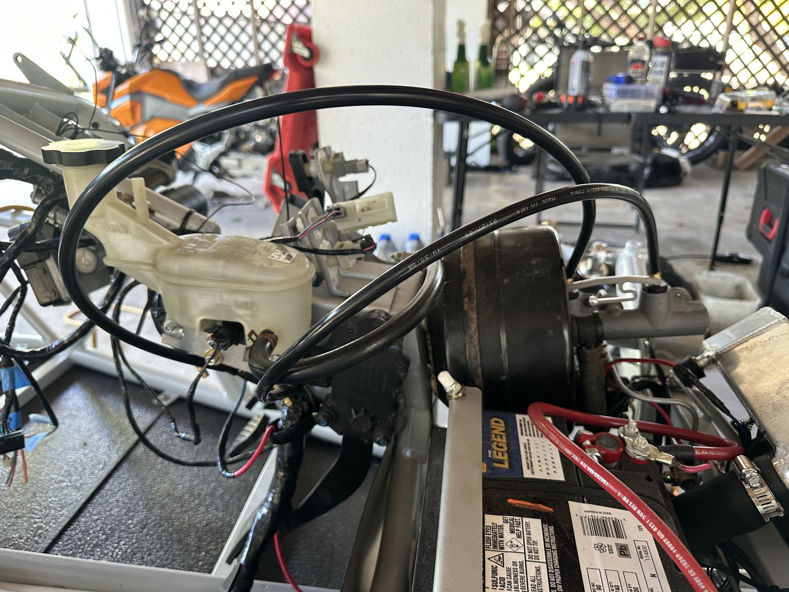

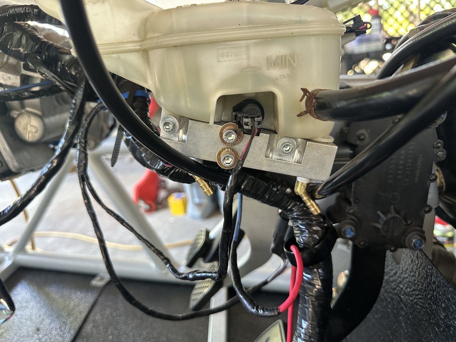

Working on the brake reservoir relocation today. Got everything mounted and now I’m hooking up the lines. Does it matter which way they are connected? I wouldn’t think so but this piping is hard to work with and I wouldn’t rather ask than to do it twice.

I didn’t actually use those cause lots of folks were having issues with leaking but you will need them almost flat and not high like that or you’ll never get fluid to the master cylinder from the reservoir. Hard to see which fitting you have on the m/c
What did you use? I think I saw someone using what looked like braided stainless lines. Was that you? I am not going to mount them like that. That was just to give a visual of what I was asking.

Working on the brake reservoir relocation today. Got everything mounted and now I’m hooking up the lines. Does it matter which way they are connected? I wouldn’t think so but this piping is hard to work with and I wouldn’t rather ask than to do it twice. View attachment 53509View attachment 53510
I used those provided in the kit, with red loctite and let them cure for days while I did other things before they ever saw fluid. I havent had a problem yet.
I put braided stainless lines on... copying what others had already figured out.

The proportioning valve isn't necessary, although might be good to have. You can do braided lines from the reservoir to the master cylinder without it. You are less likely to have leaks with the braided lines.
I ran for about a year without the proportioning valve and didn't see the need for....... Until I started competing in autocross where I was using the brakes very hard. IMHO you will probably not notice the need for it on the street unless you wind up in a panic braking situation where it really shows its merit. After experiencing hard driving in the vehicle I would not feel comfortable without one just for the what if situation.
The lines from the reservoir to the master base need to be as low as possible. Fluid does not like to travel up hill on its own.
You don’t need the prop valve until you do. One panic stop and you’ll find out quickly its needed.
That proportioning valve was ordered before DF offered their solution. The DF solution includes all the custom brake lines, so if you are going to add one, and don't want to make your own brake lines, I would recommend it.
No, it isn't needed for replacing the reservoir lines. If you want to stop faster, and more in control, then it is recommended.
