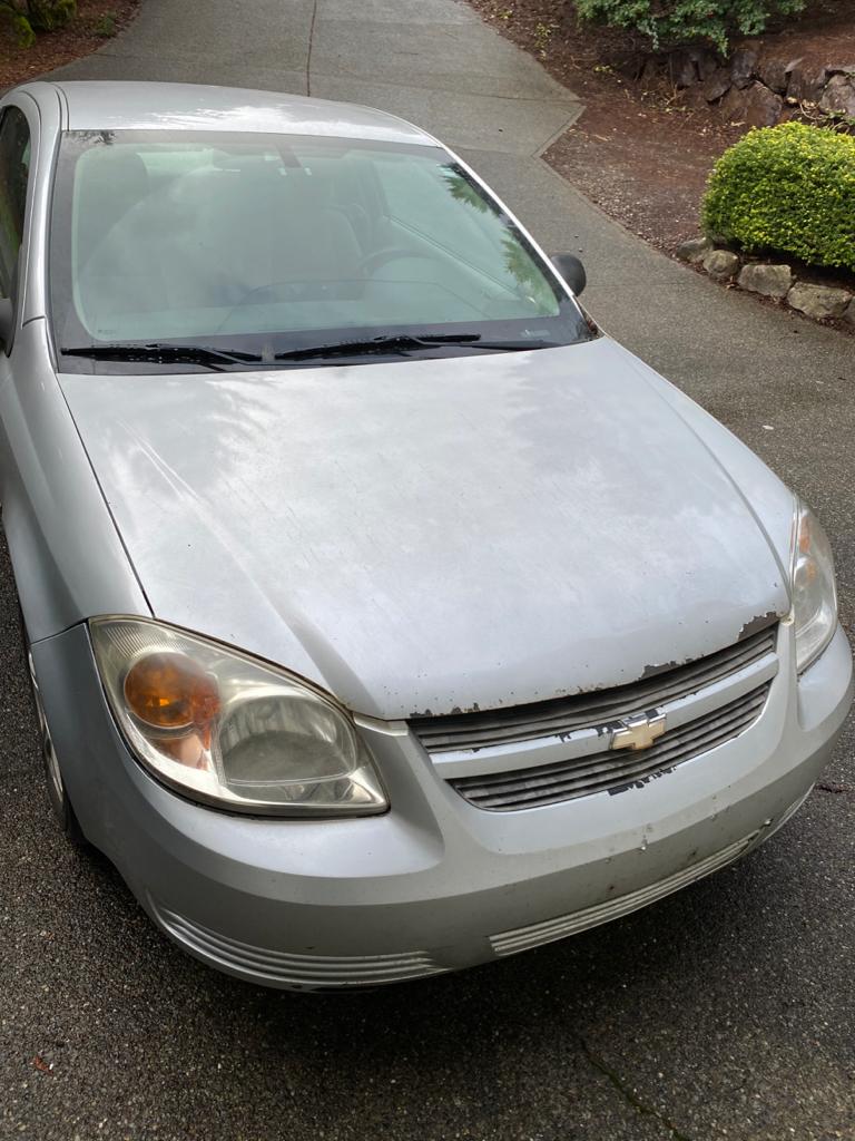

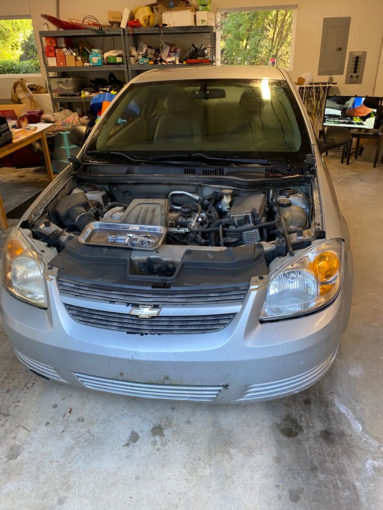

Hi All!

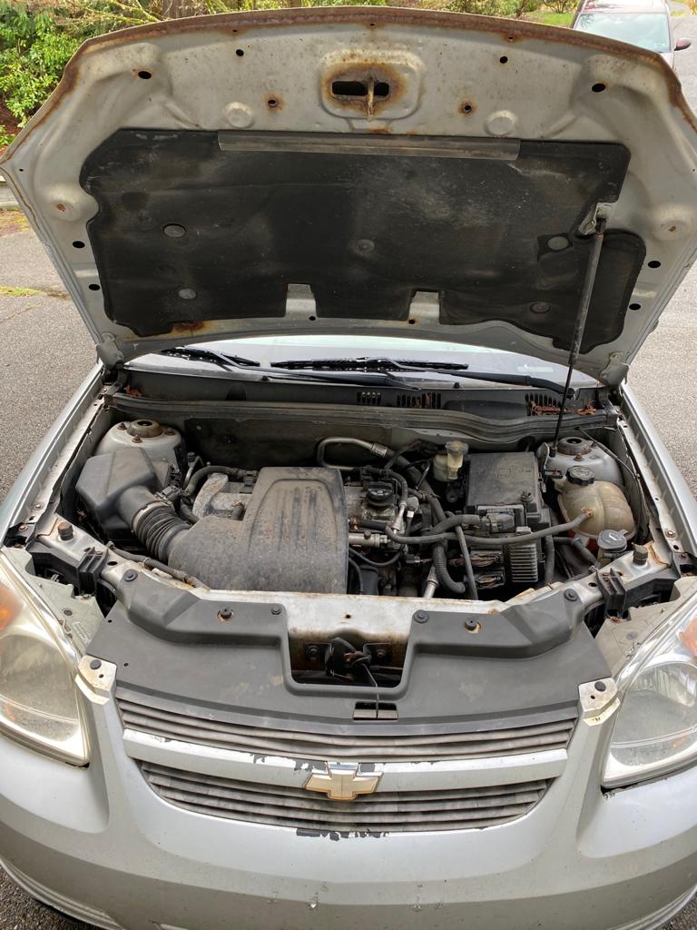

New builder here in WA state. I haven't placed the order for my kit yet, but just purchased my donor this afternoon so thought I would start my build log. It's a 2007 LS automatic (I've got plans to add a supercharger or turbo kit to it eventually) with 130k miles on it. Found the car via Craigslist and kinda just lucked into it as the seller wasn't getting much attention and just wanted to get rid of it. The car is dirty, has a bunch of rust on it the body, but the engine runs well, and the important parts all look good from the outside. I'll be starting the tear down soon and then will get the kit order placed in a few or so.

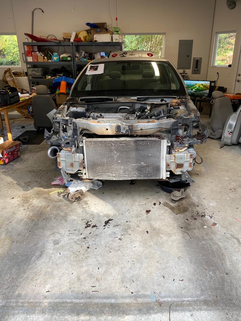

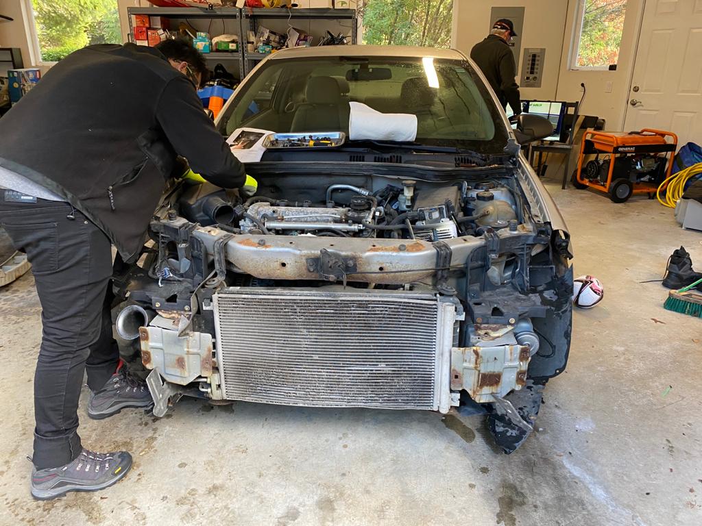

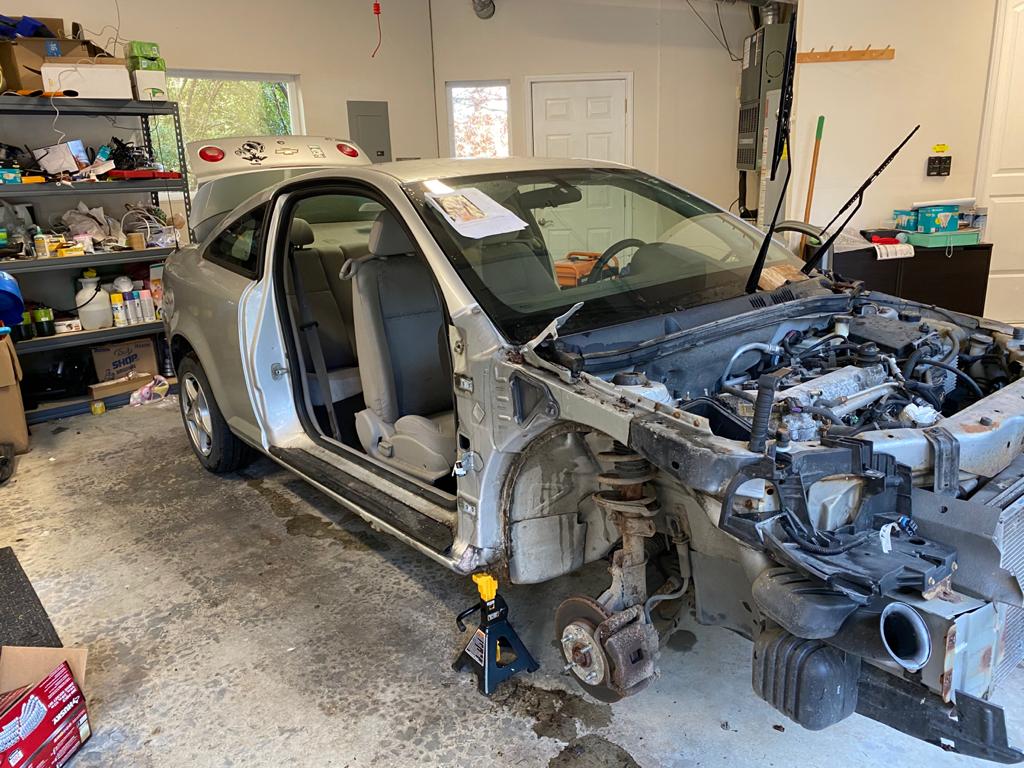

Made some progress this weekend in stripping the donor. Got the hood out, bumper, fenders, front seats, and front calipers all out. Also, managed to empty the fuel tank; the seller was very considerate and sold the car with a full tank of gas. So emptying this out required multiple 5 gallon gas cans. Looking forward to getting the suspension and powertrain out next.

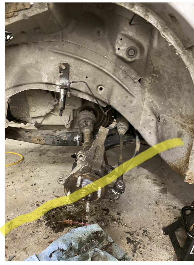

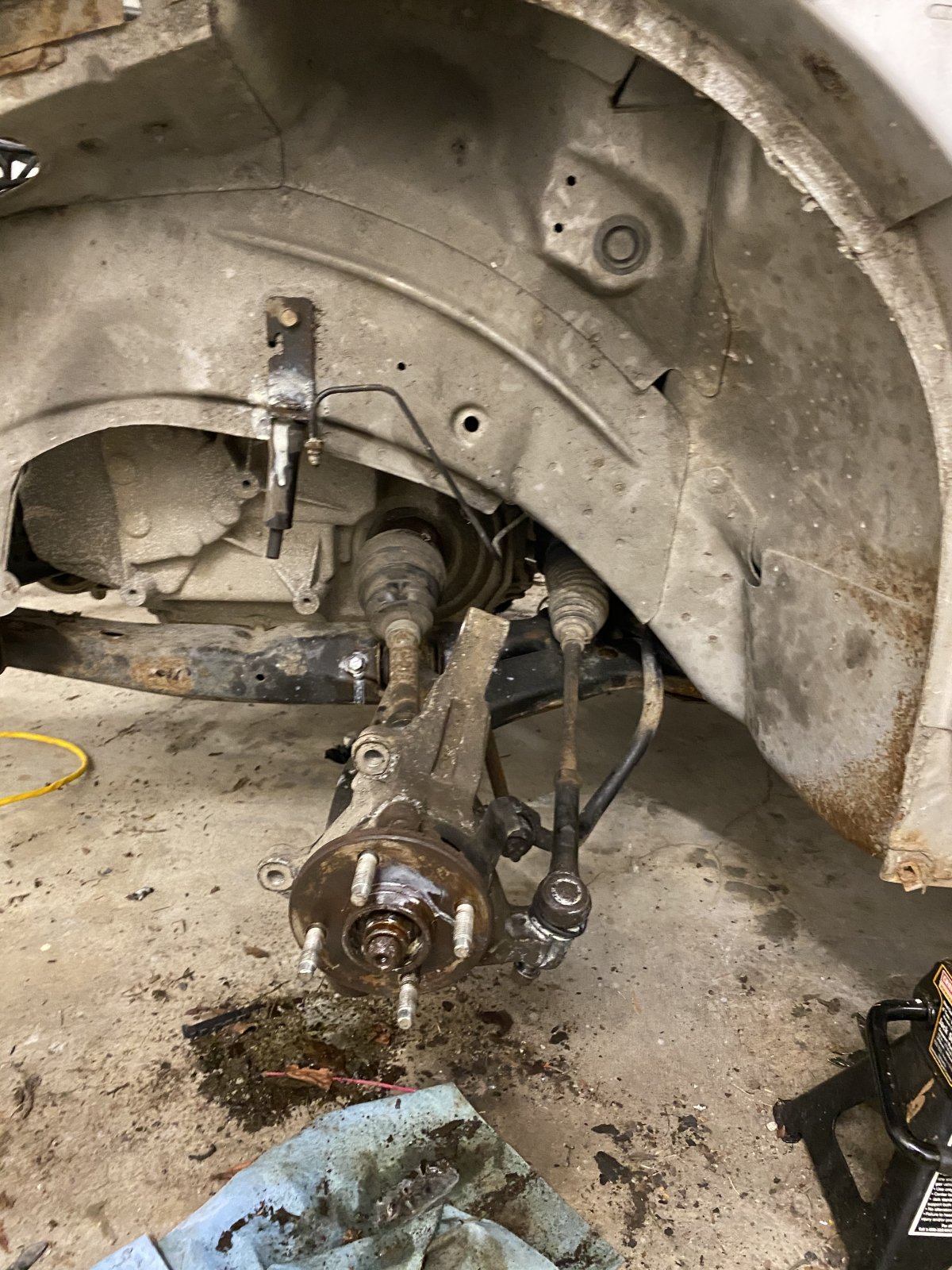

Made some progress over the last few days. In working on the suspension I had to cut off front sway bar connection to the struts. Now that I’m working on taking the axle nut off, the axle seems to spin as I’m using the wrench on it. Any suggestions on how to get this nut off?
11584
Sounds like the perfect justification for a new air compressor and an impact driver. New project, new tools.
put a pipe, pry bar, long extension or what ever between the studs touching the ground and that will lock the hub up. *note, pic not drawn to scale hehe
Another option would be to put a wheel and tire back on with a couple of lug nuts.
Anks329
looking great! The only way i could get those Axle nuts off is with an electric impact wrench. I got the cheap electric version and worked great. I had a big need to use this in other areas as well. i highly suggest getting one.
https://www.harborfreight.com/7a-12-in-impact-wrench-61173.html
I've got a Makita 18v impact wrench that I haven't had much luck with yet. Will try with the wheel back on, and hopefully it works. Otherwise another trip to Harbor Freight it is :-)
Also, just placed my order for the kit! I'm going with the Extended City frame version. Exciting day!!
Motoracer110
I've got a Makita 18v impact wrench that I haven't had much luck with yet. Will try with the wheel back on, and hopefully it works. Otherwise another trip to Harbor Freight it is :)
o dang they are on there good then, I did have to let my gun impact for about 10-15 seconds before mine came off

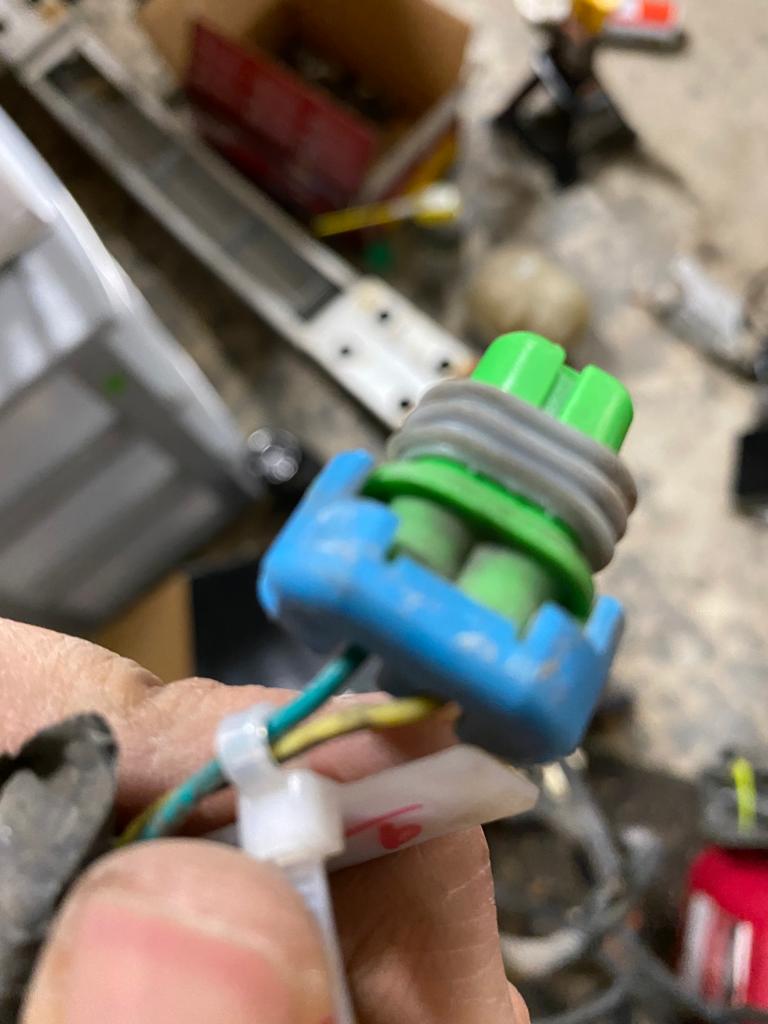

As i'm cleaning out the engine bay, I ran into a connector that incorrectly labeled near the driver side headlights, it's got a green and yellow wire coming out of it and here's a picture of the connector

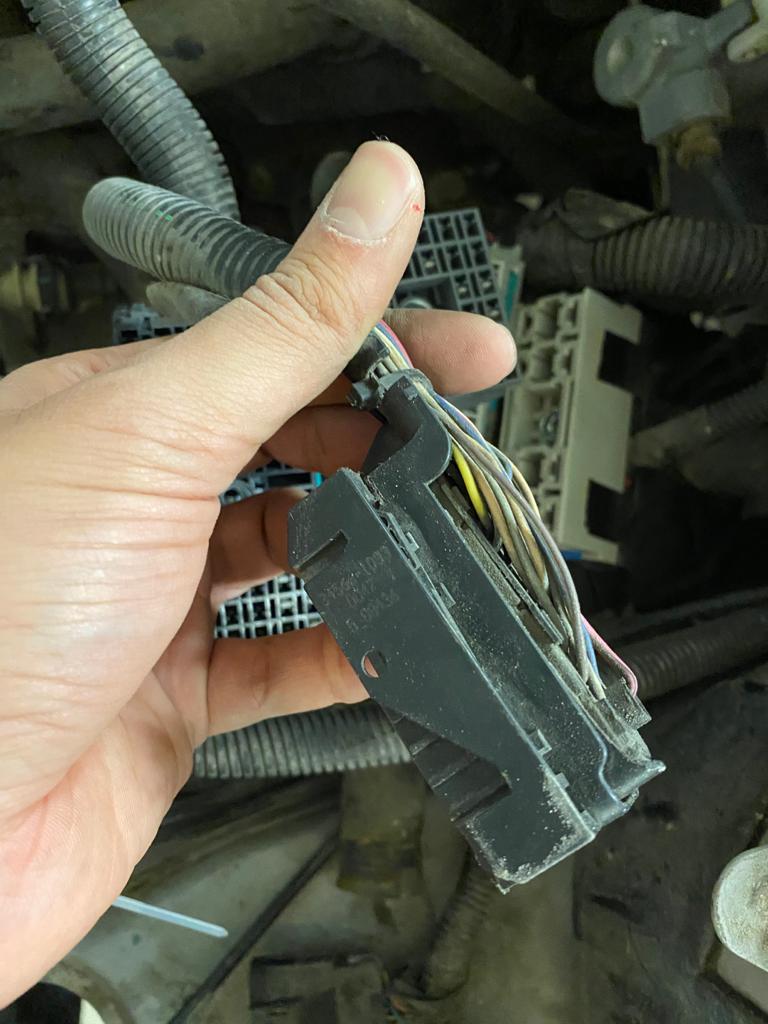

Second question, one of the ECM plugs was broken. Is it important to fix this, or can I leave it as is? And if I should replace it, where can I get a replacement plug?
11809
Thanks!
