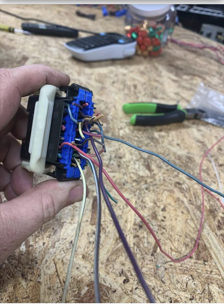

Need help on another wiring issue! LOL
I deleted the other posts because I figured them out.
In the body harness, I have a few wires left that sound important. Do these get cut out and thinned??
A6 - run/crank ignition 1 voltage
B9 - cruise control clutch pedal position switch signal
B11 - accelerator pedal position
C3 - torque converter clutch brake switch signal
D4 - stop lamp supply voltage
25074
I figured out my issues!!!
I have a 2006 SS that is NOT SC or TC.
I was using the wiring labels for the base model in the link in the video.
I found that I should have been using the SC labels. Those wires were VERY important and were cut and labeled.
so if anyone else has a similar issue, use the SC labels.
