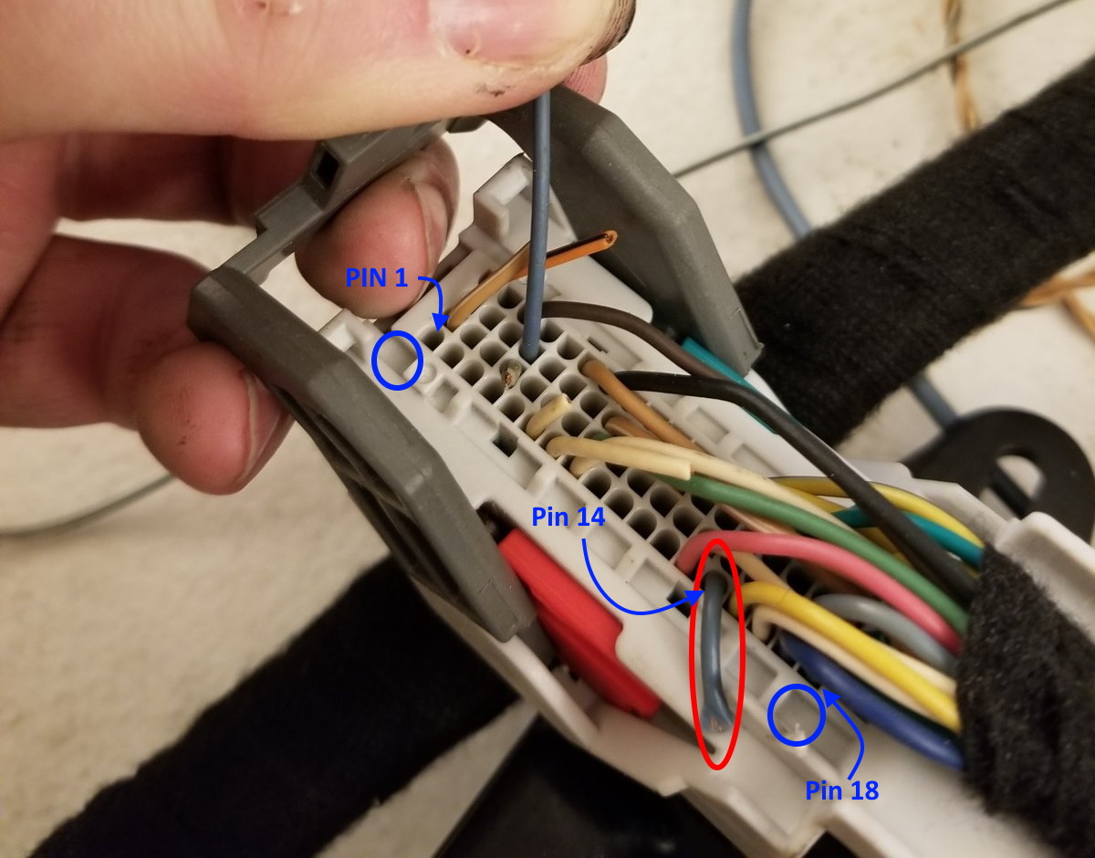

I've adhered to the newer harness series as much as possible as it is more thorough and taken some time to double check the old series too for any thing i might have missed. working with a naturally aspirated manual should make things straight forward I thought... some things were, thanks to some of the research others have here in the forums ;- )
So i have exhausted my efforts to research and figure this one out on my own... gotta ask for help now.
so here goes...
so here goes...
- I have a spare wire coming from the body to engine connector that I don't know what to do with.
- light green
- in position E-1 if you are looking at the connector head on
- runs to the BCM housing currently, along with other loose wires that ARE accounted for
- Need to confirm: I can either thin out or safely route for later use the evap pump wire
- [red and white]
- Need to confirm: Even though it has not been addressed yet in the new wiring harness series I still have my handbrake ground connector dangling in the middle of my harness with suspisicons that it will by left in the middle to accomodate the hand brake when I finish. {see above image}
- I am sorely missing the fuse box side wiring for the ignition lock cylinder control solenoid... A.K.A. the Key Lock B10 connector that needs to be extended during the dash harness addition.
