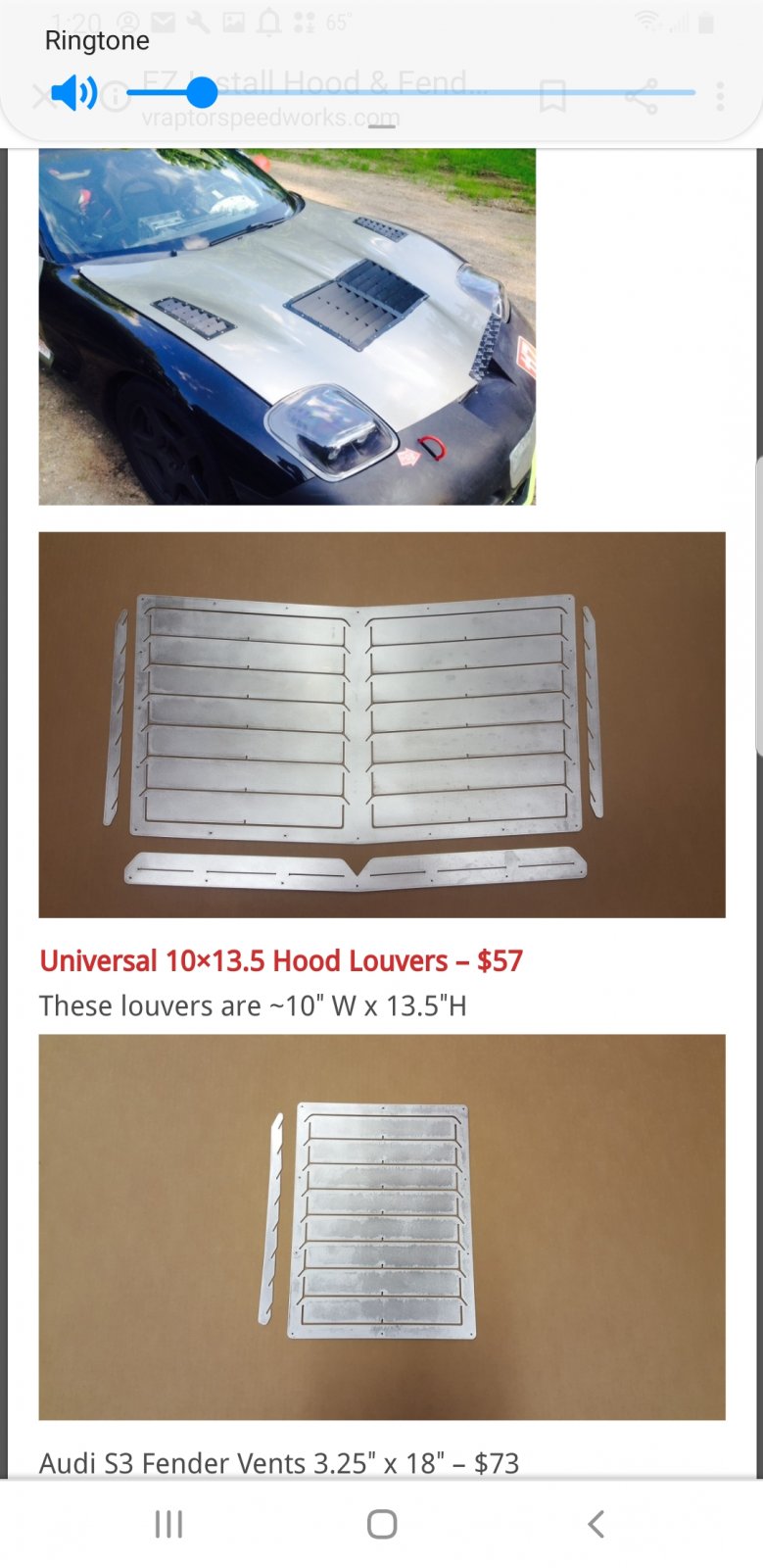

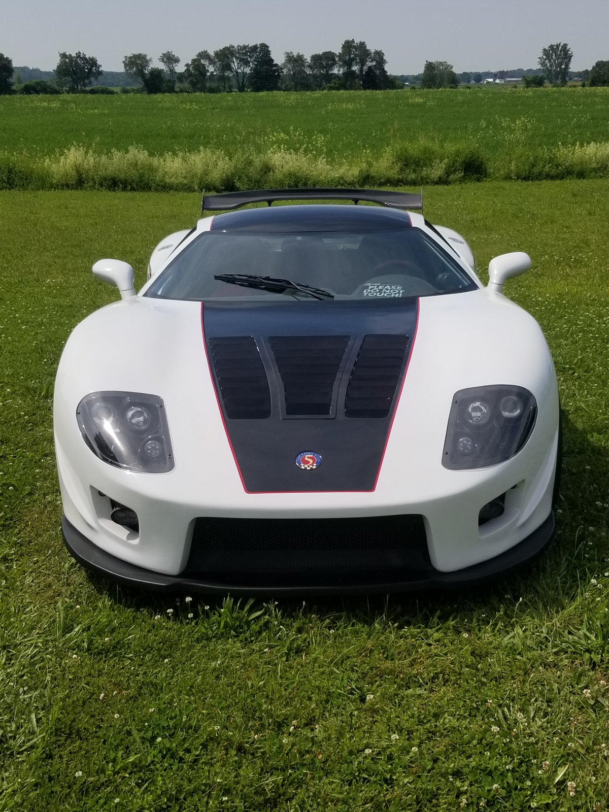

I recently built a Factory five GTM, and put hood louvers on the hood to improve cooling, and to increase down force. The Goblin I've heard has no cooling problems, but could it benefit from less lift in the front, without the added drag of a front spoiler?
Here is a picture of a universal louver sold by VRAPTOR Speedworks. $57. I mounted louvers made by Shane similar to this on my GTM, and they worked great. They assemble like an old aluminum ice cube tray. They get the air out. See pictures of the universal one, and my GTM's hood.
