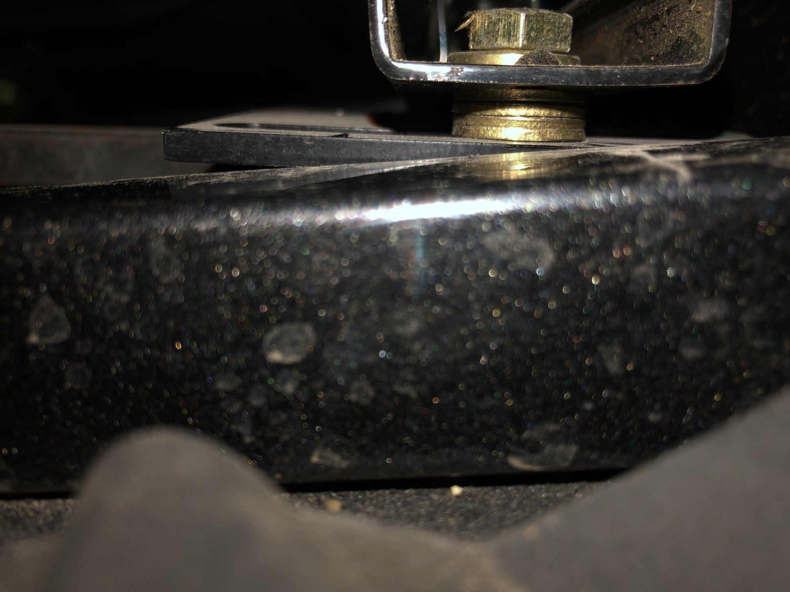

I caught all that in your previous post, but in my case, it looks like the front ends of the seat rails will rest on top of the frame crossbar. Perhaps your seat rails were shorter than mine.
I used 4 washers to clear the bar

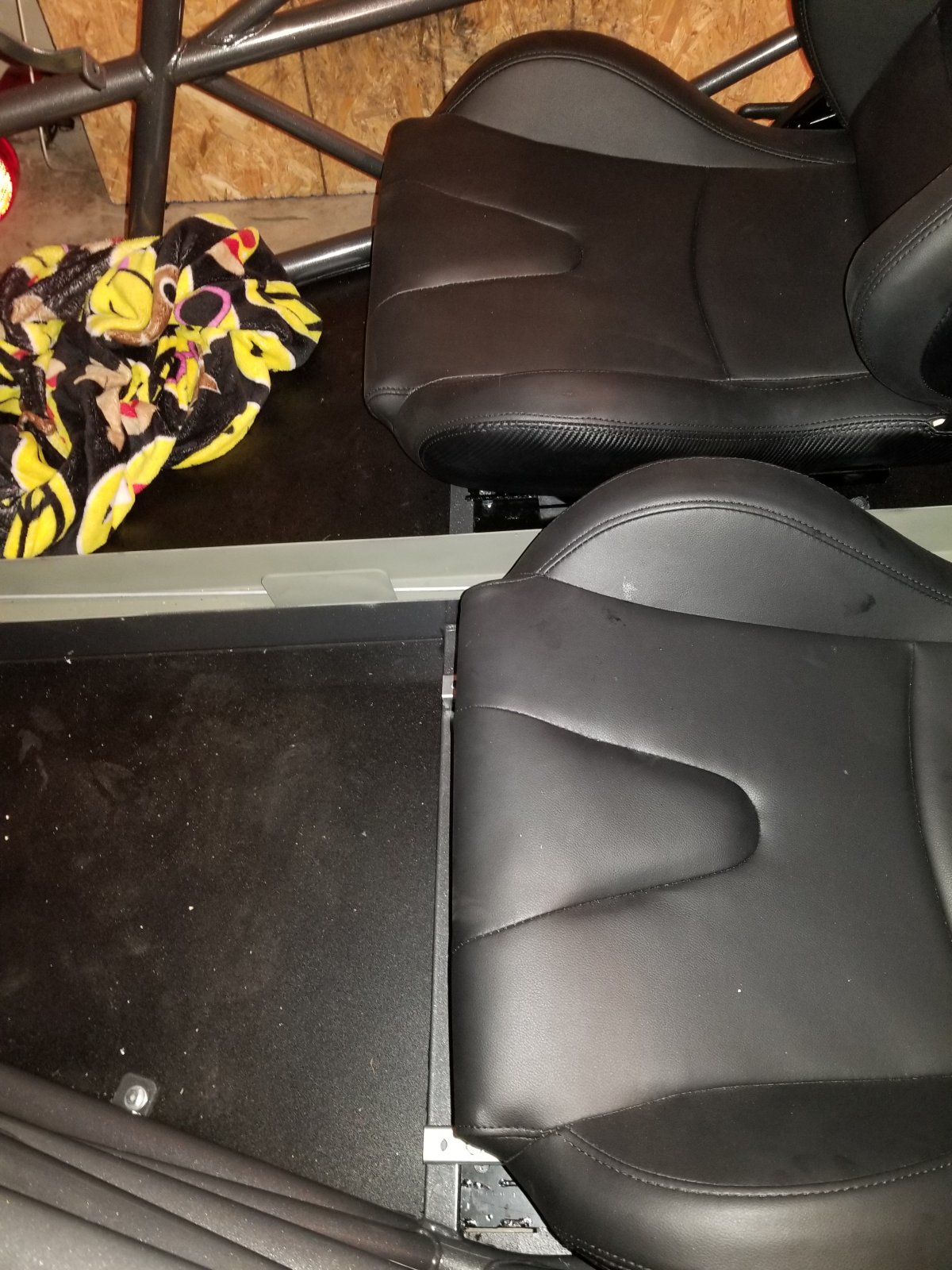

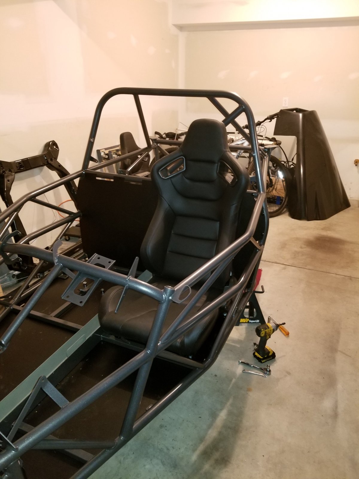

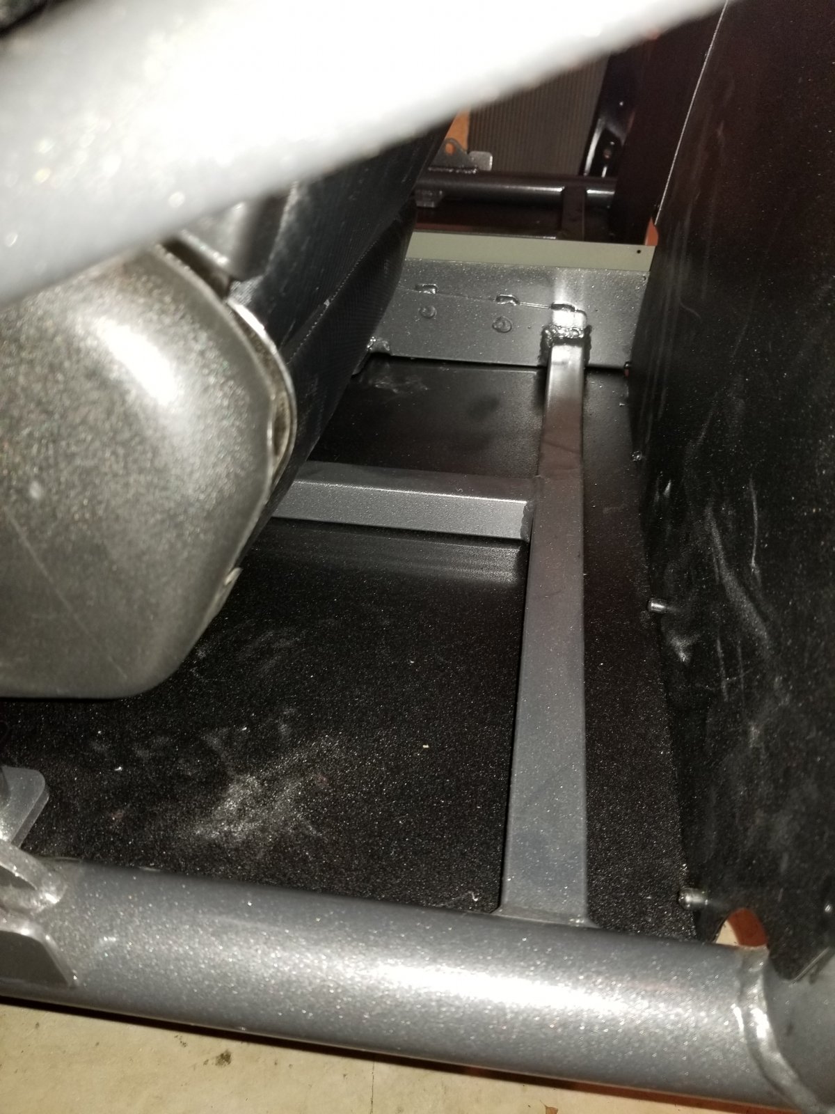

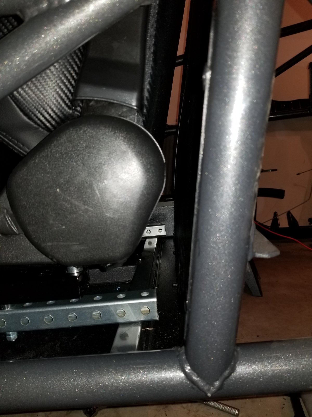

Well since I was able to get to the hardware store today and pick up some nuts, bolts, and washers, I figured I would actually mount the driver's seat and hopefully get clarity on whether this was going to work without any modifications, or not.
First, I was correct: 3/4" spacers between the rear of the seat brackets and the mounting points on the floor pan worked out perfectly.
Second, I was also correct about the front 1/4" or so of my sliders resting perfectly on the frame crossbar. Once it was all tightened down, there's zero play whatsoever in the seat, and no bending or anything going on with the seat bracket.
The only problem is, the seat does not go far enough back with the sliders that came with them. I'm not a tall guy, but I fear I'm going to be too close to the steering wheel, and there's a good half foot to spare behind the seat when it is at the furtherest-back position.
I found another set of sliders that should give me a couple more inches to play with. Failing that, I will try to see if I can make some adapter plates to move the seats back a couple of inches, independent of the sliders. Anybody willing to make and sell me something like this out of steel?
I'll have to actually get the dimensions first. I've got another set of sliders on their way though, so I'll try those first.
Really appreciate the consideration, seriously!

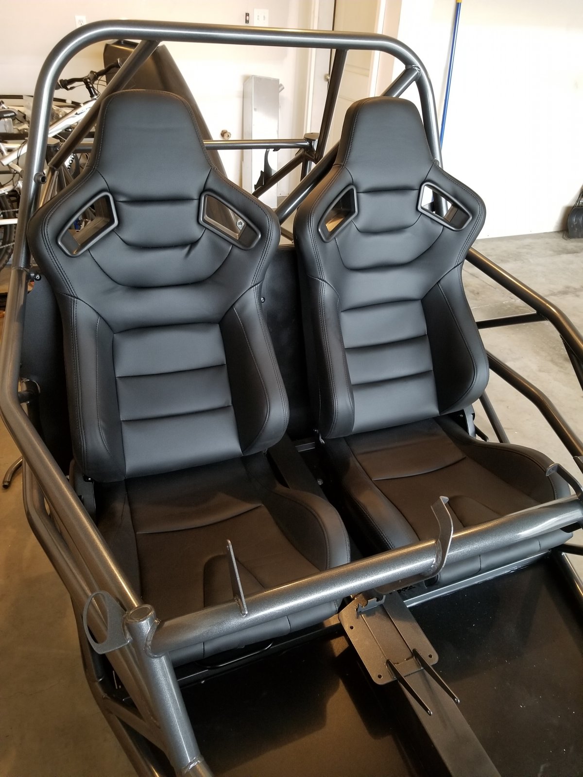

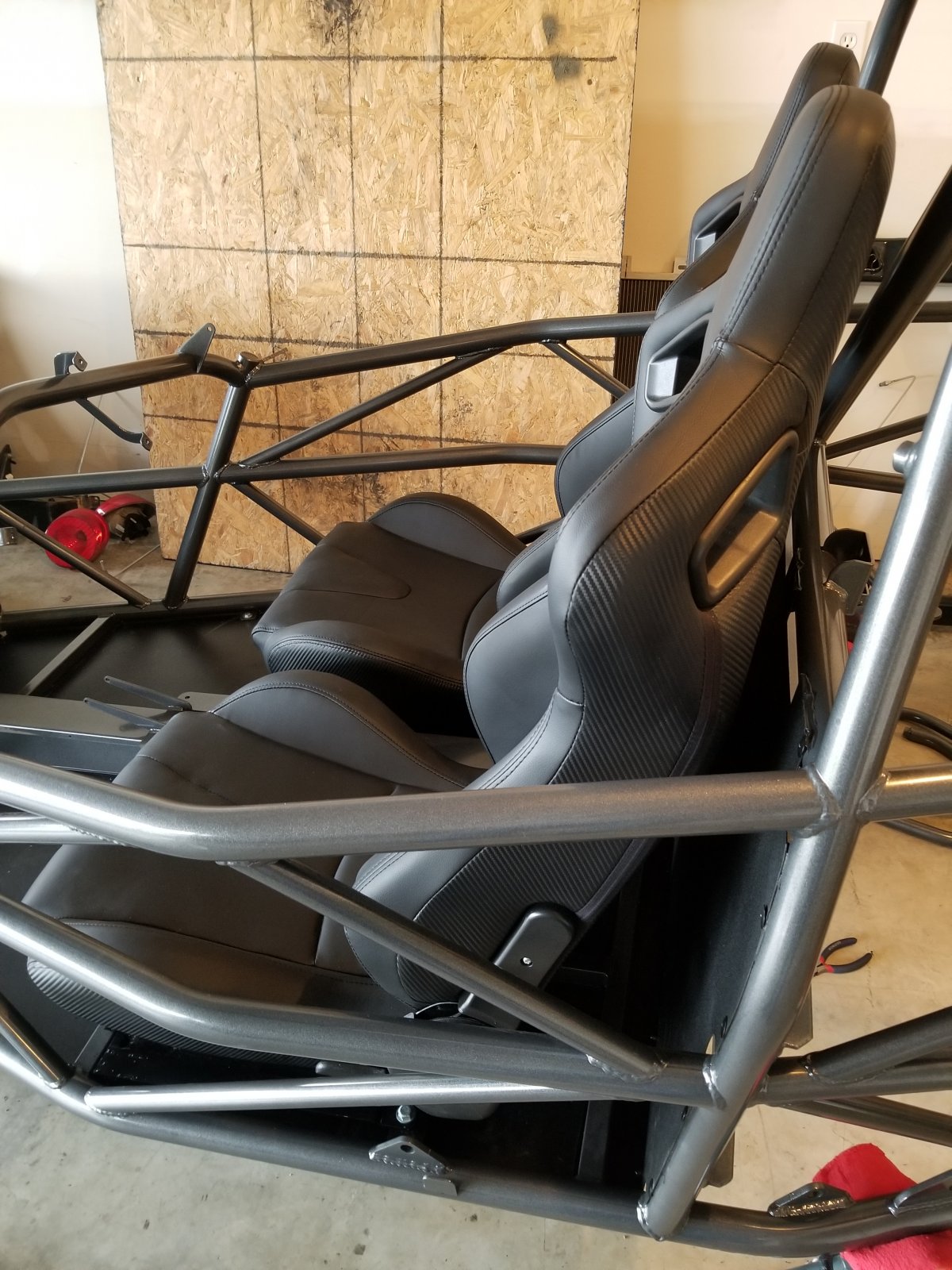

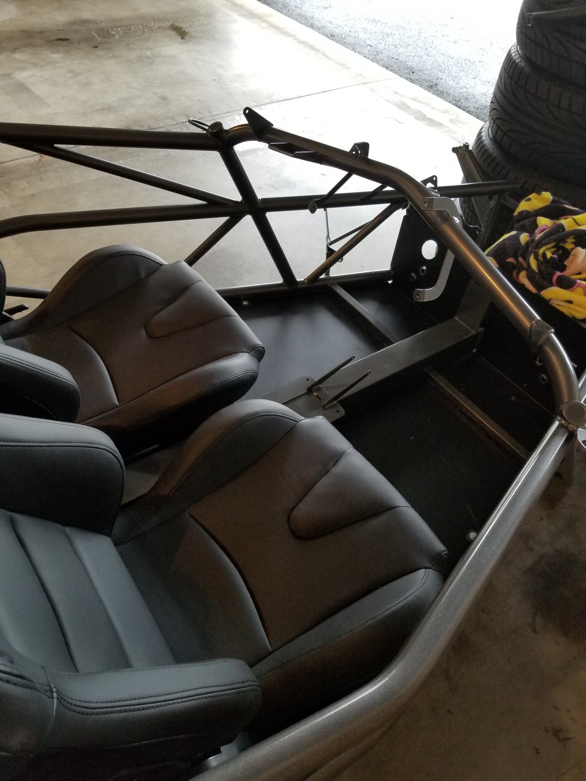

Got both seats installed this weekend on the new sliders. I gained a couple inches I think. Either way, I won't worry too much about fitment until I get the power steering unit in.
Looks pretty good in my opinion, though the passenger seat has a little bit of a flaw in the material up next to the left-shoulder restraint hole. I guess that should be expected from SUPER CHEAP SEATS lol.

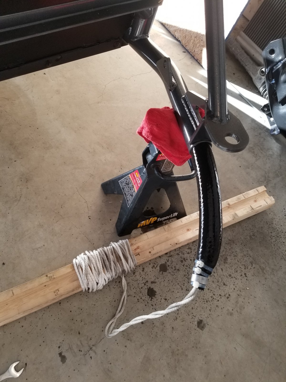

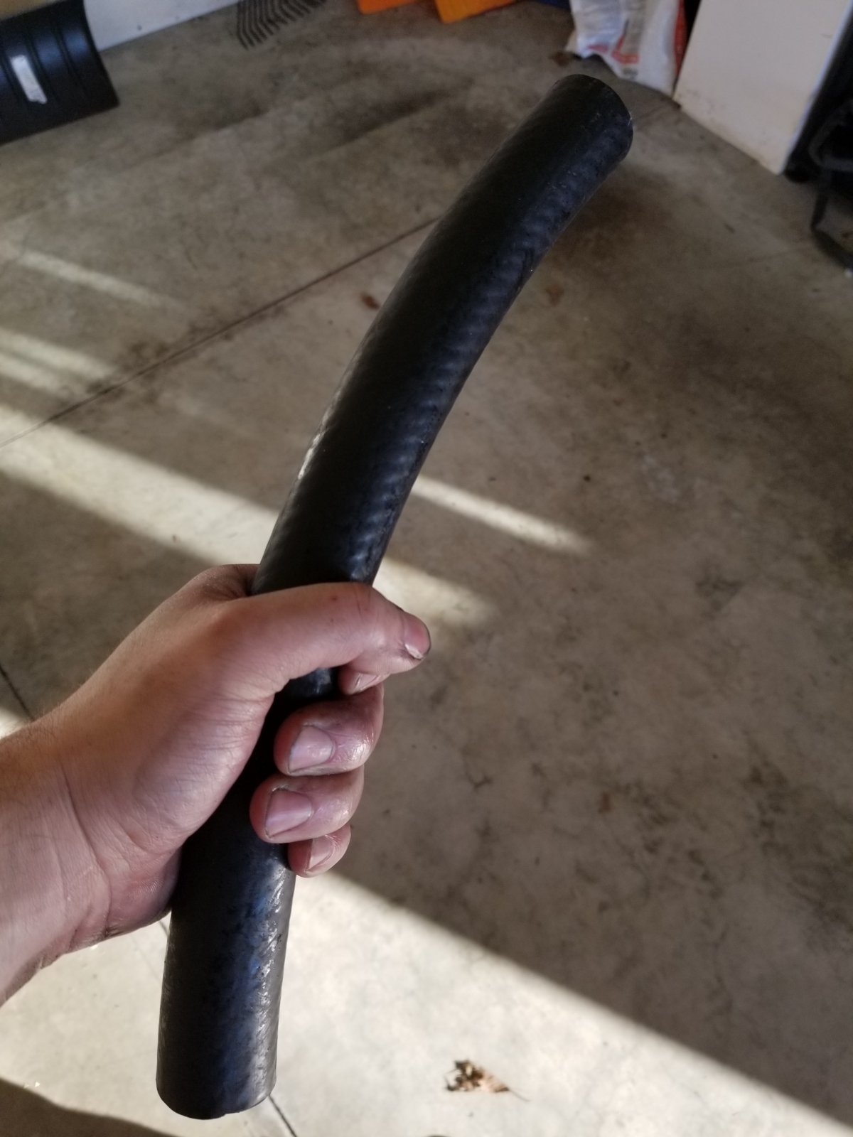

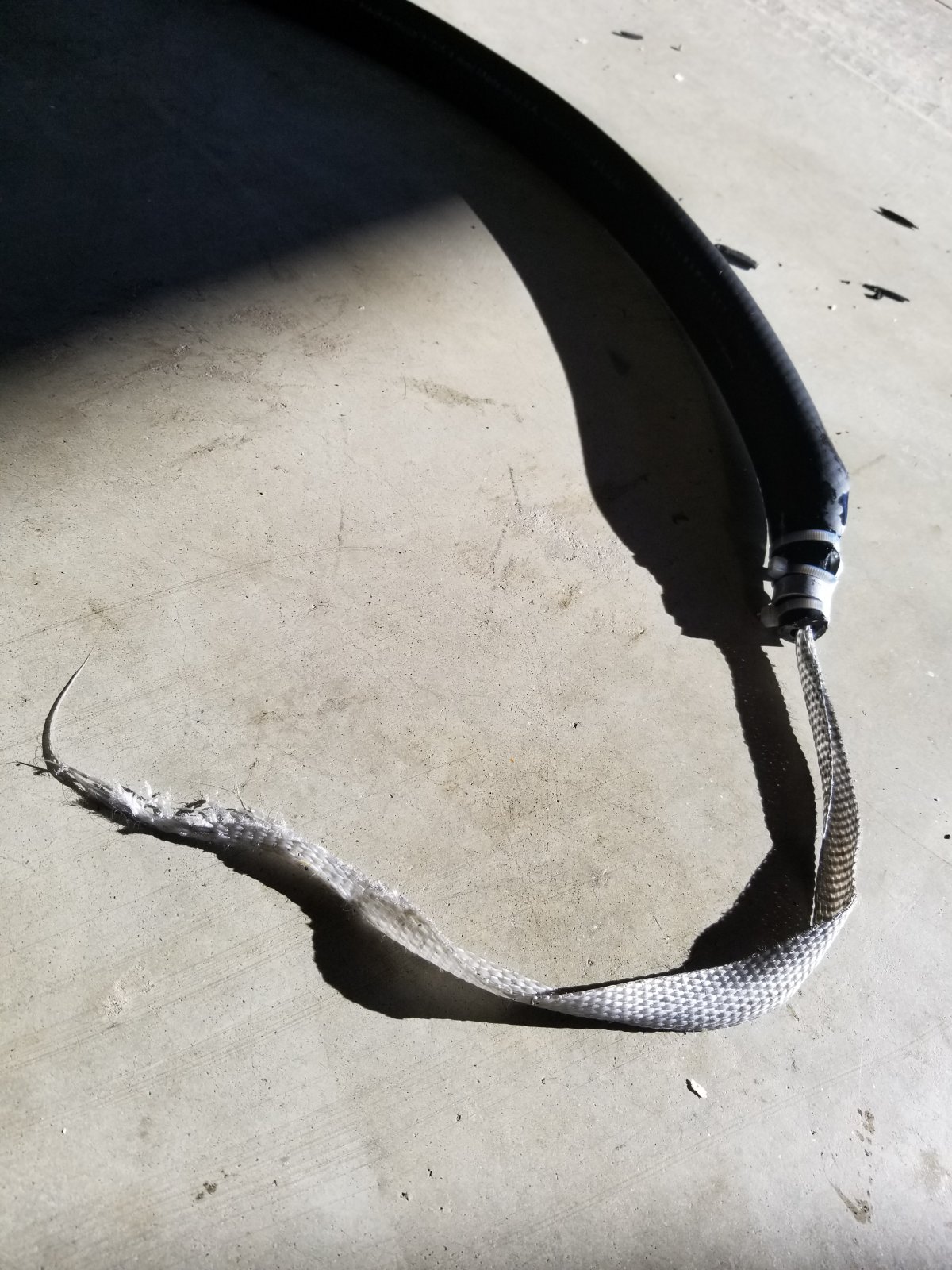

I got back at it today. I prepped the end of the hose for the 4th time, lubed the frame tube up good, soaked the hose good, and went for it. Here's the result:
I just about threw in the towel at that point. I had already chipped away at the length of heater hose so much, I didn't think I would have enough, and to make matters worse, I managed to damage my $35 puller tool. I started to clean up, but then I thought, no ... it's 65 degrees outside, it's a beautiful day, I'm not going to be beaten by this **** hose. I knew there were plenty of people on here that pulled these hoses through without the DF tool, so I started to look around to see what I could use to mimic its functionality. I don't have a winch, and there's nothing laying around to make a makeshift one out of.

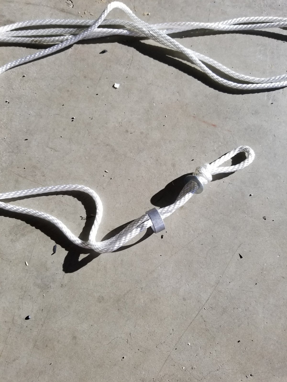

What I ended up doing was, I took a long length of nylon rope, doubled it back on itself, and mimic'd the DF tool at one end:
I took a piece of scrap lumber I had in the corner of the garage and knotted the other end of the rope around it, then wound up most of the slack around the lumber. I put the rope through the frame, prepped the end of the hose, lubed up the tube and the hose, and started pulling. It was easy at first, but got very difficult, very fast. I ended up laying on my back with my arms wrapped around the lumber, and using my legs to push against the frame. Paydirt:
I lucked out ... this is all the hose I had left!
Shout out to DF for sending more than enough extra hose for idiots like me that screw up a lot .... errr... have lots of "learning experiences".

First of all, I made things easy on myself (or so I thought), by buying one of DF's hose puller tools. If you weren't aware, it's a $35 device of DF's design, that screws down to a 2x4 which is attached to the rear of the frame, where the subframe mounts. You do one side, then move your assembly to the other side, and repeat. Well, not for me. I failed all three tries I made yesterday, and damaged the DF tool in the process. I was not careful and let the nylon strap wind funny as I ran my drill on the first attempt, and it ended up somehow doubling back on itself and fraying a bit along one edge, I believe because of the sharp edge of the washer on that side of the tool. It worsened on the second and third attempts. I called it a day after failed attempt #3.

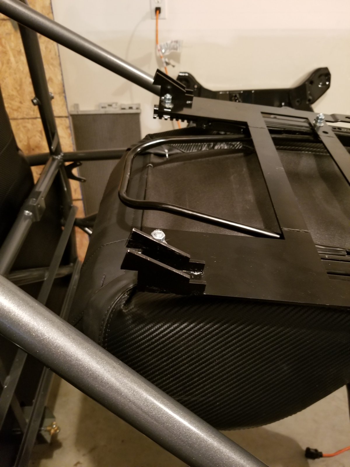

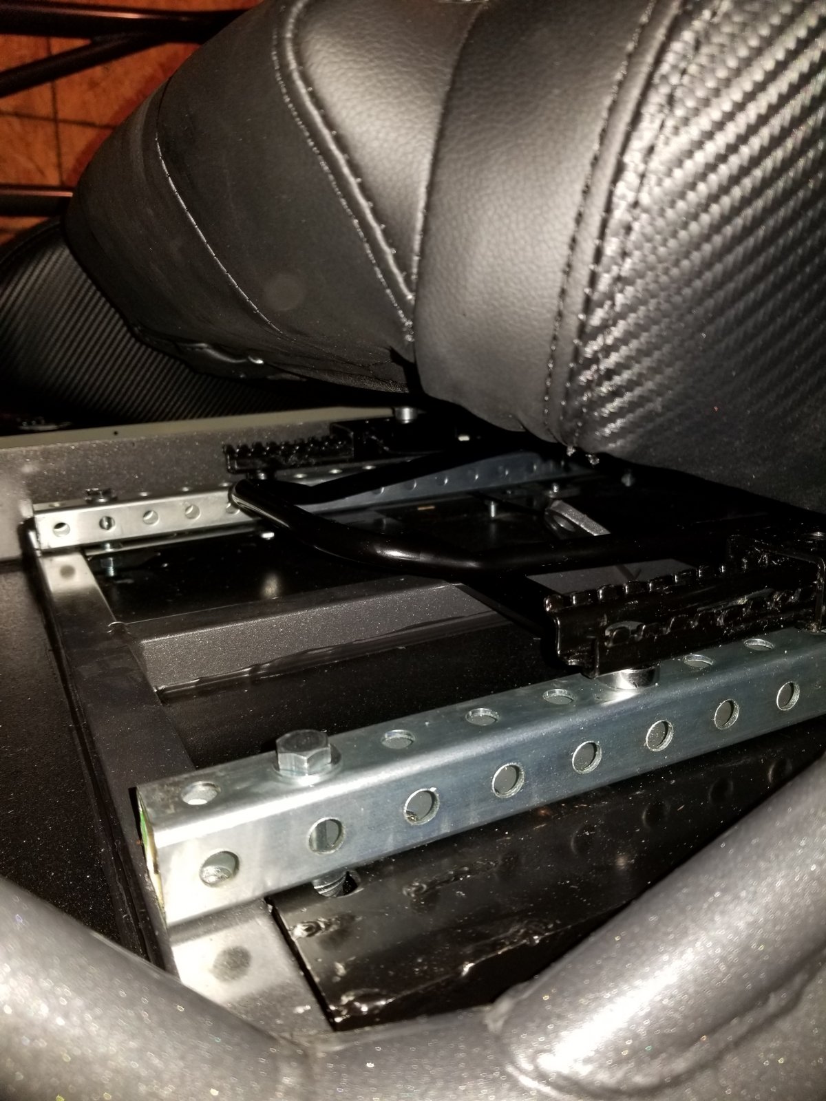

To start off with, here's a couple of images from before I did any extra work. These are just the seats with the slightly-longer sliders, and the eBay seat bracket installed. When mounted in the frame, this configuration left about 5-6 inches of open space behind the seat, and likely would have put me too far forward to properly work the pedals and/or steer, let alone get in the **** thing.

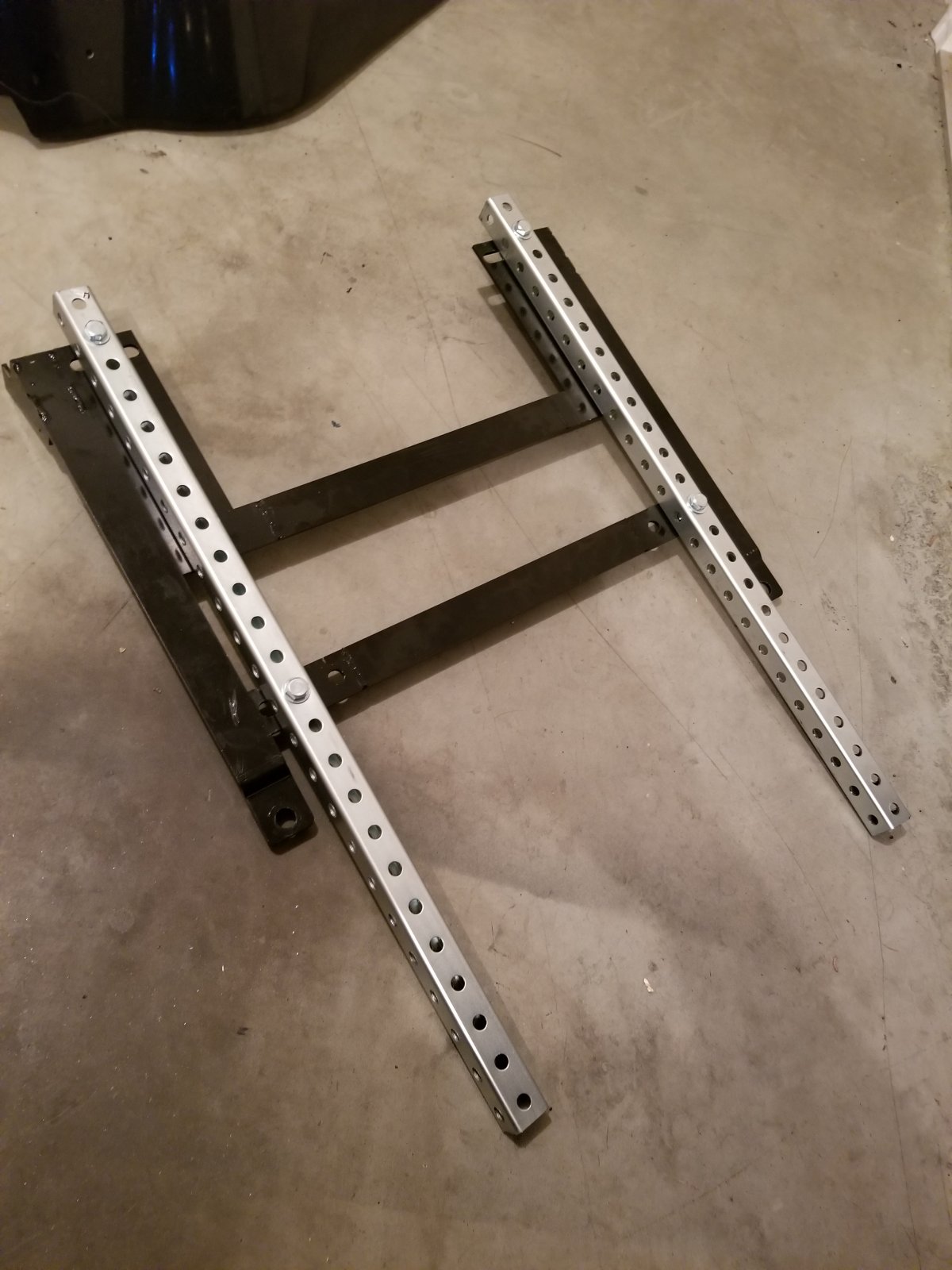

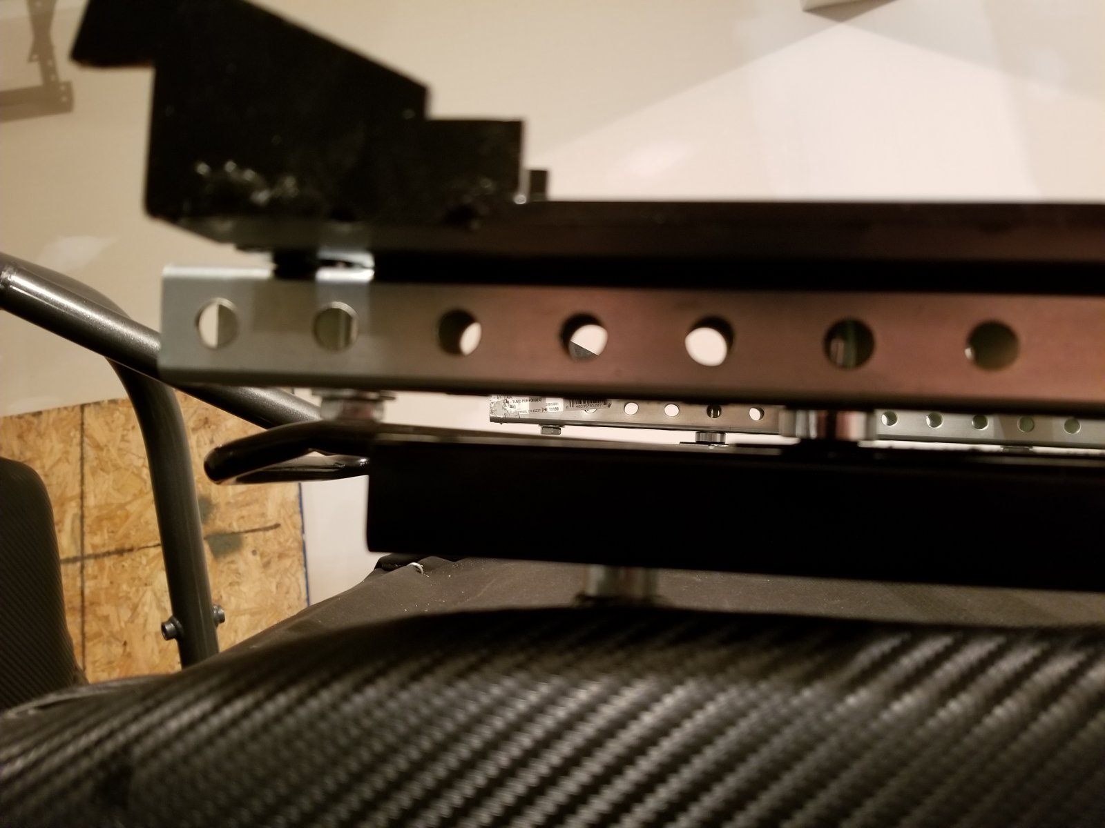

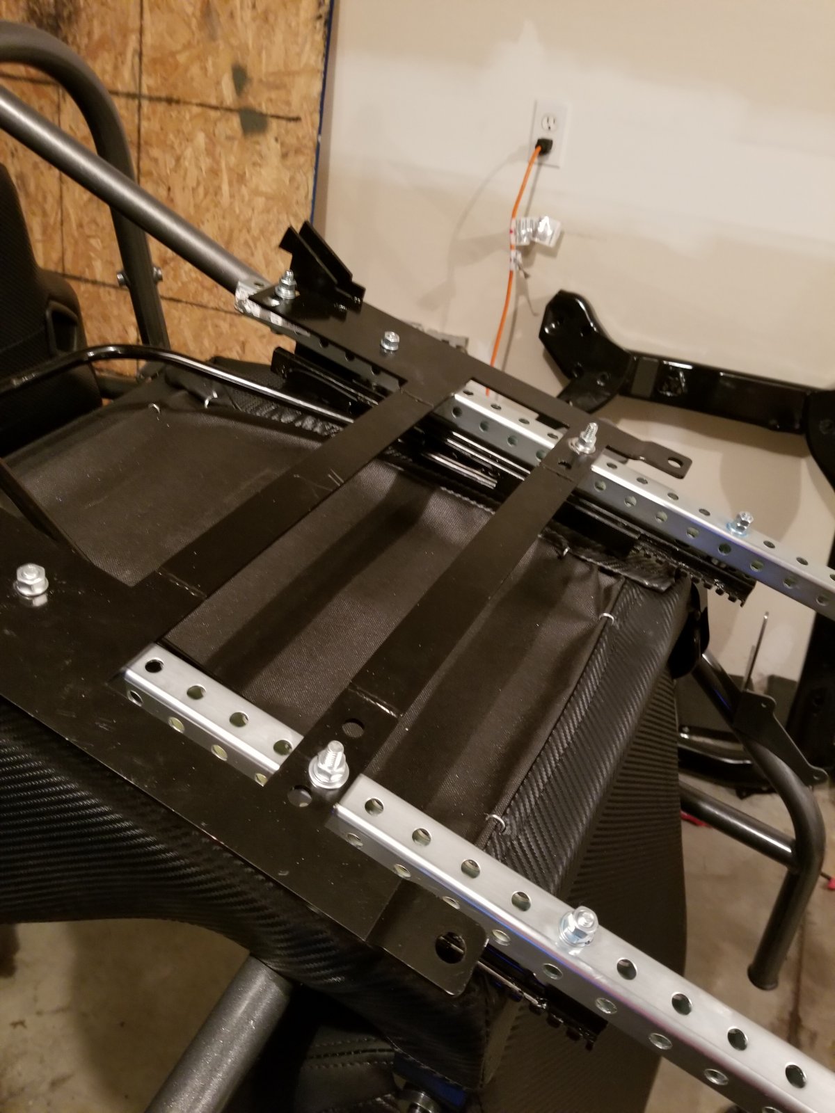

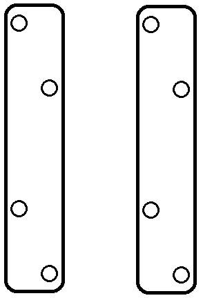

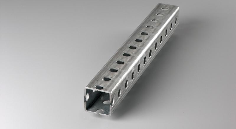

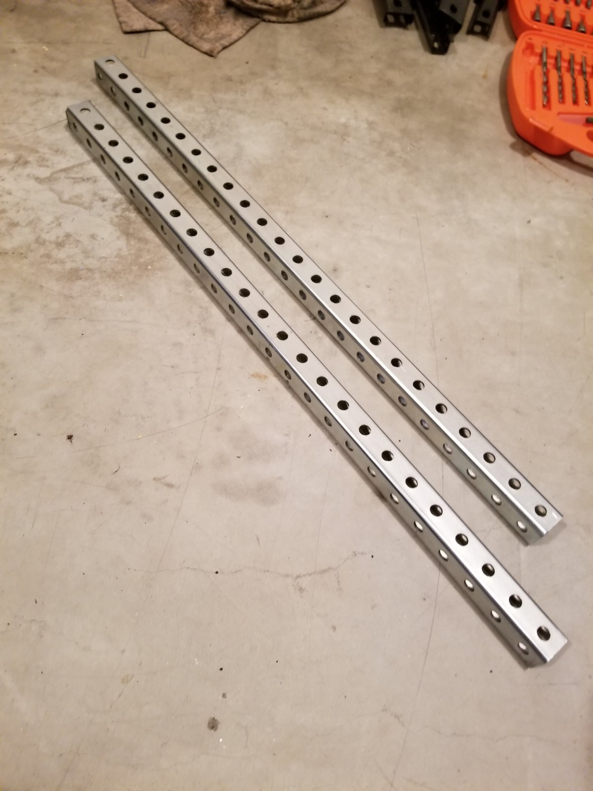

So, I "borrowed" Motoracer110's idea for a bracket modification. I purchased two 4-foot lengths of galvanized steel sign post from Amazon (1" tubes, THESE) and cut them each into two 2-foot pieces.

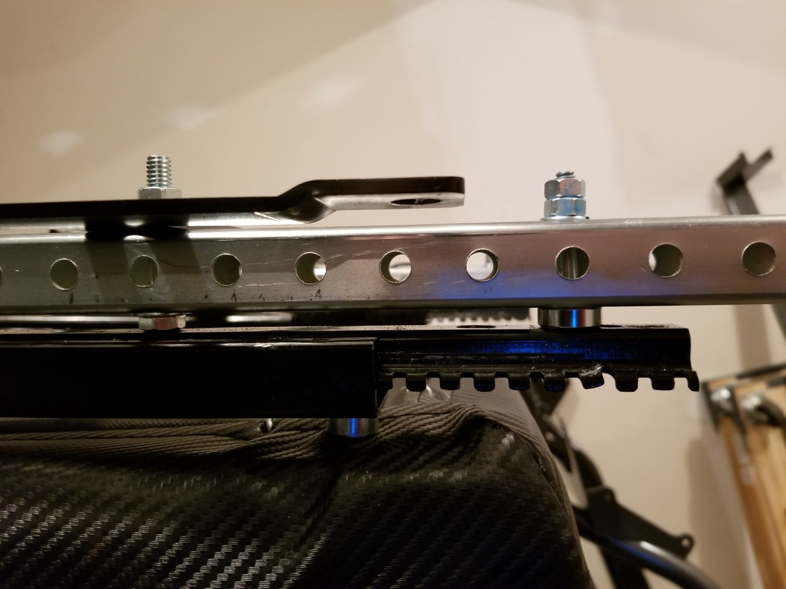

Then I drilled a pair of new holes in the eBay brackets and mounted the steel pieces to the bracket.
This assembly mounted up nicely to the seat sliders. I had to include a pair of 1/4" spacers on each side because there was a bolt head in the way.

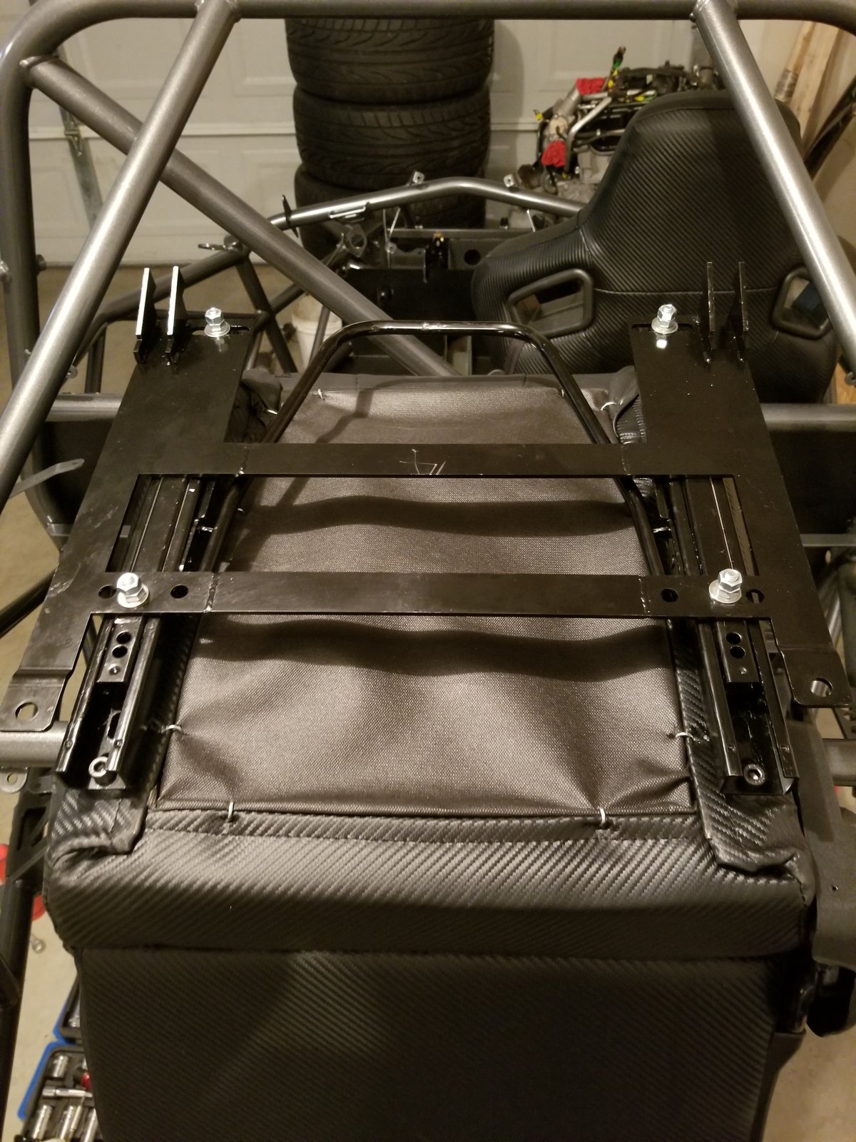

Finally, I turned the assembled seat over and mounted it in the frame. The idea here is that the steel pieces extend slightly beyond the front edge of the bracket, and rest perfectly on the crossbar of the frame. Additionally, the steel pieces extend well past the back of the bracket, and rest perfectly on the back crossbar. The fit is quite tight (though I did have to slightly bend the eBay bracket to get the steel pieces to rest on the back crossbar), so I don't think I am going to bother running bolts through the crossbars and steel pieces.
Notice there's now next to zero space between the back of the seat and the firewall.
And last but not least, here's an image comparing how the new driver's seat mounting system compares to what I had, with only the sliders and brackets.
My only regret right now is that I did not paint or powder coat the steel pieces before installing them. I used a bit of red ThreadLocker so I believe if I do anything more at all, I will just mask the frame and seats well and throw some paint on the steel pieces while they are installed.
