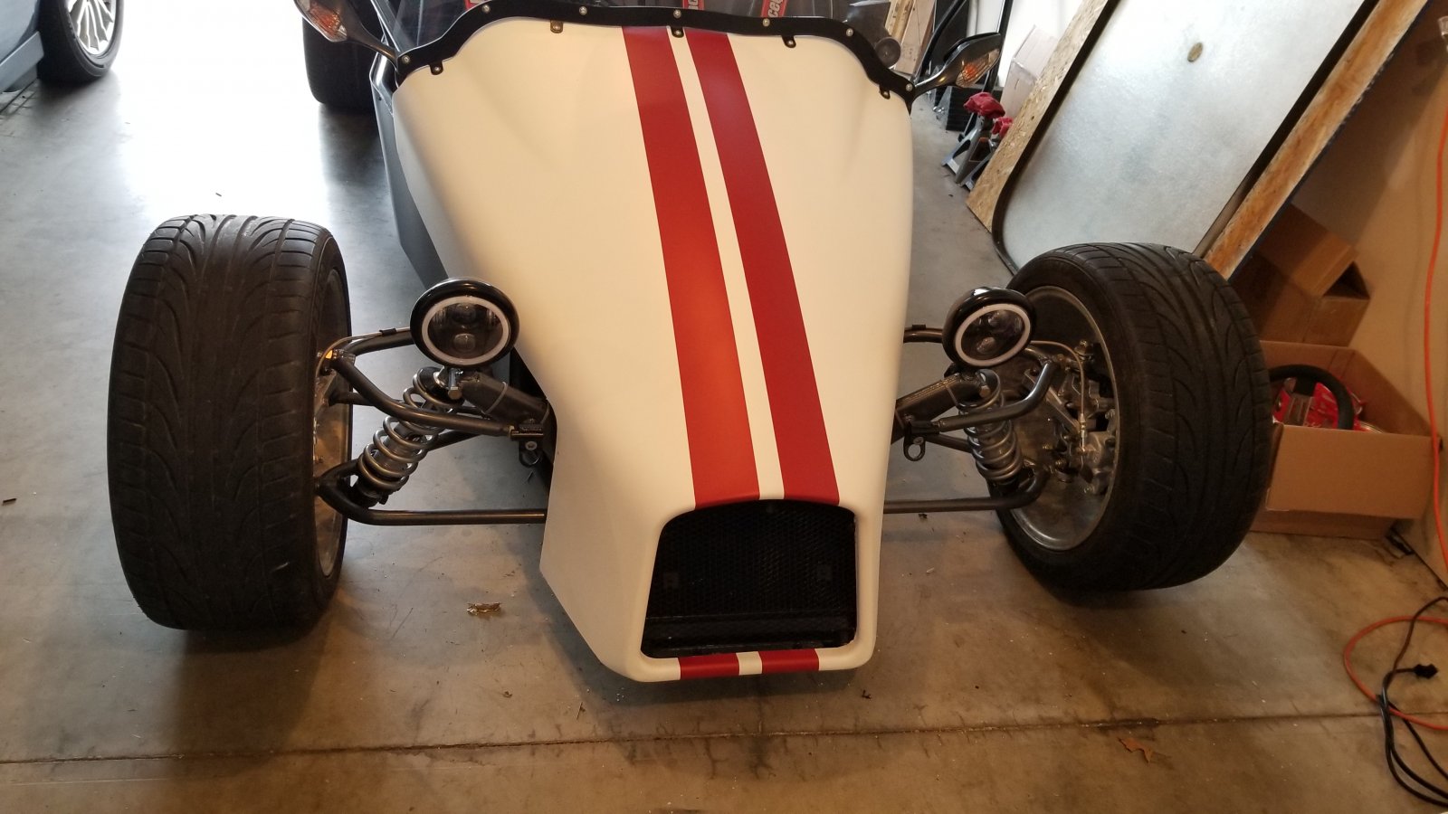

New headlights with the hood on:

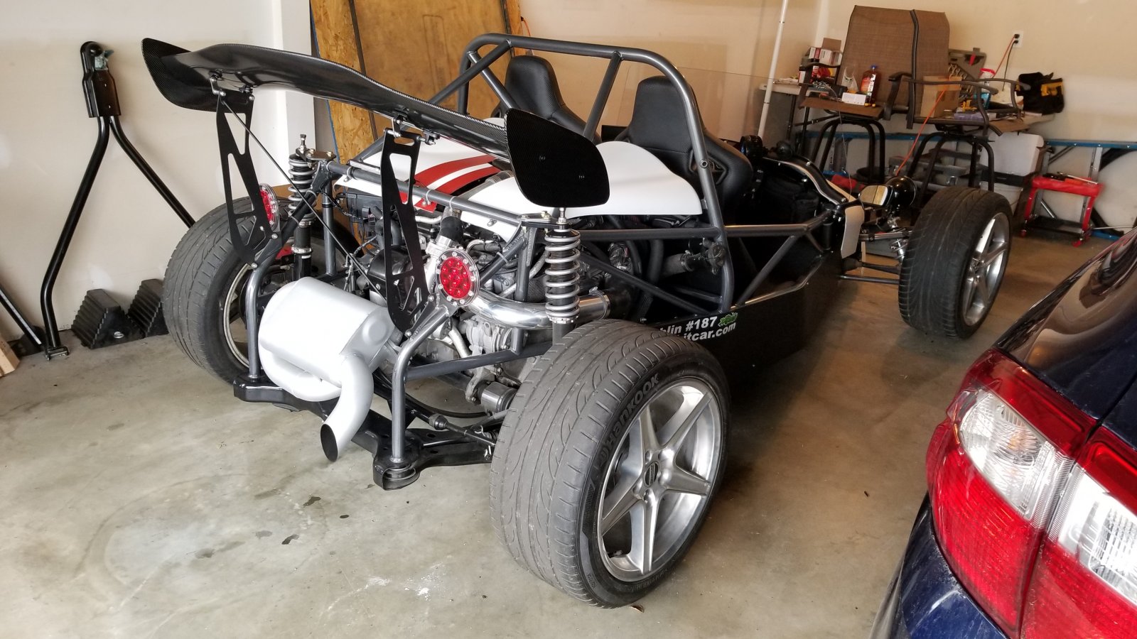

New wing:

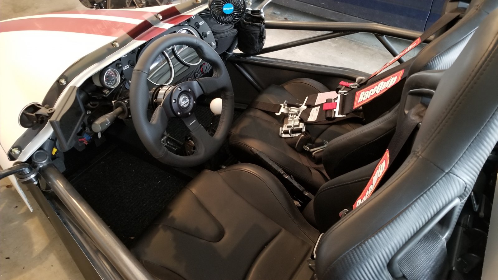

New quick-release wheel (I LOVE IT):
Which quick release and hub adapter did you go with?
pisco
Over 9000.
21154
Fozda
I feel like I overpaid for the adapter.
Quick release I picked up was the srk-400
That wheel looks great in your car and I bet it feels even better.
Which hub adapter did you get? Ark got the adapter to go from the DF supplied spline adapter but some folks like myself are getting the NRG hub adapter that goes straight from spline shaft to wheel/quick release.
Also should note that the cheap hub adapter I got needed slight modification to work with the DF-supplied spline adapter. I had to drill out the three holes slightly larger to take the bolts supplied with DF's adapter.

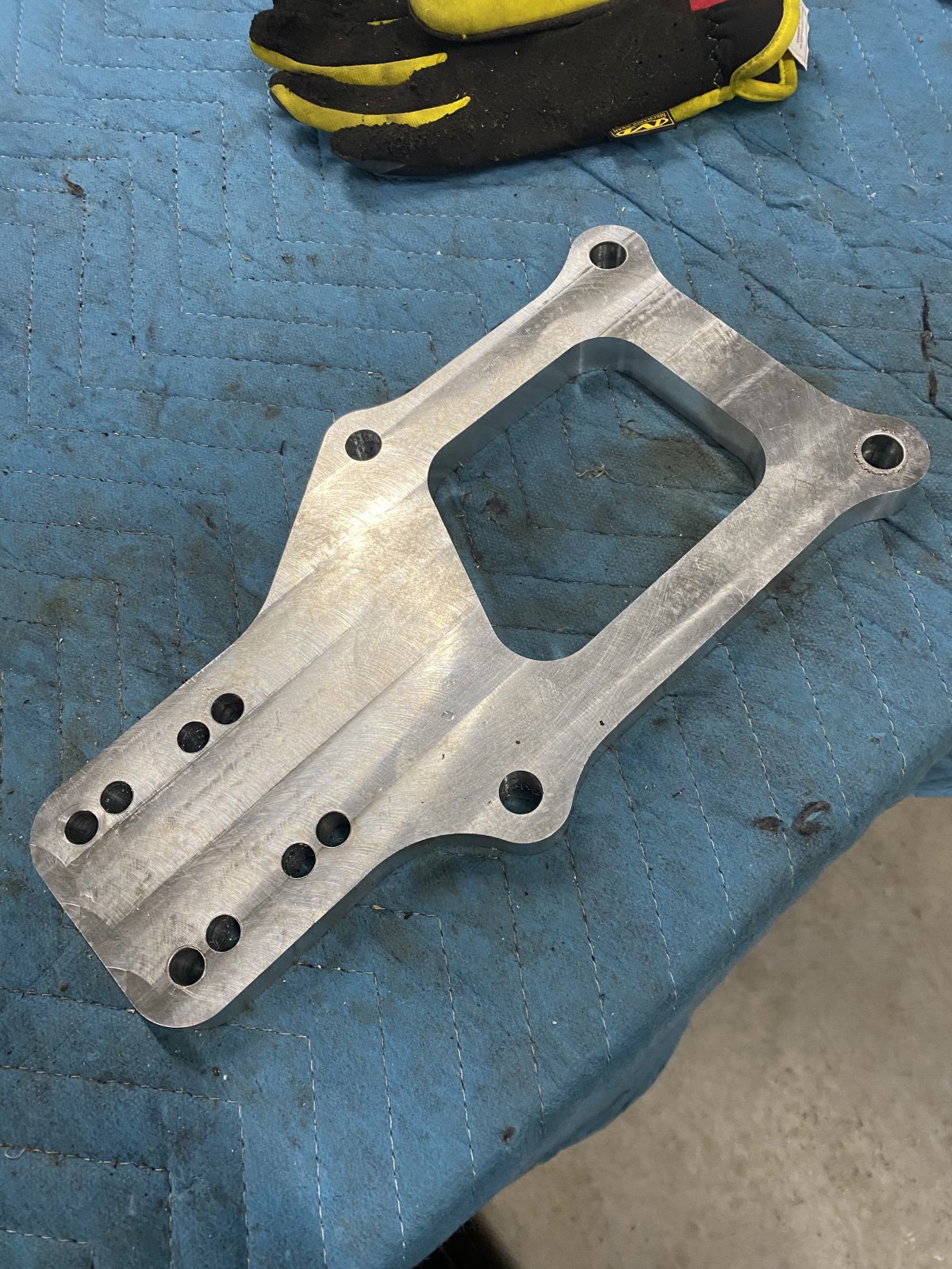

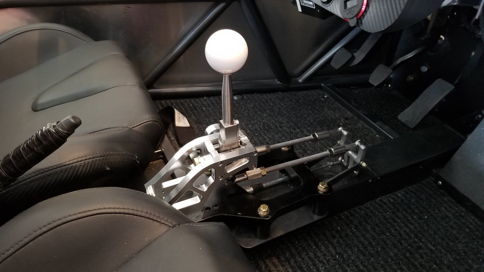

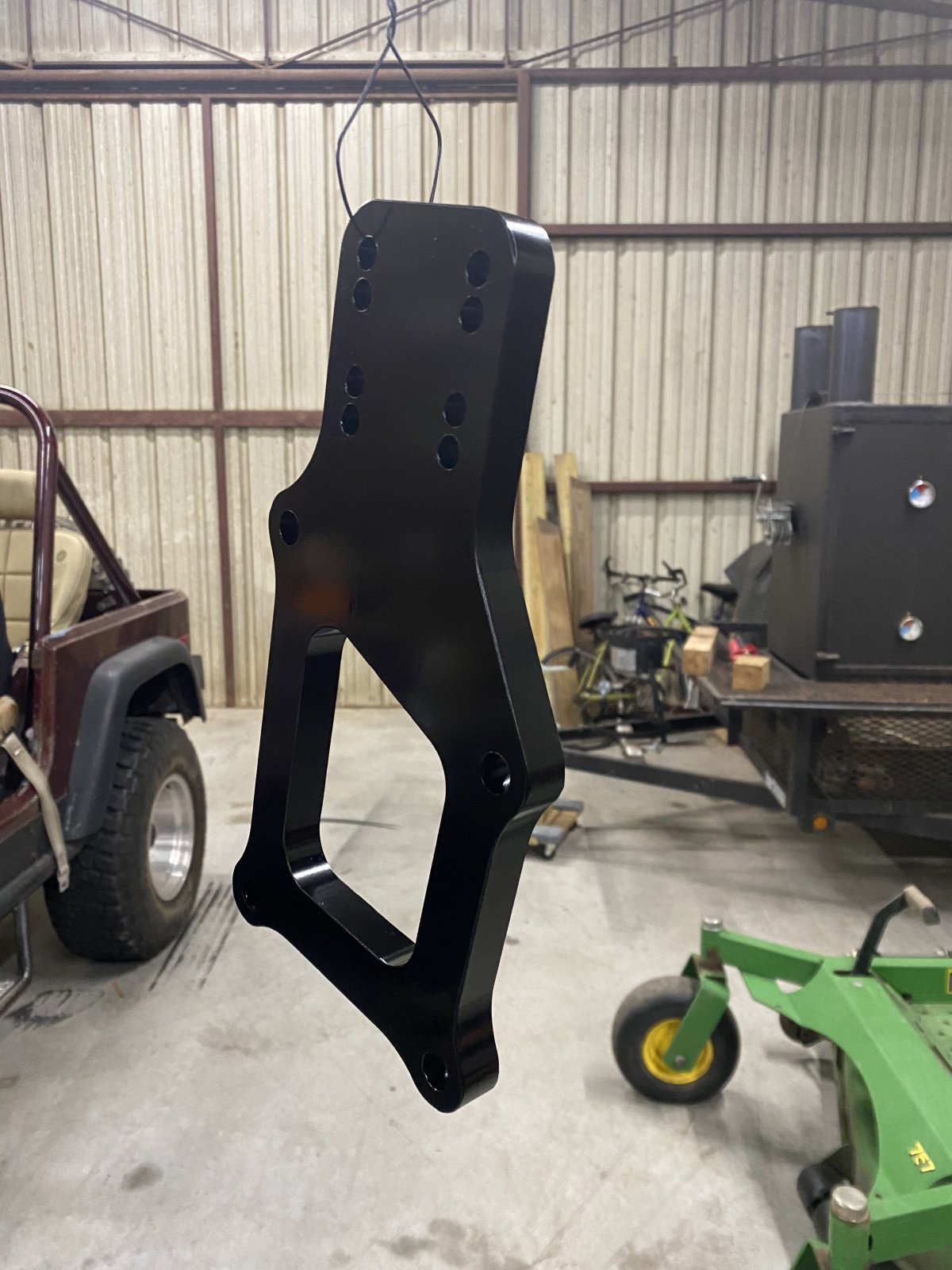

It's a beautiful, sunny spring day here, just south of Lancaster, PA, and I am still a week or so out from receiving my Montana plate/registration. I received @SACTX 's shifter upgrade and wanted to get it installed today. I did so, and it's a sizable upgrade. It'll take some getting used to (hard to tell whether I'm about to shift into 1st or 3rd, for example), but it works GREAT and it's 100x better than the stock shifter. I may need to tweak it some more, getting into 5th isn't super easy, but we'll see. Painting the base plate didn't work out too well, so I'm going to take it back out and get it blasted and powder-coated sometime soon.

It doesn’t take long to get use to it.
It’s left up, a little pressure left down, for 1 and 2. Then the awesome part is kind of a flip back up for 3. With the auto center, it’s an easy shift. Then, little flip down for 4. Then..........hunt for 5th gear like the stock one. :rolleyes: Reverse is a little tricky, but not really. A hard quick flip right and down pops it right in. :cool:
I painted mine, but I used a scuff pad on my die grinder to “scuff“ the aluminum so the paint would stick. Some steel wool or fine grit sandpaper will work, too. Anything to scuff up the smooth surface.
adding a stiff leg from the tunnel top to the frame will really make everything solid.
