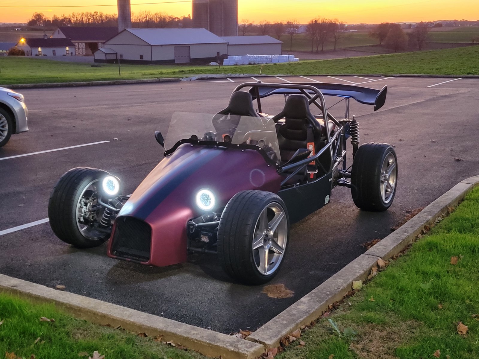

Since the sun is setting (both in this picture and on my driving season as a whole), I figured I'd bump my build log to talk about my offseason plans. I think this weekend will be the time for me to put the car up on jack stands, take the hood off, etc so I stop driving it in the cold. It was 32 degrees on my way to work this morning and that's just too cold to make it worth the drive.
Here's my laundry list:
  • Choose a different color scheme and respray the car
  • Buy into HP Tuners and install a basic tune
  • Upgrade my seats and harnesses
  • Buy and install the brake prop kit from DF
  • Buy and install a NACA duct kit
Tertiary list:
  • Pursue a keyless start system
  • Dive back into getting more data displayed while driving
Due to the fact that I need to stick to a strict budget this holiday season, I will realistically only choose two out of the five items on my main list. This car is quite literally a money pit, even though it's been completely reliable since hitting the road. Just the nature of kit cars, right?
Here's my analysis on the above lists.
Color scheme - Debating this one. I love the current scheme and it's still in nearly perfect condition, but I chose plastidip for my car in part because it's easy to change it up. I was considering going with something glossy or color-shifty this time around, with a dark green or dark blue base and powder coating of the wheels to either matte black or semi-gloss black. ¯\_(ツ)_/¯
Buy into HP Tuners - I've wanted to do this for a while, but my mind keeps going back to the fact that I am 100% fine with the performance of the car as-is, and I don't want to introduce anything that could cause problems with the car. But who doesn't want more performance, ya know? I have a basic tune file that should put me up near 300 hp with new MAP sensors being the only required purchase, aside from HP Tuners and the credits.
Upgrade seats/harnesses - My seats are eBay cheapos, but they're very comfortable and I've no good reason to replace them, aside from the drool-worthiness of some of the Braum seats. My harnesses though, I've never been fully happy with. Guest riders cannot figure out how to get themselves buckled in and they're very wide ... and I'd probably go with cam-lock 4-points instead of 5's.
Brake prop kit - this, in my opinion, is a must-have and is almost definitely going to be one of the two upgrades I pick up.
NACA ducts - I never cared for the look of the NACA duct kit, but it's grown on me a bit and I rather like the look when the inlets are mounted behind the fiberglass, rather than in front of it. I'm also mildly concerned about my turbo temps ... is there any definitive info out there of the efficiency/superiority of the ducts vs. the fan? I asked DF but the response I got was only about how hot air heats the tunnel and to seal it off with expanding foam, which isn't what I inquired about. Thoughts?
Keyless start - Wanted to do it long ago, stopped caring because the keys in the ignition don't bother me. But I am out of projects so I thought about bringing this back out. I need to rebuild my proof-of-concept breadboard again, only this time, run it off a battery or somehow measure the power drain so I know if it's feasible to keep an ESP32 running full-time, and if it's not feasible, I need to measure how long it takes to boot. I don't want to throw a switch in the car, then have to wait 60 seconds to start it.
More data display - still on my radar, but very low priority. Literally everything else on this list will come first, most likely.
Anyway .... thoughts are always welcome from my fellow Goblineers.
