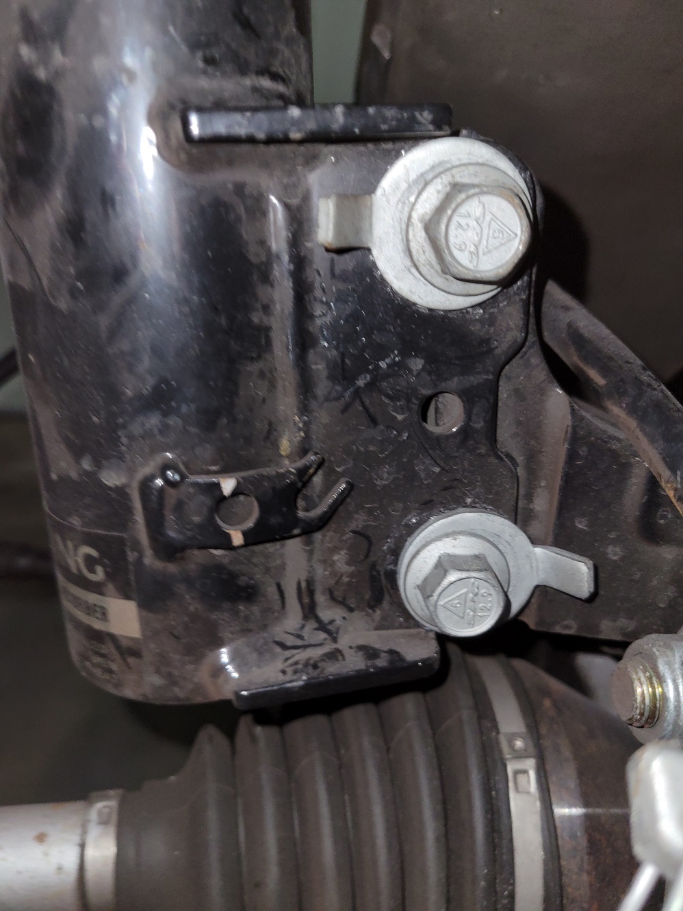

Reworked my alignment recently. My rear tires were showing some uneven wear, so I put in a second set of camber bolts on each side and now both sides are really close to -.5 degrees. I also rechecked the toe in the back and I think I had some minor crabwalking going on. Fixed that (double, triple, quadruple checked with toe plates, etc) then redid the front alignment as well because redoing the back knocked my steering rack off-center. I think I am just going to find a shop willing to do a professional alignment, and be done with it.

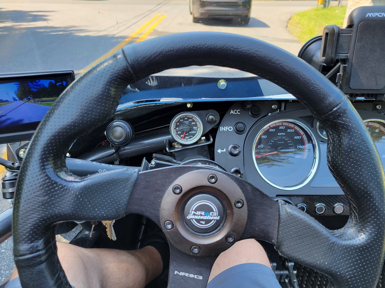

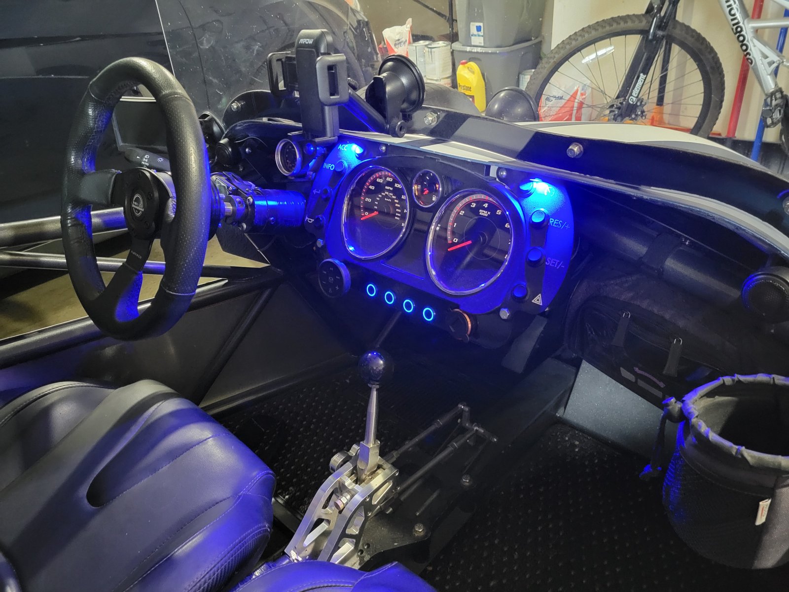

Last but not least, I changed out my dash buttons and lighting to better match my current color scheme. I like it.
