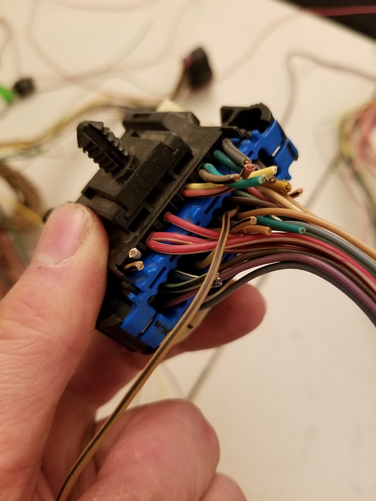

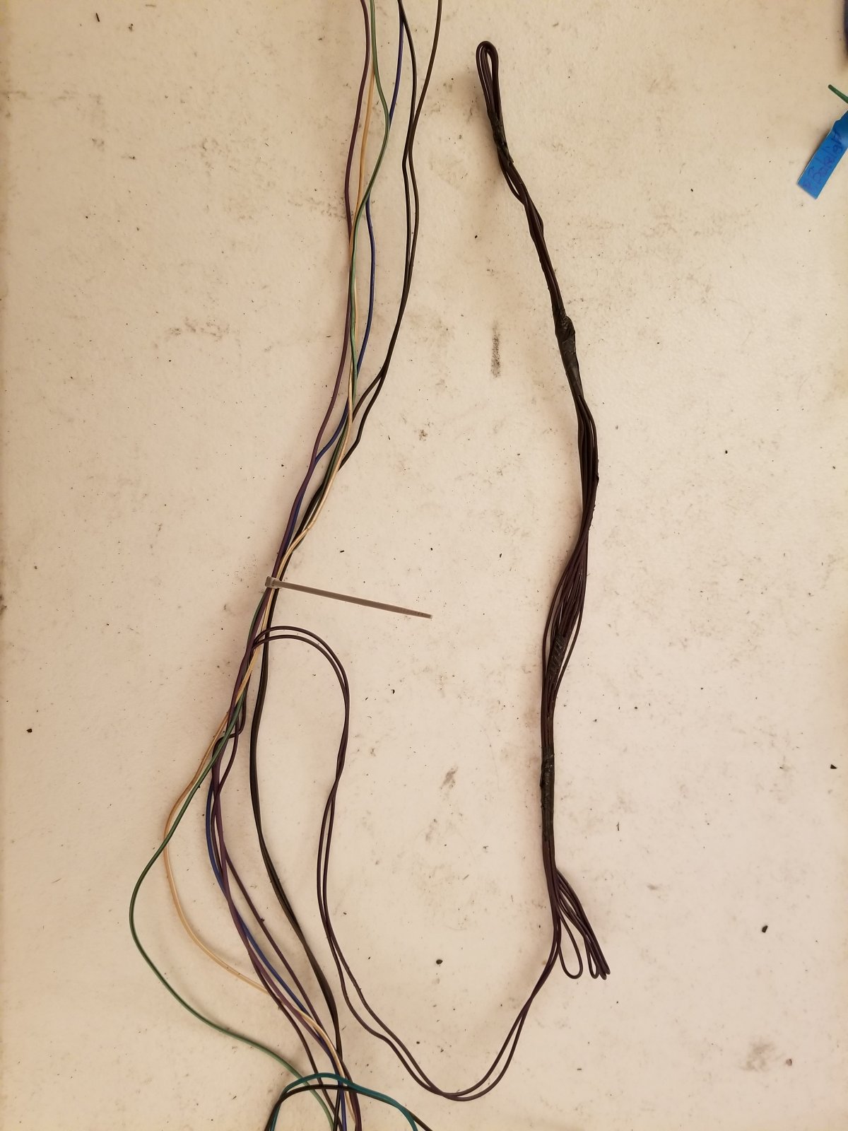

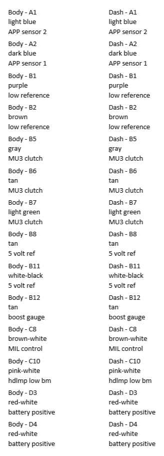

I'm finding to ground lugs are a bit different on my harness, too. I was planning to run my own larger-gauge ground wire regardless, but I'm finding all the ground wires to be a bit confusing. Some go to sensor connectors or other connectors, and some go to the fuse block. Tough to tell what's what.
