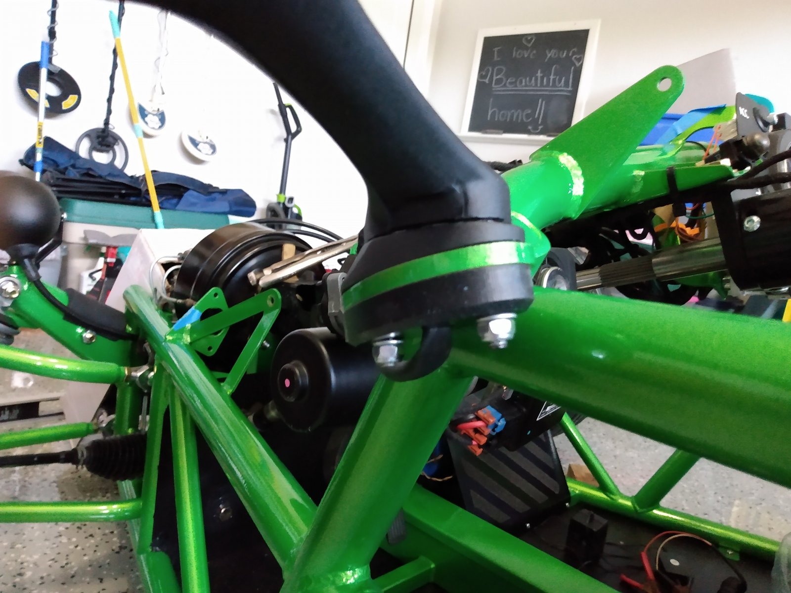

The side mirrors go: Mirror>chassis>3D printed adapter>washer>nut.
Lndshrk Steve

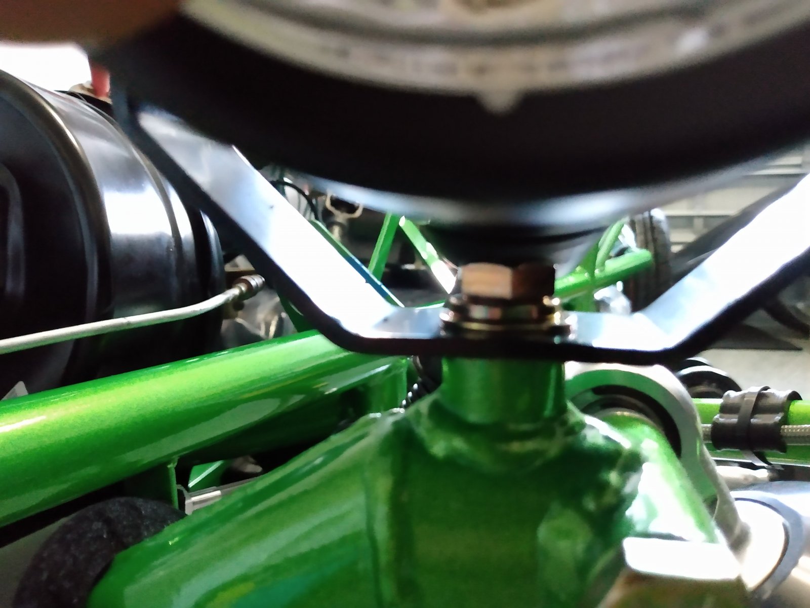

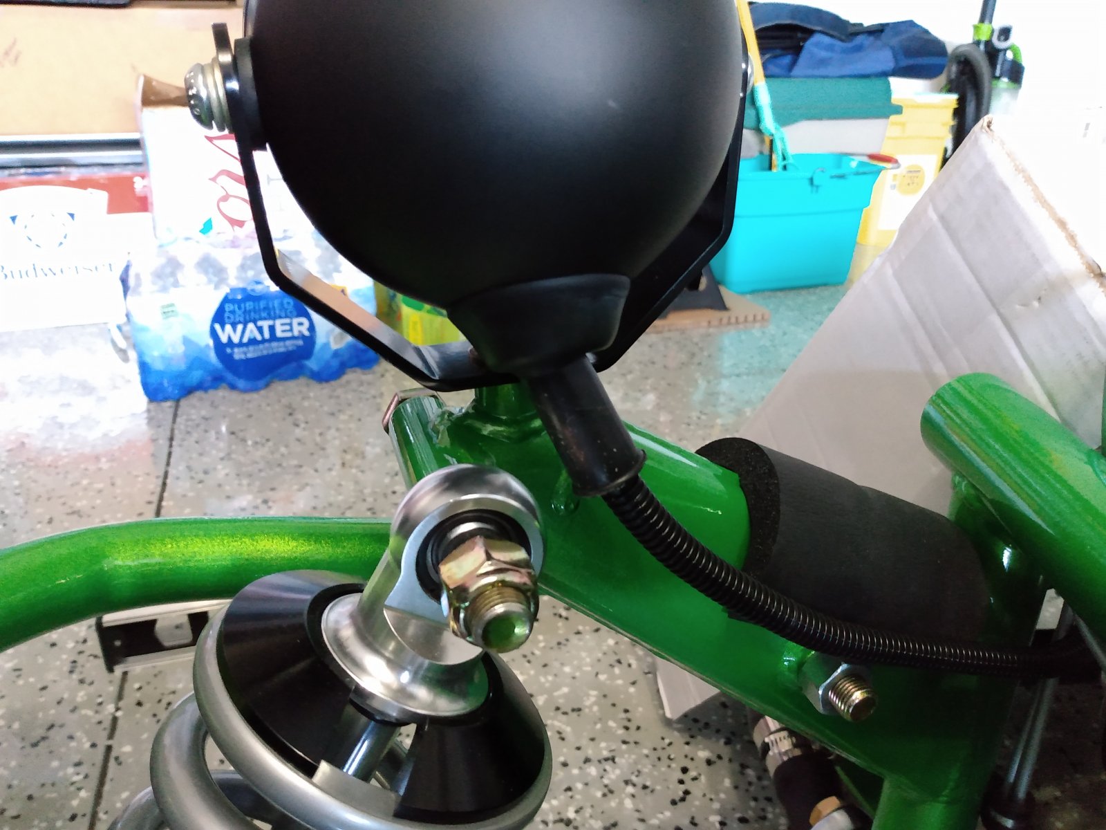

Here are some close ups. I used the positive battery cable grommet at the firewall to plug the hole in the bottom of the headlights. Had to get a second one at the junk yard but it worked great.
On the headlights I used bracket, washer, lock washer and bolt.
There is a left and right base on the mirrors. Just play with them until the shape looks right.

Hope this helps.
