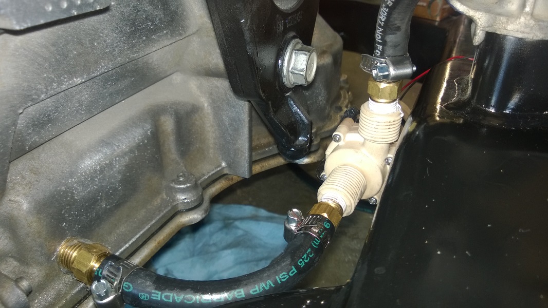

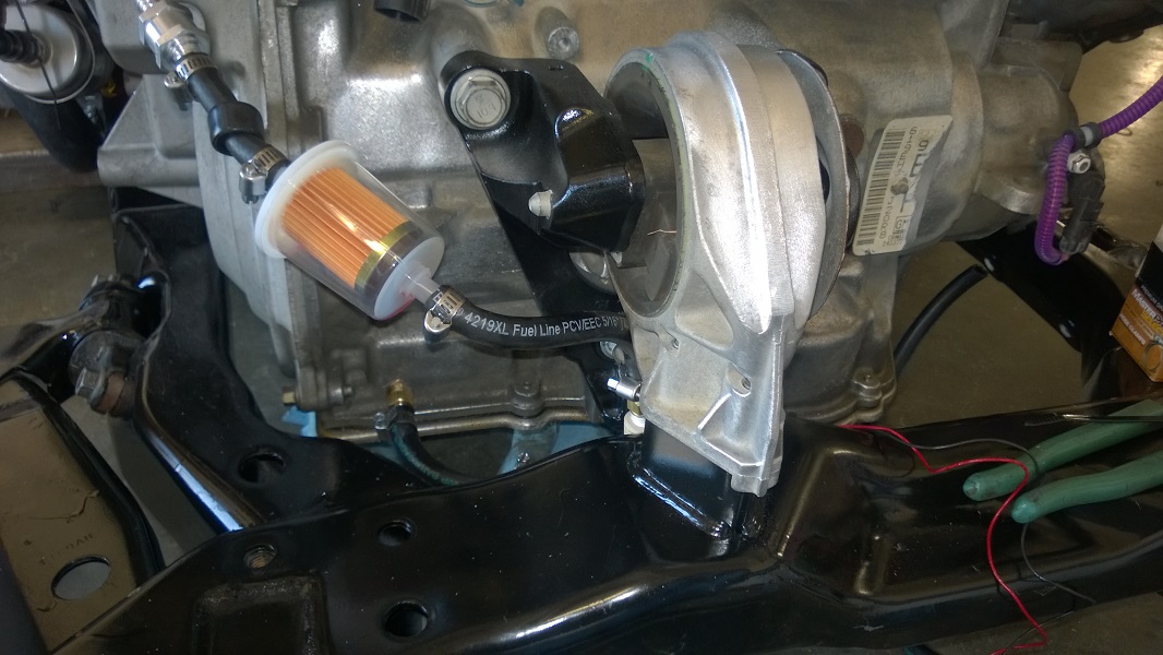

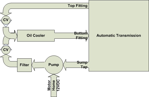

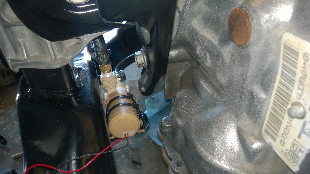

I added a 12 VDC pump that will get power from the motorhome while traveling. I tapped the AT sump to feed the pump well below the oil line. The pump is a centrifugal unit and it will not pull well so I wanted to insure that the pump was fed. I doubt that it pump much volume but it will be enough to keep some oil lubing the input end of the trans. I added a filter (the sump oil I will pull is not filtered). Then two check valves, one from the my pump and one from the transmission pump. Either of the two lines feed the oil cooler. There was really no need to cool the oil during towing but I figured it would do no harm. Then the feed to the bottom oil line in the transmission. In the transmission this feed what is called "lube 1" which is the front end of the transmission.

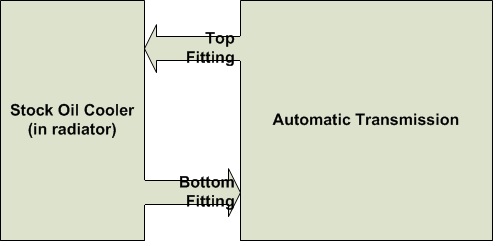

Stock Cobalt Diagram:
Dan's Diagram:
Sump tap, filter and new pump check valve:
Sump Tap Enlarged and Oil Pump:
Oil Pump (back view)
Dan's Diagram:
