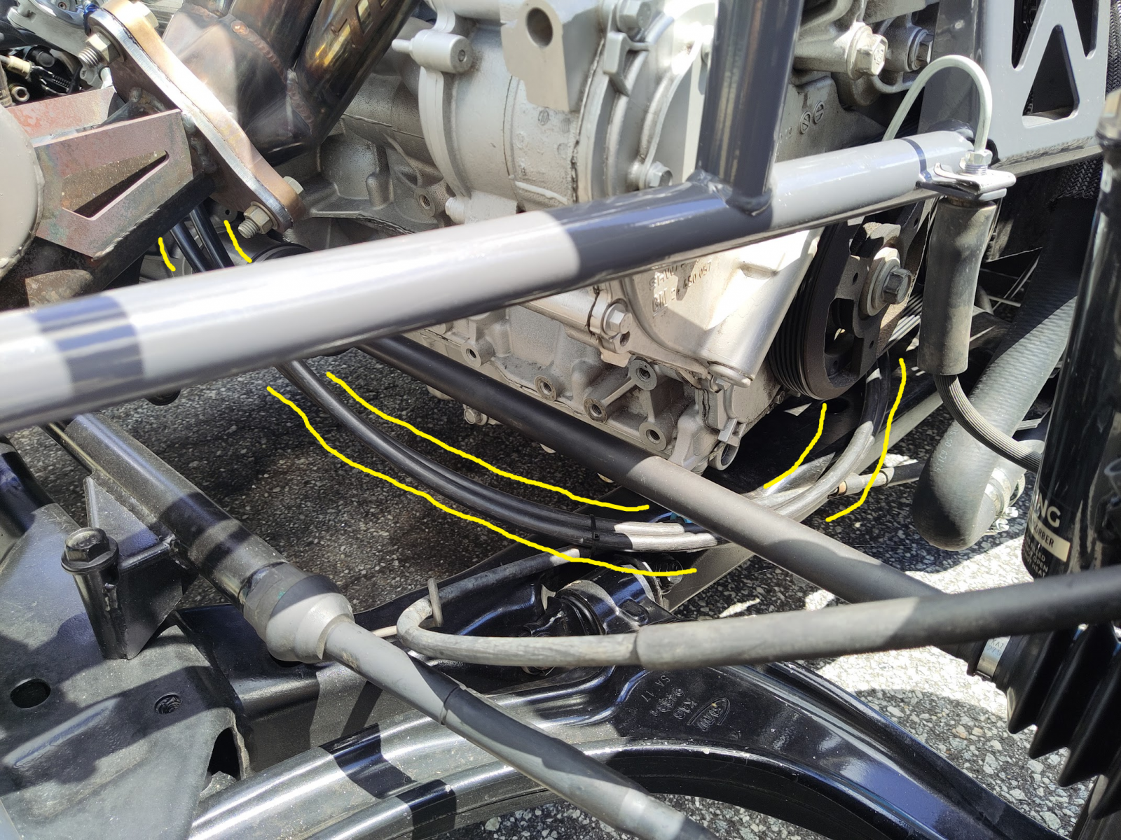

I have the billet shifter from DF as well. I routed mine after it exits the rear of the tunnel to the passenger side of the engine cradle and made a large bend over to the trans. It tucked up nicely to the cradle and I secured it with a couple of zip ties to keep it from bouncing.
The shifter cables will actually stay in this position on their own pretty well, but the ziptie right above the leading control arm bushing just keeps the shifter cables off the exhaust from road bumps. They're tied to the parking brake cable.
34254

How close are those to the axle? They look like they are rubbing against it. Probably just an optical illusion, but that wouldn't be good...

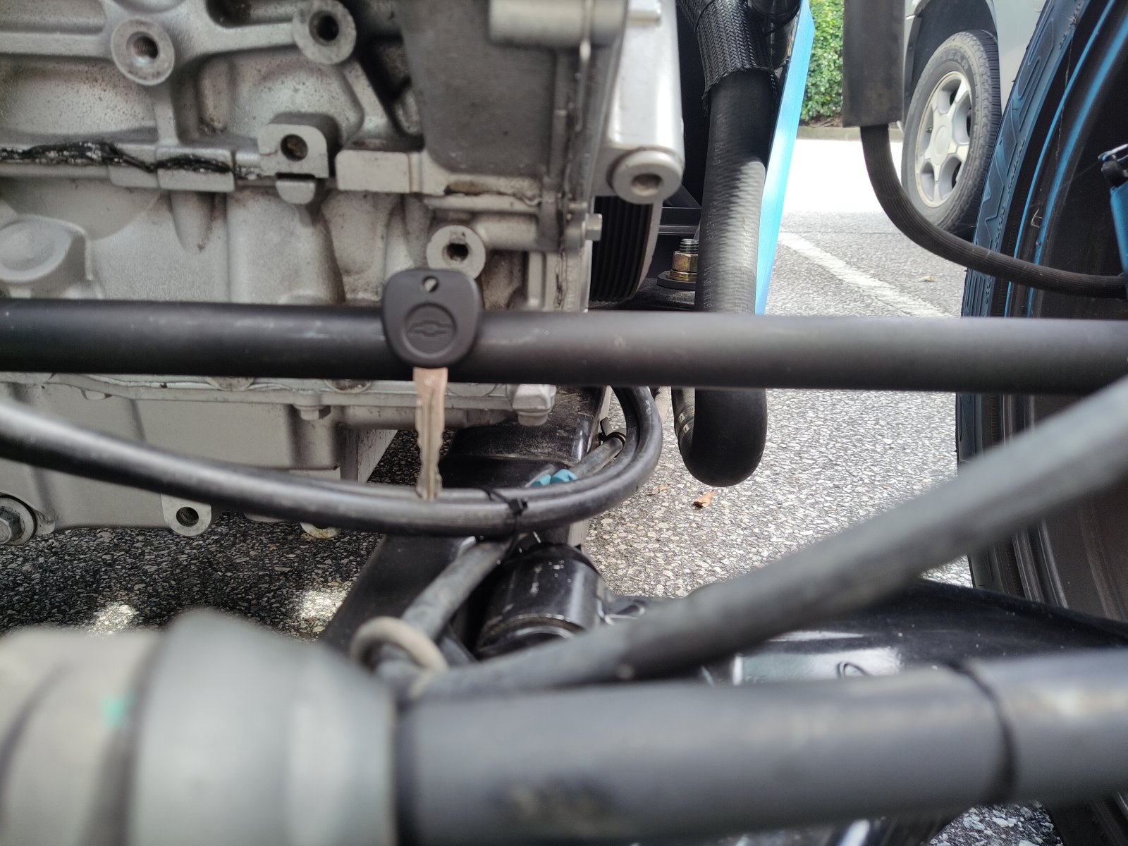

There's a least a finger's clearance at full suspension droop (rear end in the air). Keep in mind also this is an F23 with the long axle straight from the trans output to the passenger side hub, so if you have an F35 with the intermediate shaft there should be even more clearance here.
34259

It must be an optical illusion in the first picture... It doesn't look like anywhere near that much space!
