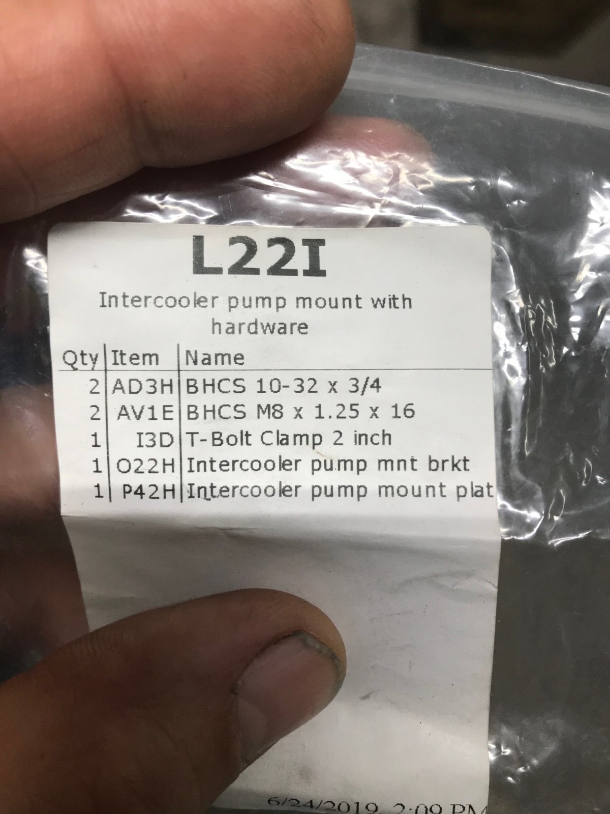

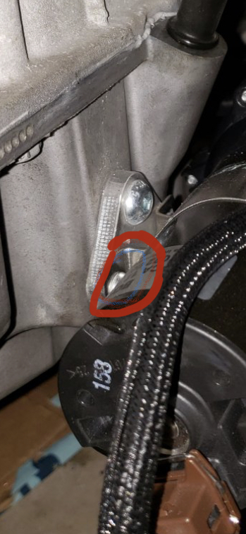

Anyone know the size and thread pitch of this bolt circled below? I forgot to grab one for reference before I left the house today and was hoping someone might know to save me from going home then back out lol. It seems like the ones supplied to me were to long and hit the oil pan. Thanks!

I had to cut my down about 3/8" so it would not hit on the oil sump. 2009 SS TC. Not sure what year you are working with, but as cheap as the bolts are, you might want to pick up another pair a little shorter than supplied in the kit. :)
