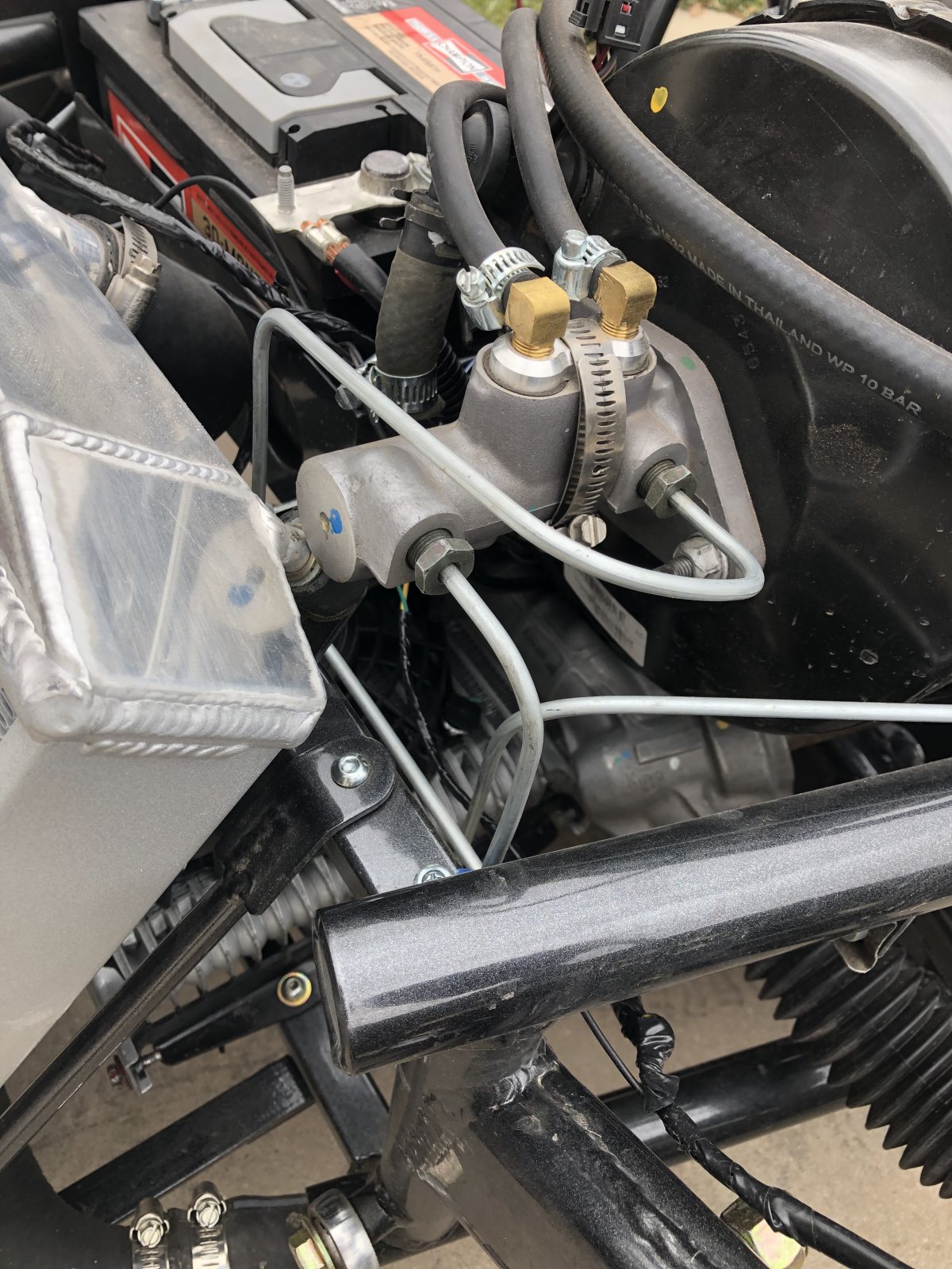

I thought I read somewhere on here that spacers are required in order to get some of the newer master cylinders to clear the cap less radiators but by looking at the setup I cannot figure it out.. any help? I removed my spacer in between the booster and pedal box but this is causing my brakes to constantly be applied so I need to find about 1/2 in

Add a couple washers under the aft/upper pedal box support and the pedal box. See Lonny's reply to my thread where I had the same problem:
Christopher Sanchez
Thank you for that! I will try that now but it’s hard to see being able to gain enough clearance. I hope it works! Did your booster have an 1/2 in aluminum spacer also?

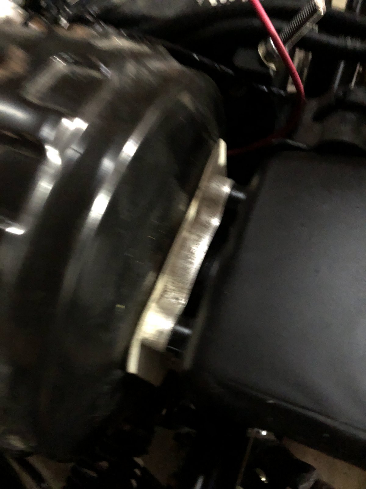

I still don't have much clearance. I ended up placing a dab of silicone caulk between master cylinder and radiator to try and damp out vibrations some. Can't remember which master I ended up going with, but I may have also shaved a smidge of material off the end.
I'm using the late model master/booster like you are, and I do have the 1/2" spacer installed - blurry pic attached.
