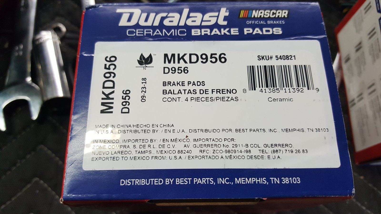

I believe it is fronts all the way around. At least on my non SS it is that way.So I walked into AZ with extreme confidence on what I needed as far as brake pads. He asked for the year/make/model, and I told him exactly what they were. No problem. Then he asked me the dreaded question of "front or rear?" and I locked up. I had no idea how to respond to that complex question. I was truly confounded.
Does the kit use front pads all the way around, rear all the way around, or a mix of front/rear?
Yep for the rear now with the emergency/ parking brake calipers you will need rear pads from the Solstice. The previous post were made before DF released the parking brakes.I have solstice brakes on the rear (to accommodate the emergency brakes). My stock brake pads off my 2006 Cobalt SS don't fit.

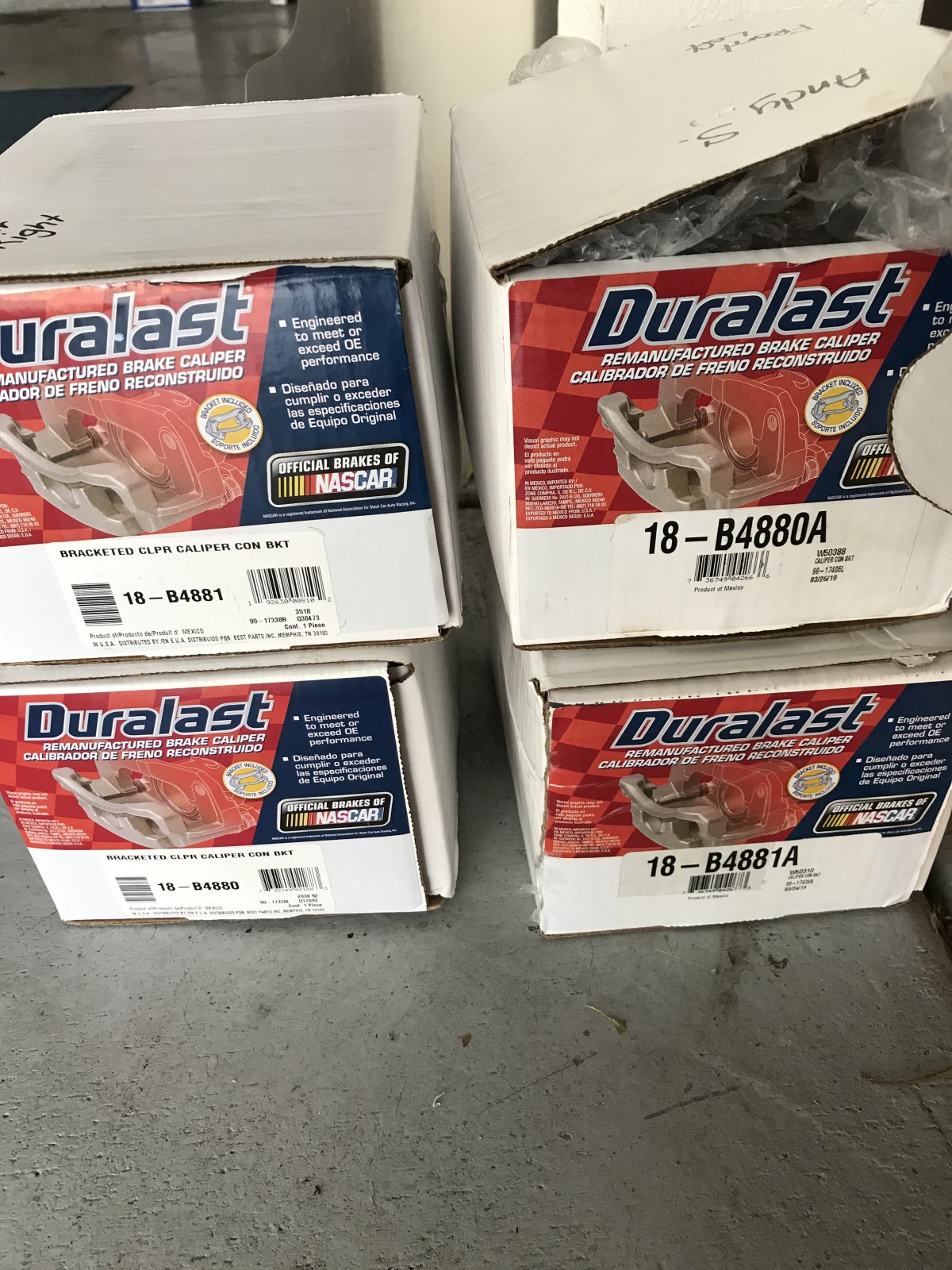

18-B5050 is the rear drivers side brake caliper for a 2006-09 Pontiac Solstice.
18-B5051 is the rear passenger side brake caliper for a 2006-09 Pontiac Solstice.
18-B4880A is the front driver side brake caliper for a 2007-10 Chevy Cobalt (base 2.2 liter engine)
18-B4881A is the front passenger side brake caliper for a 2007-10 Chevy Cobalt (base 2.2 liter engine)
