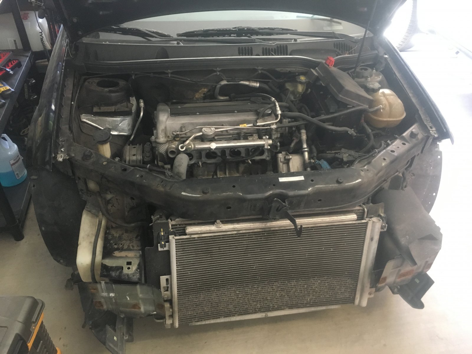

For my donor, I decided to go with....wait. I haven't decided yet. I am picking up donor # 1, a part out G85 2006 LSJ tomorrow ($300). Owner has already sold the wheels, hubs, intake, blower, and intercooler. Engine has a bad rod knock, according to him.

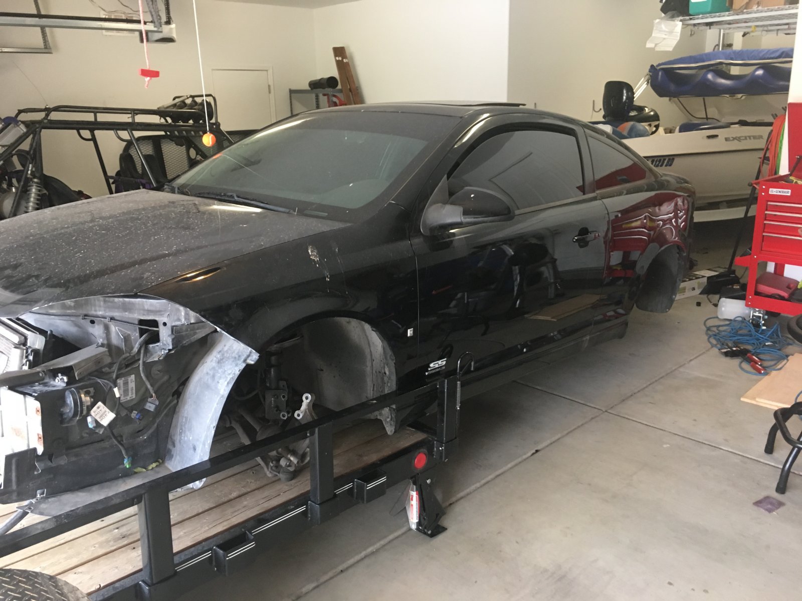

I am driving 120 miles tomorrow to pick up my hub/wheel-less donor. I have devised a creative plan to get it on and off of my trailer.

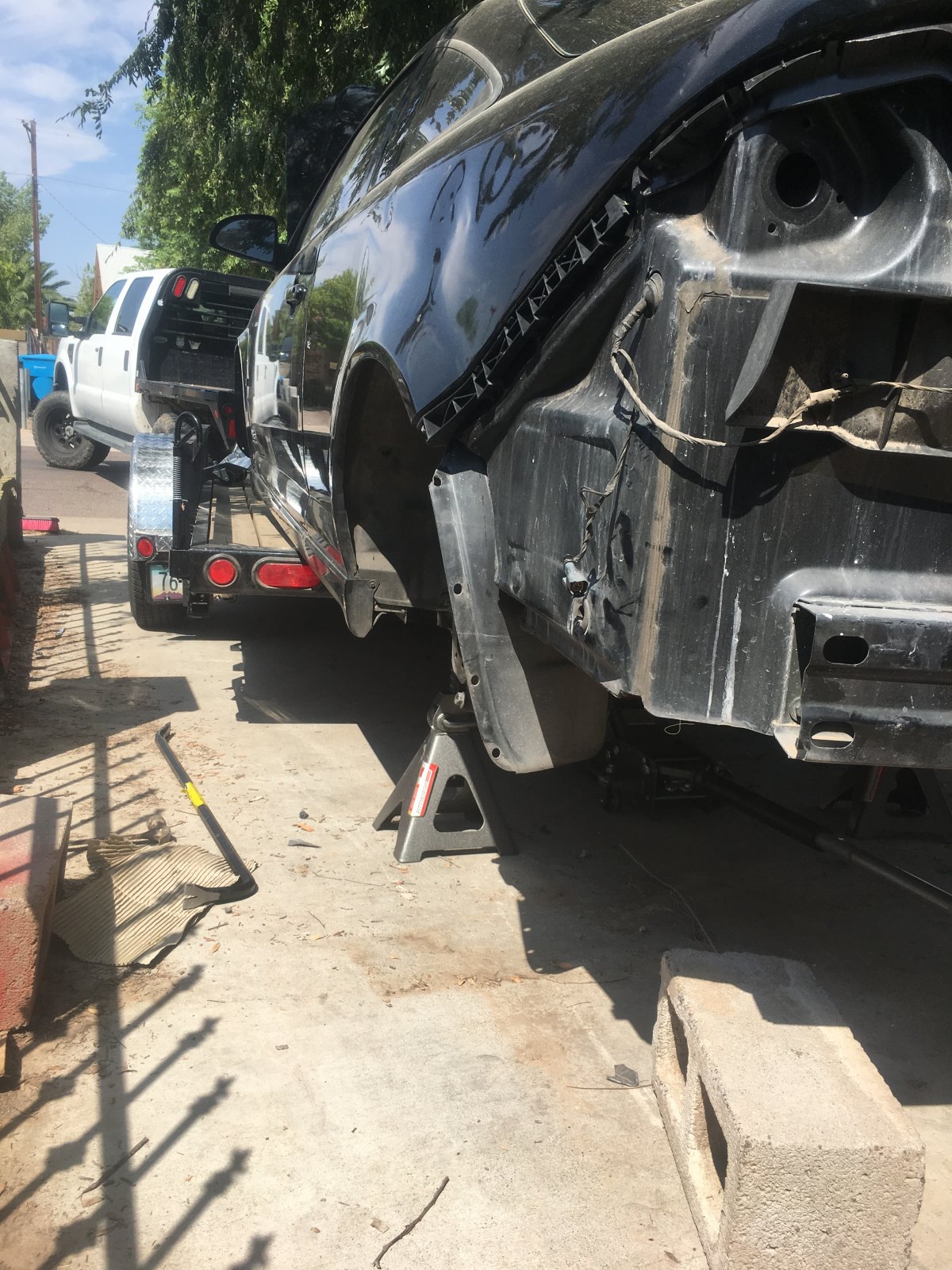

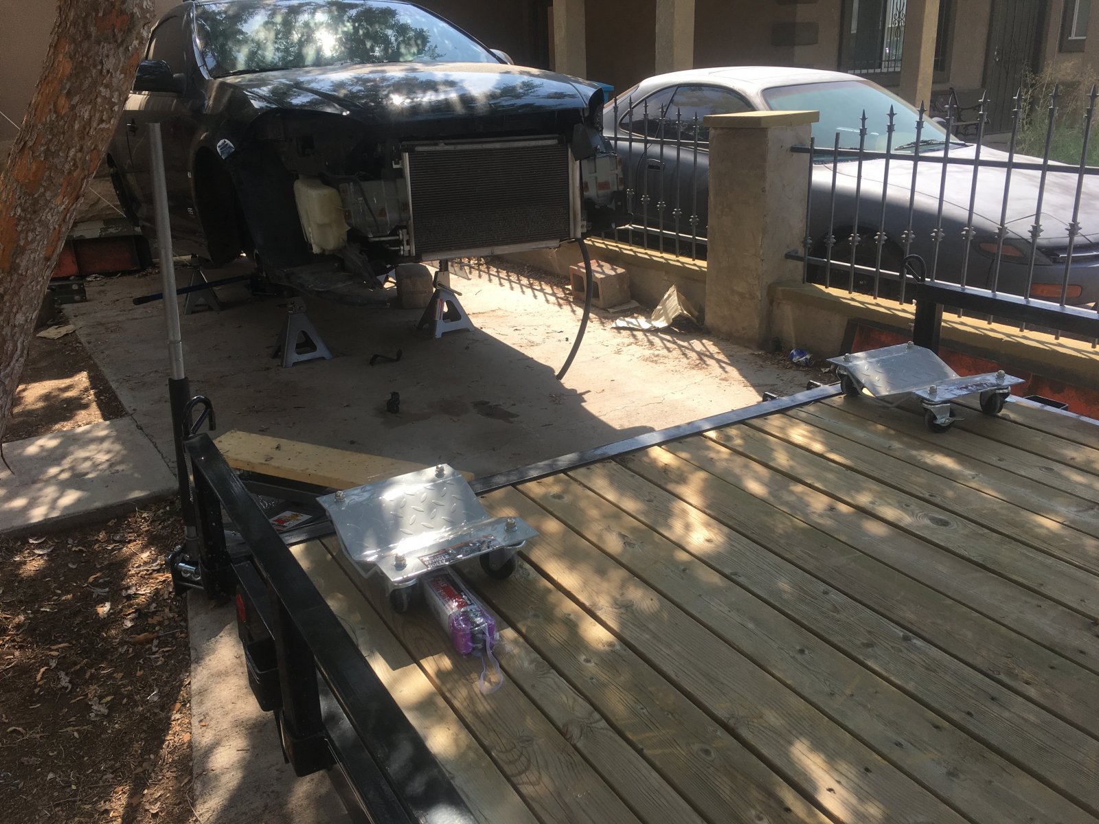

Brian74

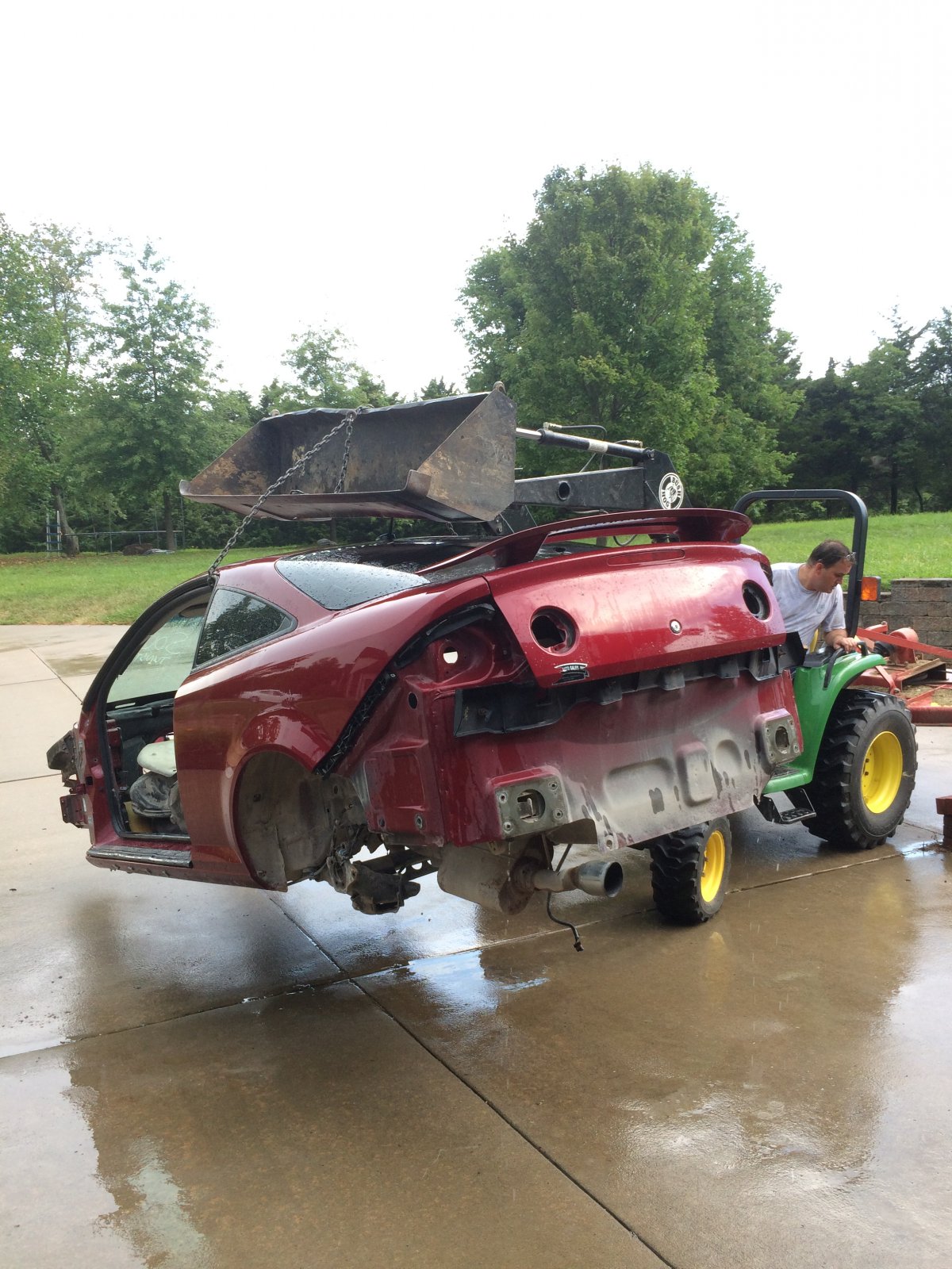

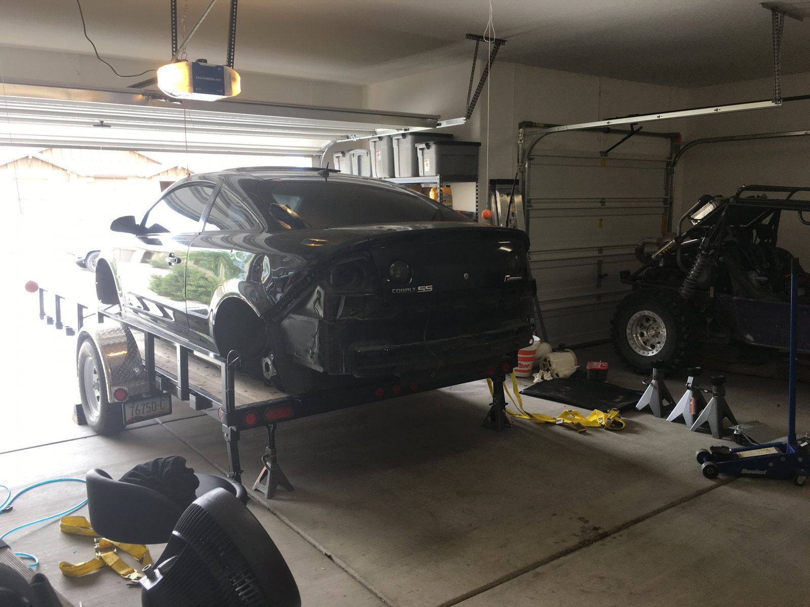

Wasn't too bad. Had to get creative with jacks and dollies.
Balphamore
Yeap I have to agree. Looks like you had a interesting time getting that on the trailer. If osha happened to peek in. Think they would be pulling their hair out lol.. Looks like the fun part begins.
Johvans
I did the same thing when I got rid of my shell... o_O
It worked and was more stable than I would've thought! :D
Nice. That's exactly what I used too. Right down to the Deere compact utility and a brush hog as a counter weight. :) That looks like a 2 or 3 family. I'm surprised it could lift it.
4200 HST. Scrappy little bastard it is! Lifting wasn't a problem but lifting it over the rails on the side of the trailer and placing it without destroying the rails was a bit of fun.
Brian74
It wasn't too bad at all. I used a $37 2 ton hand winch from Harbor Freight that kept the car in place going on and coming off. The rest was just slight trailer angle and jack adjustments. I was probably being way more careful than I needed to be.

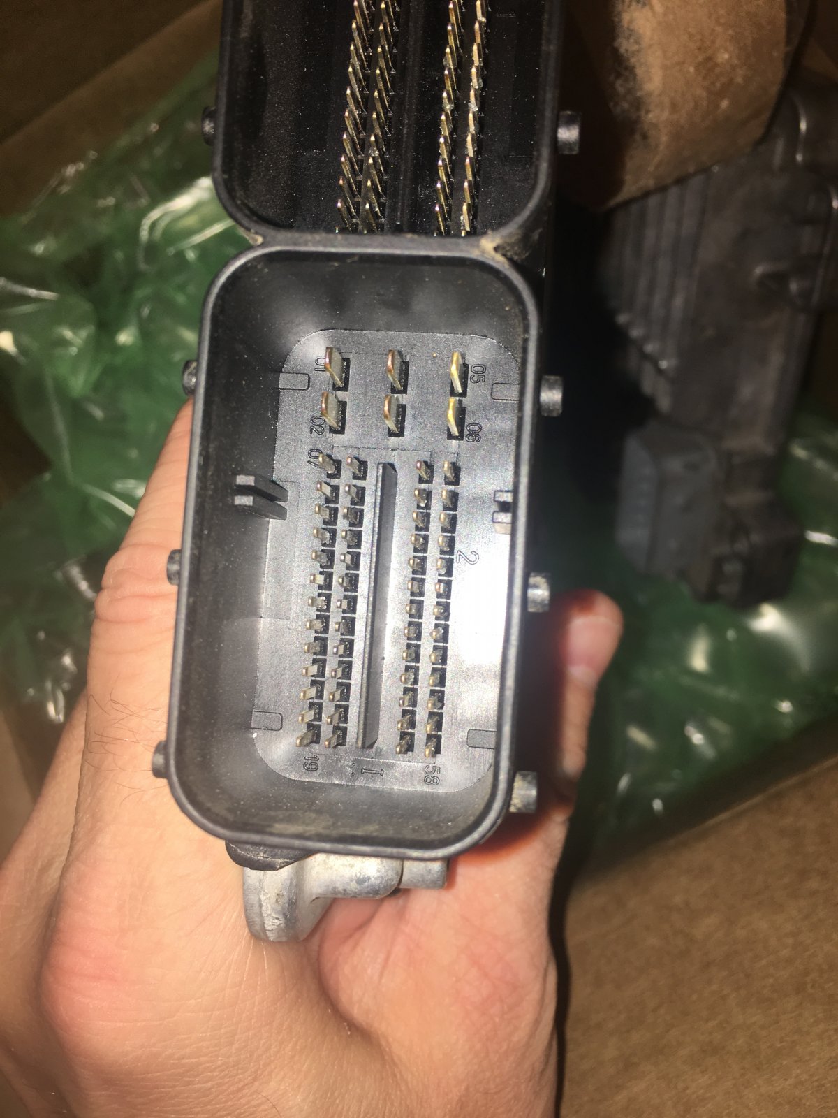

Brian74

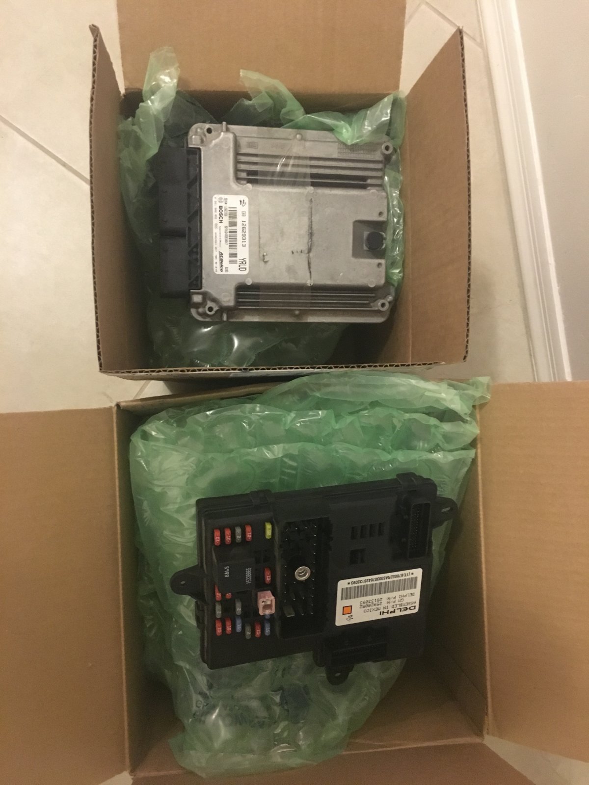

From what I can tell after more reading, VATS cannot be disabled on the E69 PCM. I went to LKQ and picked up a VIN matching PCM and BCM from an HHR SS for $100. This should allow me to do a key relearn and keep the VATS. I plan to start with the factory tune so I can complete the engine break-in and test everything.
HP tuners has come a pretty long way with the Bosch ECM over the years. Like I said earlier, I am not looking to do much over the factory tune. This car will be more than enough just shy of 300 hp.

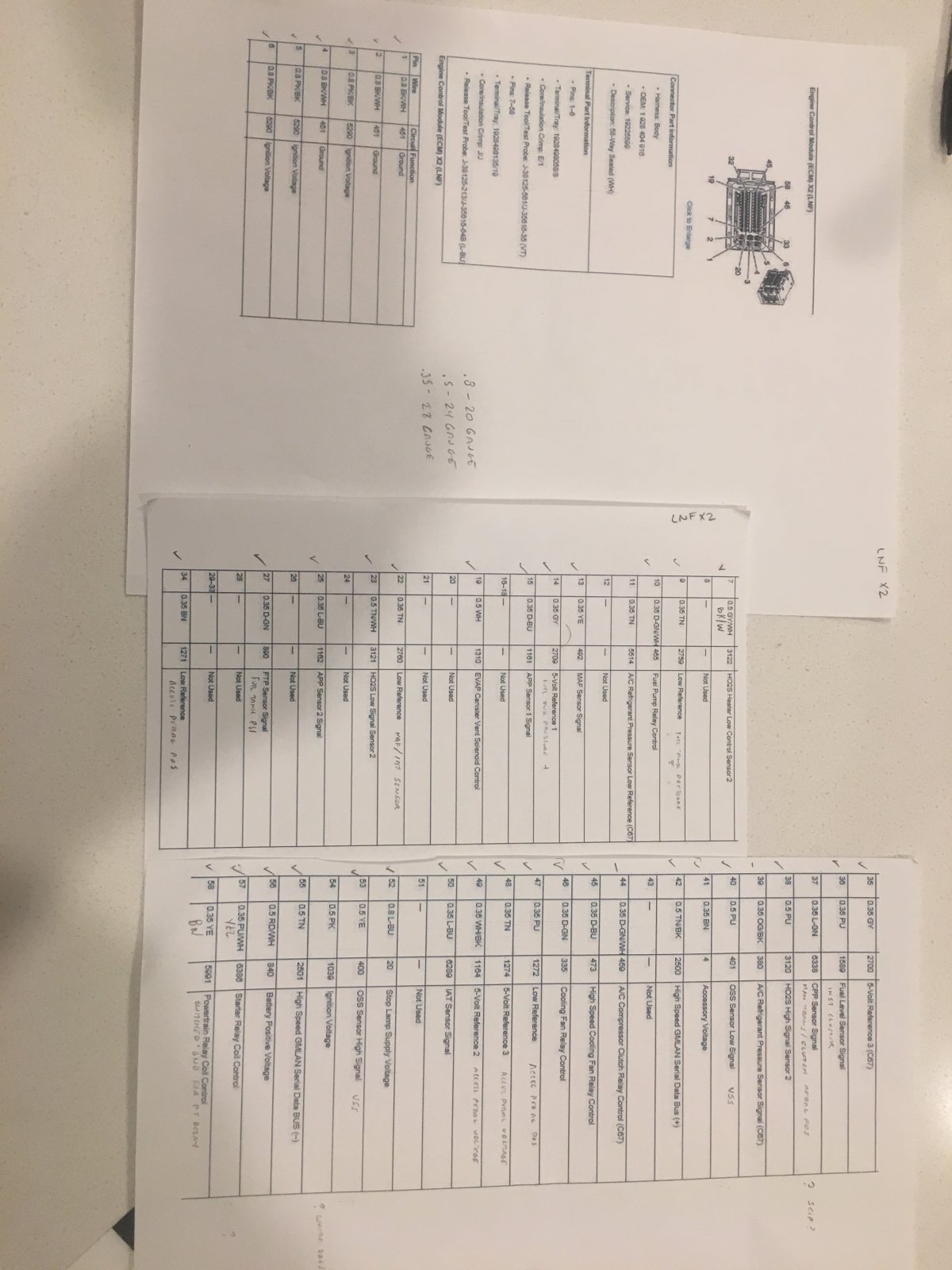

Brian74
BCM and PCM arrived today. They are both off the same 2009 Cobalt SS, which I am hoping will make things easier.

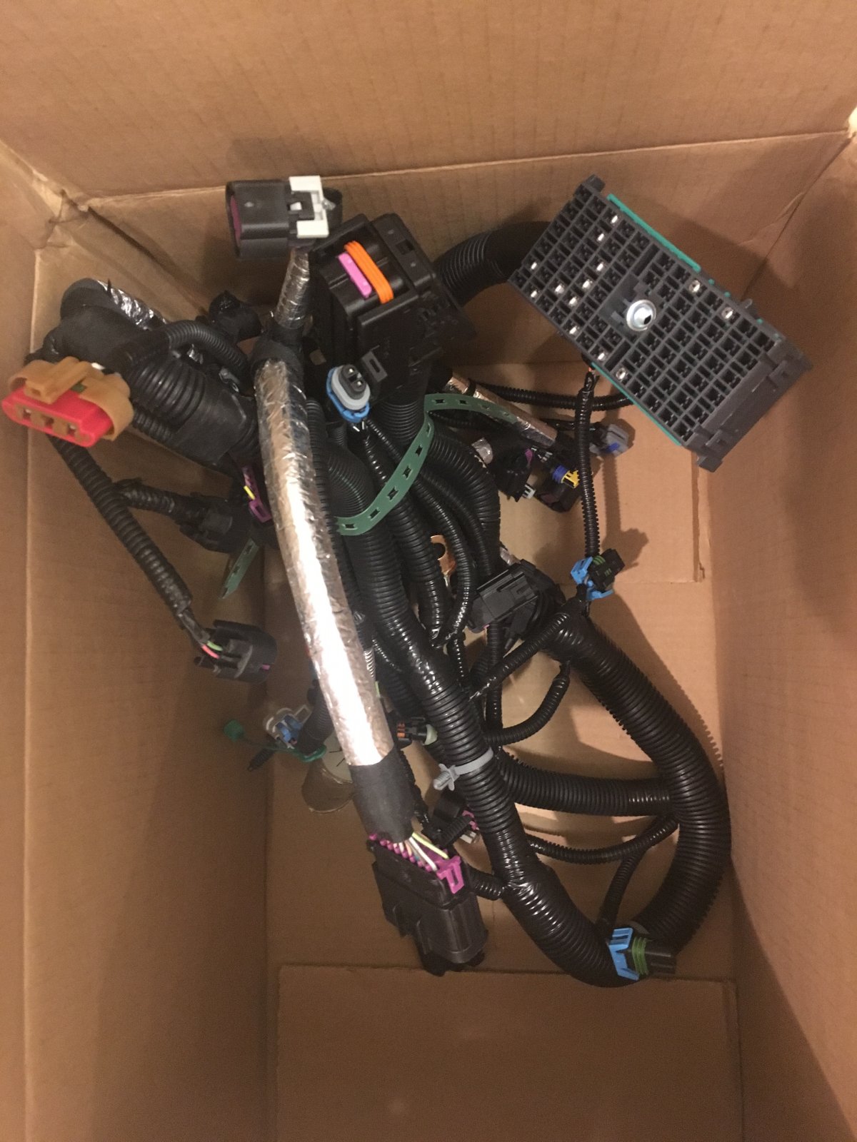

I just ordered a brand engine wiring harness. I plan to pull the fuse/relay box & body harness from my 2006 donor and start the entire wiring mockup this weekend. Its still a bit hot to work out in the garage, so most of this part can all be done indoors.
I will fully label all the connectors ahead of time (using the factory connector diagrams) to aid in simplicity. I will order my new crate engine at the end of this month.

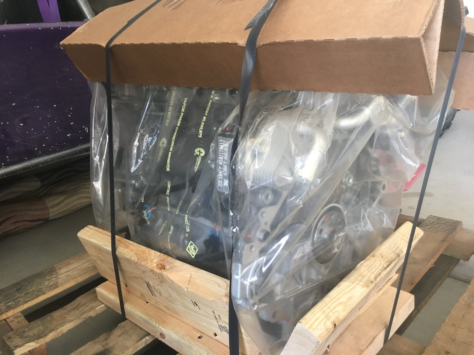

Brian74
My new factory engine harness has arrived (looks great) and I just ordered my LDK crate engine from ZZP. Since I am using the 2006 body harness, I will have to build the Bosch ECM X2 58 pin connector using the existing 2006 body wiring. Per the wiring diagrams, it shouldn't be too tough as much of it matches up. If the stupid weather here ever drops below 95 degrees I will get out in the garage and strip my donor.
Brian74

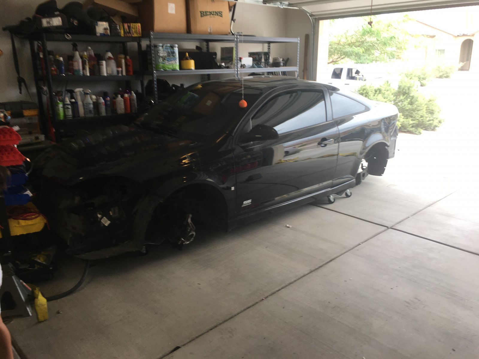

My LDK block came in last week. Haven’t done much because I haven’t had a day off due to work, nor money due to saving up for annual property taxes. I spent all weekend last weekend reorganizing my garage for this project. I’ll probably strip my donor this weekend. I plan to pick up stage 1 next month if it is ready. My first step will be getting seat rails and other weld-on parts, and then powdercoat. I’ll begin building the body harness in my spare time. Its hard to stay focused because I havent been out in the sandrail in a while and the weather is perfect. I love this project because there’s always something to look forward to.

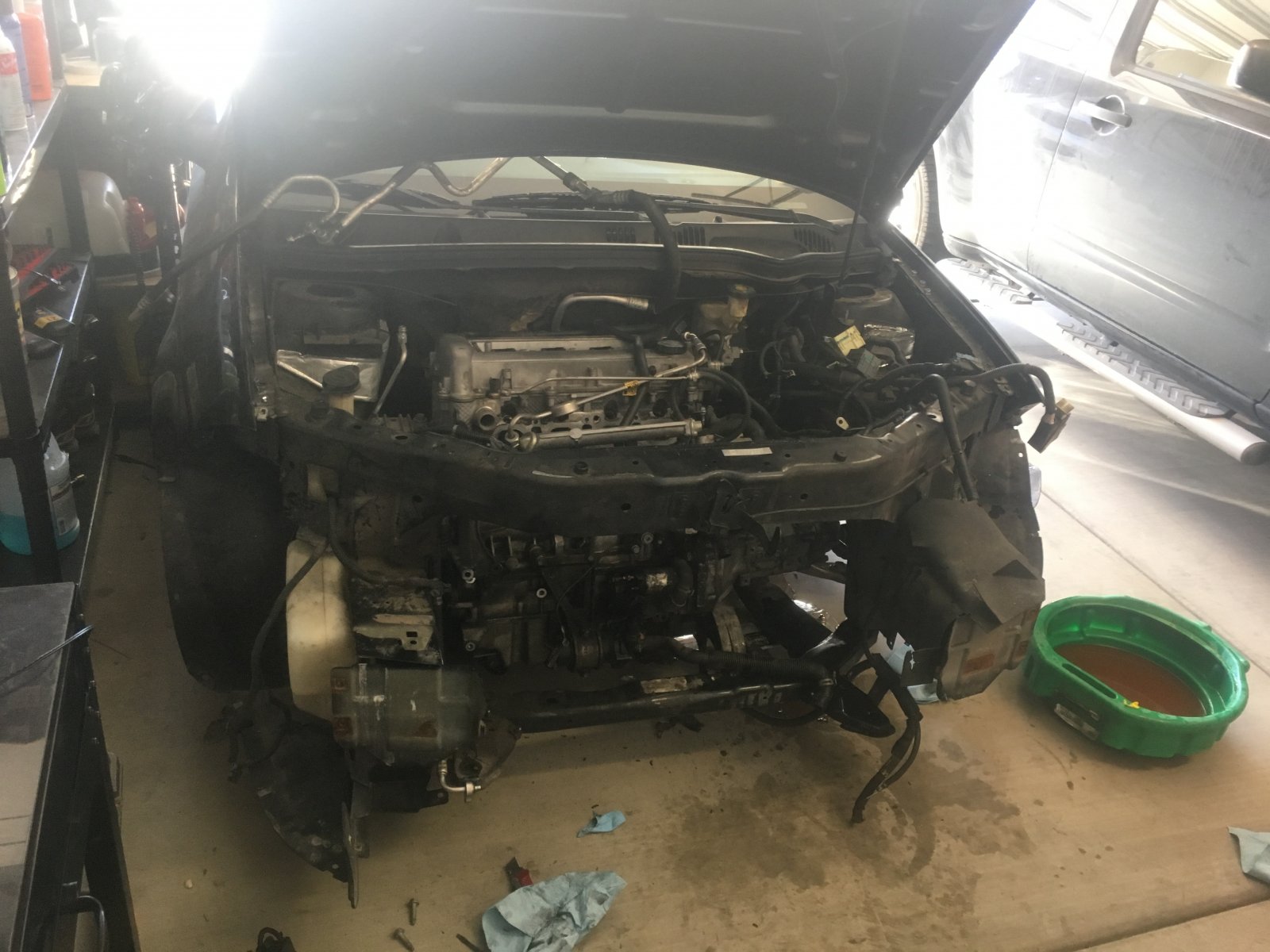

Brian74

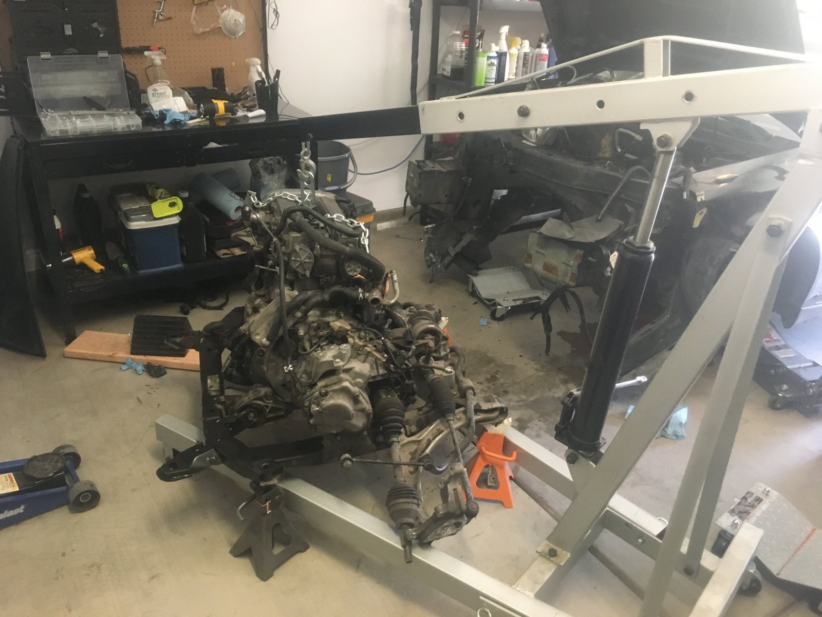

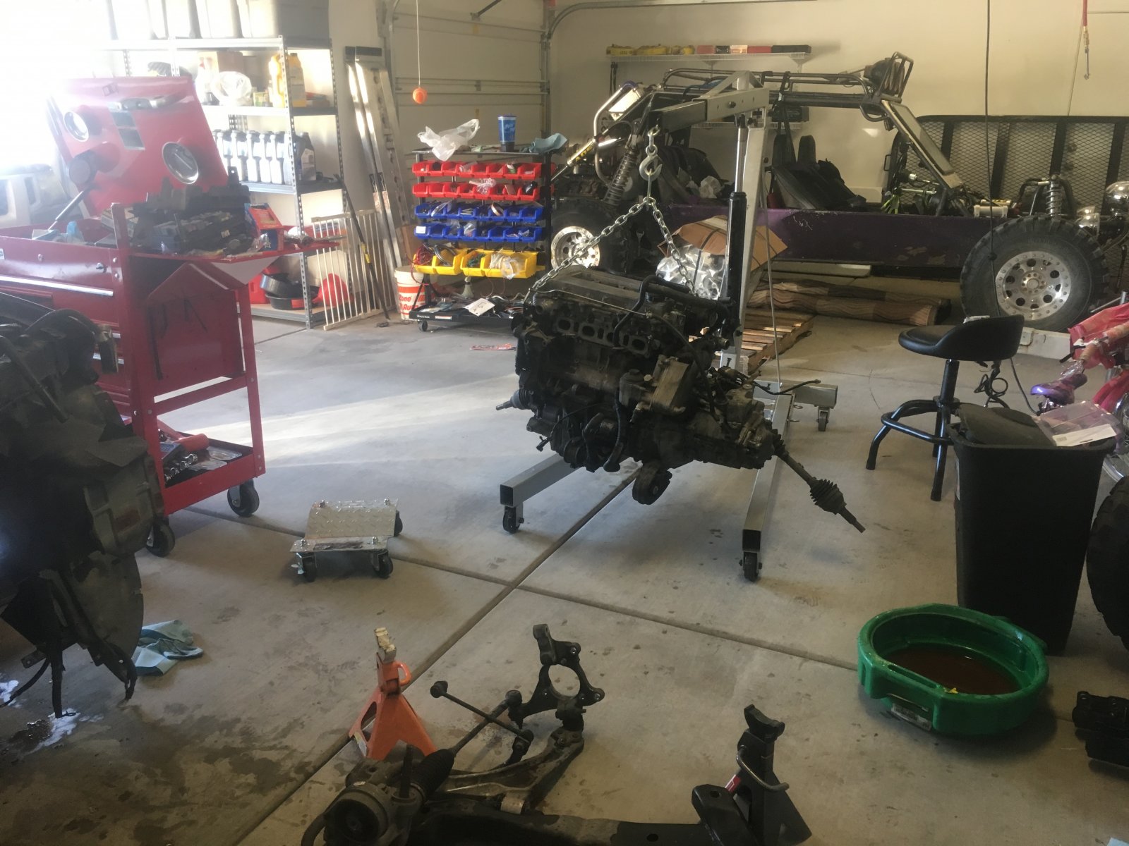

Yanked the engine & trans out of the donor this afternoon. Will get the engine up on a stand to see whats salvageable & then perhaps sell it.
Brian74
How many miles on the engine? Looks like a good unit. Great looking subframe.
Not sure the mileage; I think in the 90k’s. Prior owner says the engine (S/C) had a knock. I will tear down the engine bottom end to see if it is salvageable to resell but I already bought a new LDK turbo crate engine for my project. I mainly bought the car for the LSD trans, steering, body wiring and other donor parts.
