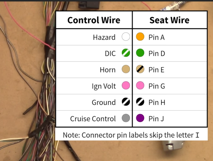

The diagram looks like this:
9706

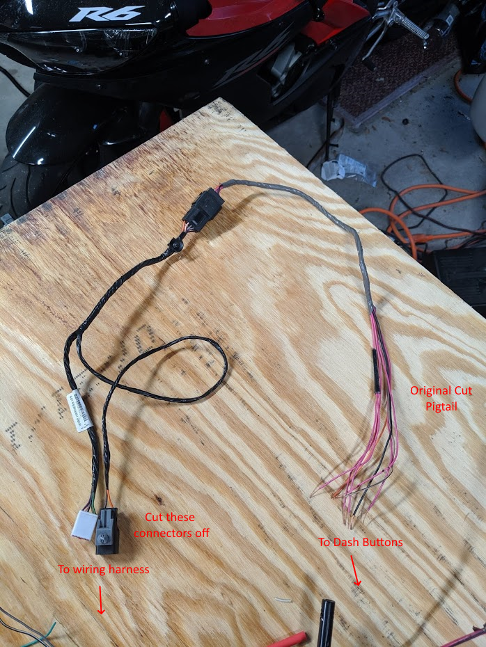

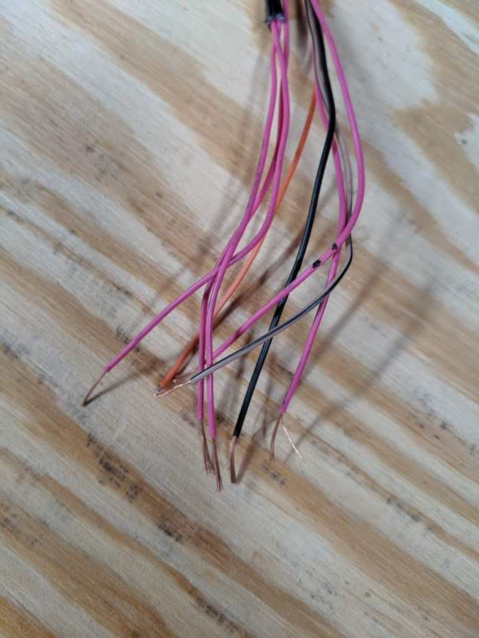

The pigtail I cut looks like this:
9707

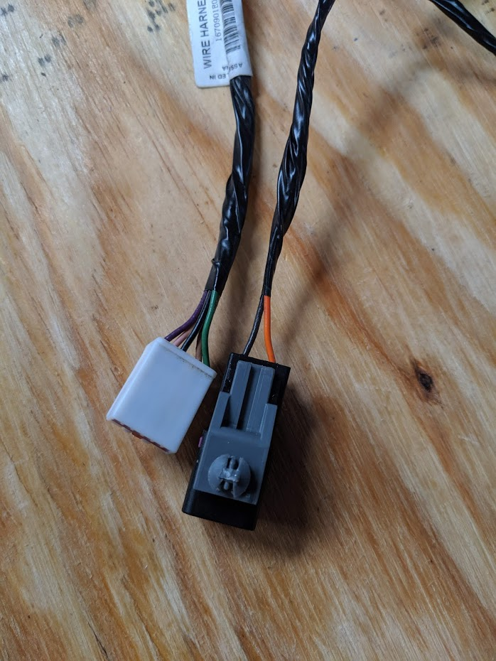

These wires do not match the ones on the diagram. Looking at the second wire that you get from under the seat, it seems like it may be this end of the wire instead? It looks like this:
9708
The video doesn't show anything about cutting these connectors off, but that would make the most sense. Am I right in thinking this?

baustin
Since my 2006 SS/SC didn't have any seat harnesses (that I recall), I used the headliner plug for the button panel connections.
jirwin
So this is literally just a way to disconnect the main harness from the button pannel? Doesn't really matter how it disconnects, just that it does
It may be the receiver for the tpms as well. I only use the remote panic alarm when people get a little too nosey with the car at var shows and gas stations though. Lol
