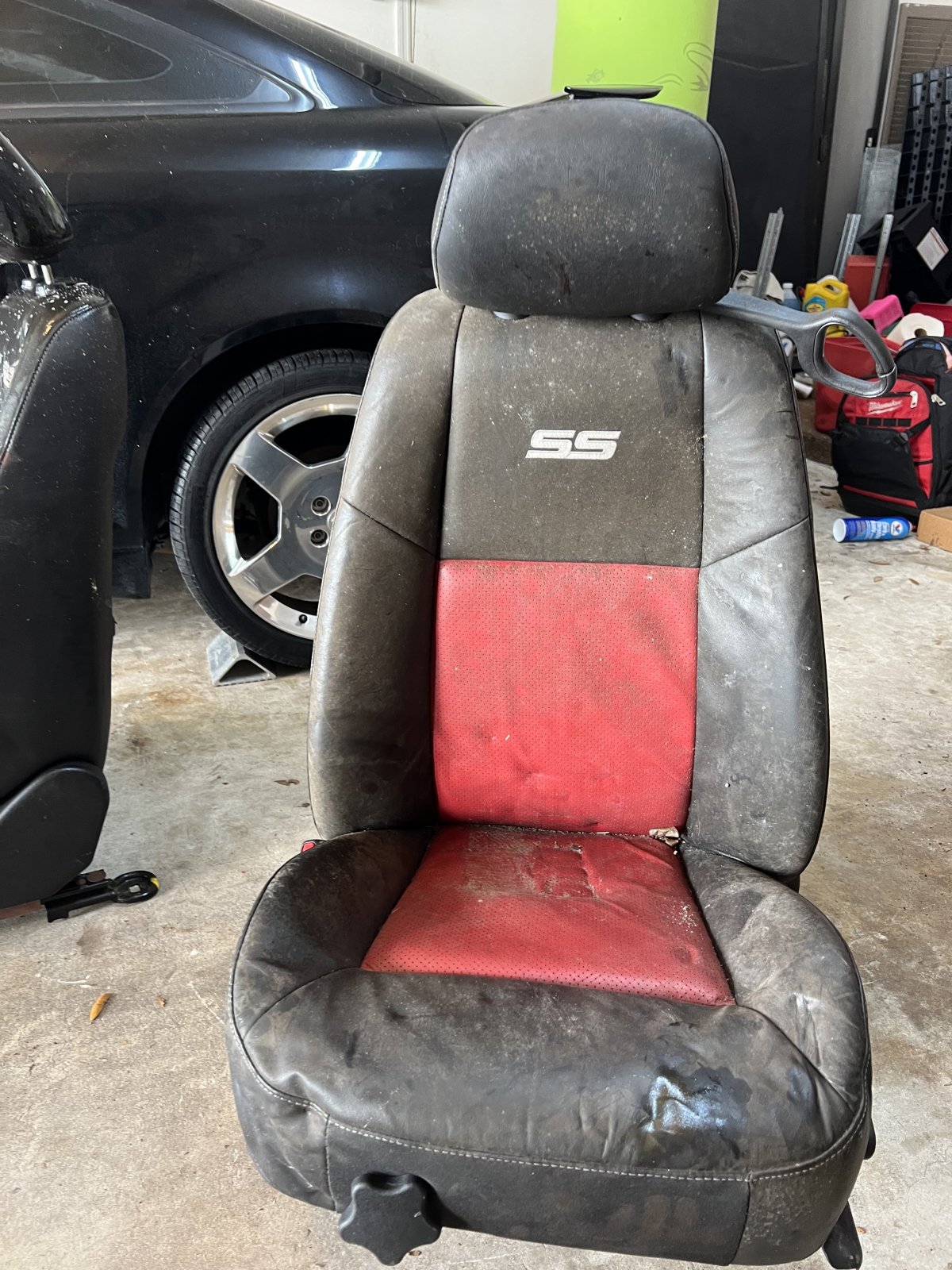

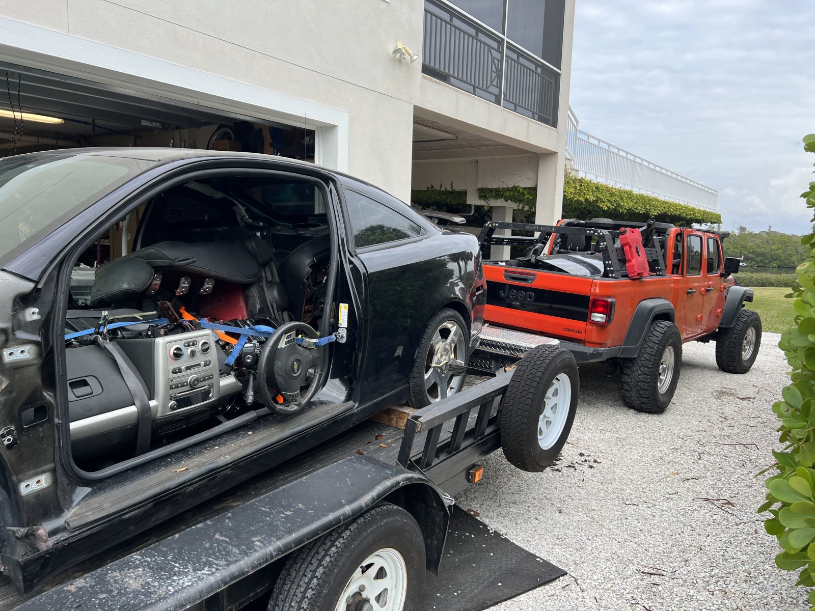

Picked up my donor car today from someone that had started the tear down process for their Goblin build but unfortunately had to abort. Going to spend the weekend getting the garage prepped and then start cataloging what I have and getting everything cleaned up. The chassis will be here in a few weeks. It’s all coming together quickly!

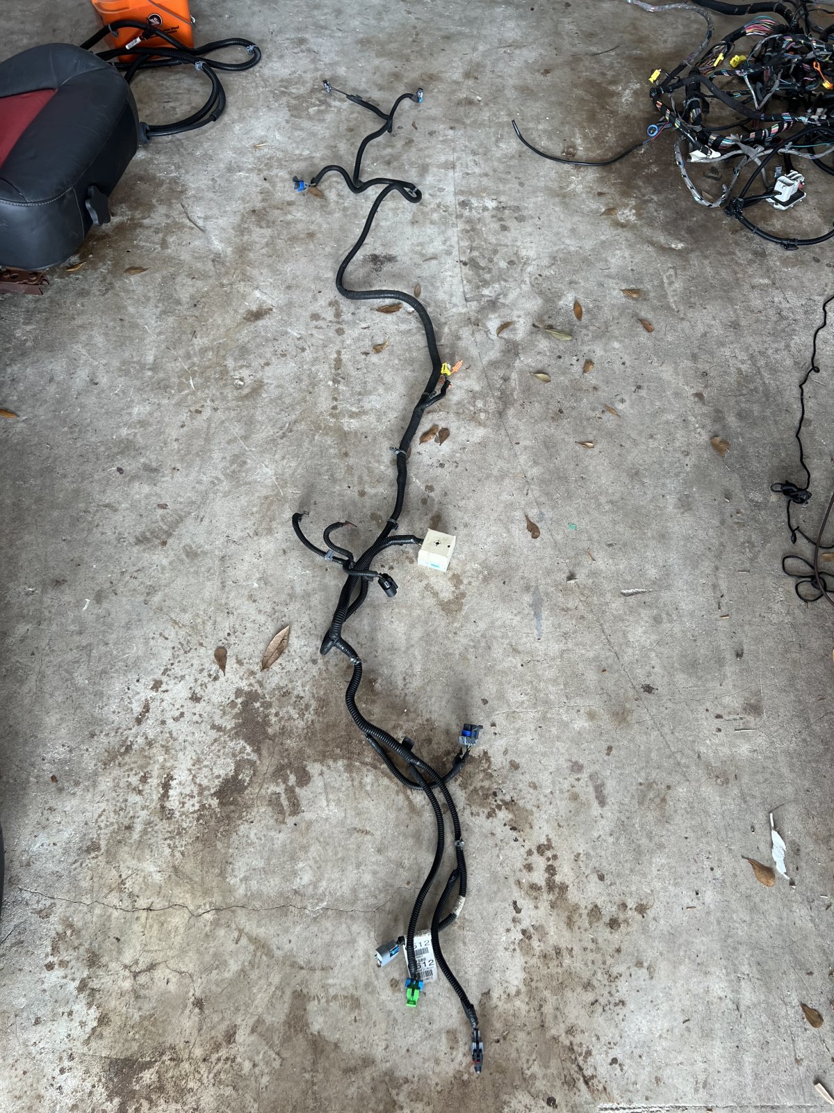

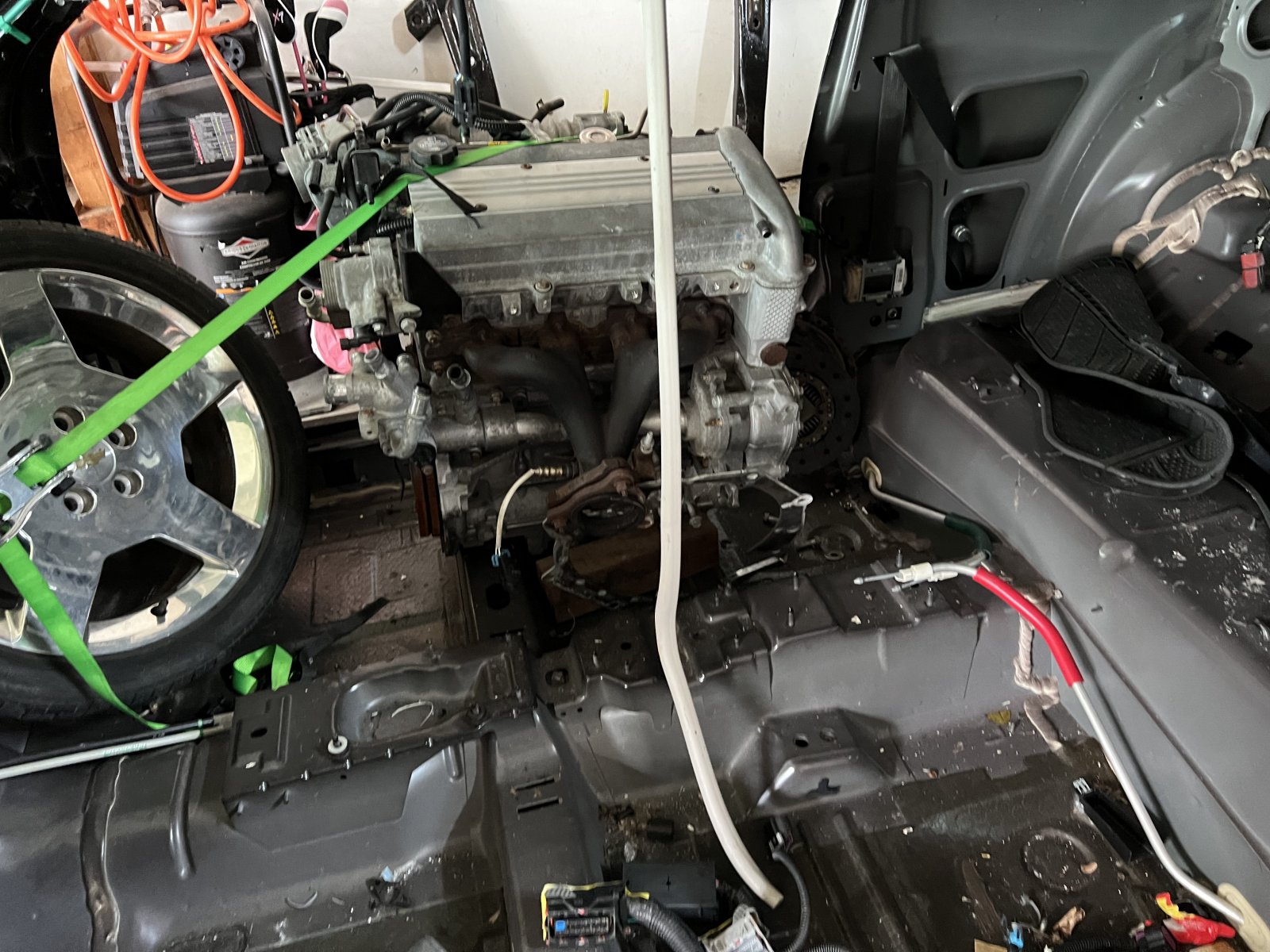

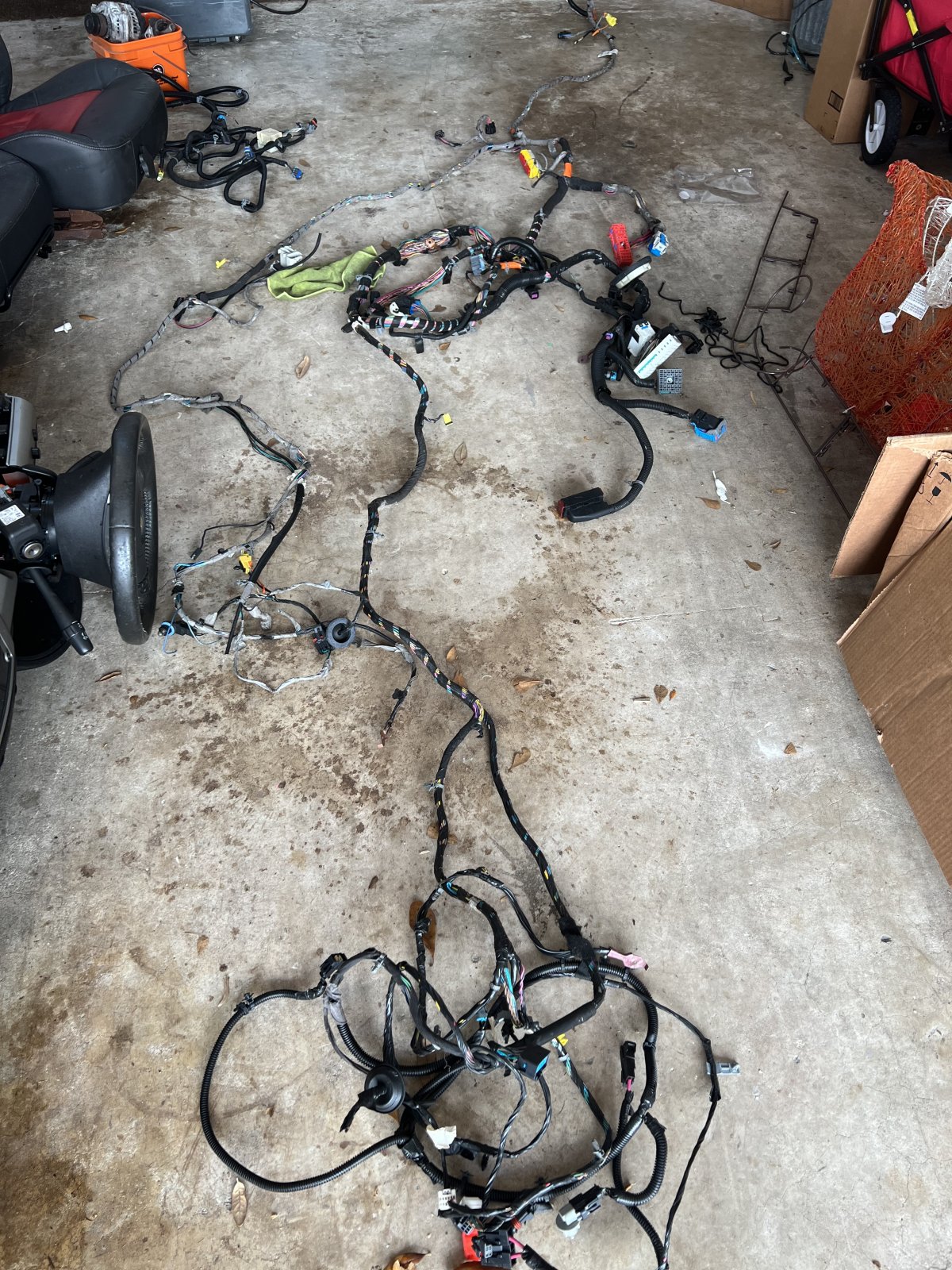

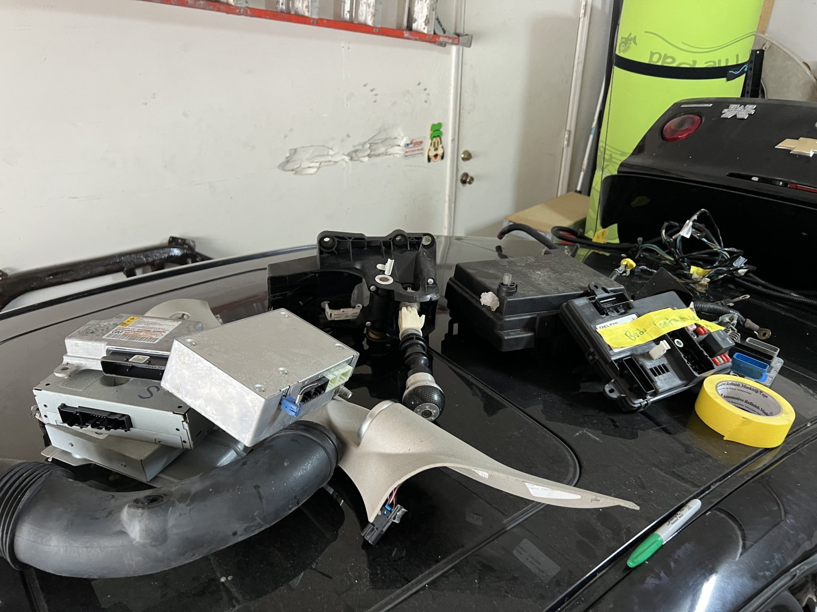

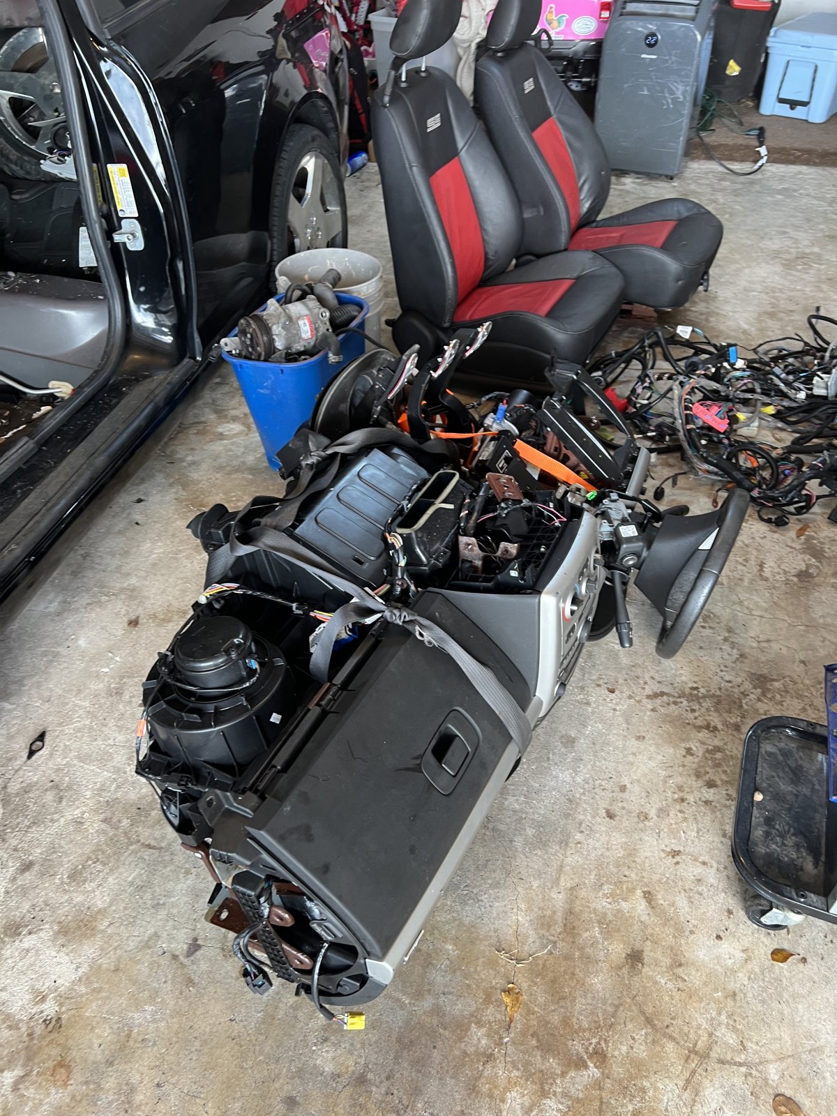

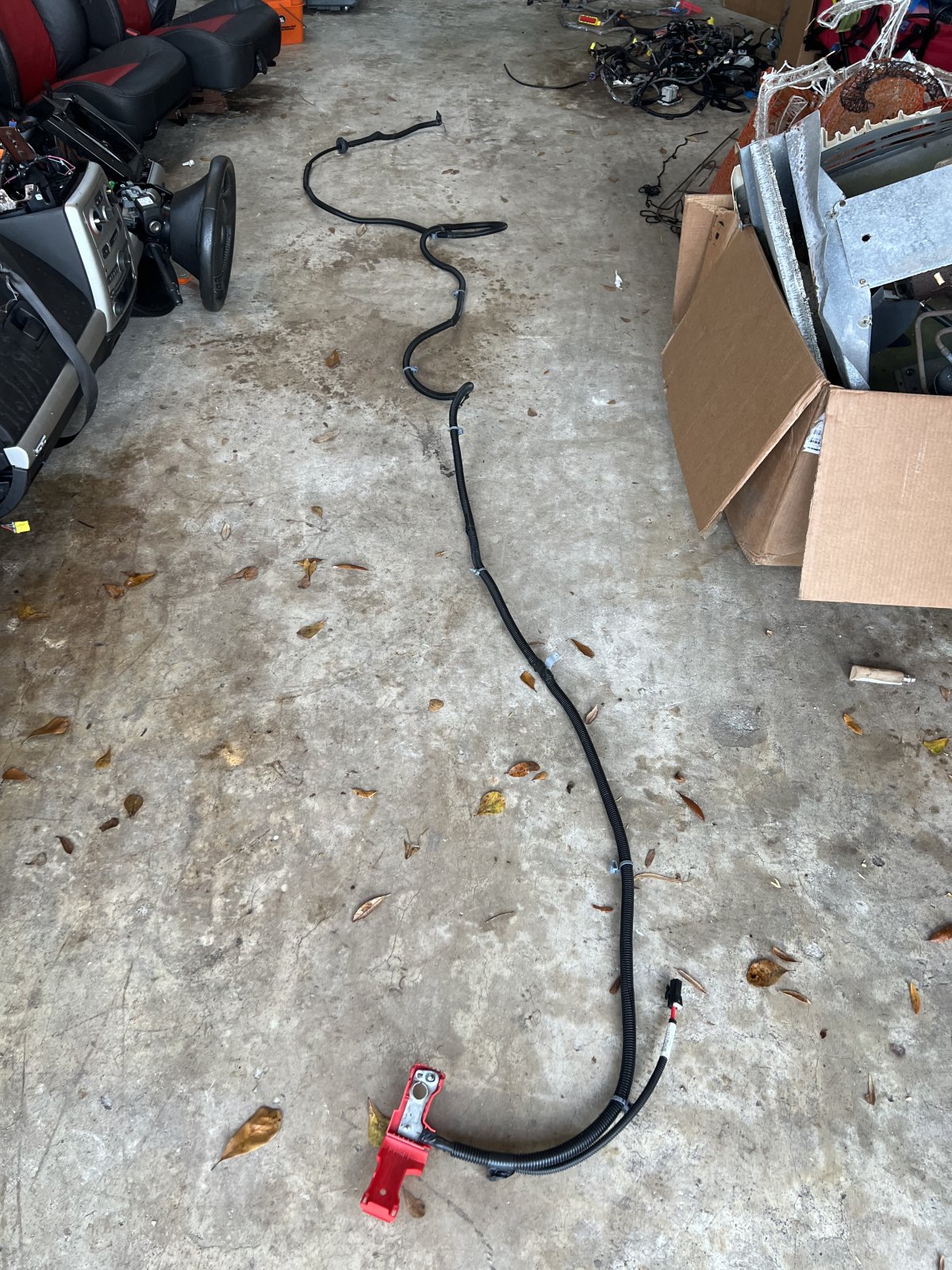

I started making my way through the mostly disassembled Cobalt today. Nothing was labeled but so far things haven’t been too difficult to identify especially with the help of google on a couple parts. Here is what I know I’m missing so far after making my way through the interior, Powertrain and wiring sections of the donor parts list document.
Missing/unsure of what “front rubber hoses” are on the brake section or the list is- can anyone tell me what they look like or have a photo?
Can’t find the TCM- messaged the previous owner to see if it happens to be in his workshop still
Don’t have the vacuum hose from the brake booster- the donor parts list document didn’t make it clear if I need the hose or the fitting into the booster or both. The fitting is there but I can’t seem to find a vacuum hose that would fit that or matched the image I found when I googled it- any help here?
I don’t see the parking brake handle or cables either but ran out of time today to dig into it more
The dash assembly is disconnected from the car but nothing has been removed yet so I believe everything is there.

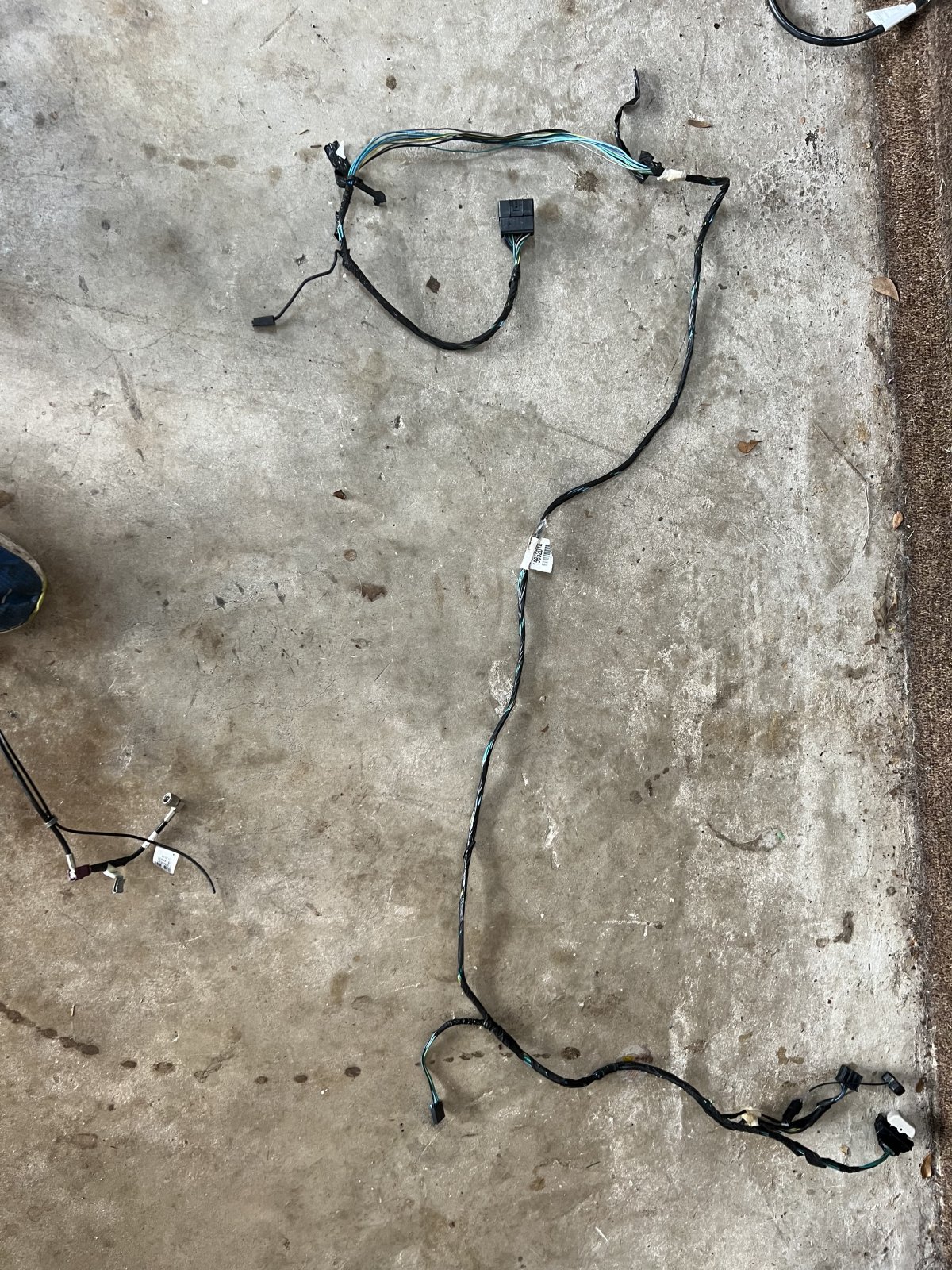

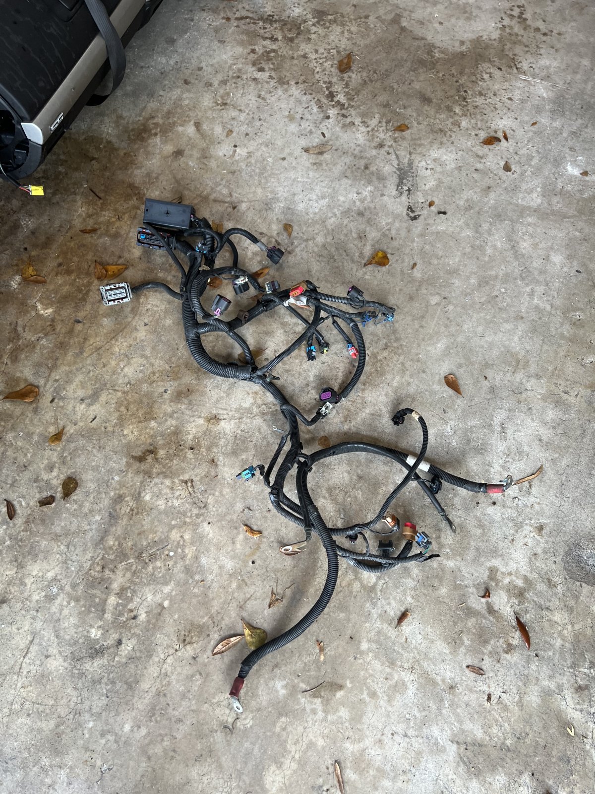

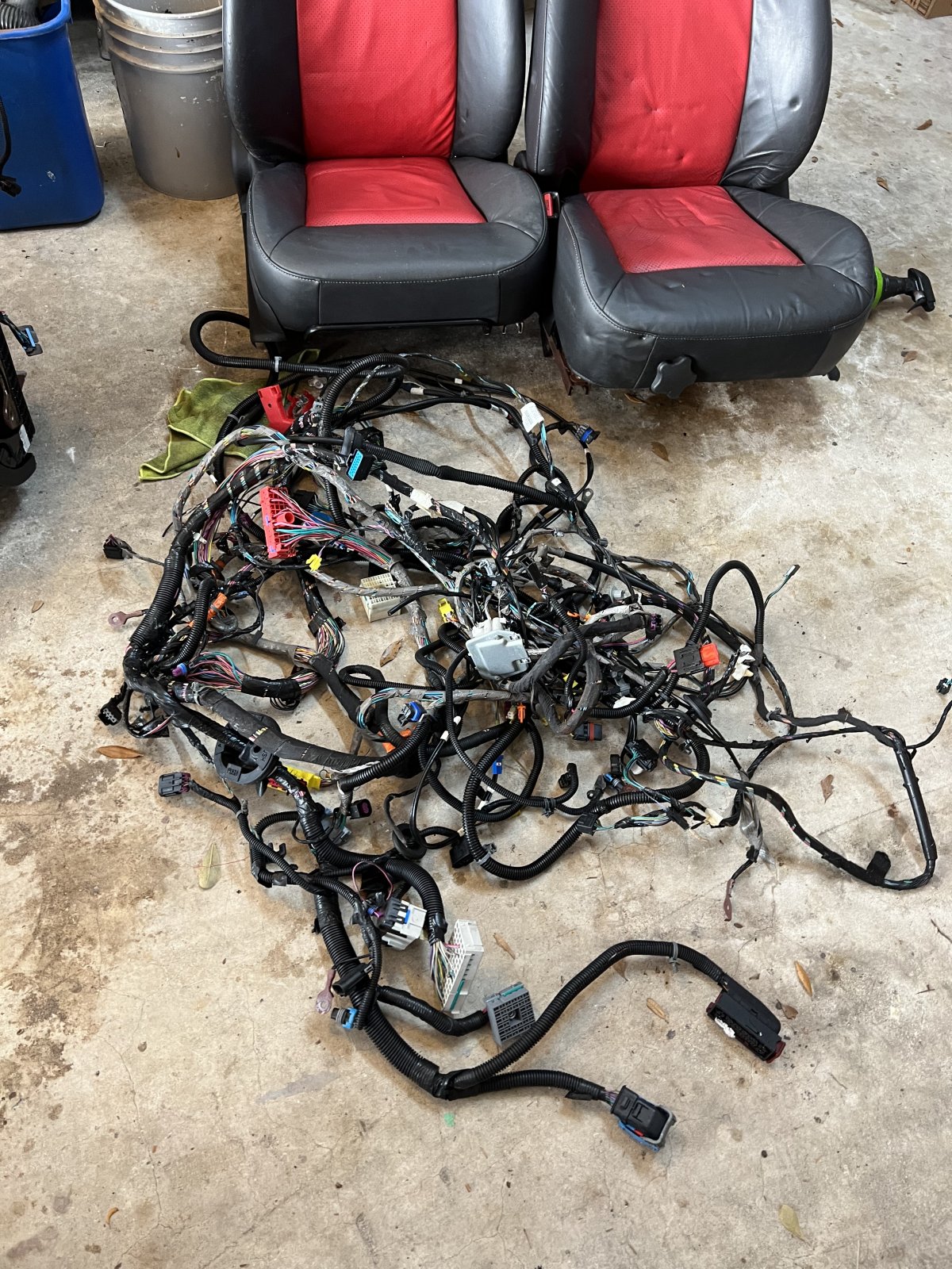

None of the wiring harness was labeled so I spent some time separating and labeling the plugs I could identify. Then I wondered if I need to go through that trouble since I am getting the wiring harness service from DF. Do I just send them all the harnesses and they take care of it?
I did find the pump for the intercooler but haven’t found any mention of that yet- do I need to keep that?

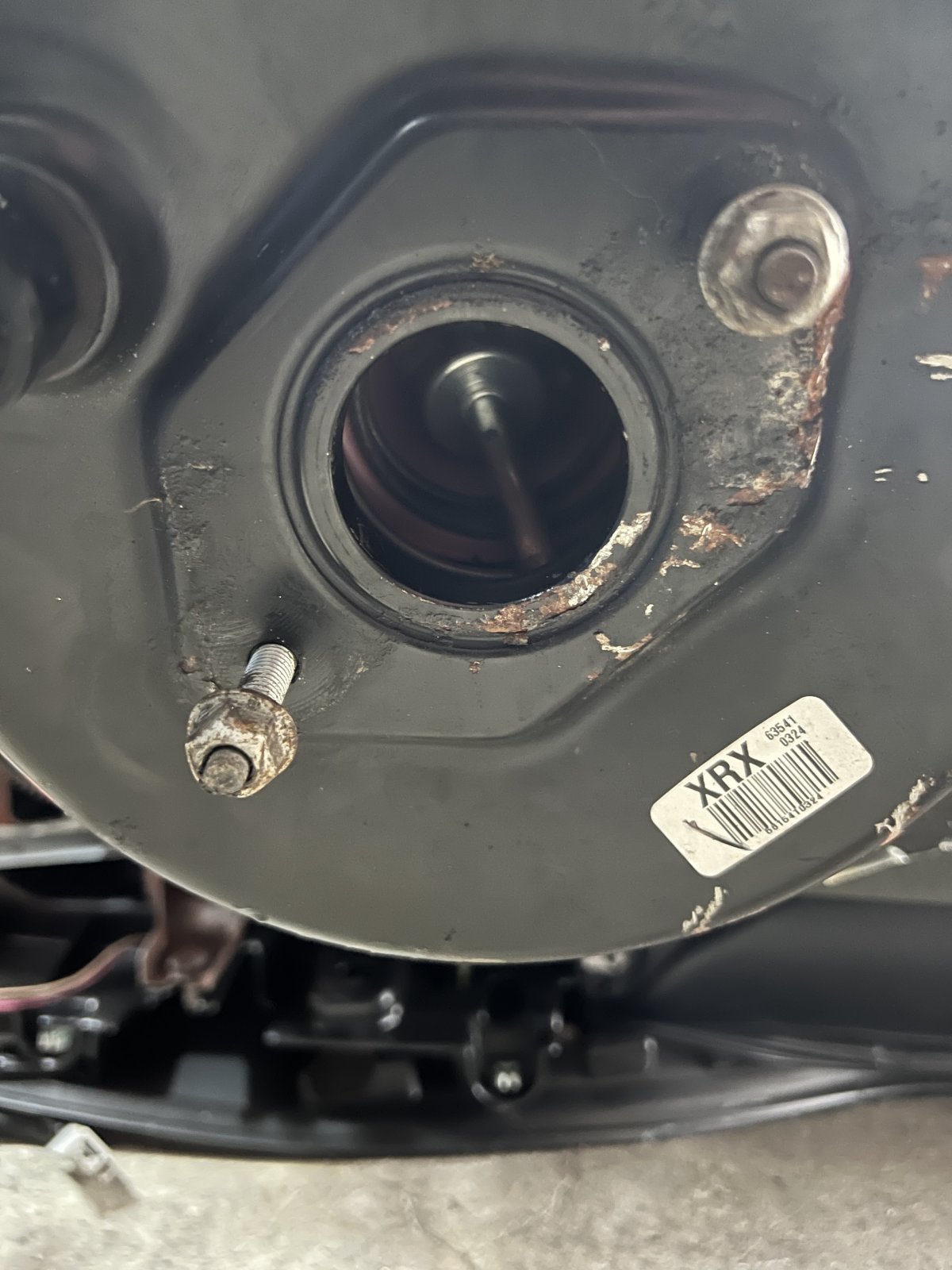

Looking at the brake booster there is a part loose inside of it. It is a retaining clip of sorts and a rod with a plunger or something on one end. Is the booster broken or should it be like that? Picture included

Vacuum hose for brake booster isn’t a big deal. You will just need a piece of rubber hose to attach the provided plastic hose to the intake and booster.
Or there are other options that make a cleaner installation.
I wouldn’t worry about the harness if you are sending it in. It’s not that bad of a job, to br honest. I’d give it a try, you can always send it to DF if you get overwhelmed
J
I really don’t like wiring but I am going to take a look at the harness instructions to see if it’s something I want to try. I would imagine that the plugs not being labeled would make things more difficult, wouldn’t it?
Yeah, that is a good point.
