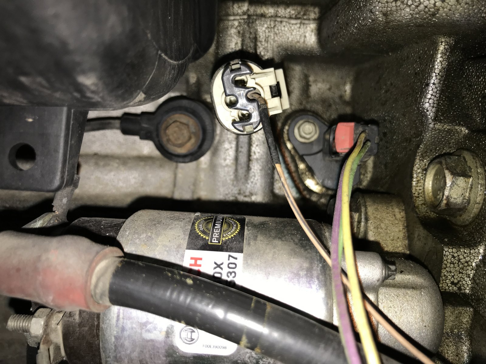

ZacMaster Well-Known Member ZacMaster Well-Known Member Mar 13, 2019 #1 Can anyone help me label these three connectors? They are just under the oil filter on my 2.4 NA.
ctuinstra Goblin Guru ctuinstra Goblin Guru Mar 13, 2019 #2 Far left is the knock sensor. Middle, oil pressure? Far right, crank position sensor. Anyone, correct me if I wrong.
ZacMaster Well-Known Member ZacMaster Well-Known Member Mar 13, 2019 #3 That middle connector only has a single tan w/ black wire going to it. Last edited: Mar 13, 2019
ctuinstra Goblin Guru ctuinstra Goblin Guru Mar 13, 2019 #4 ZacMaster said: That middle connector only has a single brown w/ white wire going to it. Click to expand... Some pressure sensor simply ground or not ground as a switch. I could be wrong, but it's just a pressure switch for low oil pressure.
ZacMaster Well-Known Member ZacMaster Well-Known Member Mar 13, 2019 #5 ctuinstra said: Some pressure sensor simply ground or not ground as a switch. I could be wrong, but it's just a pressure switch for low oil pressure. Click to expand... Makes sense if the switch grounds the lead to the case. Thanks.

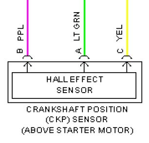

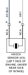

ZacMaster Well-Known Member ZacMaster Well-Known Member Mar 13, 2019 #9 Ooh, I found a wiring diagram...
Tony Well-Known Member Tony Well-Known Member Mar 13, 2019 #10 ZacMaster said: Ooh, I found a wiring diagram... Click to expand... I posted a complete one (all years) in the General Info section the other day, if you hadn't seen that.
ZacMaster Well-Known Member ZacMaster Well-Known Member Mar 13, 2019 #11 Tony said: I posted a complete one (all years) in the General Info section the other day, if you hadn't seen that. Click to expand... That's what I finally downloaded and opened. I bet you've saved me a bunch of money and time messing around in the dark. I owe you a beer if we can ever meet up. Last edited: Mar 13, 2019
