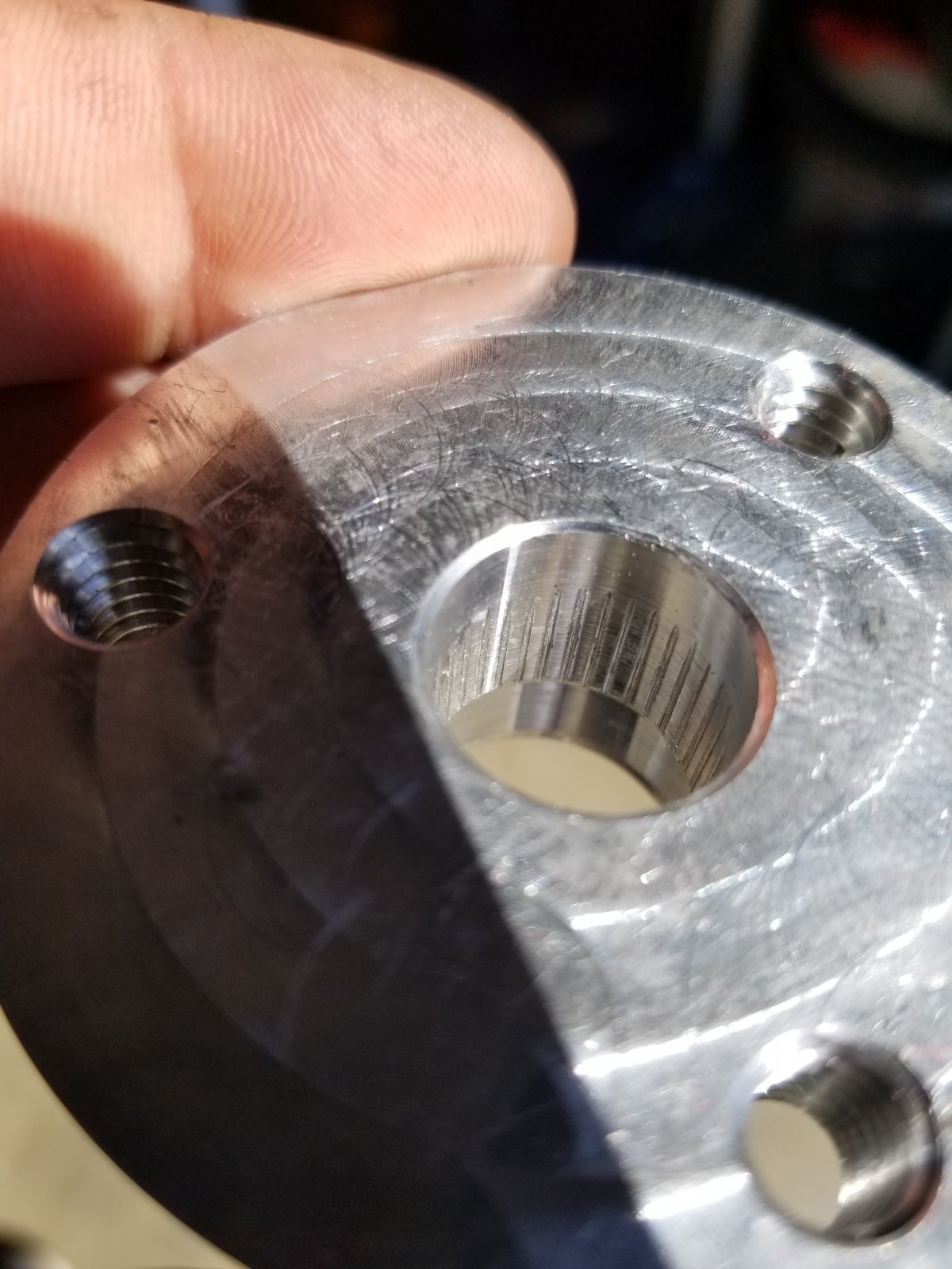

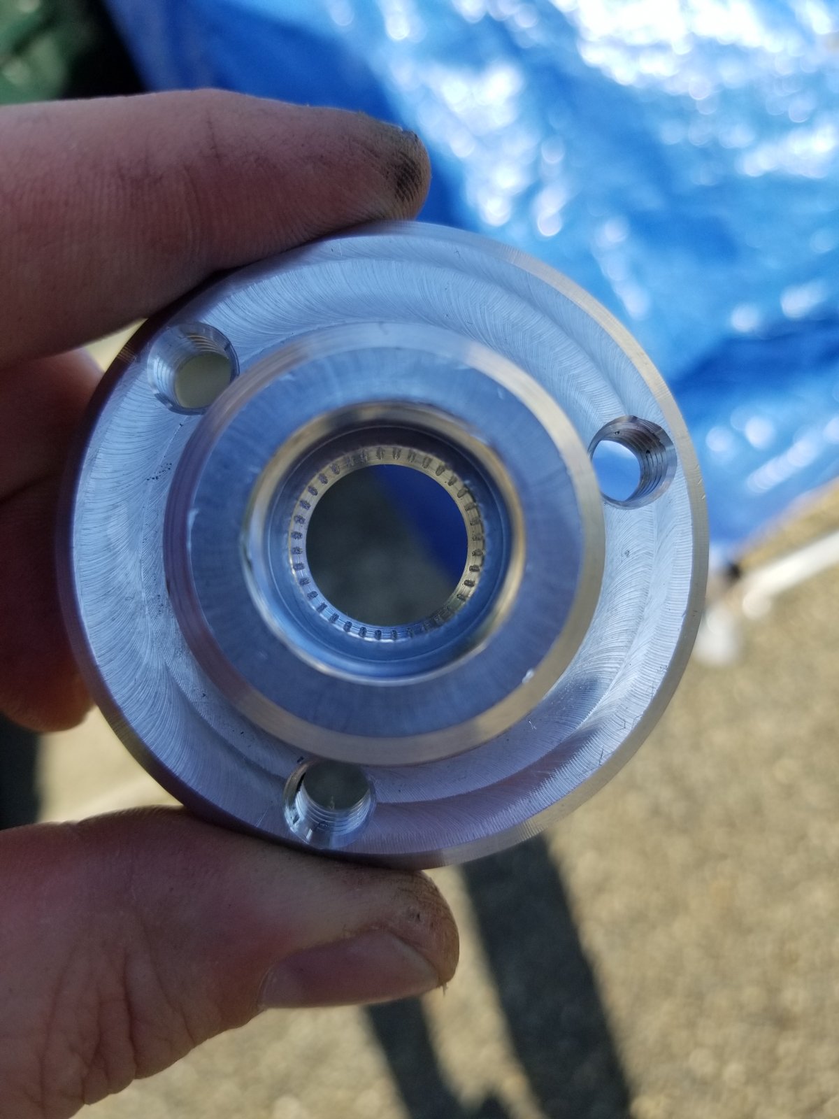

Your steering hub adapter looks like mine. I think it's machined just enough to fit on and not slip.

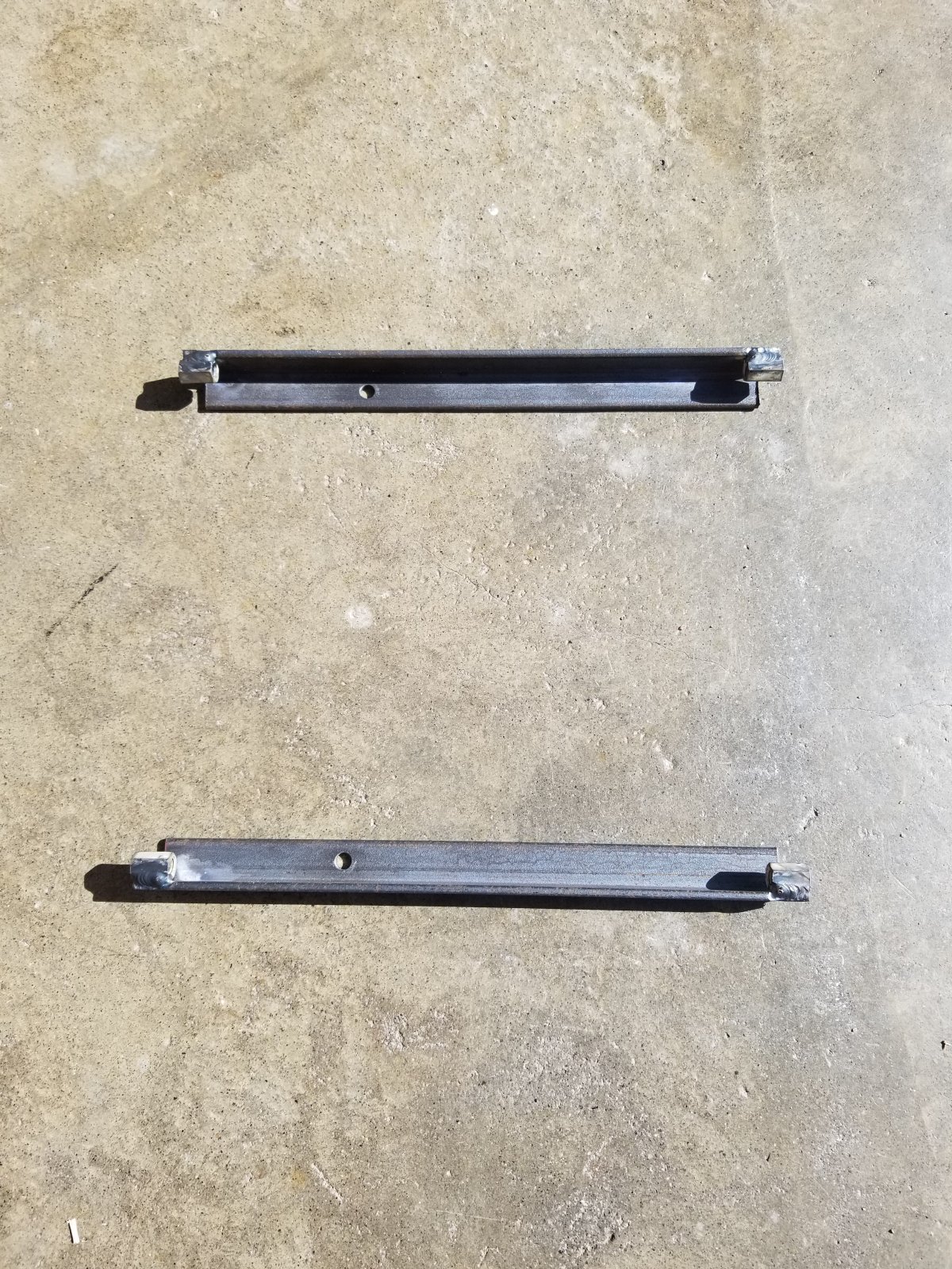

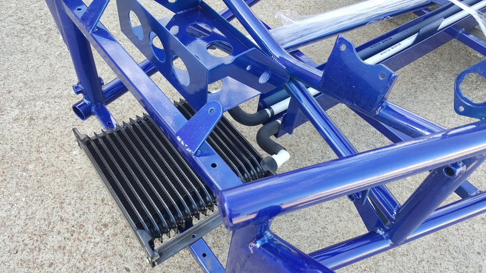

I think the stock SCs have the same heat exchanger configuration as the TCs. If that's the case, those brackets are for mounting the HX behind the radiator on the square frame tube. You'll have to drill two 1/4" holes through the tube and run bolts through there. Though you could probably use self tapping screws too. I'd rather use bolts though.
Waterdriver
That is as far as the splines go.
It's not the length of the splines but the depth I'm concerned about.
This picture might show it a little better. It's still hard to see in the picture.
If you look close, the splines a just barely machined into the hub. It's as if the splines are as deep as an engraver would make. If that makes sense.

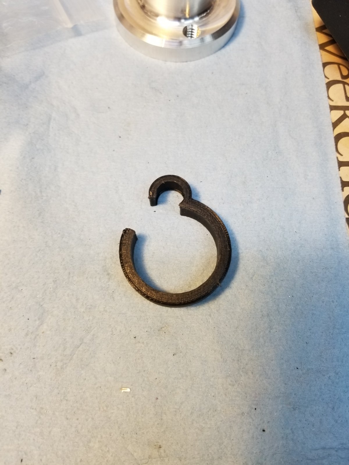

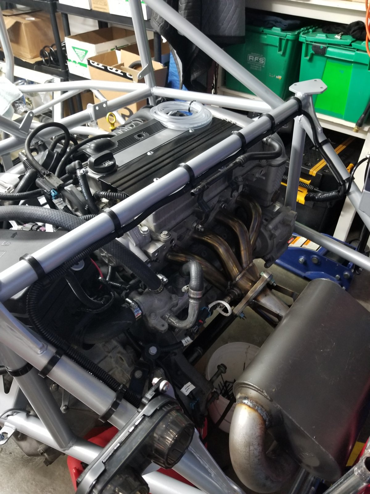

nice work on the clips! do they seem pretty stable? I might have to create my own version of that.
They seem fairly tight at the moment. Out in the sun and air flow while driving might indicate otherwise. The PLA slides fairly easily on the powdercoated tubes.
I might try wiping a thin film of clear silicon RTV sealant to the inside of the clip and let it cure before snapping them on. That might give it a little extra grip on the tube.
If your're interested, I can send you the file.

Is that to hold temporarily for routing? Or permanent?
I'm thinking permanent, but testing will tell all. I just liked the idea of a little bit of a finished look instead of just zip ties.
Plus, once you design it and like it, you just push print.

Watch the temp on that bar it gets **** hot when your sitting stile right above the header there!
Nuker-
Thank you for that nugget of info. Those clips won't last long made out of that material. I'll have to try out my ABS filament.
I had thought about wrapping those primary tubes. Guess I will now and see if that'll help. :)
