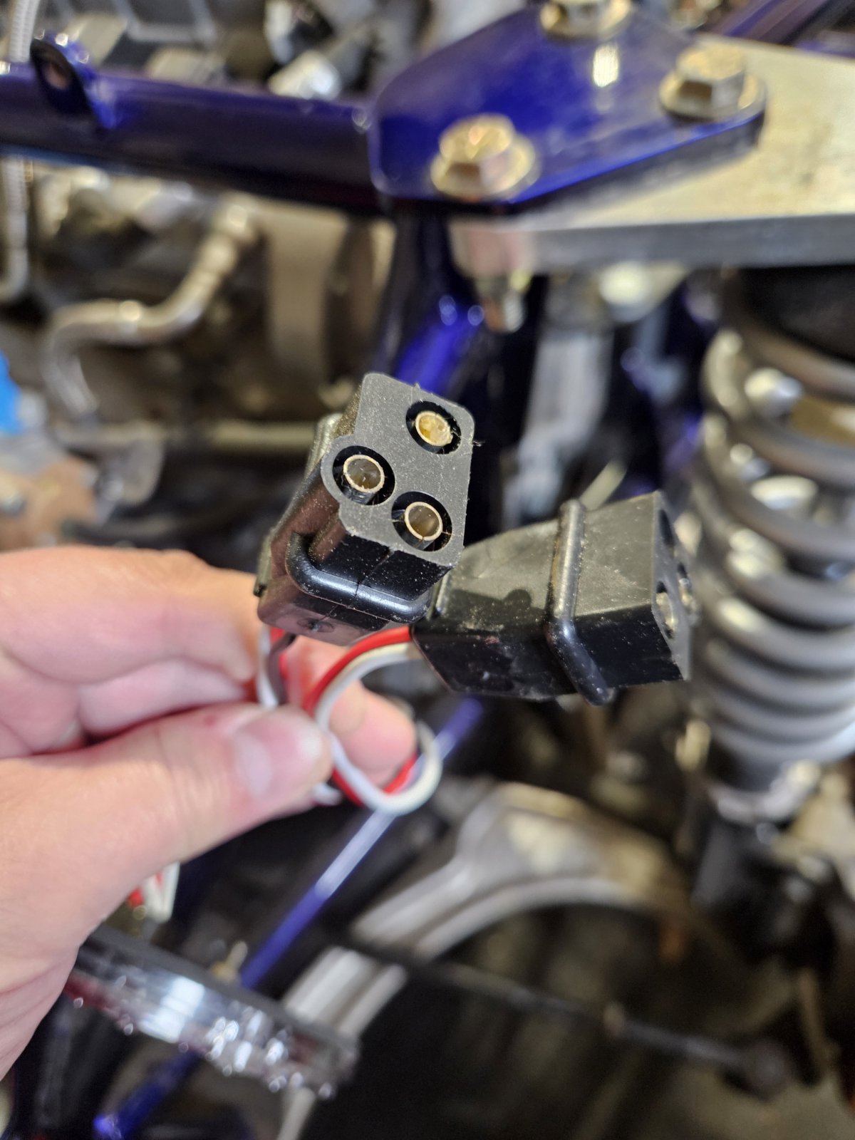

I saw a write up about wiring the tail lights, but the connectors look different than what I received from my car. Does anybody know what type of connectors these are so I can buy the right ones to plug in?
Google image search is no help... :D

I did not use the DF taillights but if you cannot find a plug to match, amazon sells multiple variations of plugs that can be wired in. I have connected all of my lights and mirrors without a plug but will be ordering something similar to these down the road for the tails, headlights, and mirrors.

Cool, I bought a waterproof connector kit similar to what you showed (I want the crimp tool, and I have other wiring as well) , and with the information in this thread I think I can figure it out

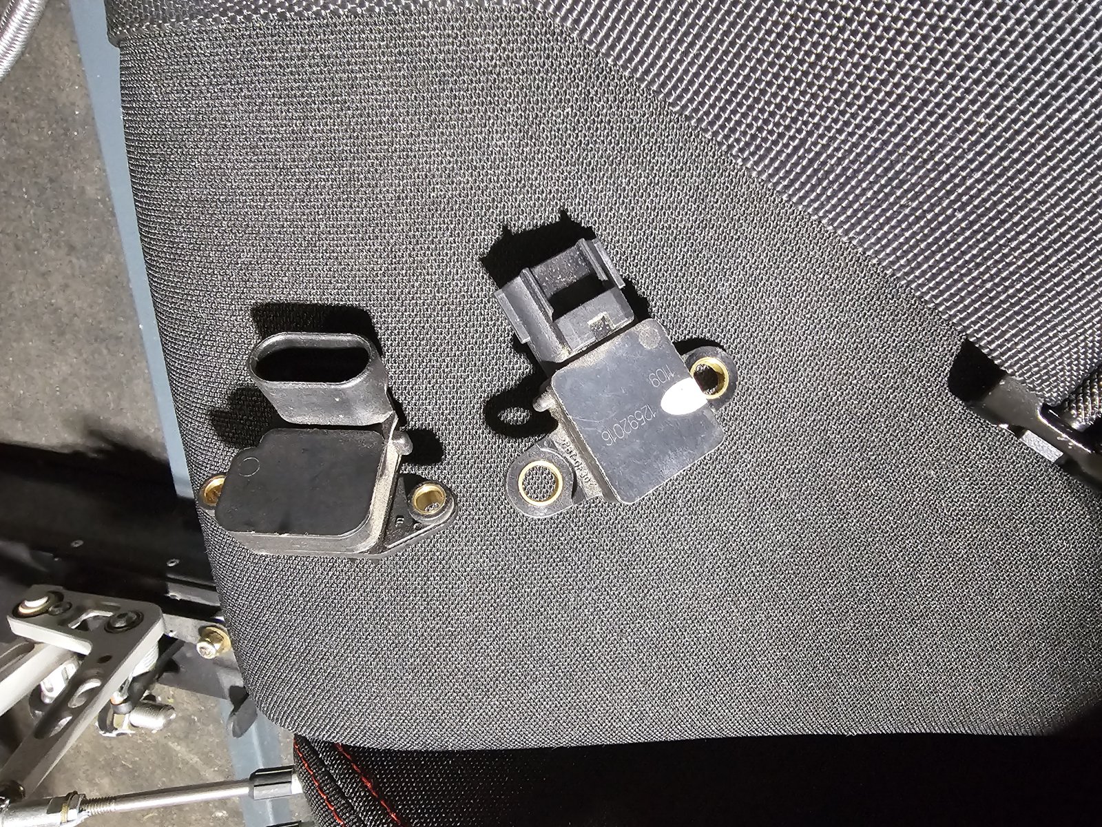

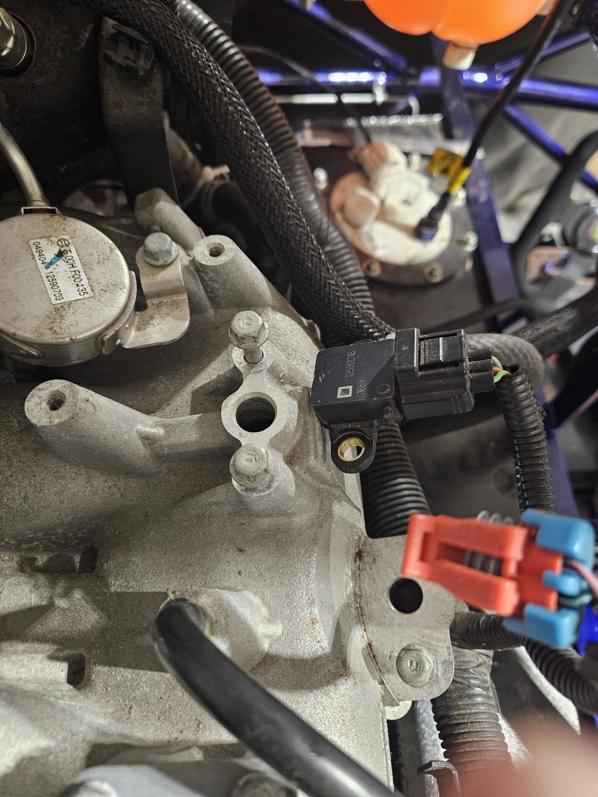

Ok, next question....MAP sensor on the LNF. I have removed the sensor from the manifold, verify that the part number is correct, and that it fits the pipe supplied by DF. This begs the question of how do you plug the hole in the manifold once the MAP sensor has been relocated?
49395
LNF has two sensors, MAP sensor in the intake manifold and "low res boost sensor" in the charge piping prior to the throttle body. It needs both and I thought original stock they had the same part number, but rockauto indicates otherwise. They can be the same if you have access to HPTuners to change the settings.
And actually there is non-replaceable pressure sensor built into the ECM for barometric pressure.
ccgillett
Ok cool. So then the manifold sensor remains in place and the low res sensor goes into the new plumbing?
Same question applies about blocking the sensor hole.
No sensor hole to block. One goes in the intake manifold the other goes in charge pipe. What other sensor hole do you have?
except after a little more though it was the GM stage kit that used the same part number sensor, with a new connector on one. One of the original contains the iat sensor and the other doesn’t so different part numbers with different number of wires.

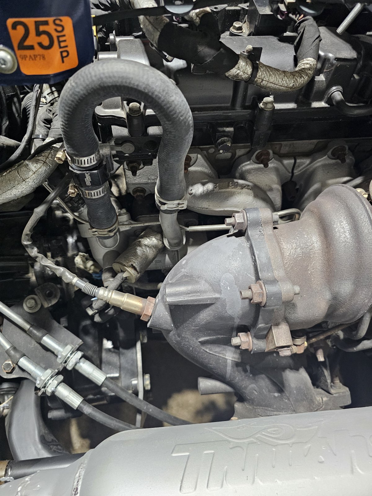

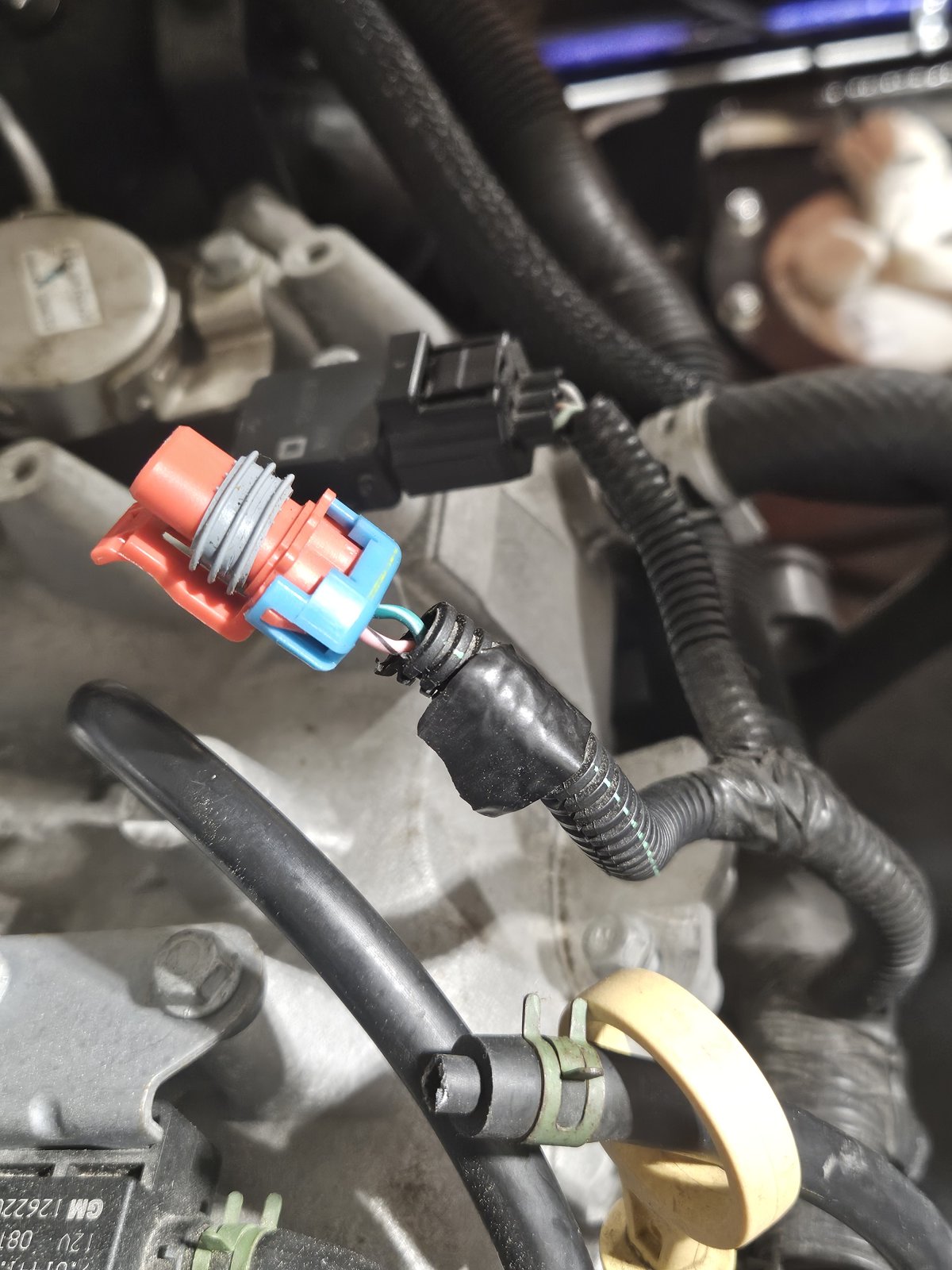

So the engine, when I received it, had no stock charge pipe or air intake. It looked pretty much as in this photo:
49403
I wasn't concerned since it all gets replaced with new hardware. I'm guessing that 2nd MAP sensor and the wiring associated with it are gone. I can easily order another one, the question now is where does it plug in to the car?

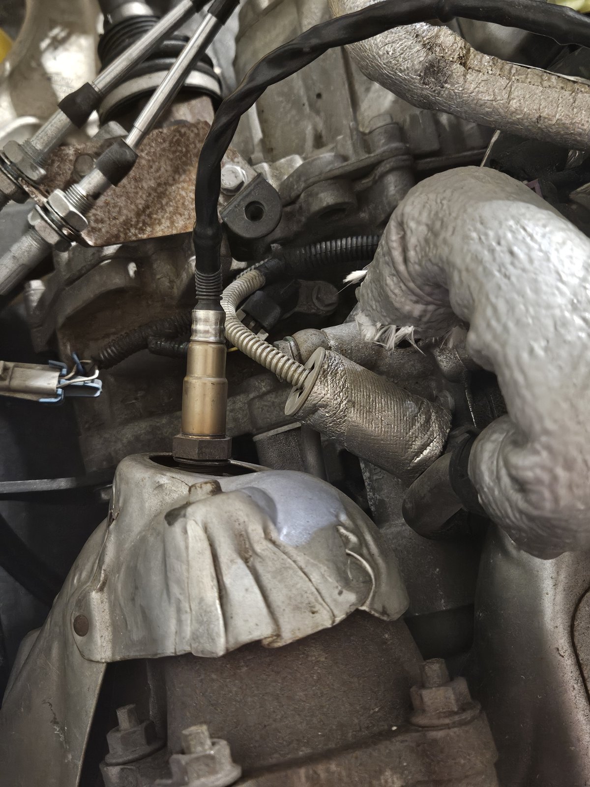

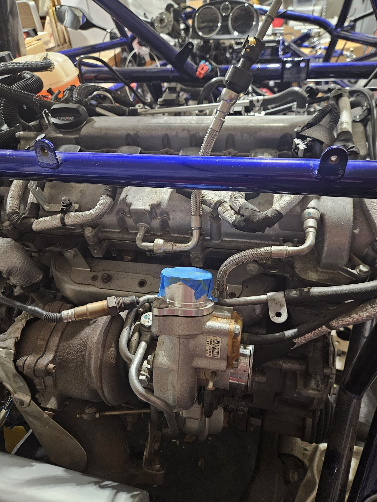

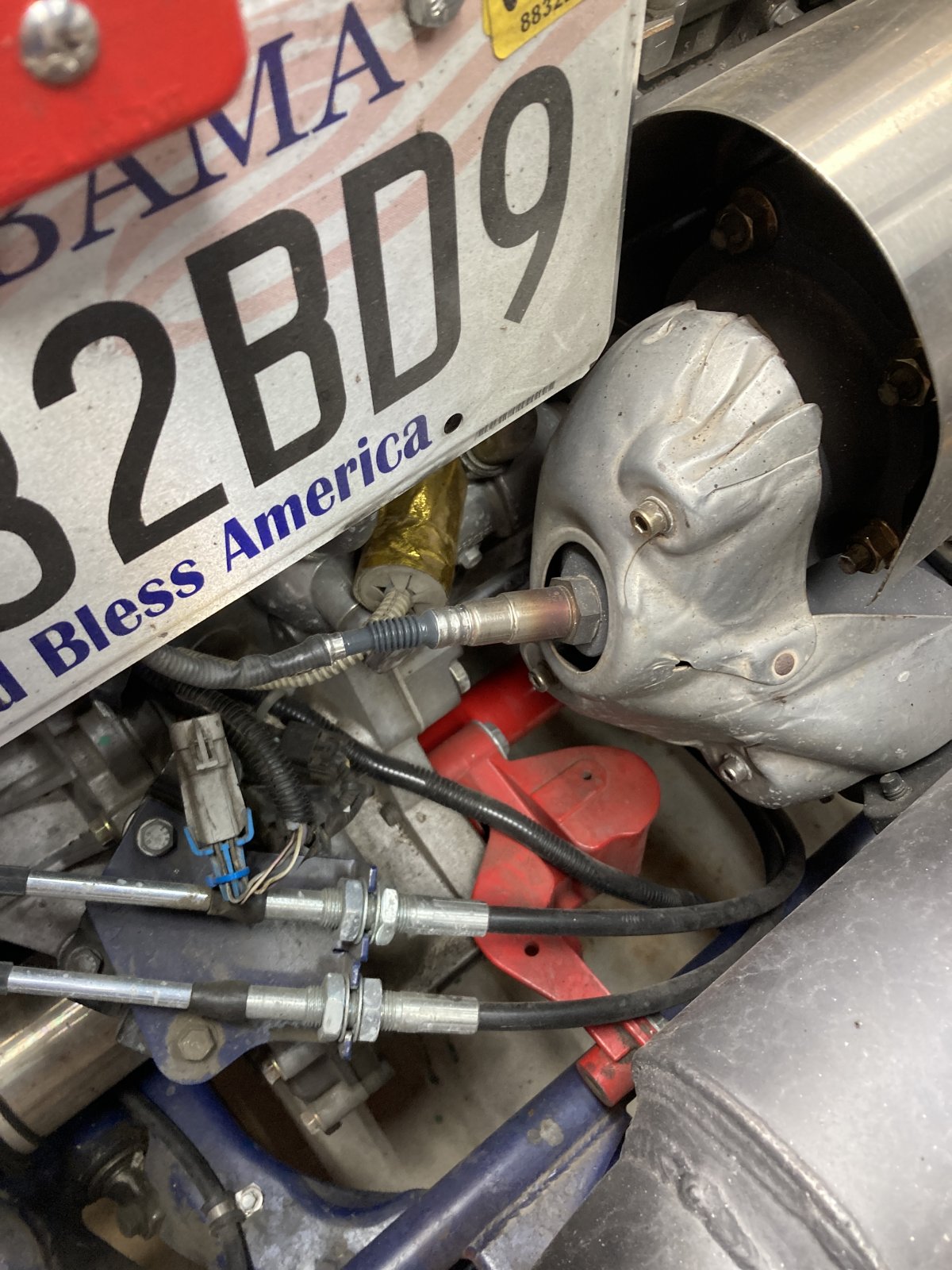

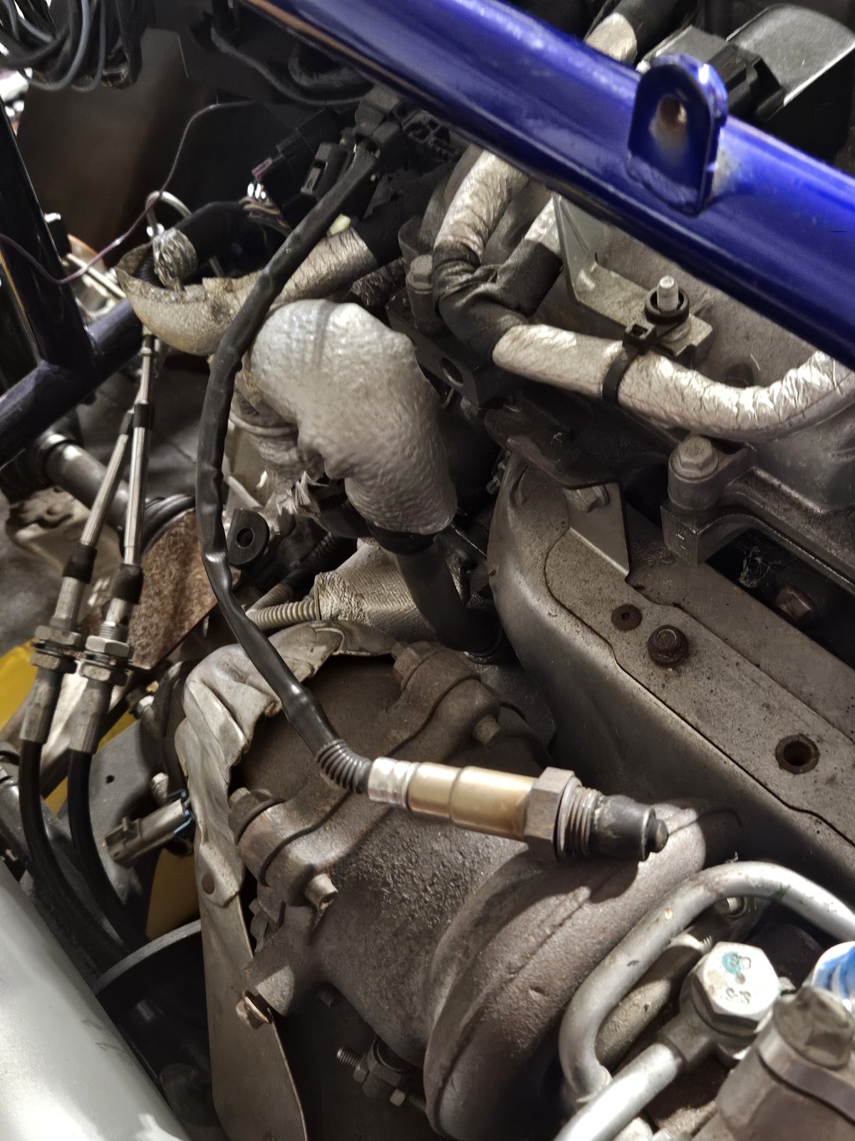

Also while we're at it, where does the O2 sensor go?
49405

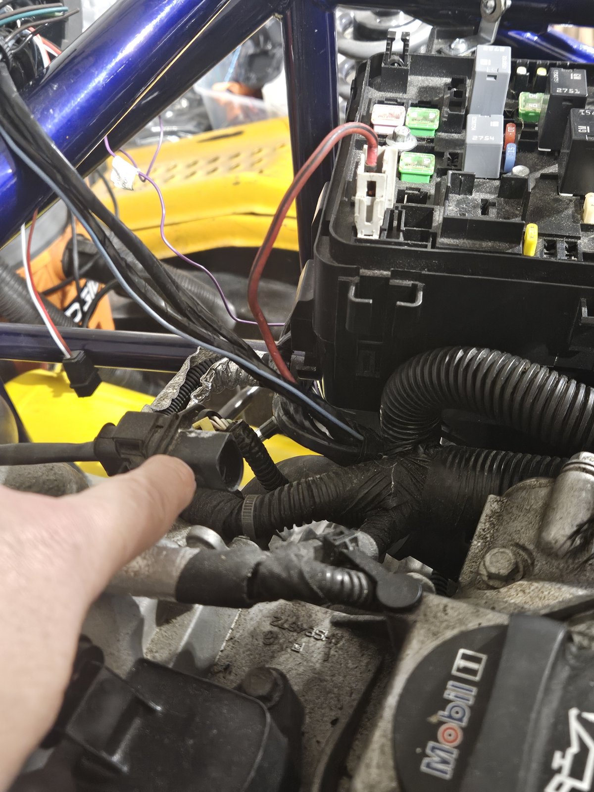

Wondering if something needs to plug in here:
49404
ccgillett

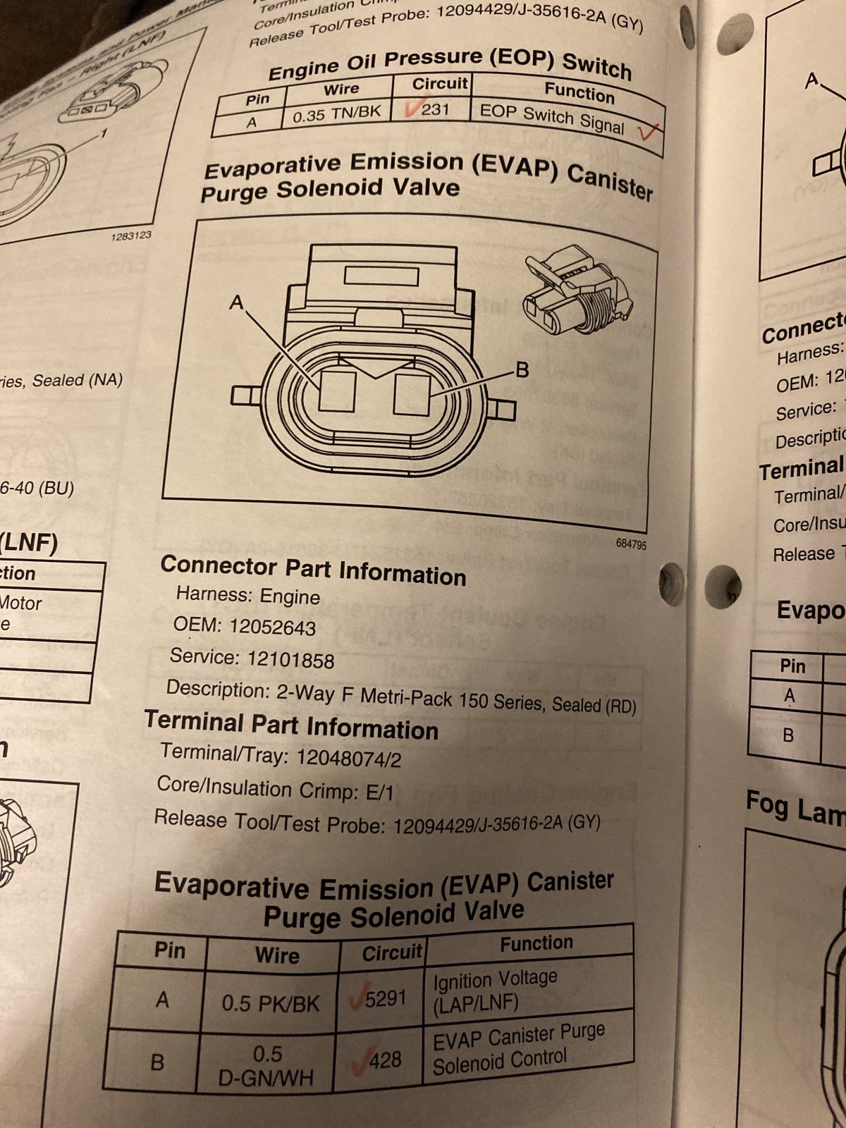

Ok one mystery solved (and I dope slapped myself so you don't have to). Now just need to figure out where to connect the MAP sensor I need to order... :D
49416
Last one I answer without an end view. It appears to be the evap purge solenoid. And the wire colors are pink w/ black stripe and green with white stripe. Details matter.
