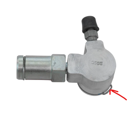

This is the clutch distribution block on top of the F35 transmission, with the 'zerk' bleed nipple on it.
51357
If you pull the clip at the arrow, and lift it up, you see this circled end of this clutch pipe is on the outside of the transmission. Check that it only has one o-ring on it, that it is in good condition, and that there isn't a second o-ring inside the distribution block. Also, that clip has to be put on correctly.

Is this the same as the F23. Looks similar enough to give it a shot
Ross, he is working with an F23, which uses a different T/O connection design.
Make sure the T/O bearing is not leaking. When that happens usually you get a nice puddle of hydraulic fluid on the floor but sometimes a bellhousing area holds the fluid(usually because the leak has collected enough clutch dust to sort of "seal" the separation). The F23 doesn't have the nice viewing window the F35 has, darn it. Either snake a bore scope into the area or loosen the bellhousing bolts just a turn or so, wiggle the trans and any liquid should drip or run out(all over your nice clean floor).

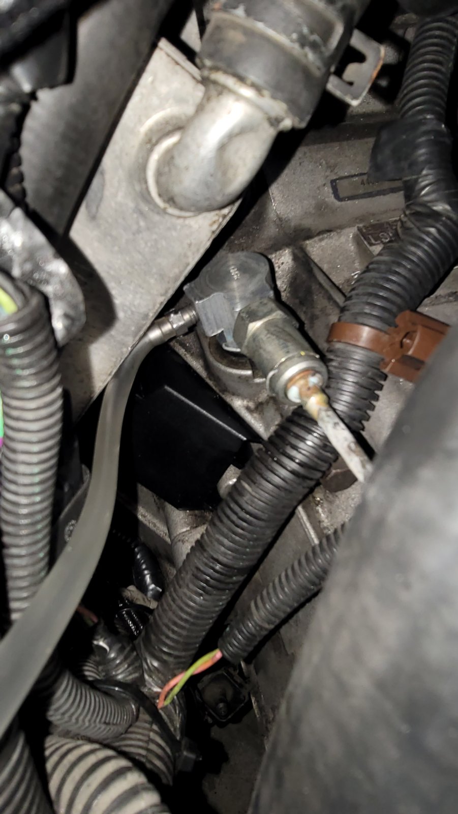

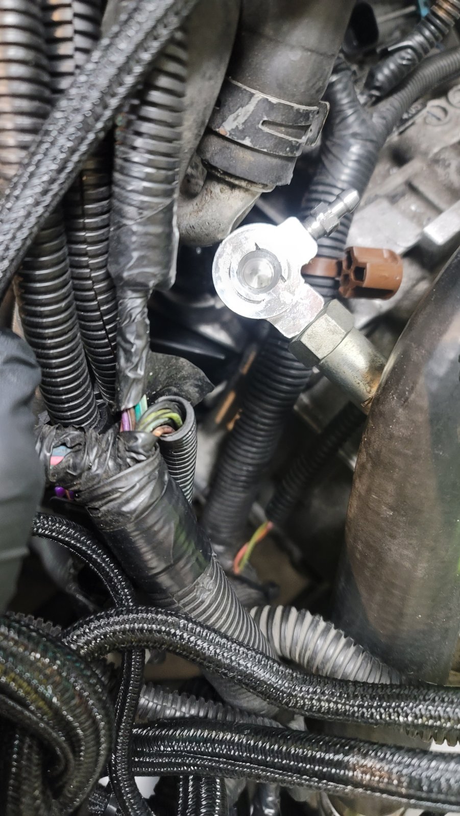

This is how loose the elbow is... gotta be what the problem is... Not sure if the fluid is from when I bled it or not, but probably not.
No big puddles of fluid under the car, so that's a relief. There is a plastic cover, that can be removed to view into the bell housing...but idk what I'm looking for in there? A lake of fluid in the bellhousing?
Is there a way to confirm that this is the air leak?

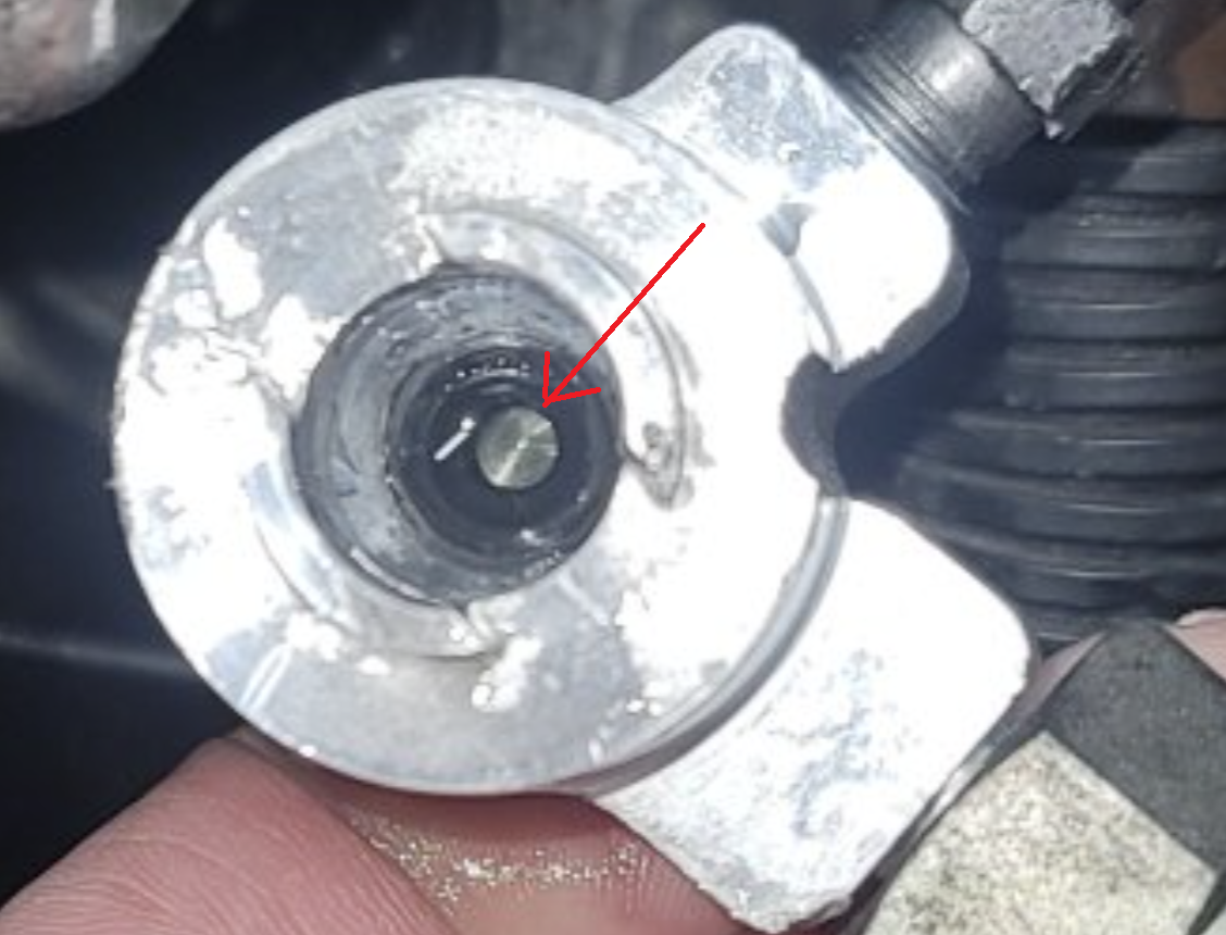

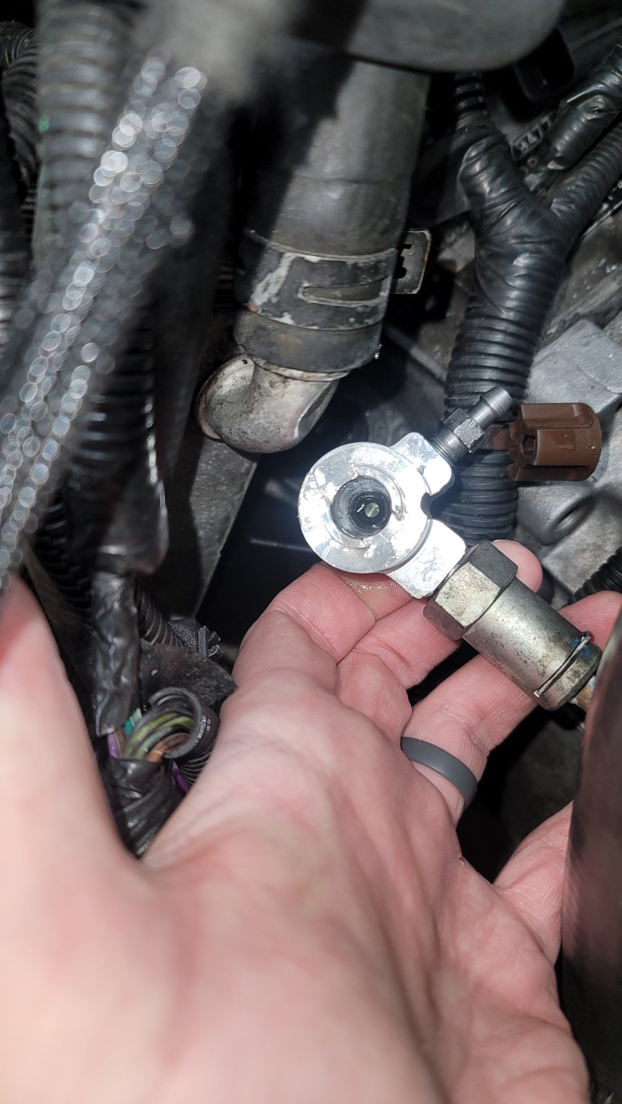

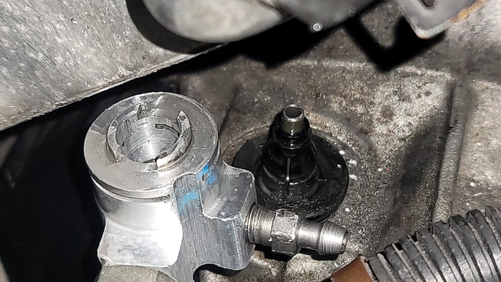

Update: took off the clutch elbow and the fitting seems to be working properly. I troubleshot the zerk fitting and when I try and apply a vacuum with the zerk fitting closed it won't hold vacuum. So I'm thinking leaky zerk? The black seal deep inside the elbow looks misaligned in the 3rd pic?

Is that a black seal deep inside, or is it a O ring off of the part that goes in there?

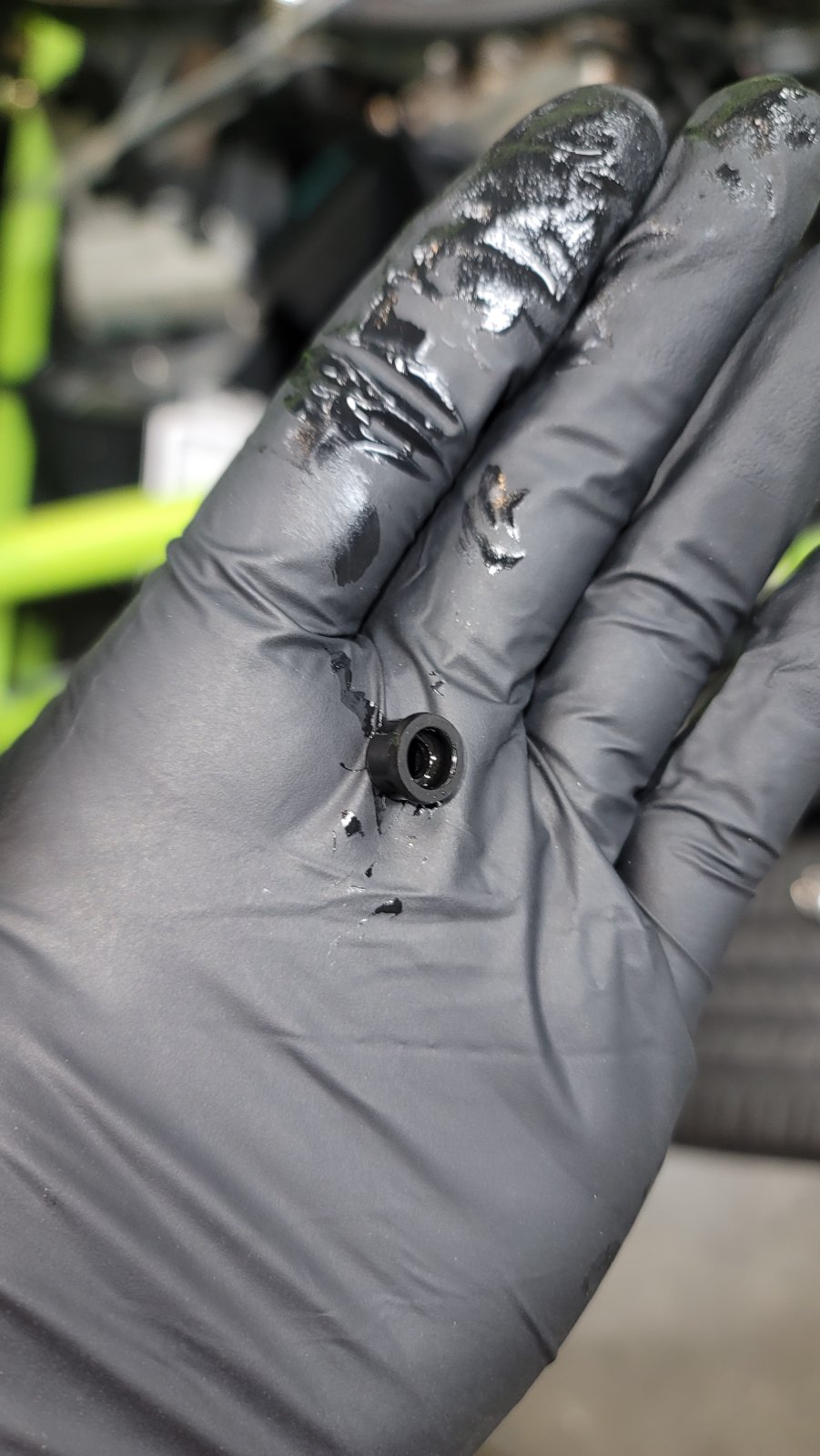

The black rubber seal is either broken into 2 pieces or there are 2 there as it looks like one is jammed up in the elbow. Also if the one on the nipple isn't broken in 2 pieces then it is jammed on too far and the seal looks scrunched down...at least that's what it looks like in the pics.
ToothMagician

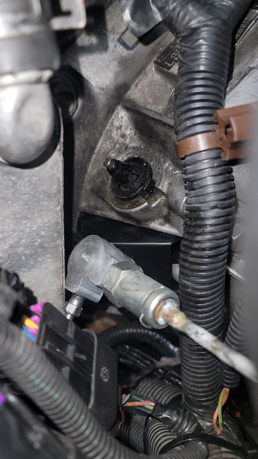

So I took out the seal and it seems perfectly fine. Only one, so I put it on the nipple and replaced the elbow. No change.
