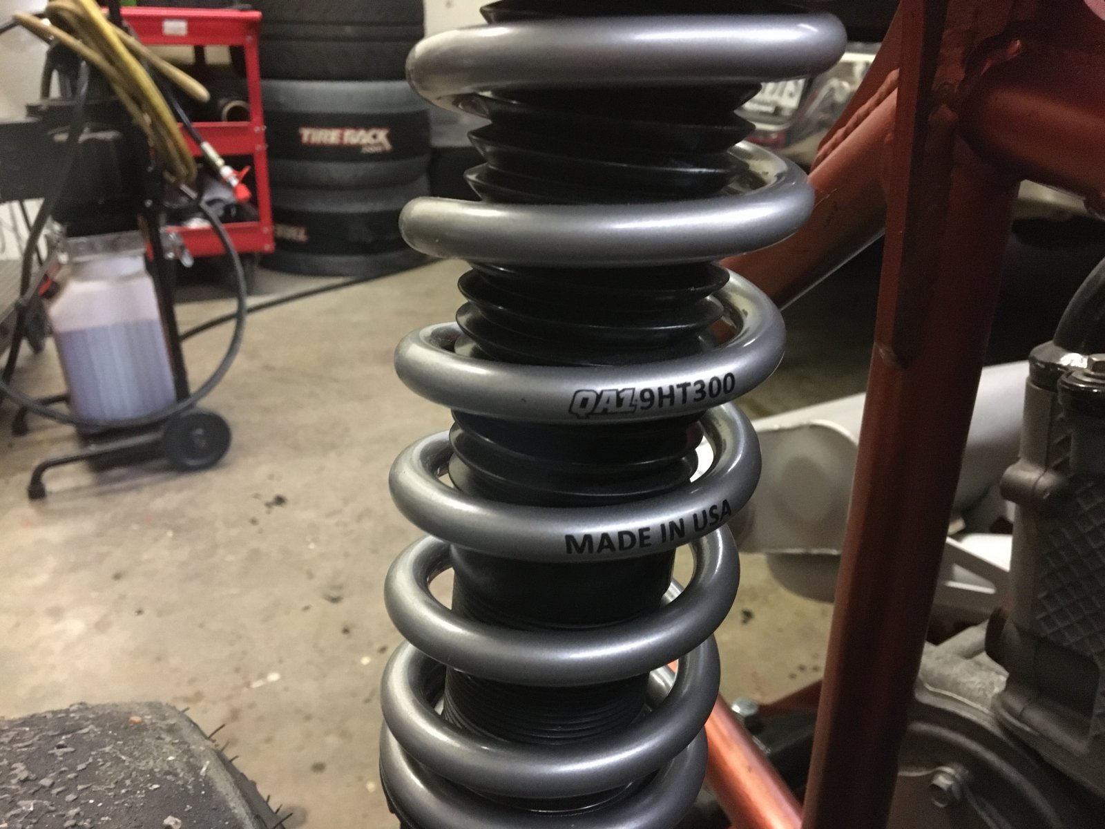

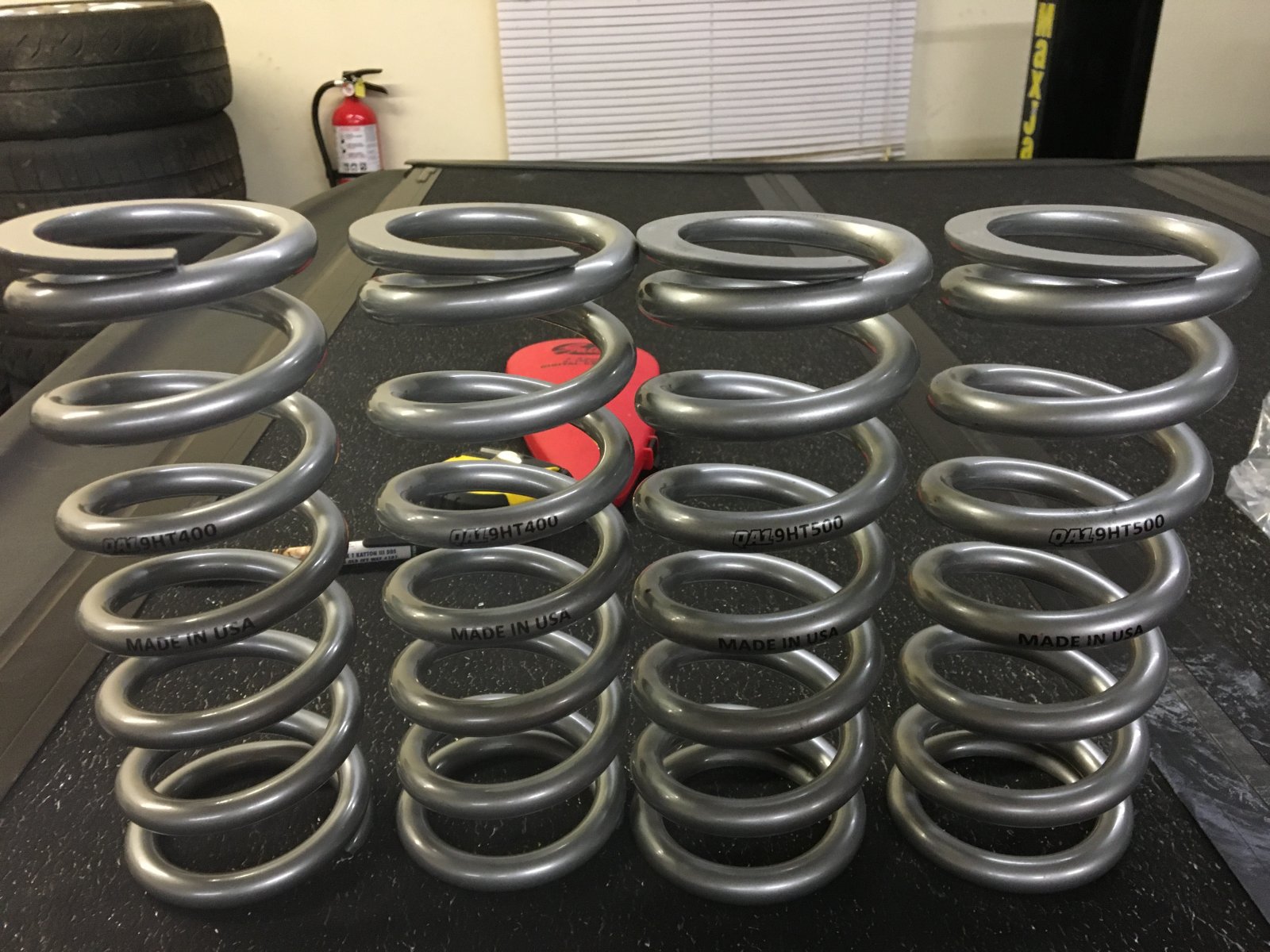

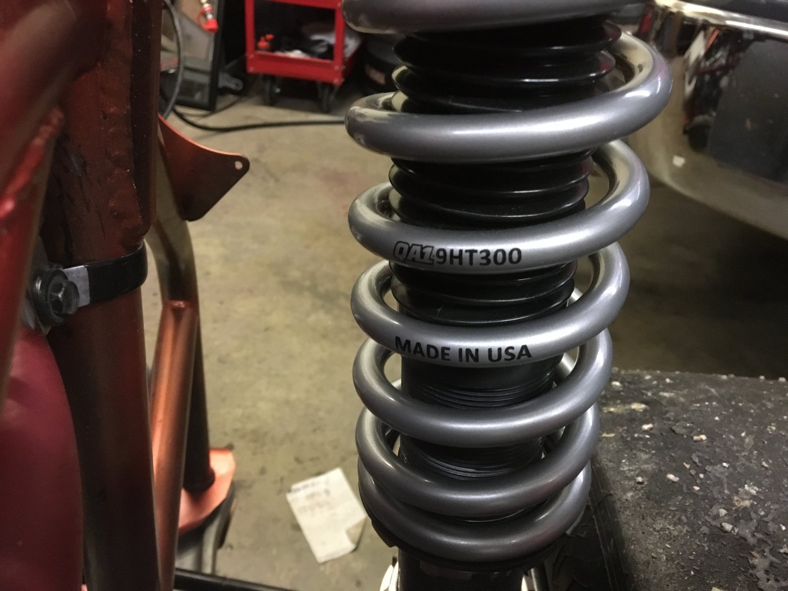

Do you already have 500's ? I have some and used them once planning on going a different route. I have 2-300's 2x400's and 2x500's if anyone wants them I will ship them for 50 a set. No point in having them sit around if im not going to use them. All QA9HT-xxx still powdercoat grey

Can you post a pic of them...think I will take them all!
ccannx
I will go run out to the garage and snap a pic. The 300’s are on all 4 corners of the car but I’m replacing one set of them with variable rates so I don’t need all 4 just 2.

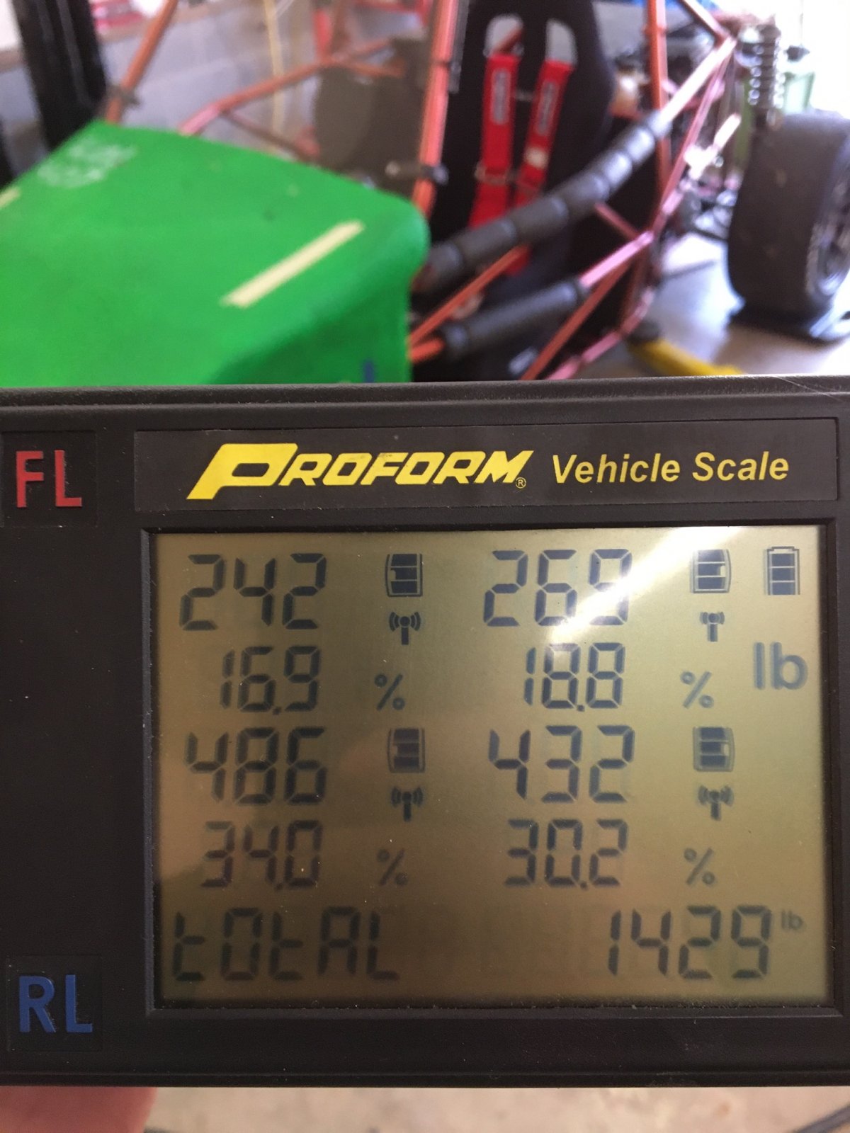

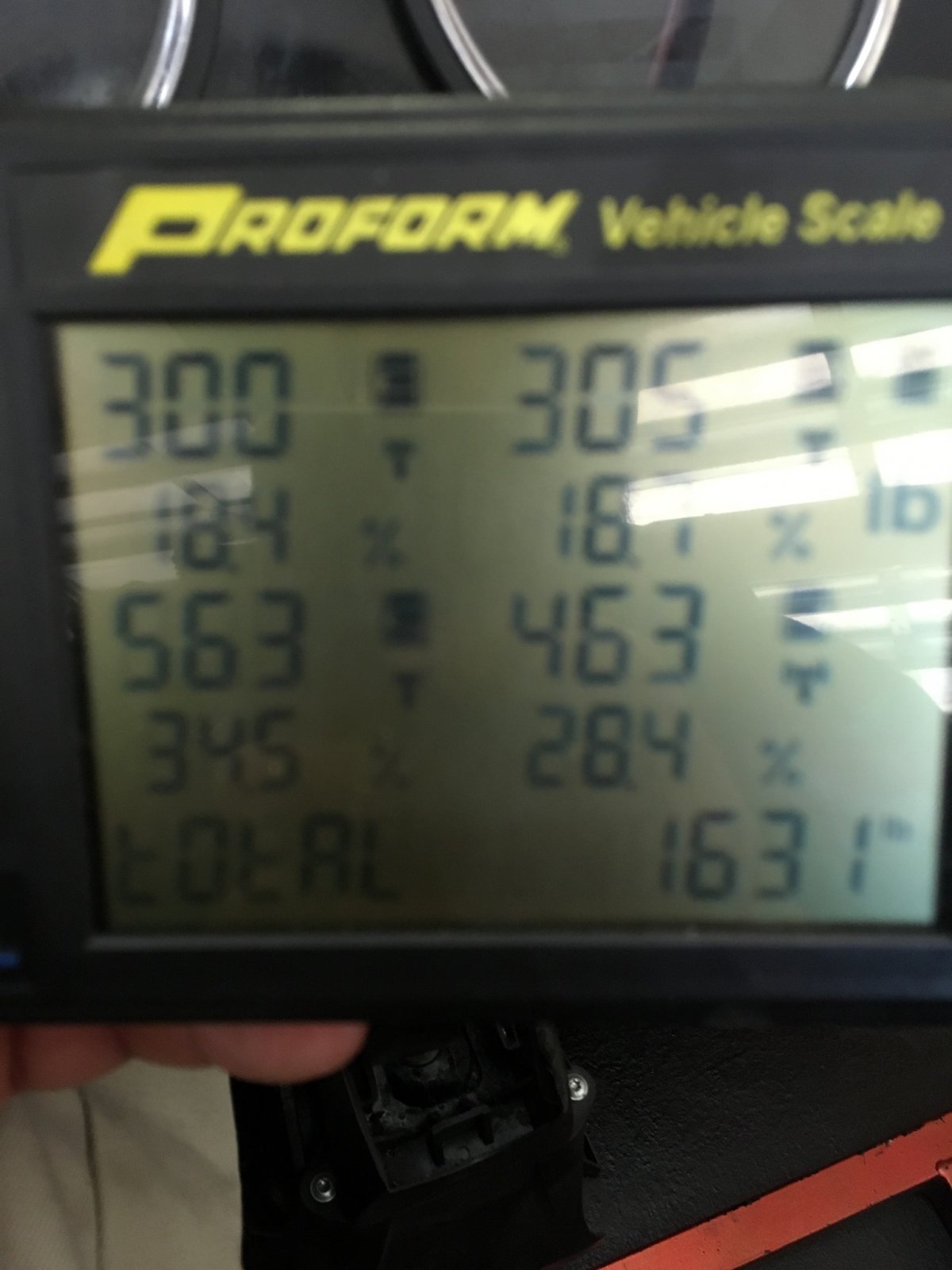

So has anyone scaled out their car and used different spring rates on the corners based on L-R weight balance (or F-R for that matter)? Or added ballast to scale the car out? Thinking Autocross here...
George
I was able to balance mine without adding weight. Make sure the swaybar is disconnected. The reconnect so that is neutral when done with drive. May need to make one end adjustable.
We are in the same boat. I believe George has gotten the furthest with this so far. I started a thread here : http://dfkitcar.com/forum/index.php?threads/suspension-and-spring-rates.1485/
I have very little knowledge about suspension but trying to learn and share what I know and read. I've been told to run super high spring rates and I've been told to basically run the car on bumpstops so I don't know who to believe anymore.
I'm aiming at finishing the car and then using 1/4 plate or thicker if needed at the front anywhere on the floor-pan of the car to get up to the 1700lb emod weight as needed looking about 50-70lbs to add to meet weight requirements for class.

Yep, definitely on the sway bar disconnect (have setup circle track cars) before scaling. Are you Autocrossing yours? Would just think that messing around with different spring rates on the corners and getting the car basically 50-50 on weight with driver in seat could be a huge advantage on these cars
George
Autocross some, I am not a talerted driver so I have some younger more aggressive divers drive also. My racing expertis has been mostly building,setup and campainin cars. Normally 4 cylinder circle track and road course.
Hopefully at the beginning of the season during test and tune I can travel where another Goblin is running so we can work together.
Currently have 3 sets of front shocks with different spring rates and 3 different spring rates for the rear and 40# and 50# spring cushions for fine tuning rates either end.
