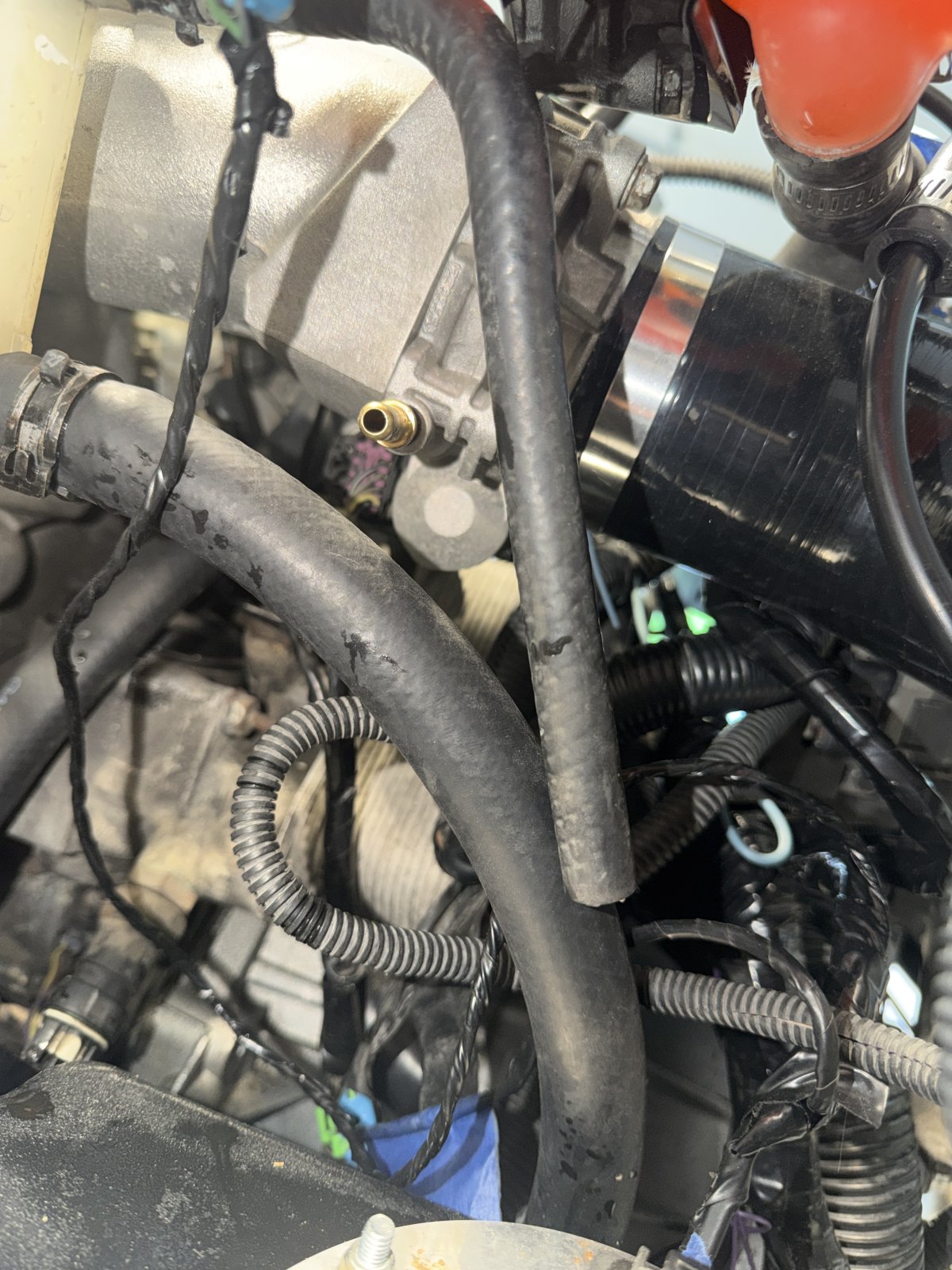

Finally got my engine put into my car and couldn’t get it to fire. It would crank just wouldn’t fire. I went through every ground and cleaned them. Go to start it and it now sputters and sounds like it’s going to pop off.
checked spark and the 2 cylinders on the passenger side are getting very good spark and the drive side 2 cylinders are getting spark but not very good spark like the passenger side two.
Has anyone ever heard of something like this?
the engine wants to start… I can feel it!
How do you quantify good spark versus not good spark?
My input is not going to be super Goblin-specific if that's still helpful.
If you swap a coil from #1 or 2 to #3 or 4, does the issue follow the plug?
How about a spark plug?
How about an injector?
If the issue follows parts swapping, then you've probably identified your culprit.
If not, we can start tracing wiring back to the fuse block or PCM, but based on my preliminary inspection, the +12v, low ref, and ground are common to all the coils. My hunch would be that you're not experiencing an issue on 2 of 4 cylinders with wires that are common to all 4 cylinders, but it's still a definite possibility. But for my $0.02, given that you've said you've already checked all the grounds, I'd start with swapping coils then plugs then injectors.

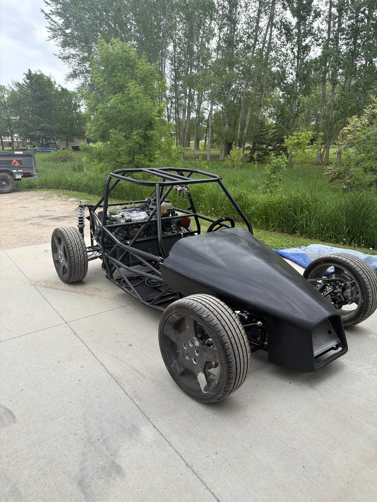

Well well well… just got the car back from powder coating last week Friday the 22nd and I am getting it built quick. Too nice out not to want to drive it. Having engine problems with running on 2 cylinders. This engine has been sitting for 3 years and we came to the conclusion that 2 injectors were clogged or bad. Either way I’m replacing all of them. Installed new spark plugs. Injectors are suppose to be here next week. Still have to find nice seats and harnesses. Otherwise I’m on the search for wheels and tires as well as a wing.
