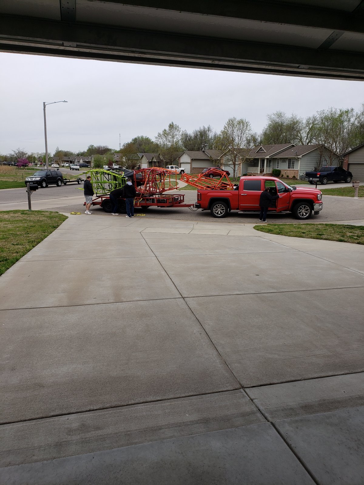

In some situations, multiple buyers have made arrangements to work together to send one truck/many kits to help save on freight. No promises you will have that opportunity.
I drove a hour to meet up with someone on their way through Missouri to pick up Stage 2. All they had to do was pull off the interstate and I met them there. Saved me a 20 hour round trip. Just a couple of days ago, about 5 kits were delivered to their owners from one truck.
Tim Moland
One of those was mine!
