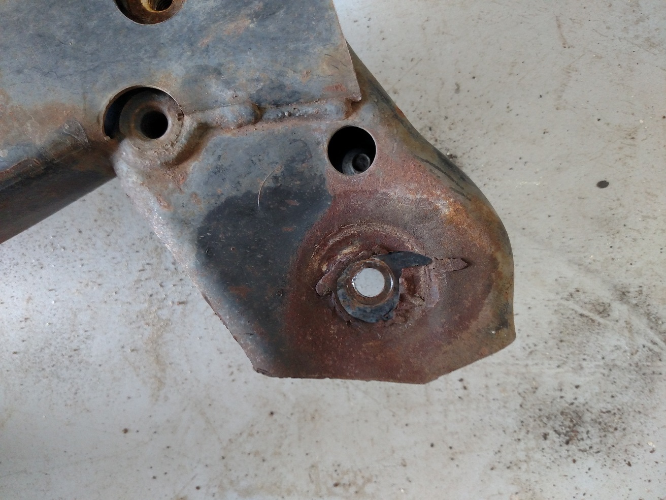

And here is the damage... The round hole is where it actually mounts to the chassis where as the rusted out hole above it is the one I am worried about.
I guess I could get a large washer and have it welded onto cradle but how much is this area rusted? I think I know of a possible (cheap) cradle locally so I will check that out tomorrow.
T
I have a welder, so that is what i would do. I would buy one before I paid a welder though(100$ in the yards around me). Good to know they all interchange.
