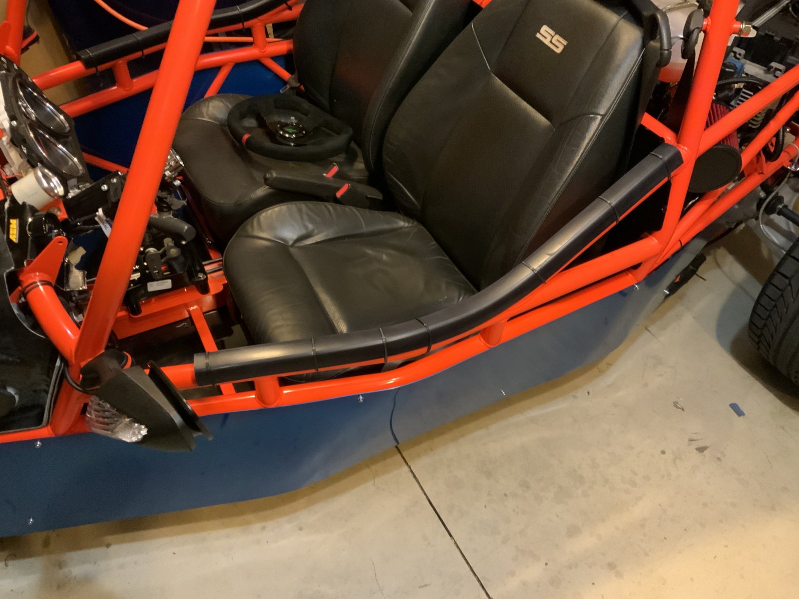

Door Bar Style: Easy Entry "Modified"/Double Bar
This is the most agonizing choice for me because I want to balance ease of entry (wife acceptance factors in big here) with having a nice arm rest and better side protection. So for any of you tall-torso Full Door and "Modified" Easy Entry owners out there, please weigh in on how your ingress/egress is and whether the door bars are still good as an arm rest. The "Modified" Easy Entry is another common frame mod that doesn't appear on the web order form so it'll be in a pre-order email.
I do wish I had ordered the Modified Door bars.
I have the standard door bar style but haven't had the opportunity to sit in other styles. I can't imagine anything lower being more comfortable. I've read that the full cage makes it easier to get in (extra stuff to hold onto) and harder to get in (now you have an overhead limit)

I have been riding sport bikes for over 20 years, so I prefer to wear a helmet in the goblin. The wind is very similar from motorcycle to goblin, so it doesn’t bother me.
you can put the footwell cover in at anytime. I have mine and have yet to put it on. With no sides, the heat just flows through and I really don’t feel it. Although when it’s 100* outside, it’s all hot no matter what.

I’m 6’2” 310. I have the double bars. The quick release steering wheel makes getting in and out easy. I added some roll bar padding it’s pretty easy to kinda slide in. The wife says getting in and out is easier then she thought it would be.
I will add, I found it much easier to get in and out once I added the quick release steering wheel on my standard door bar car. It's probably not as necessary on a lower door bar car.

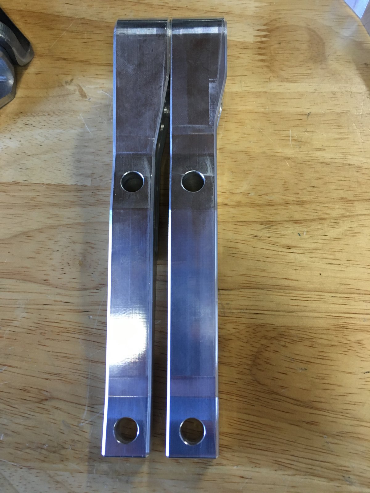

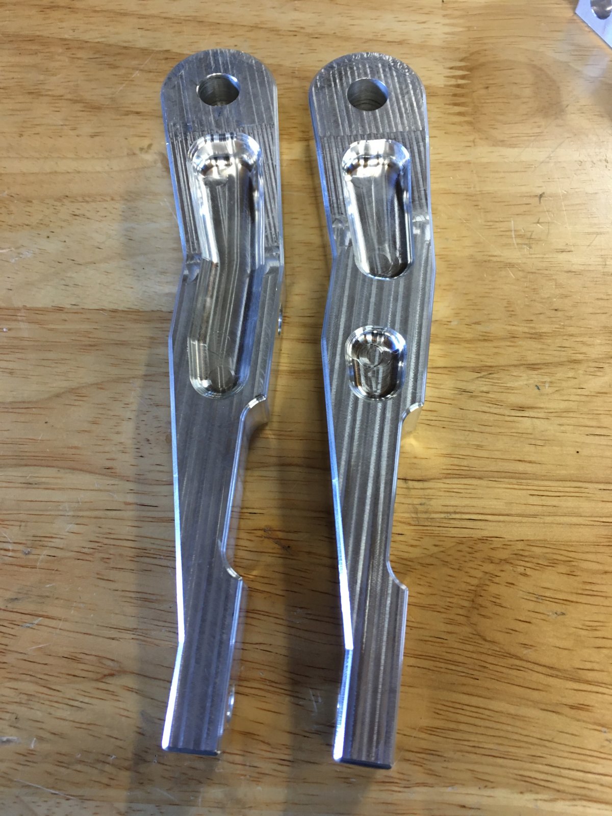

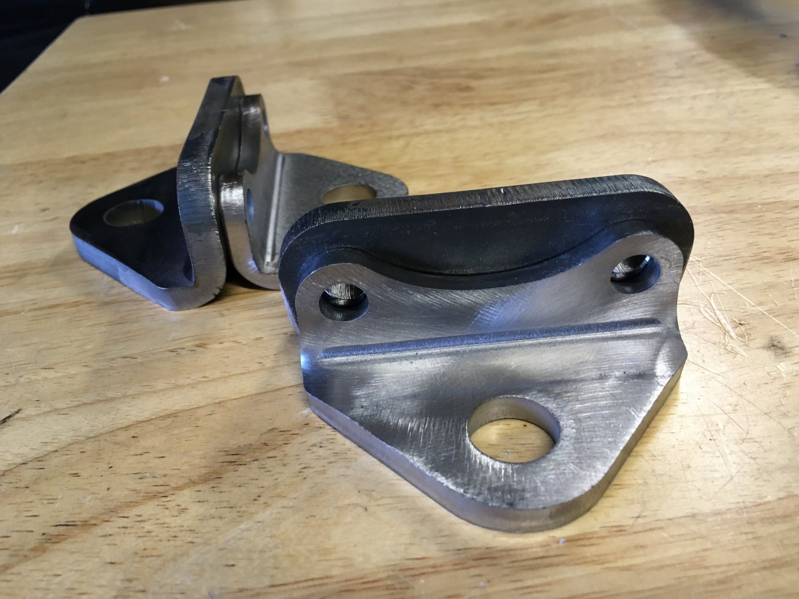

Joebob
Something I would add is to upgrade from the start, the upright brackets and the steering arms. With aggressive driving on sticky tires, they tend to bend or break. Is is easy to change out later but makes easy to do on initial build.
See differences between standard and HD below.
Joe
Ya. I second……..eerrrrrr third, fourth? The upgraded parts if you are going to track it at all. There’s tons more for upgrades, but build it stock, then upgrade is a way to go.
Excellent! That photo is very helpful for getting a sense of the proportions, and I like the padding idea.

neodied
Alright, makes sense. I'd rather upgrade failure-prone bits now and not risk a code brown moment on the road. The upgraded lower rod end mounts appear to be these:
But I don't see the steering arms. Did you get them from the DFKC online store?
