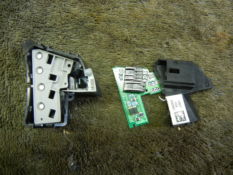

Since it's so cold today, I spent some time dissecting the cruise control and info button pod on my 2007 SS/SC. Not sure if this is the same used on other SS models. This schematic I made includes the resistor values used. Not sure why the values are different for some of the LEDs used in the illumination circuit are different. It was cold in the garage and I was shivering a bit, so I may not have this 100% but I feel confident in it.
I'm probably going to use the circuit PWB and wire the external switches to it.
Enjoy.

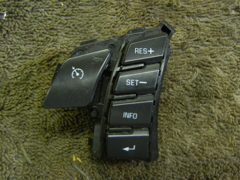

Also, can you post a pic of the left/right steering wheel control buttons? I didn't save mine, and I'm having a hard time visualizing them

I don't have any pics of the right side since it was all audio controls and I wasn't going to use them.
Here is the left side.

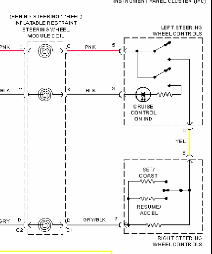

This is what I found for a 2005. It's a different schematic but it very closely resembles my schematic, just drawn different. I'm sure there are different versions of this setup out there for each model/year.
Something doesn't make sense. The '07s and '10s are consistent with your original diagram by having the resistors in parallel, but the '08s and '09s have their resistors wired differently in series.
I wonder if the left steering wheel control is different for those two years. Can anybody confirm that?
