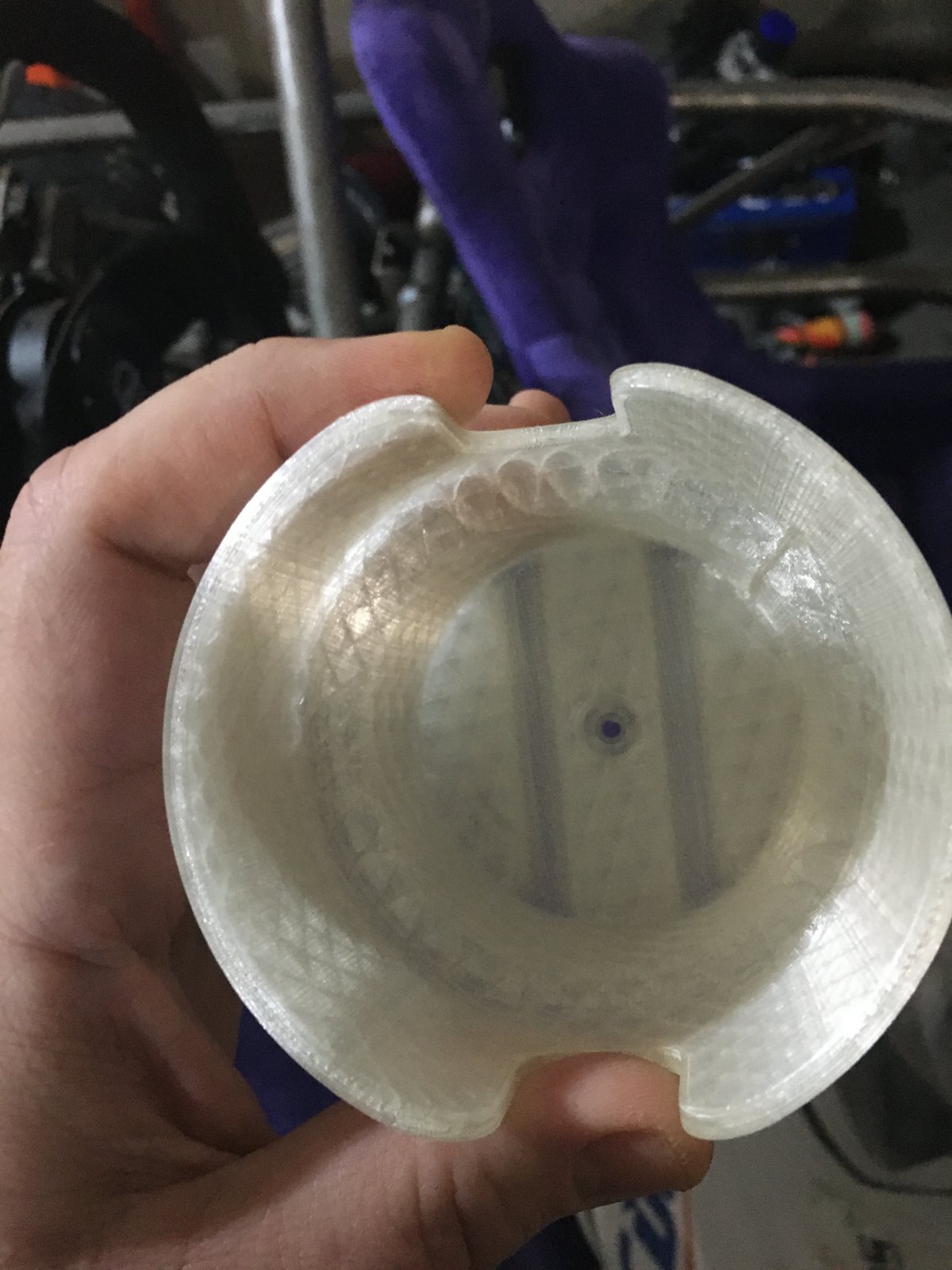

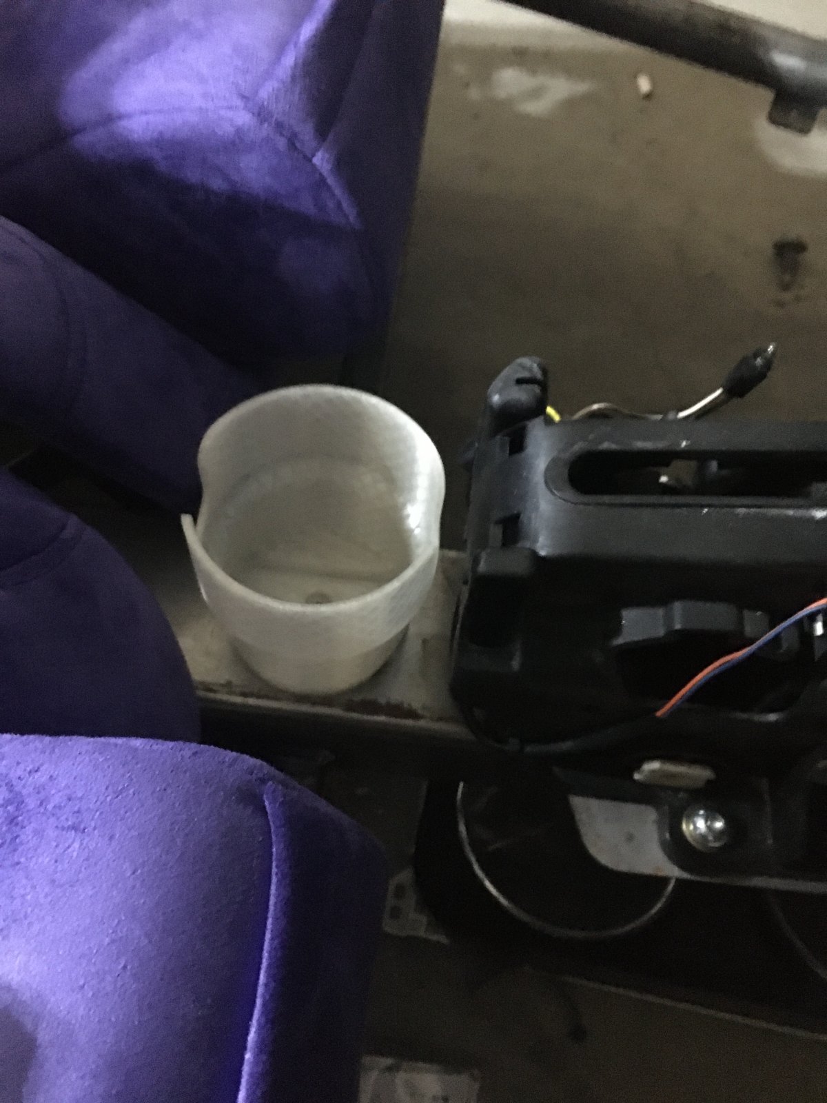

The Mayor’s new cup holder printed out great. For you total noobs out there like myself it printed fine with no supports. I went 20% infill with normal PLA and it’s got a little flex. I’ll print another one a little more solid. Here’s some pics

Either you have big hands, or it looks a little on the small side. Have you tried to put anything inside of it yet to test fit?
It's designed for a 77mm can with very small tolerances... It should be very snug.
I designed this to be printed without supports for my printer and my settings. That's not too large of a bridge to print and the overhangs aren't too difficult with a decent enough layer height. With supports, however, it's even more clean. 45 degrees is usually a safe bet for angles, I'm not 100% sure what those ended up being... they're a 14mm diameter circle split in two so whatever that ends up being.
Regarding your rigidity, try more side walls. I usually print with 4x walls and 10-15% infill (I forget the fill option in cura). The infill isn't what gives it rigidity as much as walls and layer height do (in my opinion) I've found that 4x walls is the sweet spot for super sturdy prints, regardless of infill.
I usually print .1 to .2 depending on how large something is. If I want a quick draft for sizing I do .3 but then it's relatively weak in terms of layer adhesion including especially infill.
You don't necessarily need infill past the mid-low teen % if your other settings are spot on (in my experience) I do occasionally run with a higher % infill if I have large spots of flat surface with weird top designs on them, because the layers on top end up being printed on thin air and don't come out well... 20% gyroid does really well for those types of prints but it takes forever...
It almost perfectly fits a 20 oz Yeti cup. I didn’t measure it but if the top was flared out a few more mm it would fit perfect.
Thanks for the tips West. I am a complete noob when it comes to 3D printing so the advice is appreciated. I’ll setup a thick wall profile and try it again sometime. I’m really just burning filament right now printing random stuff to get the hang of it.
A lot of printers have different tolerances so I've modeled all my stuff with my printer in mind... it sort of sucks because it makes it harder for other people to print exactly like I intended but it is what it is.
I added 3mm to the top and 1mm to the bottom, the updated models are attached. I also made one with and without the cable paths for those who don't need them.

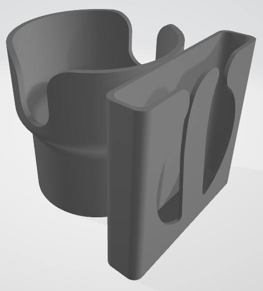

I made a new cup holder that's meant to hold your phone too... it does not have the tunnels underneath because I plan on installing it ahead of the gear selector. I have not test this print yet, and it's made for a pretty beefy iPhone with case... use/print at your own discretion. I made a little bendy tab on the phone pocket to help keep it in.
@Goblin Graber you may be interested in this one too? It also uses the larger format already built into it in from the above feedback.

This is pretty awesome, you should do one with the feet too. What are the dimensions in the iphone? I wonder if this would fit a samsung note series phone too. I'd definitely make one. What are the dimensions of your phone you used?
Mayor West
The interior of the phone box is 90mm x 15.5mm without consideration of the filleted corners impact. Different 3D printers handle tolerances differently so I added in about 1mm of extra width on everything.

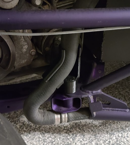

Coolant hose bracket to keep it away from the supercharger and the belt.
