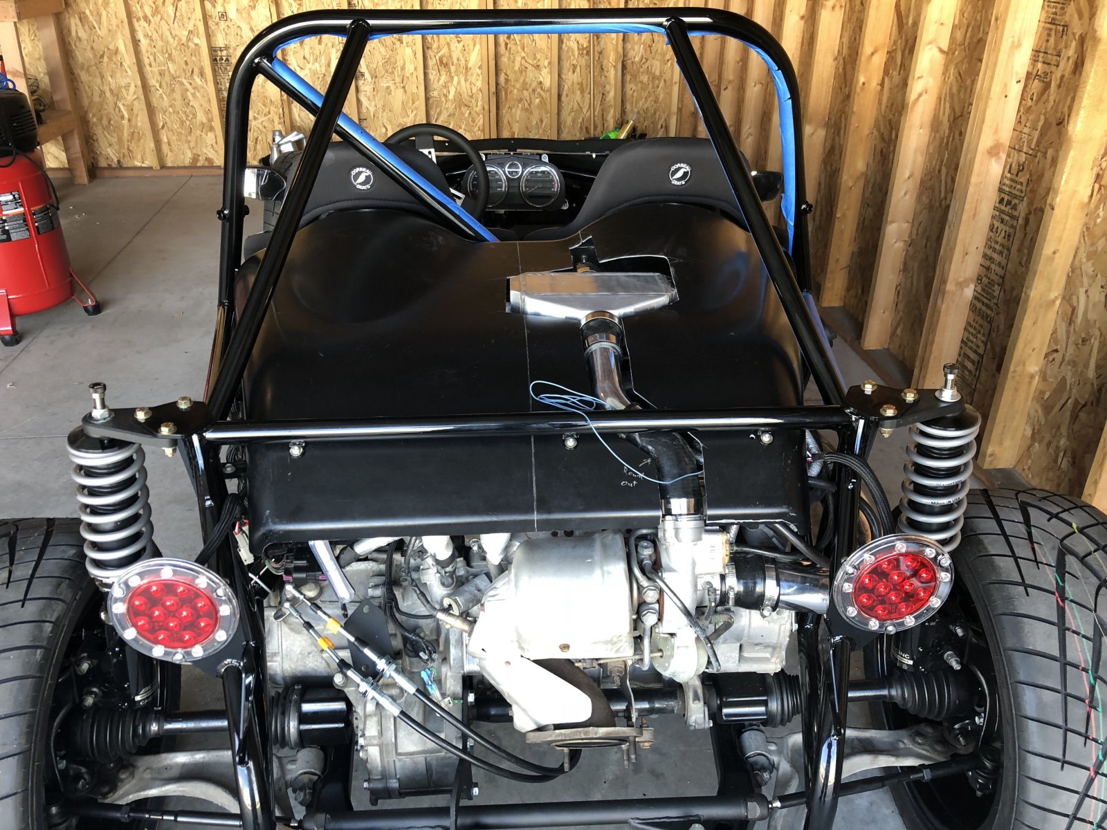

There are some visual references though:
JPas914

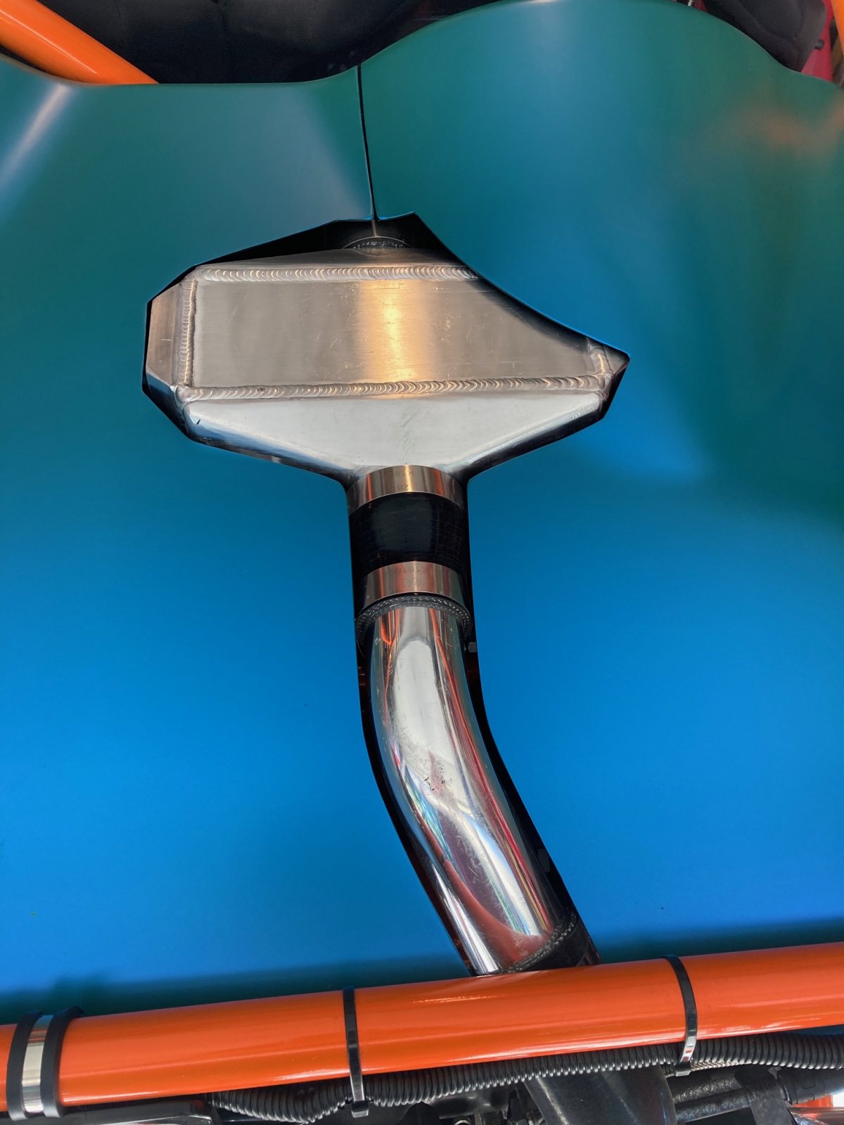

I used a dremel and several cheap cut off wheels. Then, I took a ton of measurements, drank a few beers and got to cutting. I used the center line on my engine cover as a reference point for my measurements, I also figured where that centerline would be on the frame. Once I had the cover split, and saw that it wasn’t trash, I felt way better.

Start with the centerline of the charge pipe and slowly start making cuts from there... Also remove the bottom rear portion, it will make it soooo much easier to remove and install the panels. I cut mine even with the mounting brackets to the cage. The cut at the front of the intercooler will not be as much as you think. The intercooler angles down and will not need to be cut as much. I cut too much off, not a big deal but it could have been better.

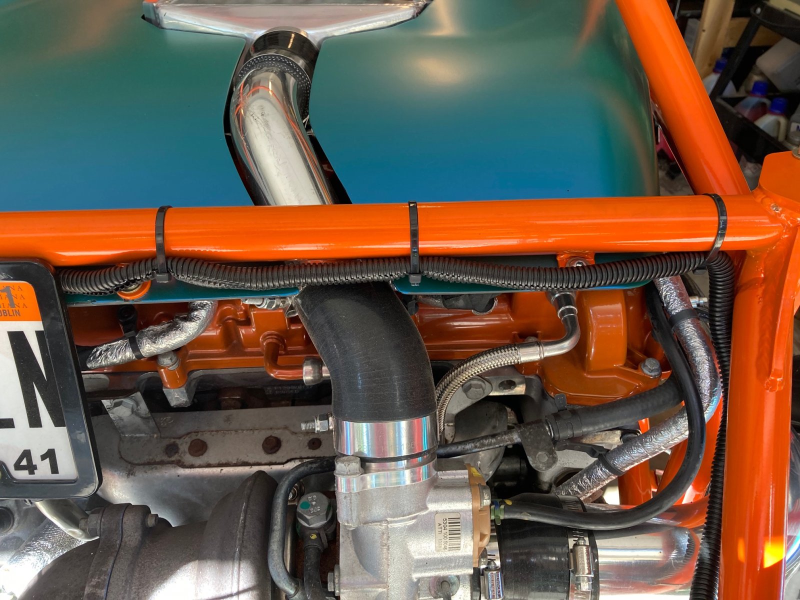

I left the lip on mine, just cut it back a bit. I wanted to hide my license plate lights up under it. Plus it was a perfect place for me to mount a third brake light. It’s a bit of a pain to get in place, but removing the charge pipe helps.

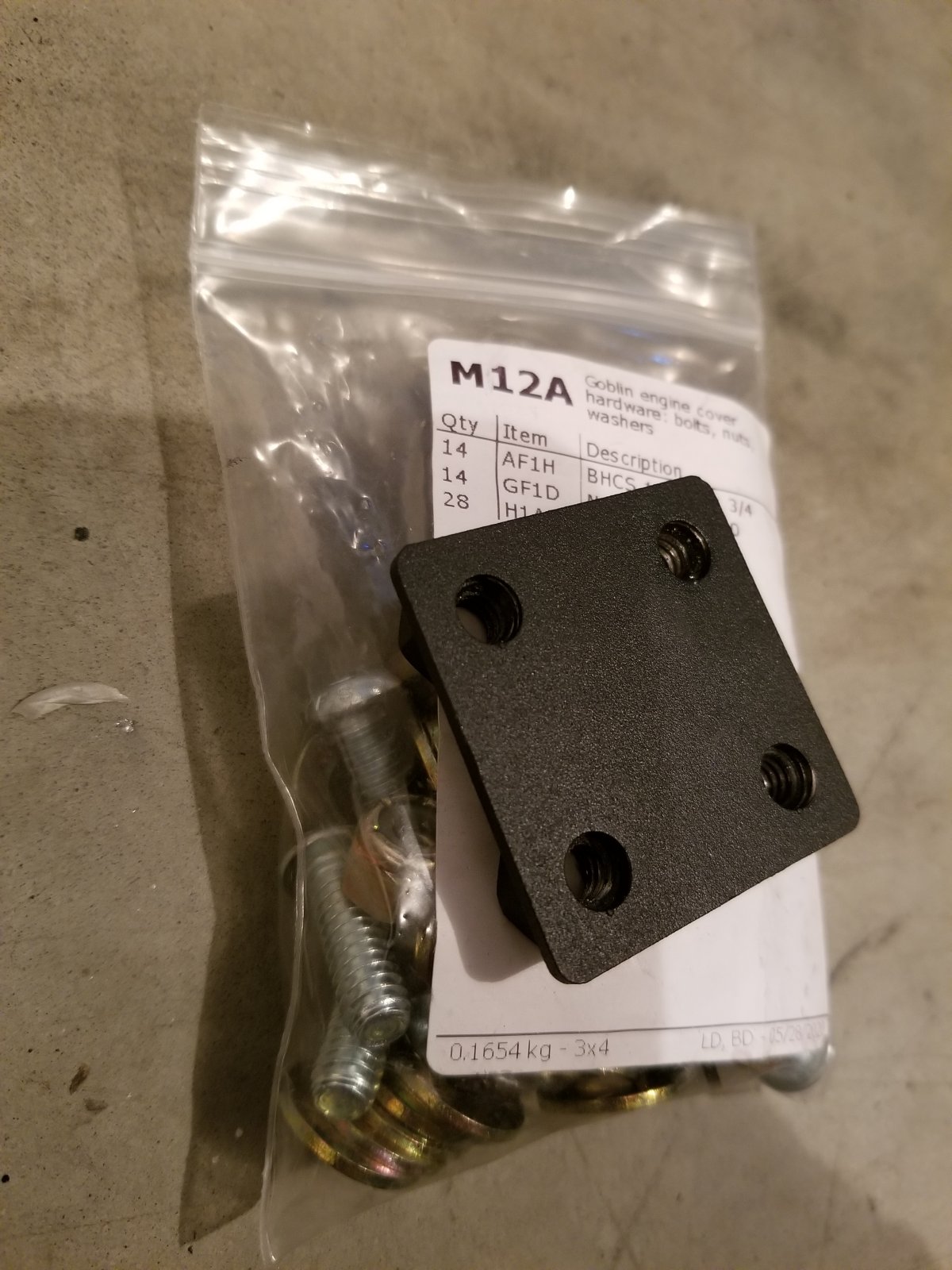

This is what you're looking for. My kit did not ship with one, I had to reach out to DF after the fact to get one. It's also not itemized on the label on the pictured baggie.
JPas914
A thin piece of steel from any hardware store works too, cut it into a square big enough to fit all 4 holes and then drill them out.
