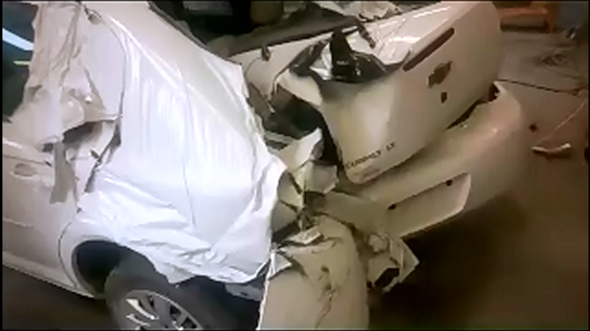

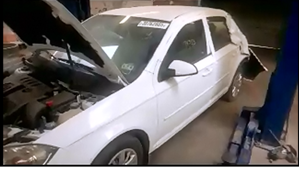

I never put a picture of my automatic Cobalt - 2010 - hit only in rear - 75,000 miles.

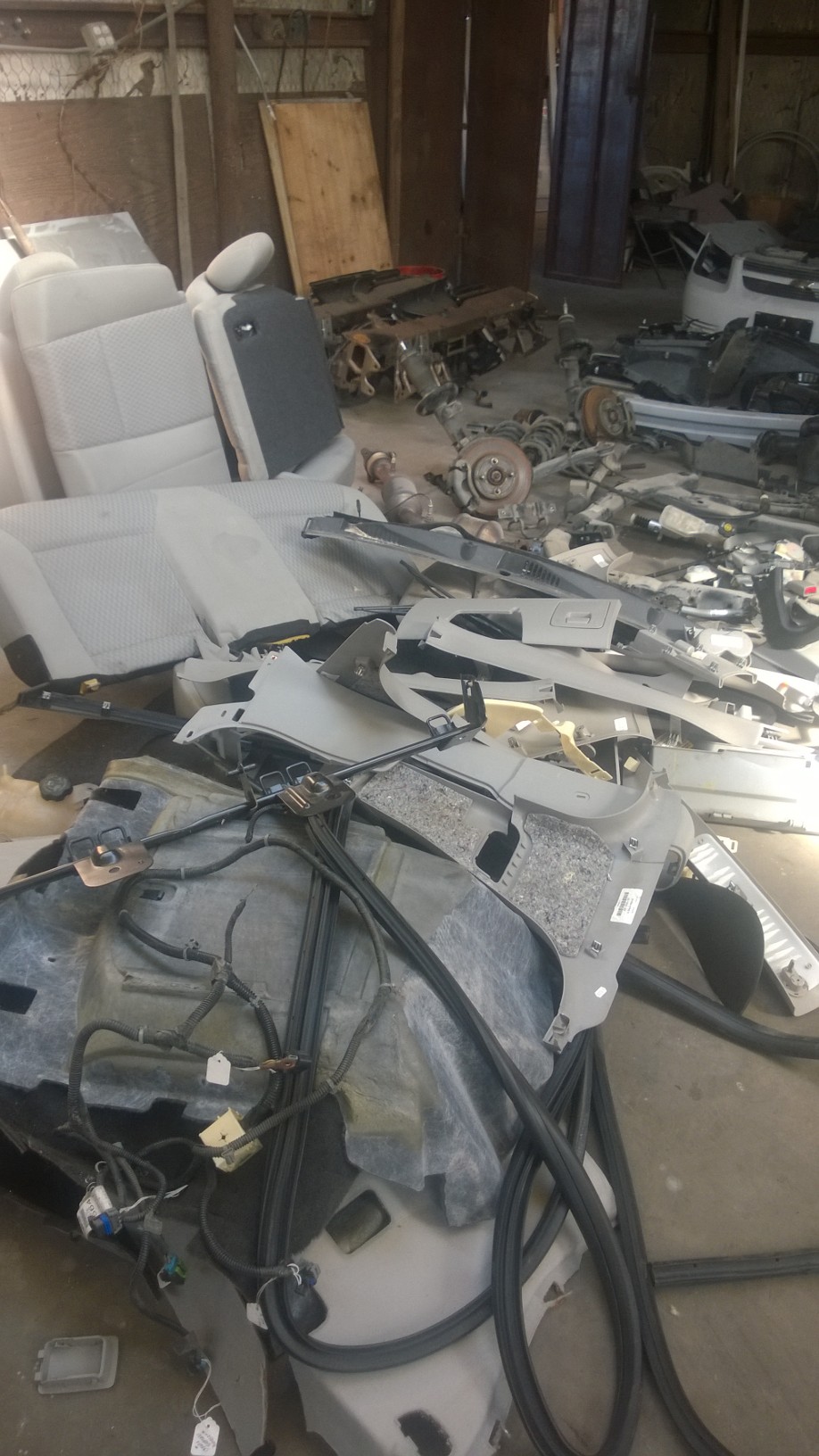

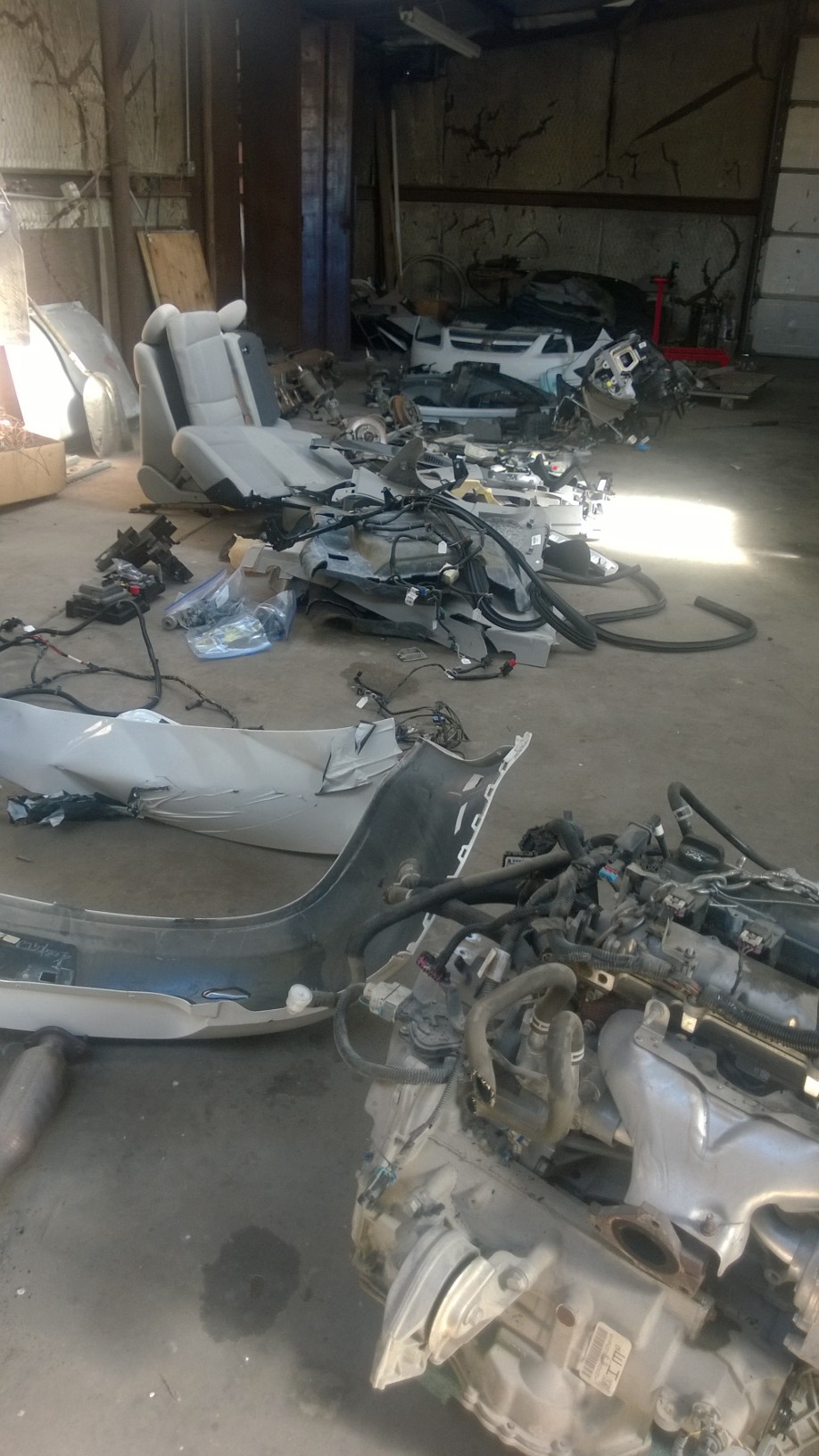

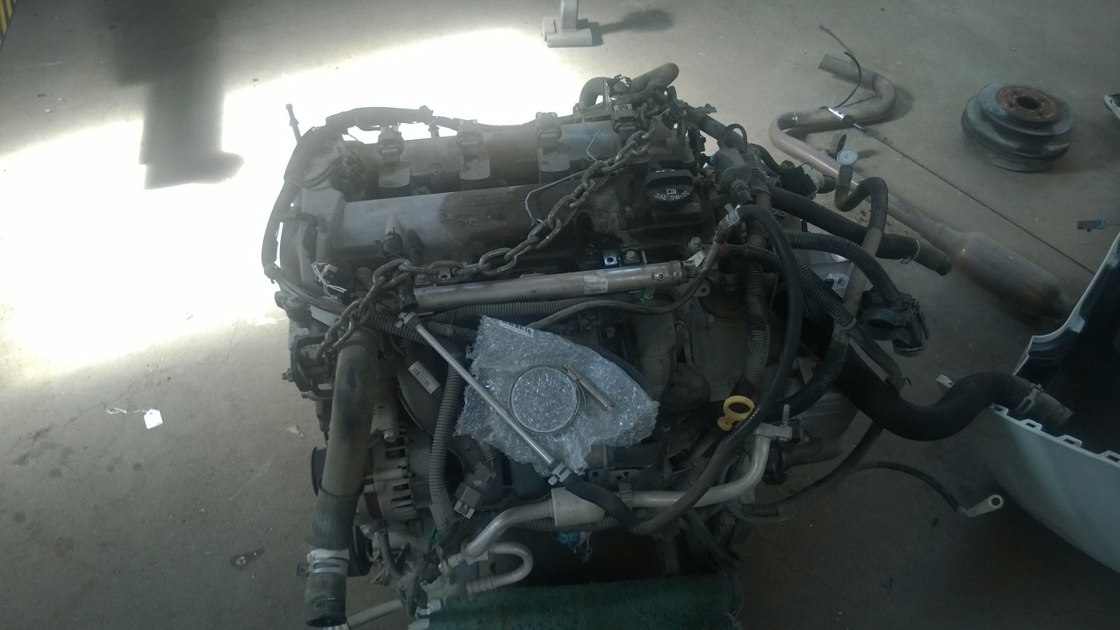

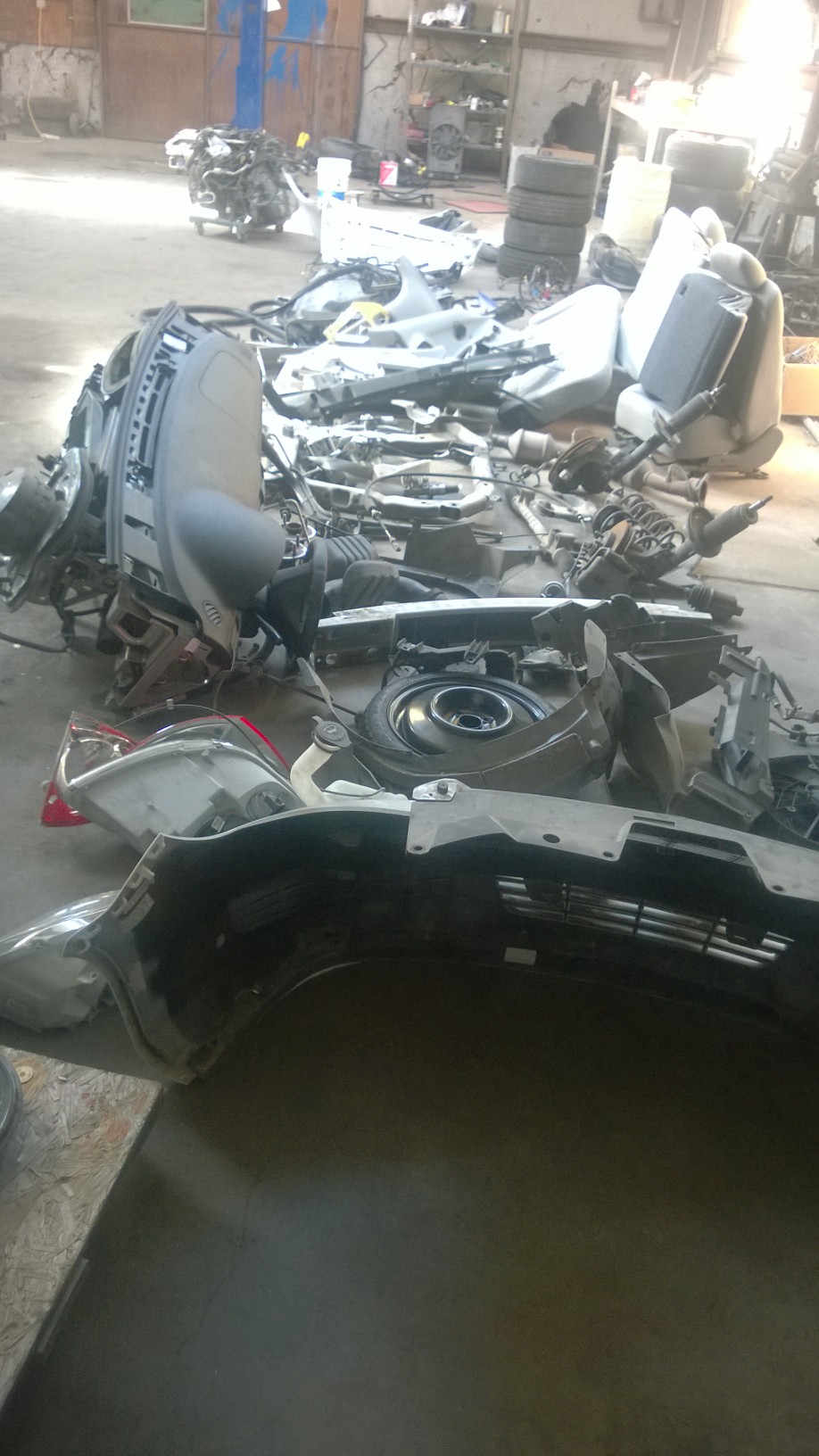

My pile of donor parts - I cant imagine how so many parts came out of one small vehicle.

Jkean949
Nice pile of parts Dan!
What are you planning on using for painting the parts after they are cleaned? Not specifically what color scheme, but what products...

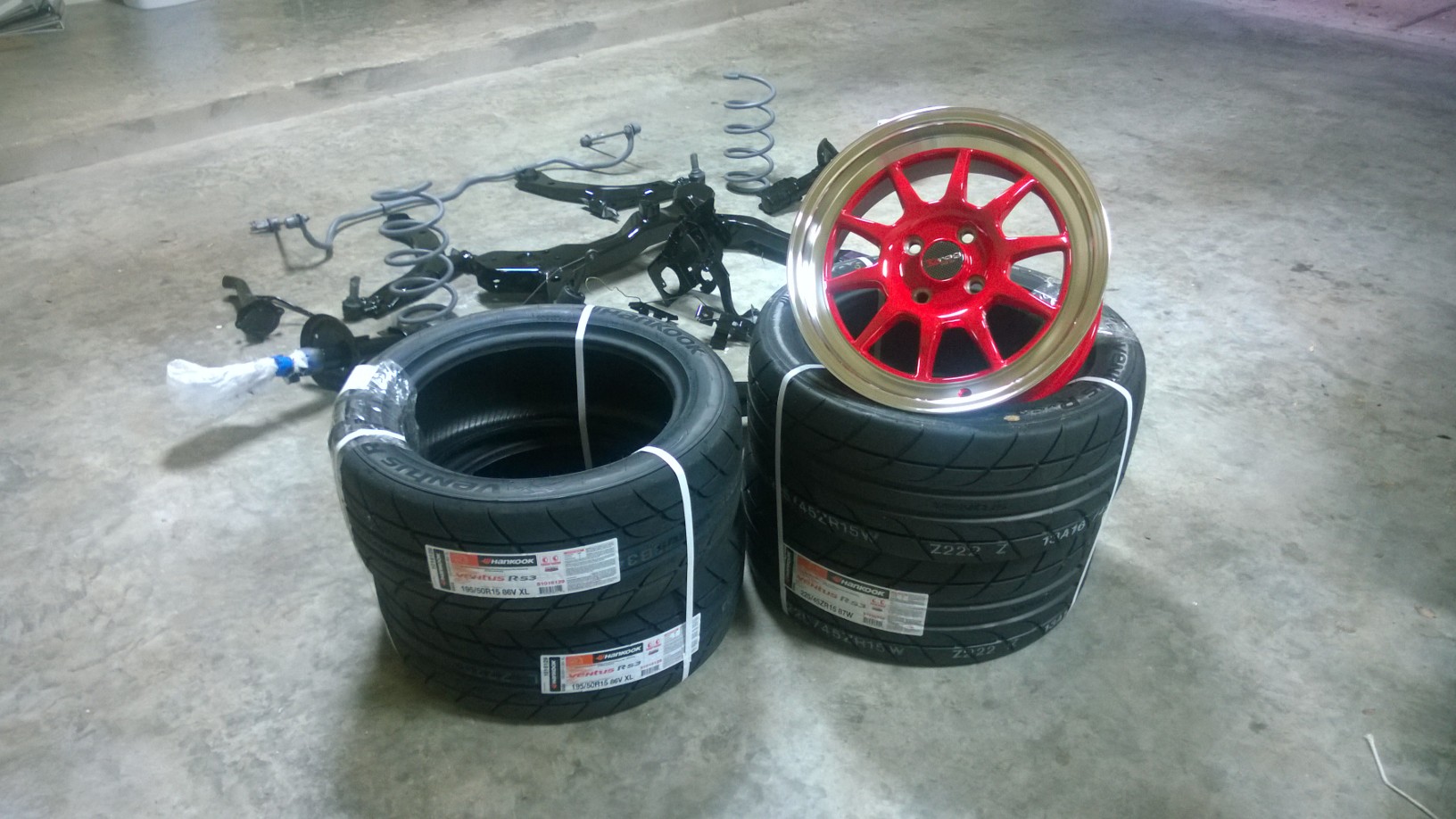

I also ordered and received my wheels and tires. I bought 225-45 R15 for the rear and 195-50 R15 for the front. I am using Hankook Ventus R-S3's I looked at lots of reviews and thees get very high ratings. The wheels are Drag

Grey - I think. Black calipers. We have an SS seat that has red to match the highlighted components, wheels, valve cover, axles, sway bar etc.

Wheels look awesome! All your parts look great. I have not tried painting my coils yet. Im thinking there will be a lot of over spray so I will have to wait until it warms up and do it outside. Mowed two days ago, last night it snowed...
