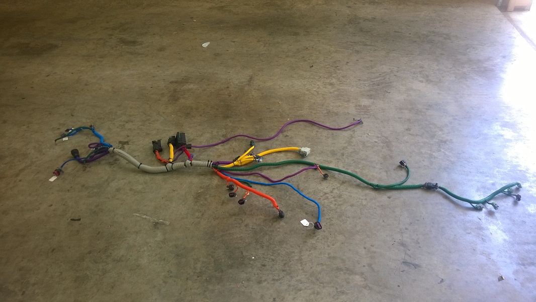

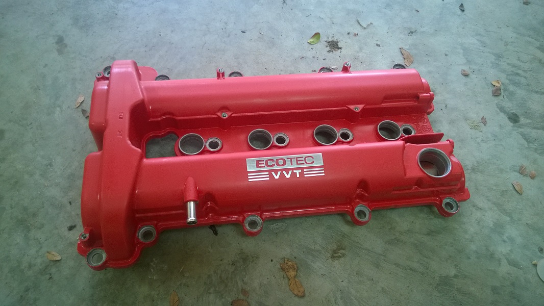

Last weekend I completely re-dressed the engine harness (including the injector harness). Although my donor was in good shape all the plastic wire shields were cracked. I got multi-colored split shields. I have a few more donor reuse parts to paint, I removed my valve cover for painting - all cleaned up now - ready to paint. I did buy a $100 stainless steel exhaust manifold. I am thinking of putting a clear plexiglass window in the engine cover - F40. My frame goes to powdercoat tomorrow.

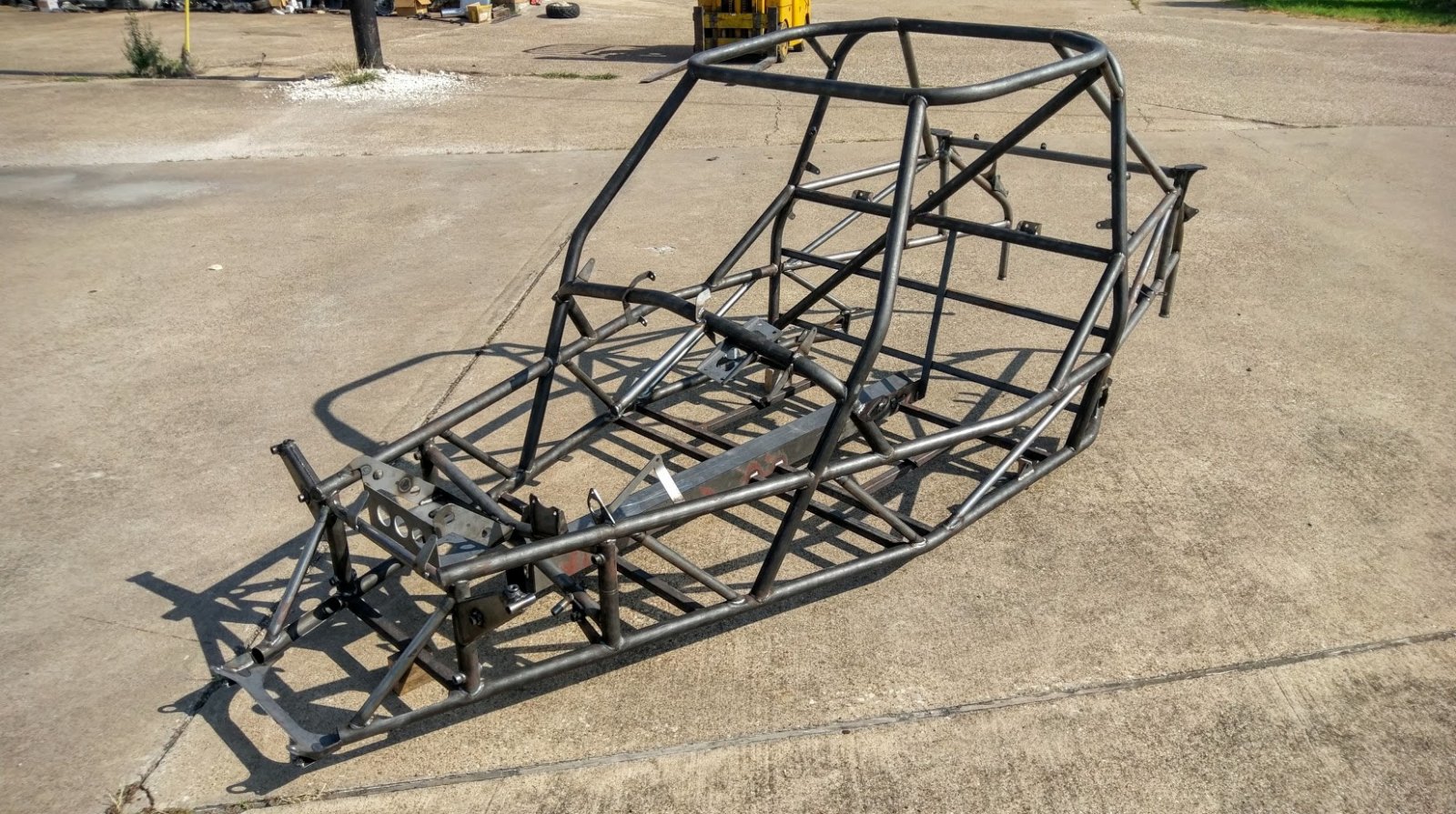

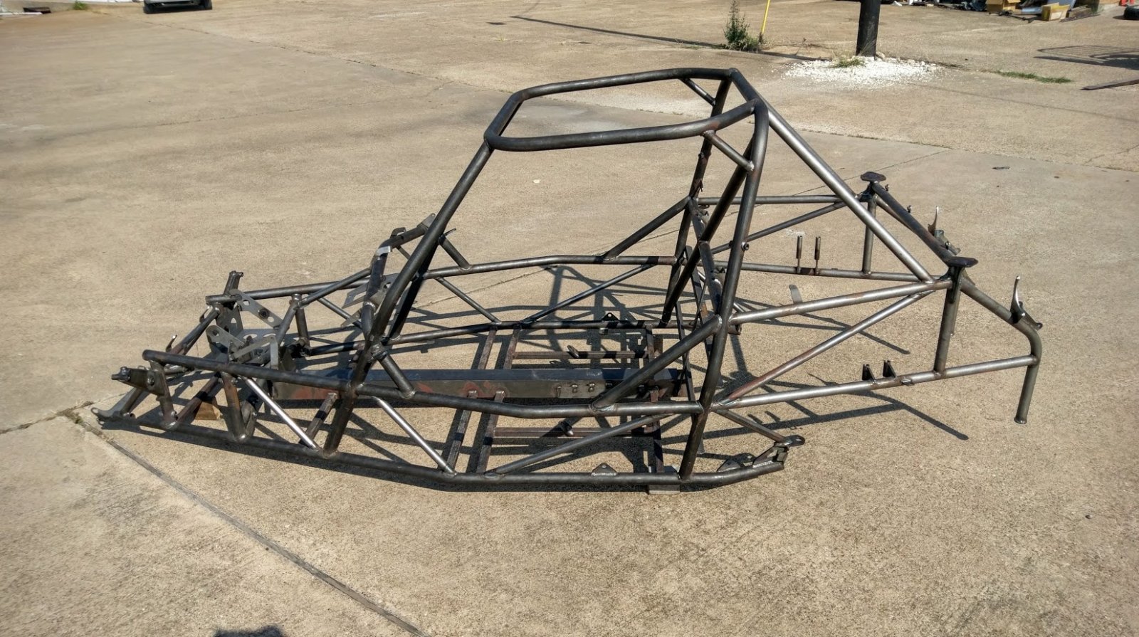

My frame - before powder coat. My frame is and extended track frame - I changed from a city to a track so I could more easily get in and out using the halo to hold on to pulling rather than pushing myself up out of the seat. The standard track frame has 3 horizontal members (bars) on the side of the driver compartment. This makes the compartment quite deep to the seat - but very well protected. My wife is very short and she had a hard time getting her leg over the top of the top member so I had Lonny and Adam eliminate the top horizontal bar.
In the pictures you can also see the two floor side-to-side members just in front of the the space for the front seat. A normal frame has just one of those. The second one is 4" in front of the normal one giving the floor pan the extra 4". The halo is also extended (not quite 4" due to angles) for the extended version. Adam and Lonny also made the top of the halo 2" taller for the extended version for a bit of increased head room. The frame went to powder coating today.
When they build the frame, the tooling uses a standard frame for the entire floor pan and second level frame tubing. This includes all structural diagonal pieces. The floor pan together with the second level have sufficient structural strength for the car. When you add the halo it is super rigid. Prototype 1 frame had just the two lower levels - no halo. I drove that car before it was rebuilt to the new frame.
With my frame, the new diagonal pieces for the upper level to the mid level frame were positioned by me, recognizing that they intersected with the mid frame at not the optimal points for rigidity. However it makes to easy access and for me it will certainly be sufficiently rigid for my purpose with the full cage. The side panels will cover the frame and it will work just fine.

Dan,
Your new frame looks good.....
BUT I still think I like your original one better.....
View attachment 238Thx, BAR
I too like the City frame better - but only in my dreams when I am remembering myself 10 years younger. But then I unfortunately wake up and reality strikes. When you get to be 70 "looks" take a much lower priority in living.

Engine harness re-do - mine was all heat cracked.
For the 4th of July I thought I would do some fireworks

Installed painted valve cover - added at least 50HP (in looks). Installed cleaned up engine wiring harness. Working on main harness now. I have not really spent any time on the main harness yet, just stretched it out. The total clean up of the engine harness (removal, stripping all old cracked covers, tape and install new cable covers, tie wrap and reinstall estimated 8 hours. This is Dan's time which includes 25% admiration time. The painting to the valve cover took about 3 hours - mostly getting a method to mask. I did not take a picture.

Hope the family is doing better... I found with doing the harnesses get them into the car before you start to really bind them back together. I probably ended up redoing them at least a half a dozen times before I got them to sit right. I put together some notes in an earlier thread with regards to the wiring blocks hopefully you can add to it. (BAR-AIR's build logs).

Thanks, I figured that out too from looking at your posts. Lonny and Adam lent me a harness for me to copy. Regardless I figured that a few tie wraps before installation would help but not wrapping the entire thing until fitted.
