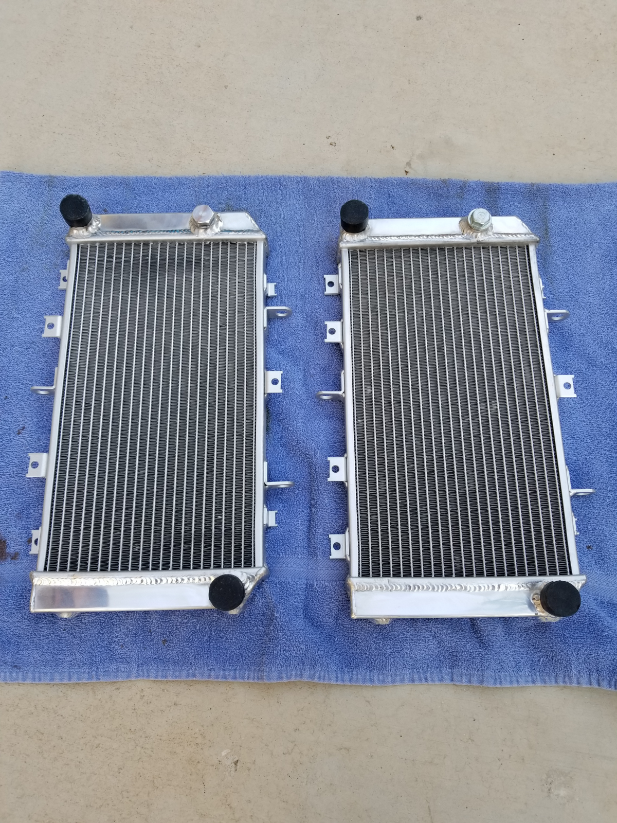

Have been slowly working on donor parts getting them ready for paint and replacing worn parts. Did order and receive my pair of heat exchangers for the intercooler. These are KZ750 radiators, measuring 17.5X8.5X1.5 inches with a core 120 square inches of dual row cooling tubes each. A single 8 inch 900cfm cooling fan will be mounted on the rear side. I plan to side mount them behind the cockpit, one on each side, with a cowl to direct air into them. They will be run in parallel with an expansion tank feeding a high flow pump. I will supplement them with a water misting system (separate water tank and pump) for each heat exchanger, for the really hot days in Phoenix.

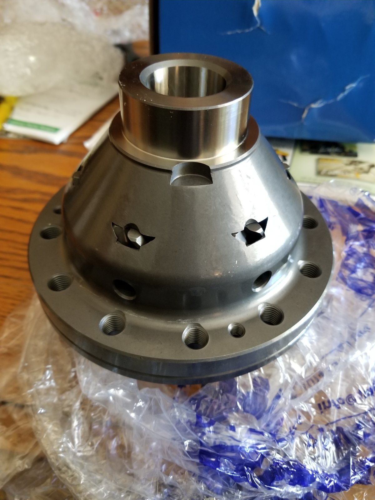

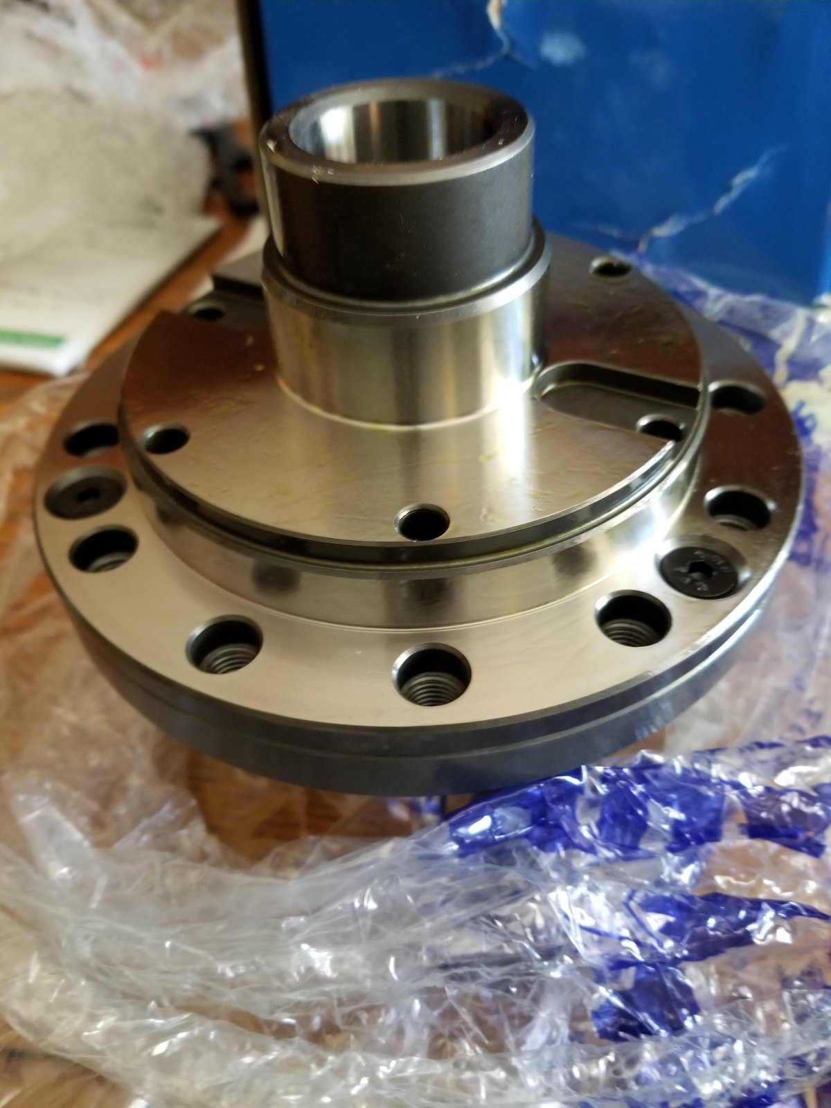

Looky, looky what I got in the mail today! All the way from across the pond from England, took a little over 2 months after ordering it, but my F40 QUAIFE LSD is finally here. This thing is beefy, weighs about 15 pounds. I can't wait to get it installed into my F40. In case anyone is curious, it was $925 shipped from Quaife through WG Motorparts in England. :):p:D

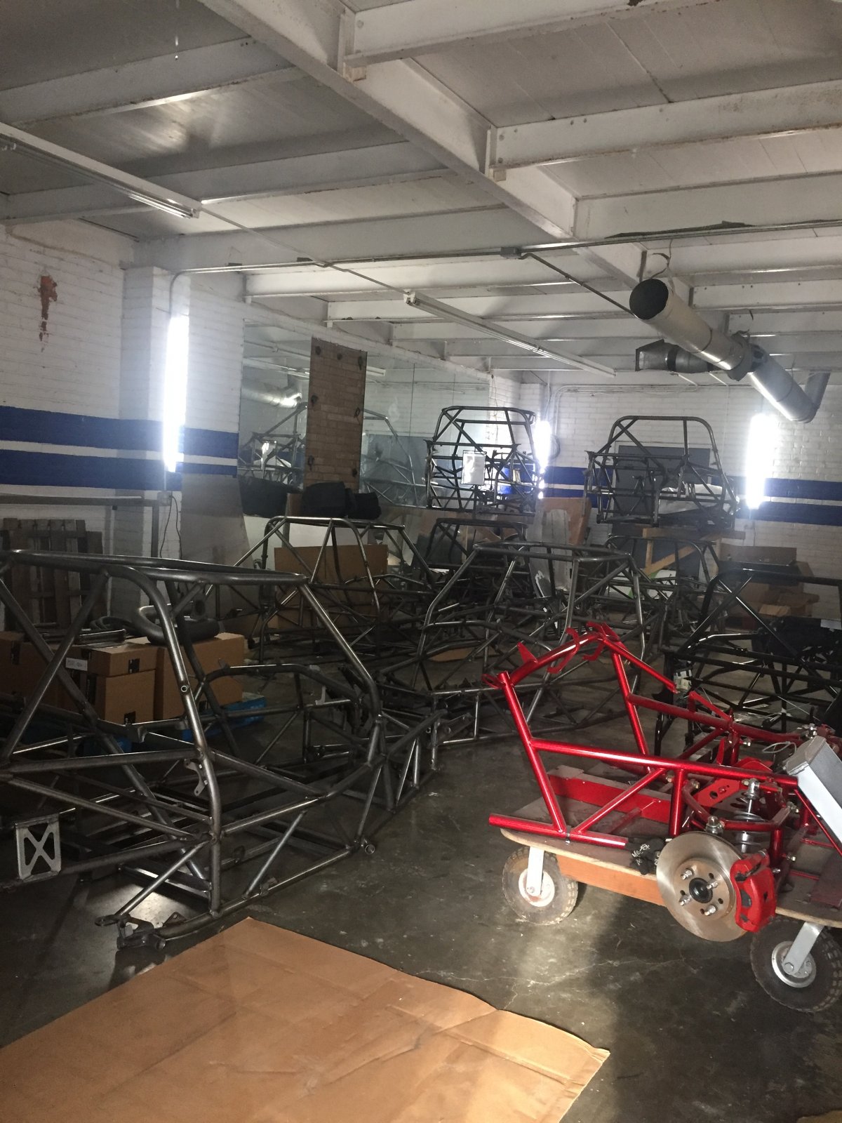

Been a while since I last posted. Anticipating my kit in the next few weeks, thanks to Motoracer 110 for the photo from the DF shop. Can't wait to get it home and start the customizing! :p

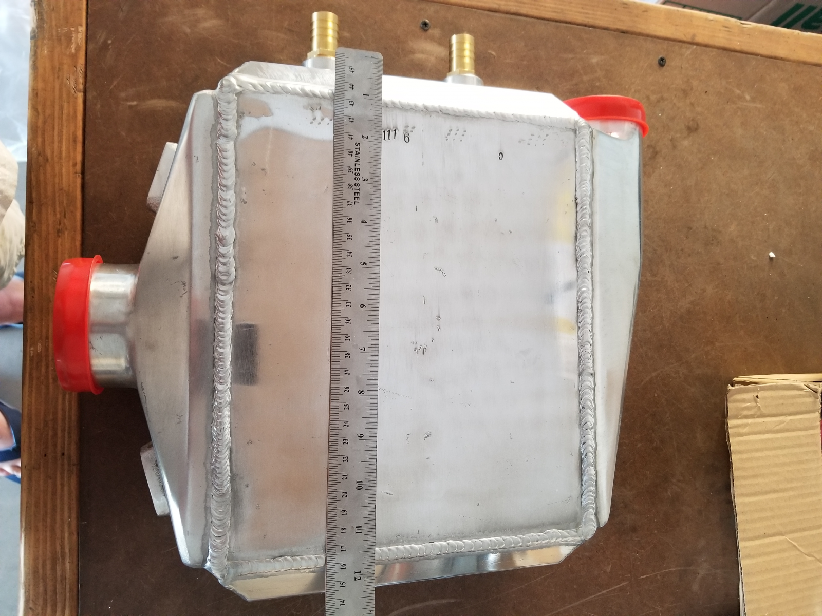

Picked these up recently, my air-water intercooler and heat exchangers to cool the intercooler.
9186
9187
I think the intercooler may be big enough to handle the Phoenix summers (designed for 400+ cubic inch V8 motors) and the heat exchangers are KZ750 radiators that both total about 250 square inches of cooling surface. I plan to add a water misting system to spray the exchangers for those really hot days (105+) and it should be sufficient to help keep the IATs in check. Time will tell once I get this put together and see what the actuals will be.

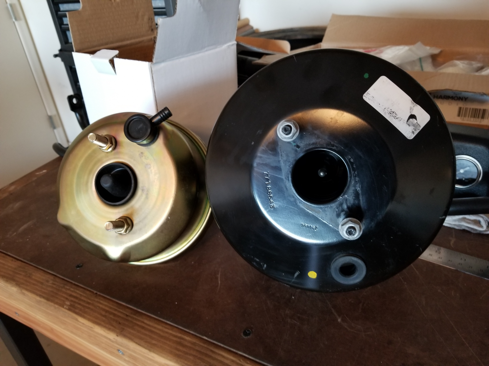

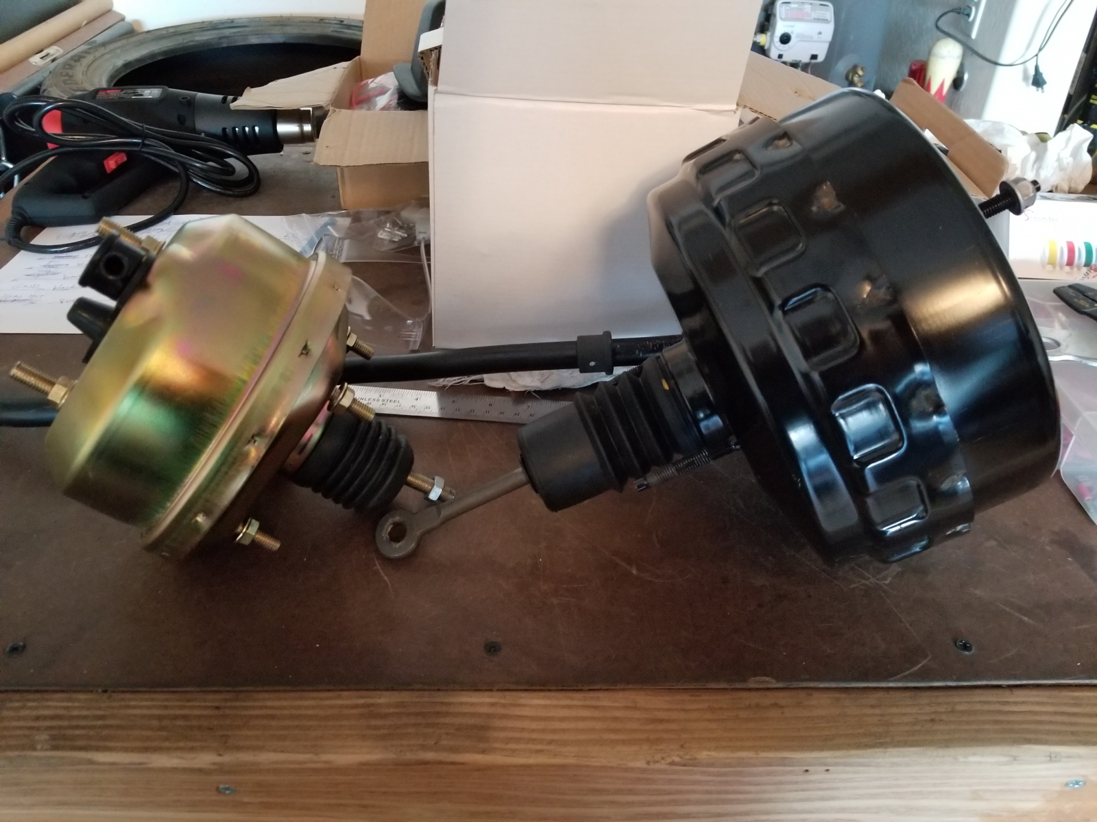

Got some new parts for the brakes, received the 7 inch single diaphragm brake booster. Is quite smaller than the stock Cobalt booster and should help me match pedal feel to the more effective/lighter effort brakes on the Goblin.
What is the PN for that booster you're going to run? Also, are you going to run the stock master cylinder, or you getting something different? I need to replace the reservoir on my master cylinder (and not having any luck finding just the reservoir), so I'm thinking about going with a smaller booster like you're doing and matching it up to a different master cylinder and reservoir since seems I'll be buying a complete master and reservoir anyway.
Evil, I am looking at an integrated master cylinder reservoir, like a Corvette or Z28/Trans Am. It should a low enough profile to fit under the hood and then I don't have to run extender lines. The key thing is to go with a larger piston to reduce the pressure somewhat from the stock Cobalt set up. Plus having the smaller single diaphragm boost should make the brake pedal feel 'normal' and reduce the chance of brake lock up if hitting them hard.
I will be running a separate clutch fluid reservoir, bought a 6.5 oz. from Tilton that should mount to the firewall near the clutch master cylinder..
The 7 inch booster is an aftermarket, not a Chevy part. The brand is MBM and PN PB7001, bought off eBay. This booster will need an extension rod to connect to the brake pedal arm, also purchased from eBay from Rod Parts Dealer PNs GH101 + GH5564. This makes the position of the pedal adjustable. I have not yet purchased the master cylinder yet, still deciding which one, but it will be a 1.125 inch unit.
