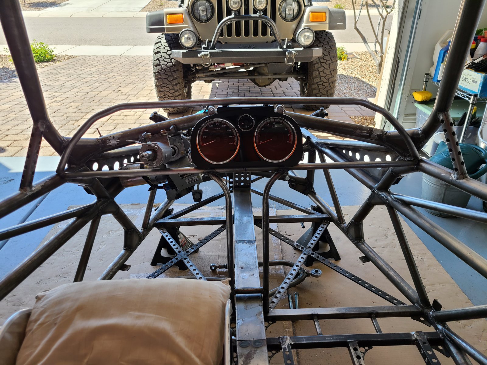

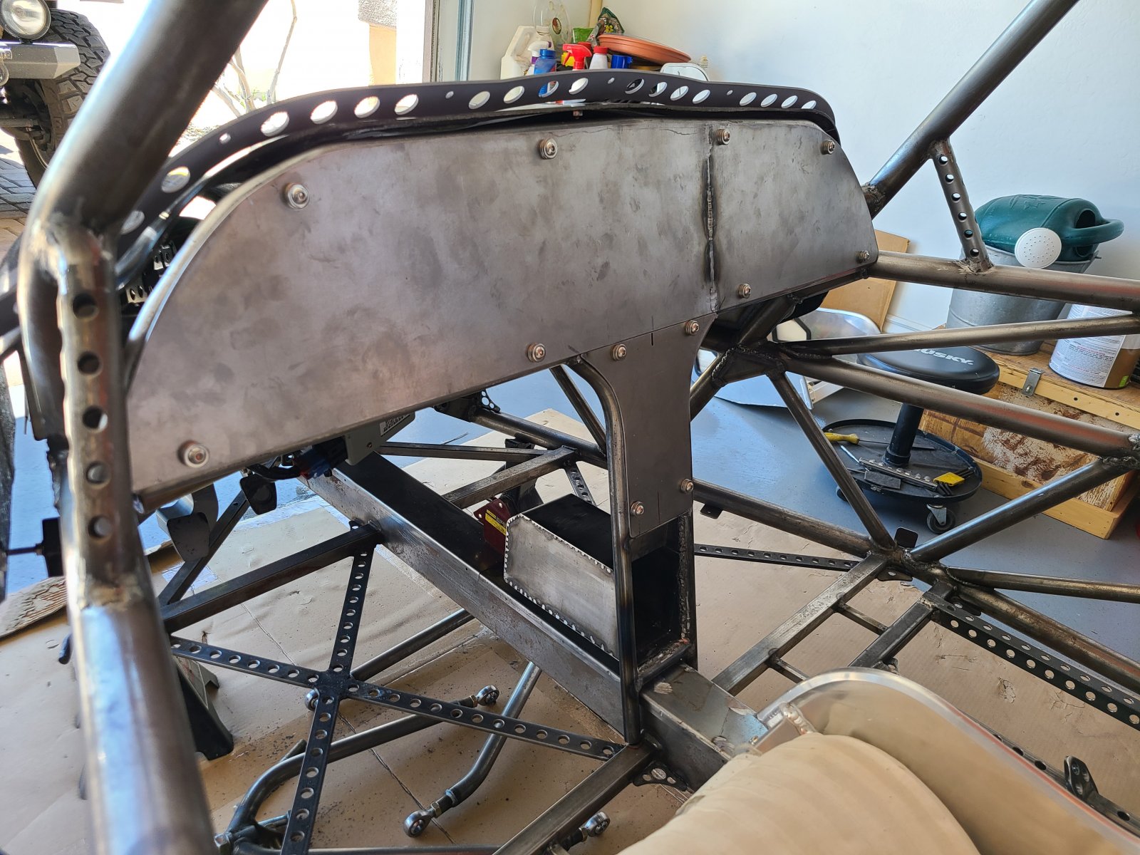

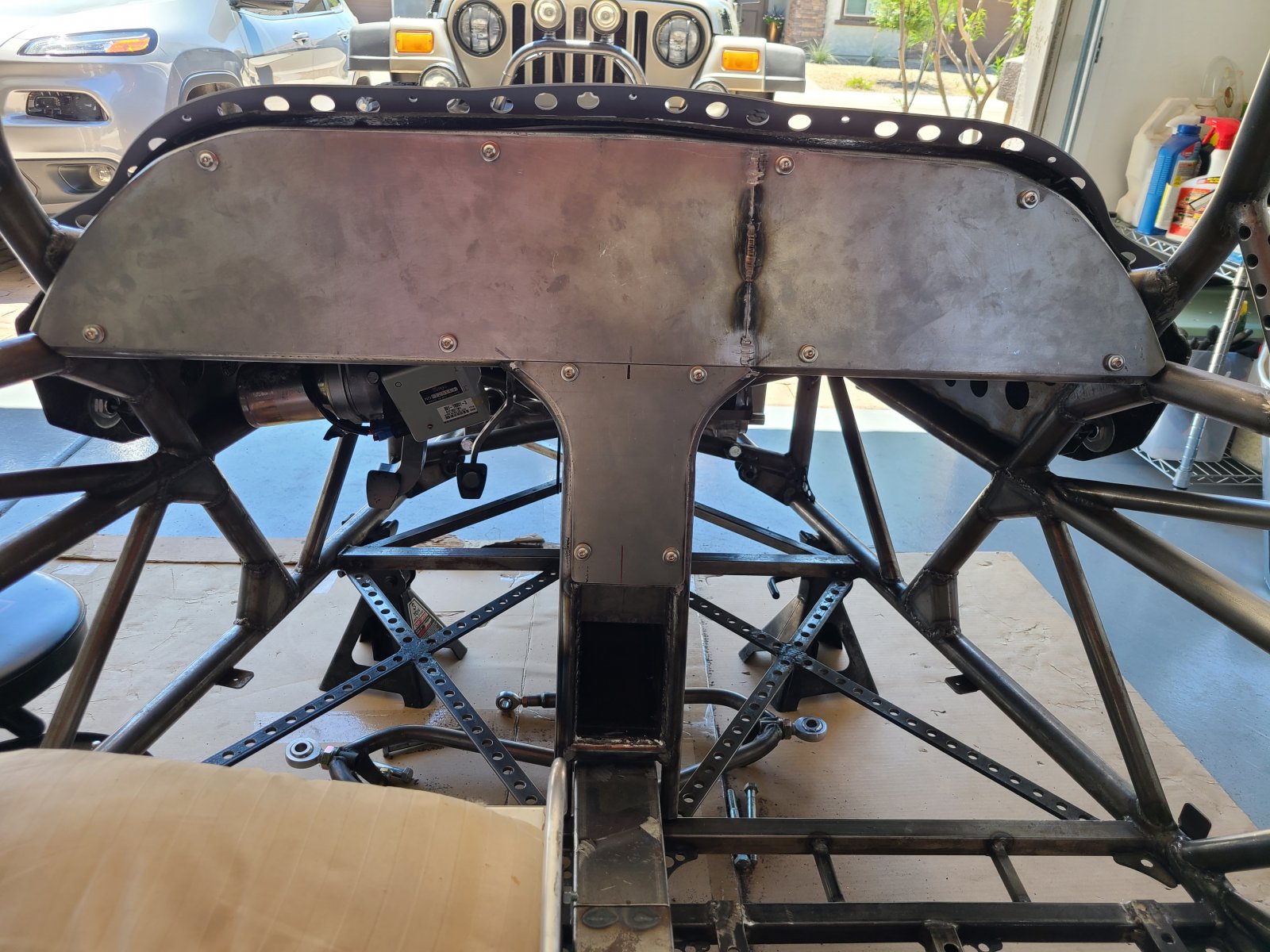

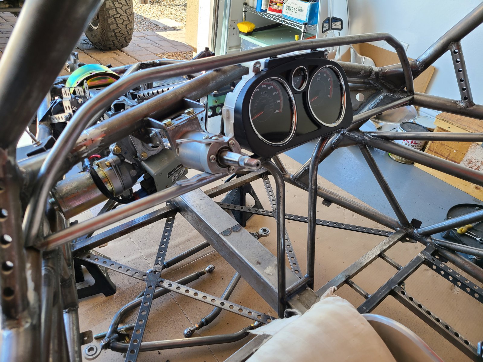

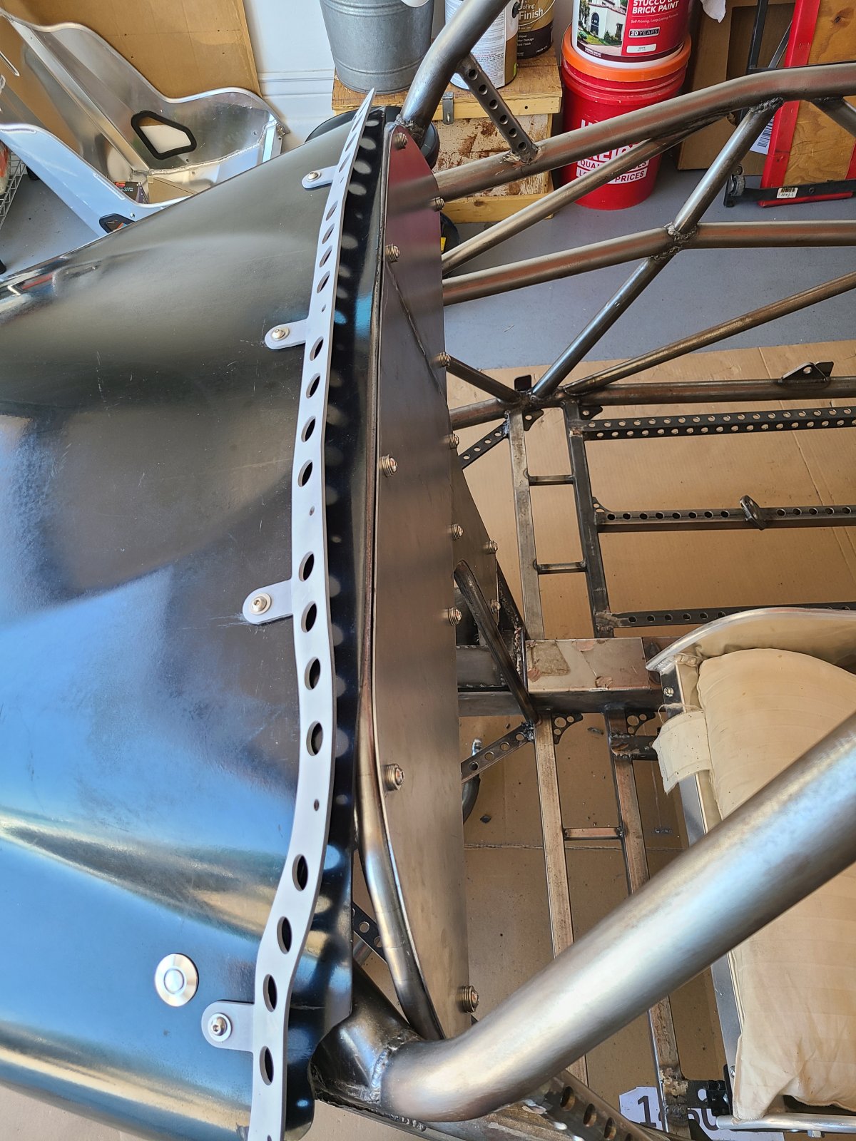

Update on the dash assembly: got the frame all measured and fabbed up - tweaked to fit correctly. The frame contour follows the underside rear edge of the hood (as close as my tooling will allow for bending the 3/4 inch tube) to try to minimize the gap. It incorporates a center 'waterfall" frame section that attaches to the floor crossbar next to the center tunnel. (My center tunnel is 3 piece - my mod - and can still be removed with the dash frame installed). I added a curve to the top of the 'waterfall' tubes to add a more esthetic look:
I then fabbed up the dash panels from 16 gauge (0.060 inch) steel - won out over fiberglass - and easier for me to work with. I welded threaded plates to the dash frame to bolt the dash panels on and to allow removal to work on guages and wiring:
I added a small 'cubby' at the bottom of the 'waterfall' panel, no room for a glovebox in the dash. The ignition switch will be mounted here for my convenience:
Next up is to cut holes for the steering column and dash gauges. The odd size/shape of the Cobalt gauge panel will be a challenge - measure 200 times, cut once. o_O
BTW, the stacked washers in the dash screws are there because I need to shorten the screws to 3/8 inch to fit without hitting the frame bars.
View attachment 46895View attachment 46896
View attachment 46897View attachment 46898

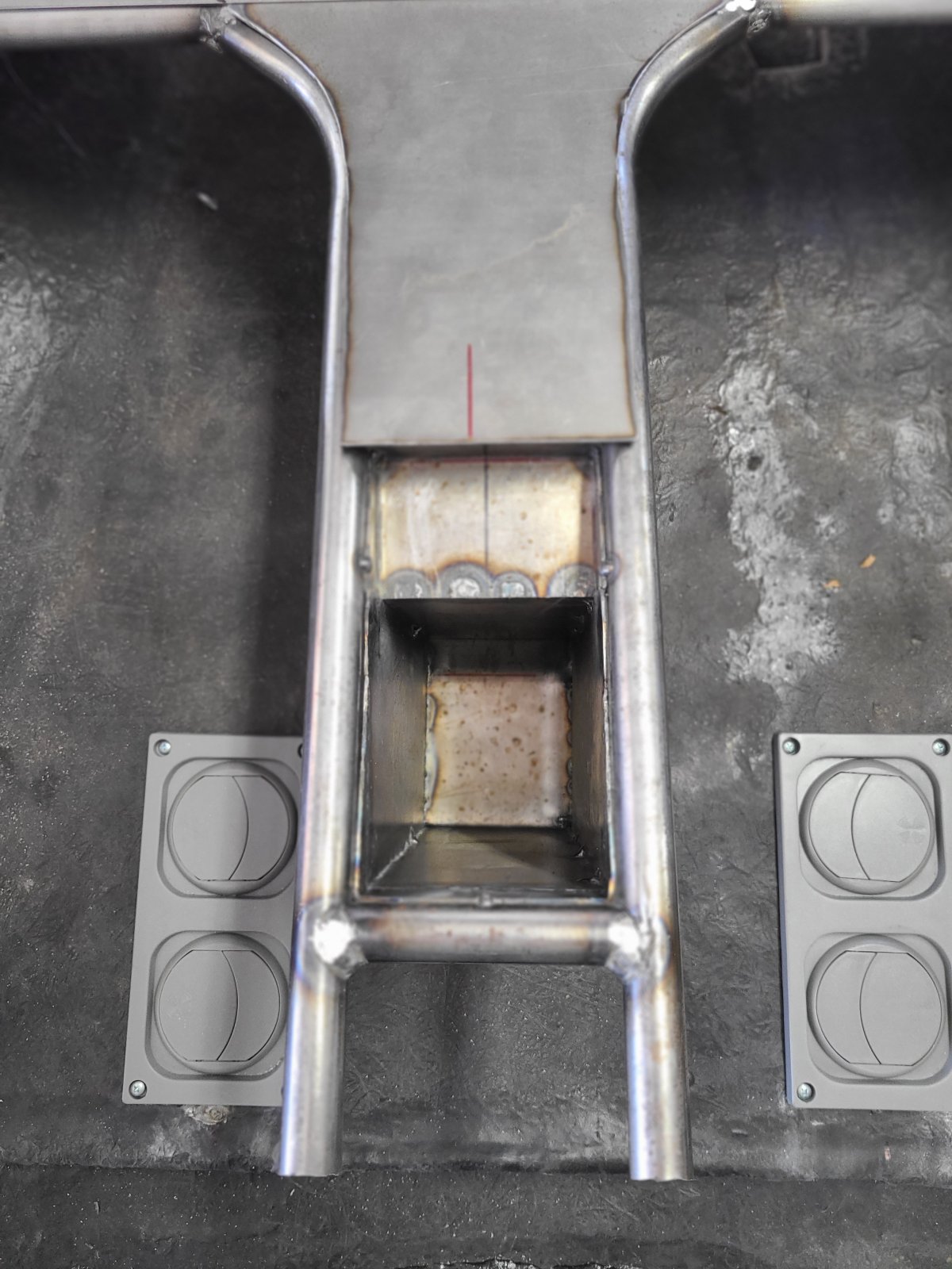

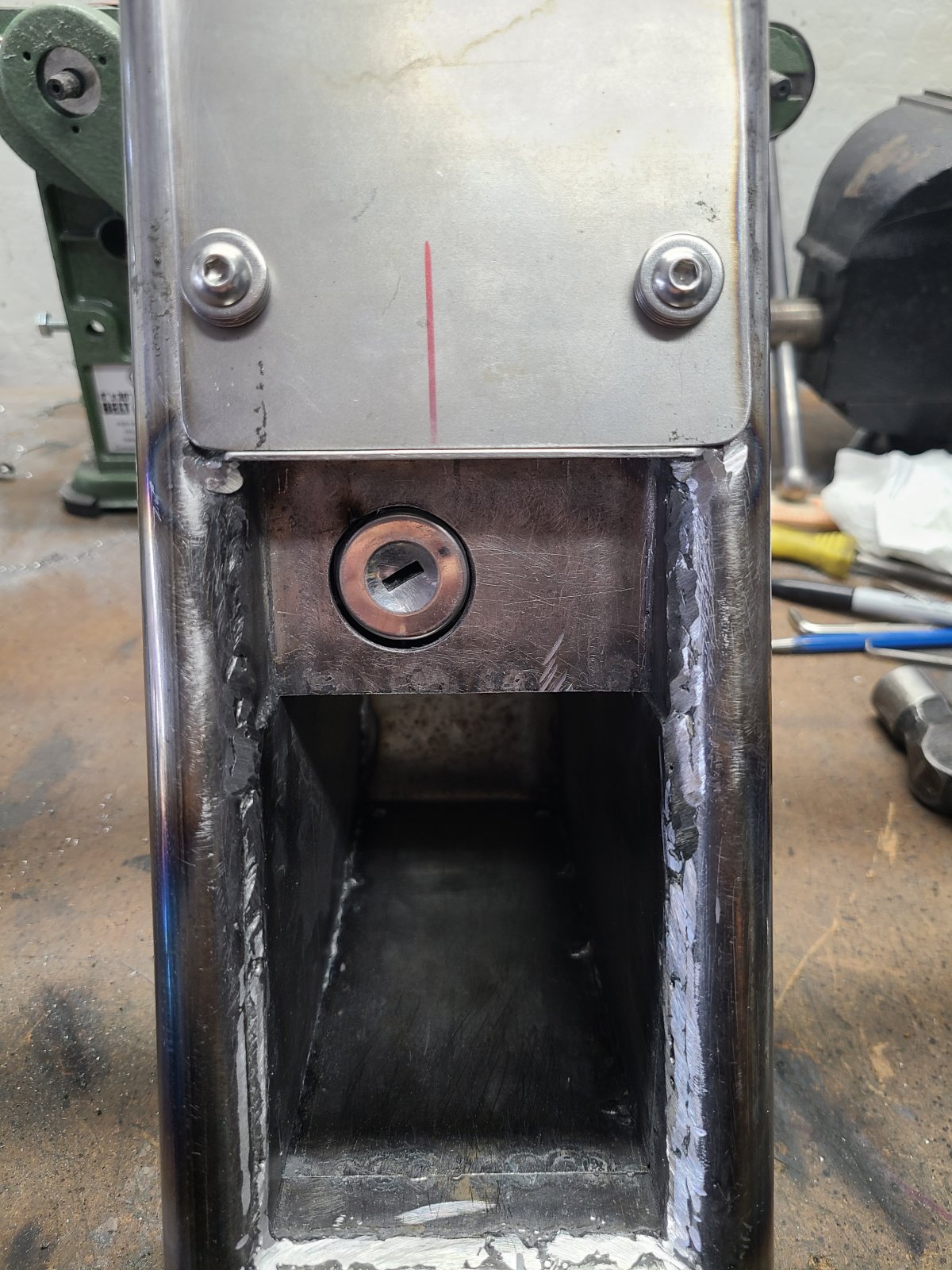

I hope the floor in that cubby hole isn't level, it should have a drain at the back(facing front) and a floor angled down (back to front), so the contents don't slide rearward every time you hit the gas! Because you will be stomping that go pedal every chance you get.;)
The 'cubby' is sloped forward, does have a couple drain holes at the low (forward) point, and will be lined with thin carpet material to keep items from rattling around. I still have to figure out the ignition switch configuration and mount that will reside above the 'cubby'. It will also need a cover too - so still not completely done with the dash assembly. More to come on this.

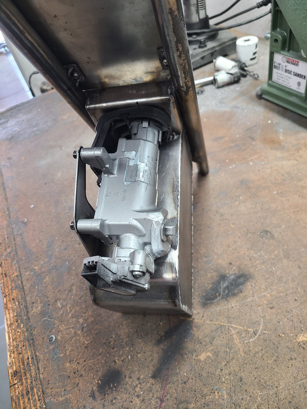

BTW, does anyone have experience with the VATs coil on the ignition switch mounted behind a steel dash panel? Will it still work properly or does the steel panel need to be opened up to expose the coil to the key? Thanks.
Big update:
The dash is finished to the point of being ready to weld it in, but I'm going to hold off until I have my hood mods completed. Did get the ignition switch mounted up into the small panel above the 'cubby'.

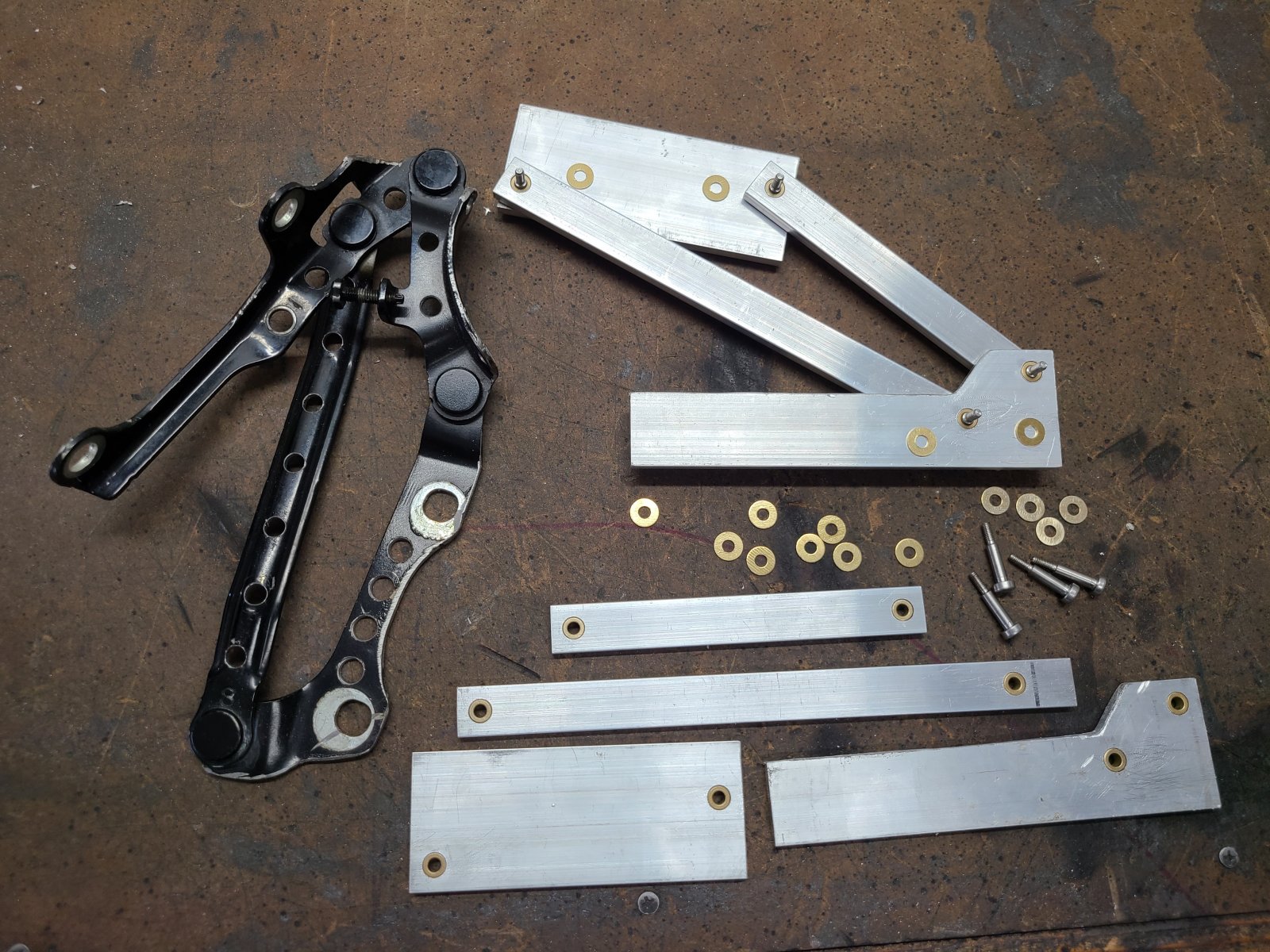

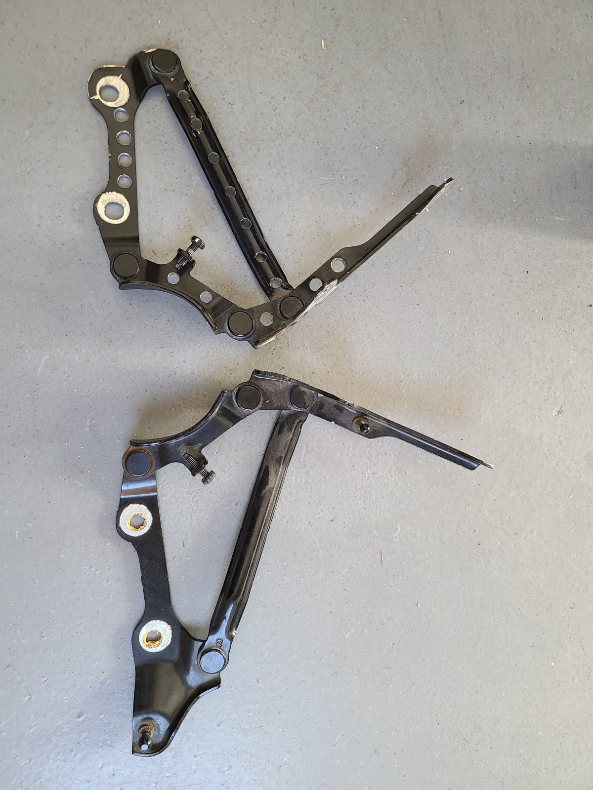

Regarding the hood mods, I was planning to use the donor hood hinges in a flip forward configuration.

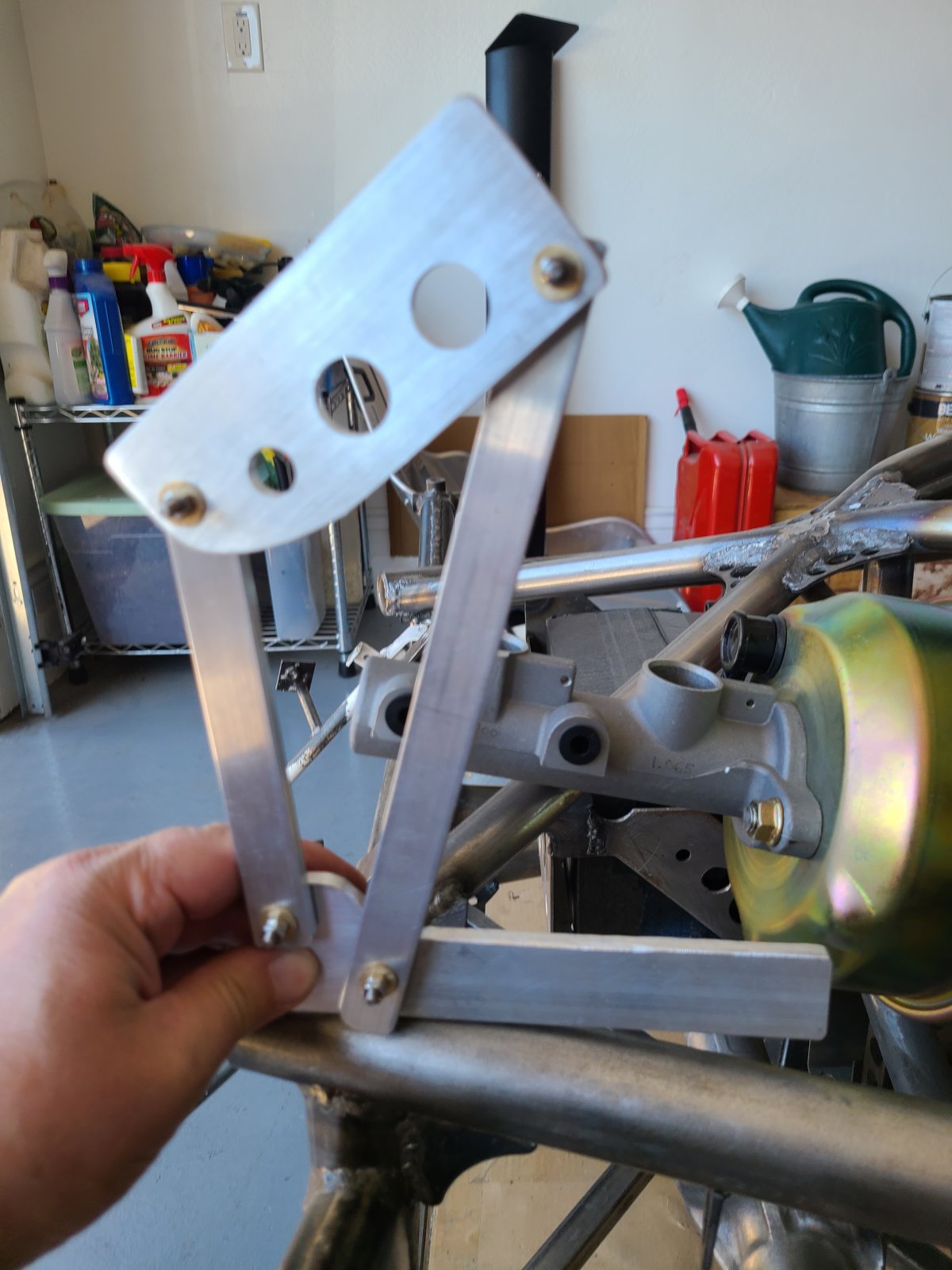

But they turned out to not fit in the location I need them to - just too tall, long and wide. So I fabbed up my own hinges from 1/4 inch aluminum bar, with bronze bushings and shoulder bolts.
These fit in the location I want them to and will match up with the flip up and forward function I want with the hood. More to come on this.

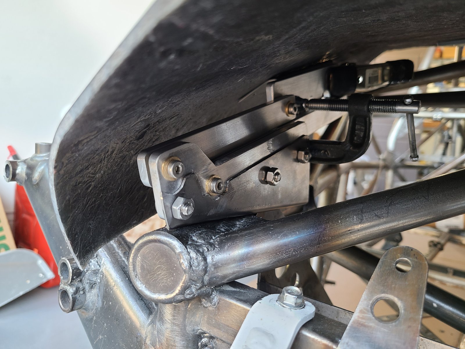

My wing standoffs I had originally fabbed up from sheet metal will not work for the active braking I'm planning to incorporate. So I fabbed up new standoffs from 1/4 inch aluminum bar with bronze bushings and shoulder bolts.
But the original frame mounts were mounted too close together, so I had to redo these too. More to come on the wing mounting and function.

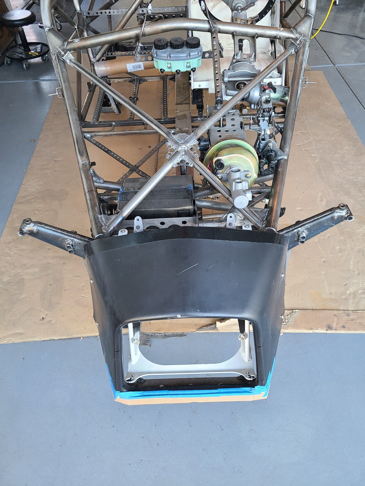

Update:

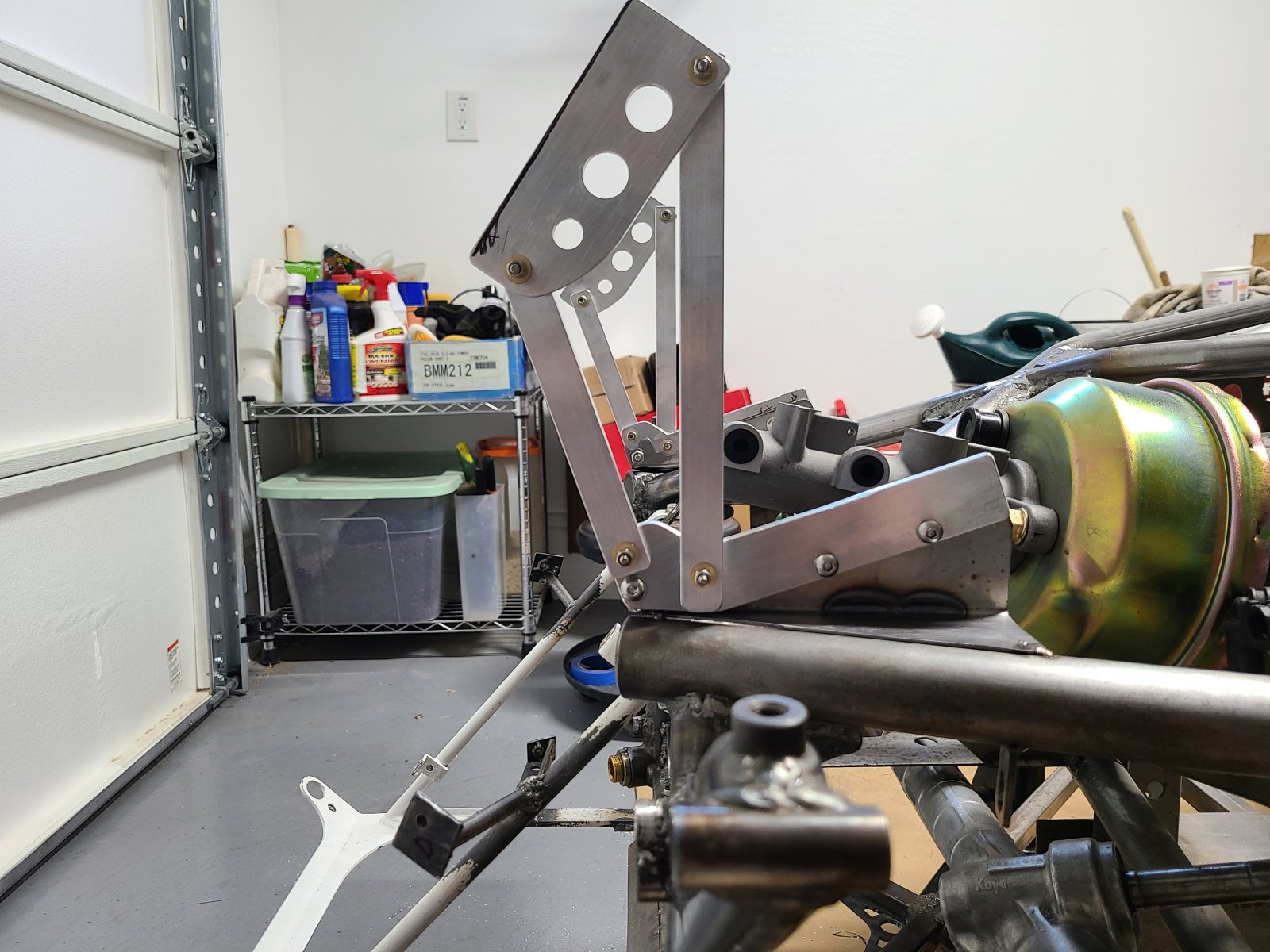

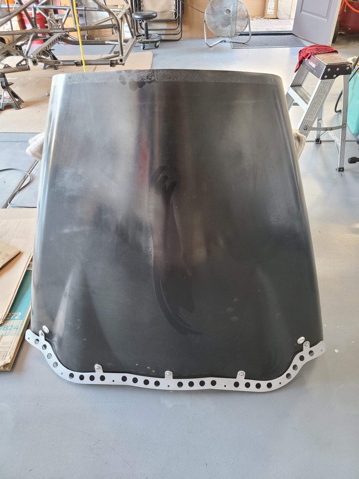

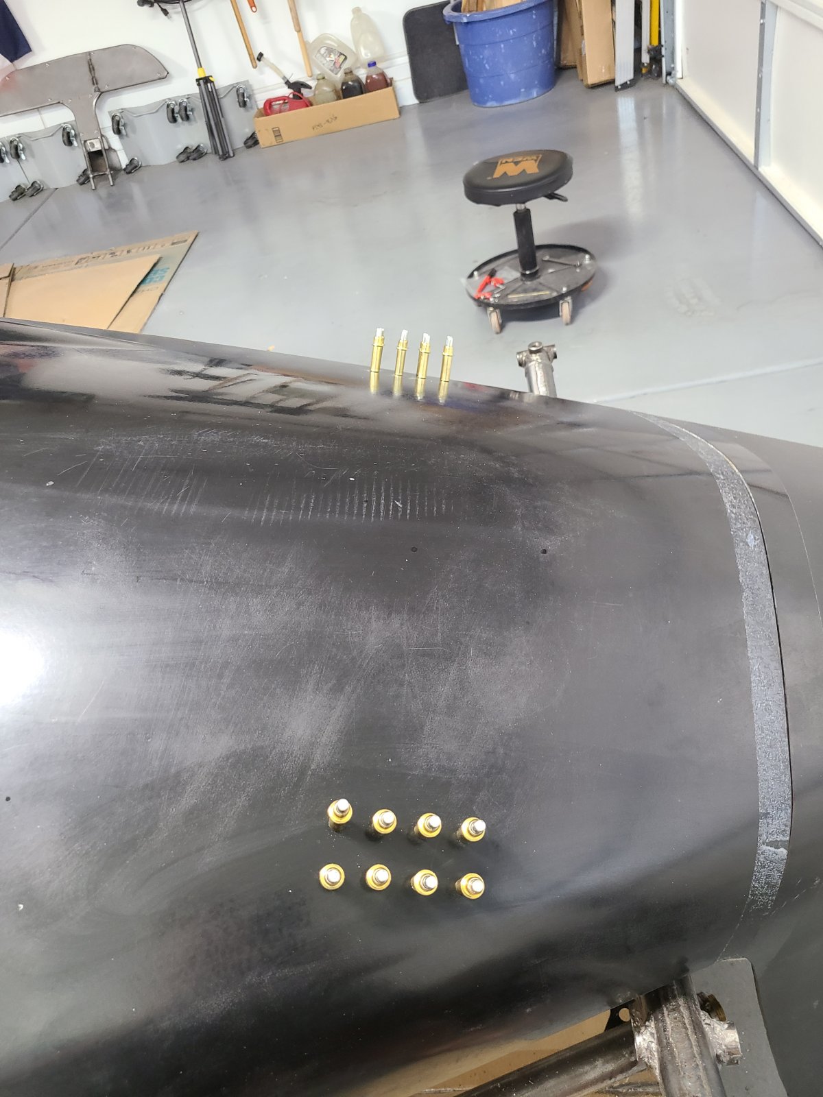

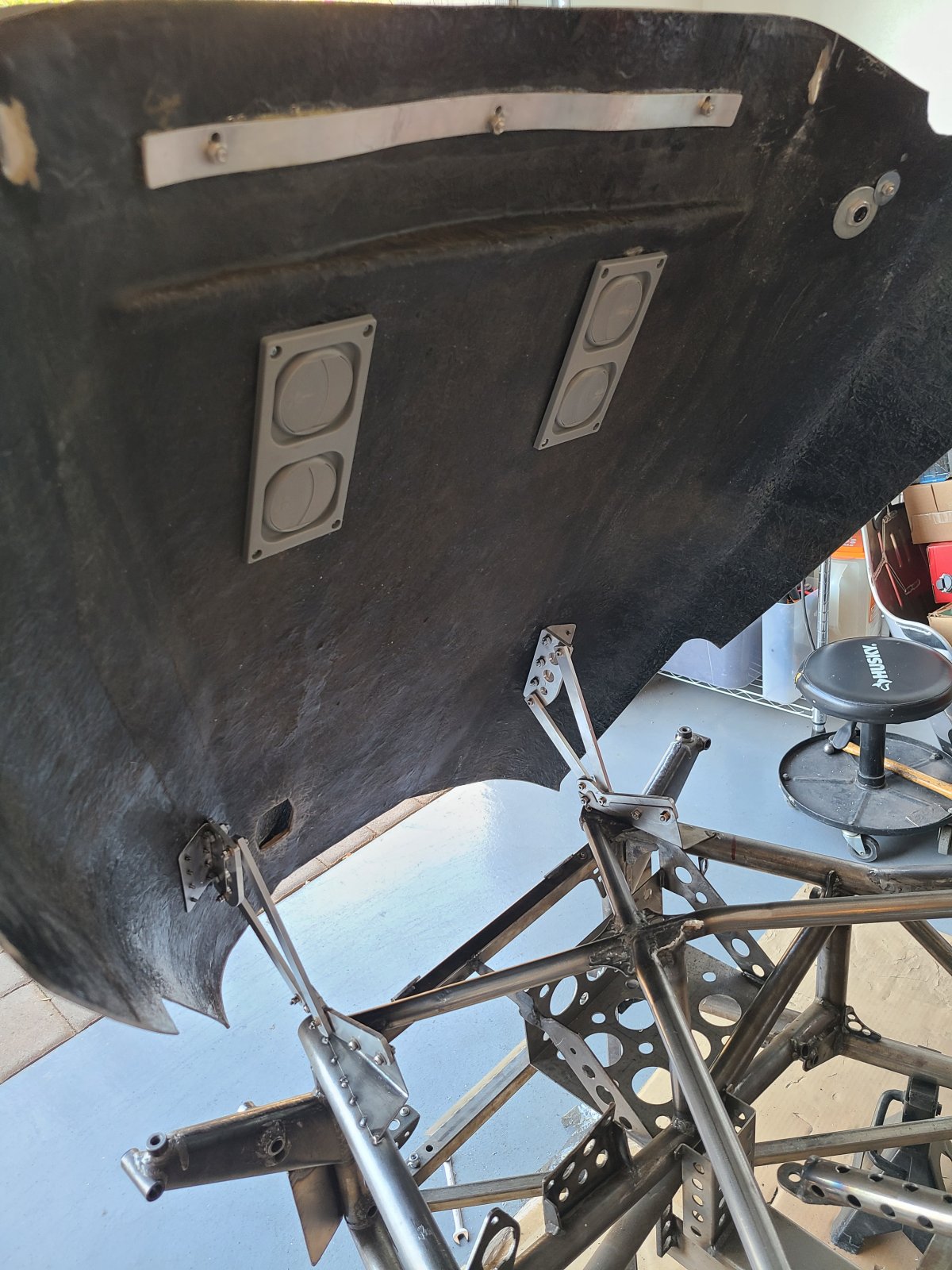

Been working on the hood, got it cut in two with a separate nose that is fixed in place and bolts on:
I previously posted photos of the new fabricated hood hinges, but now they are installed on fabricated frame mounts:
I also fabbed up hood mounts for the hinges (holding everything together with clecos during test fitting):
And and my hinged hood functions as expected:
Need to finish up hinge stops to limit forward motion so it doesn't contact the nose when opened. More to come on this.

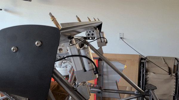

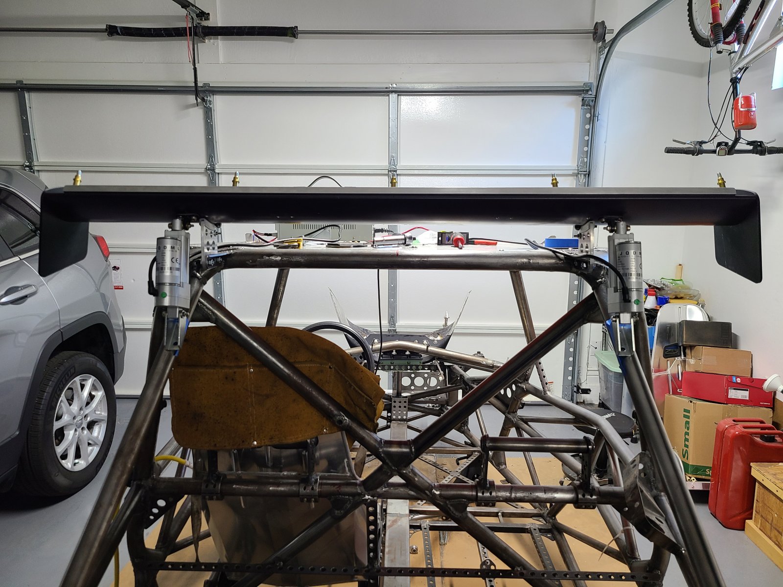

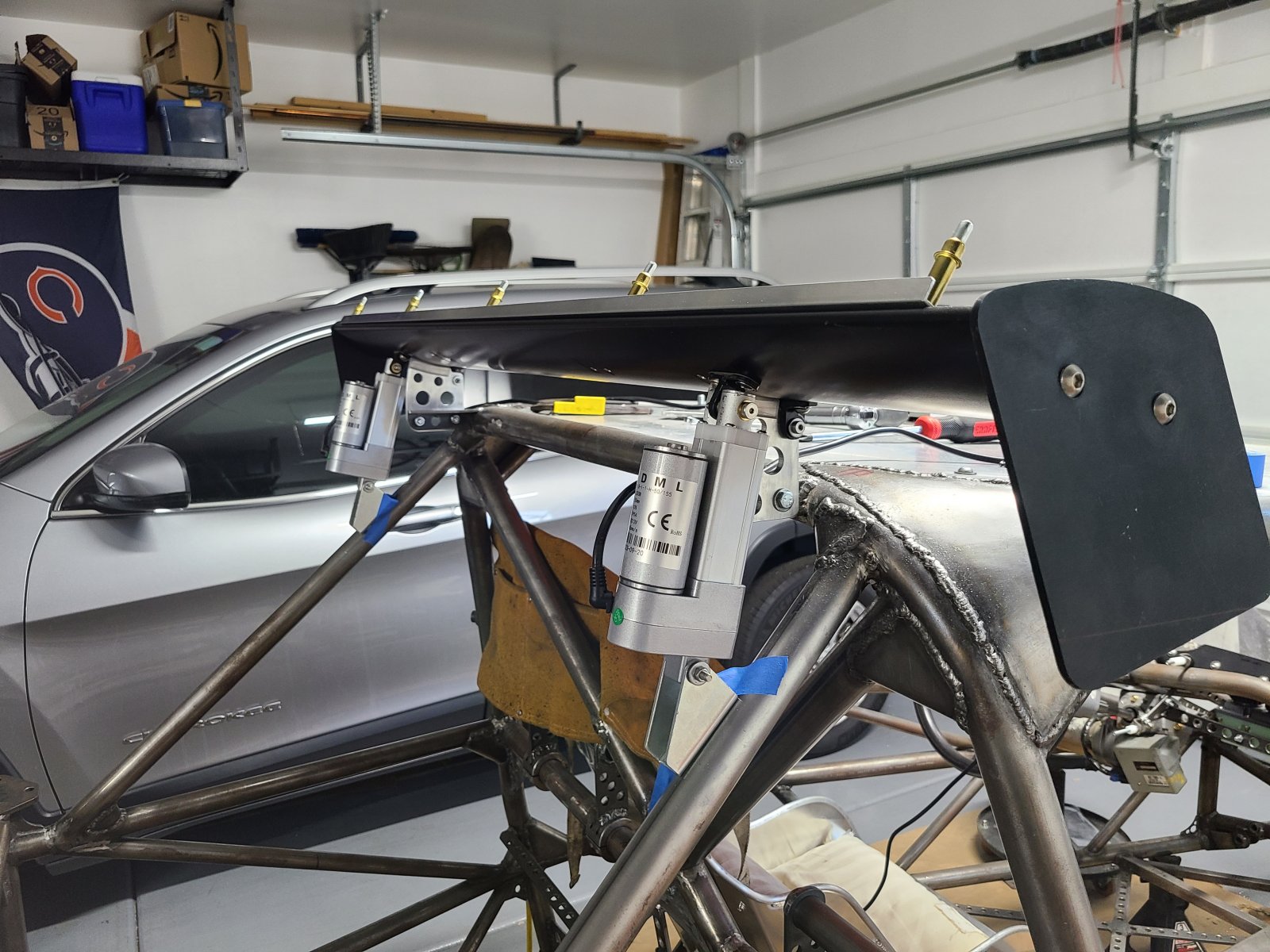

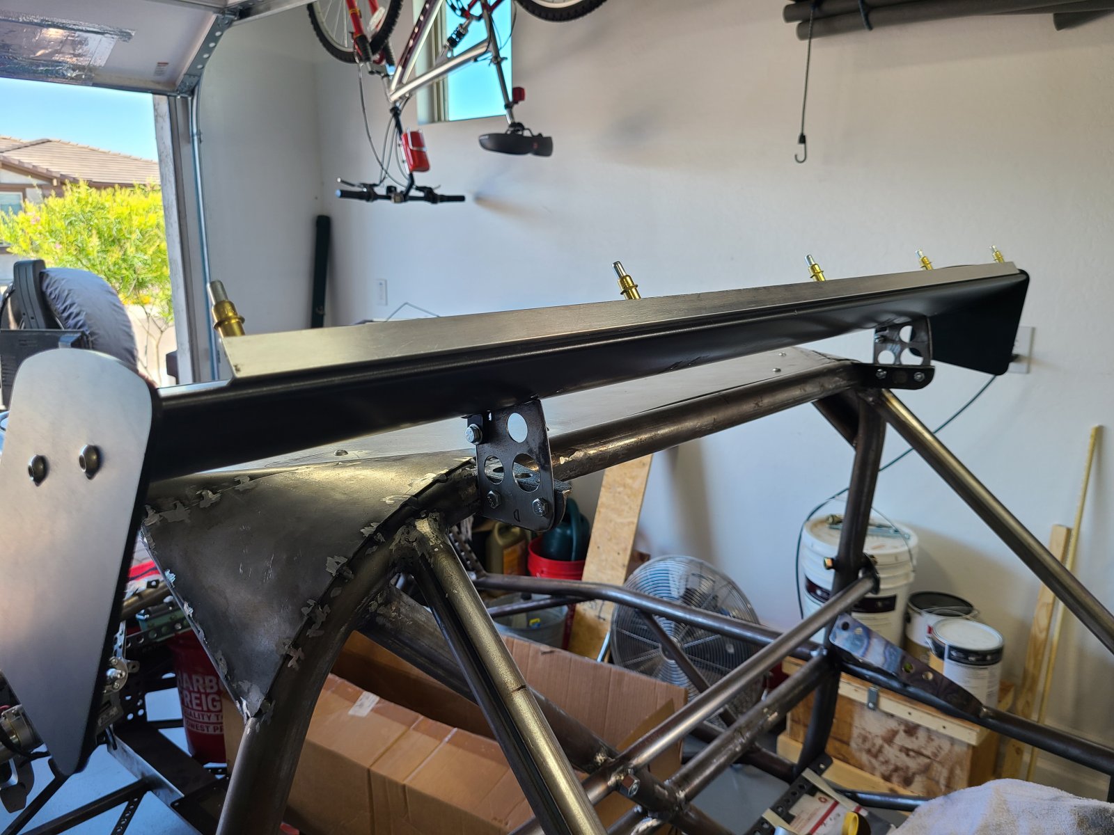

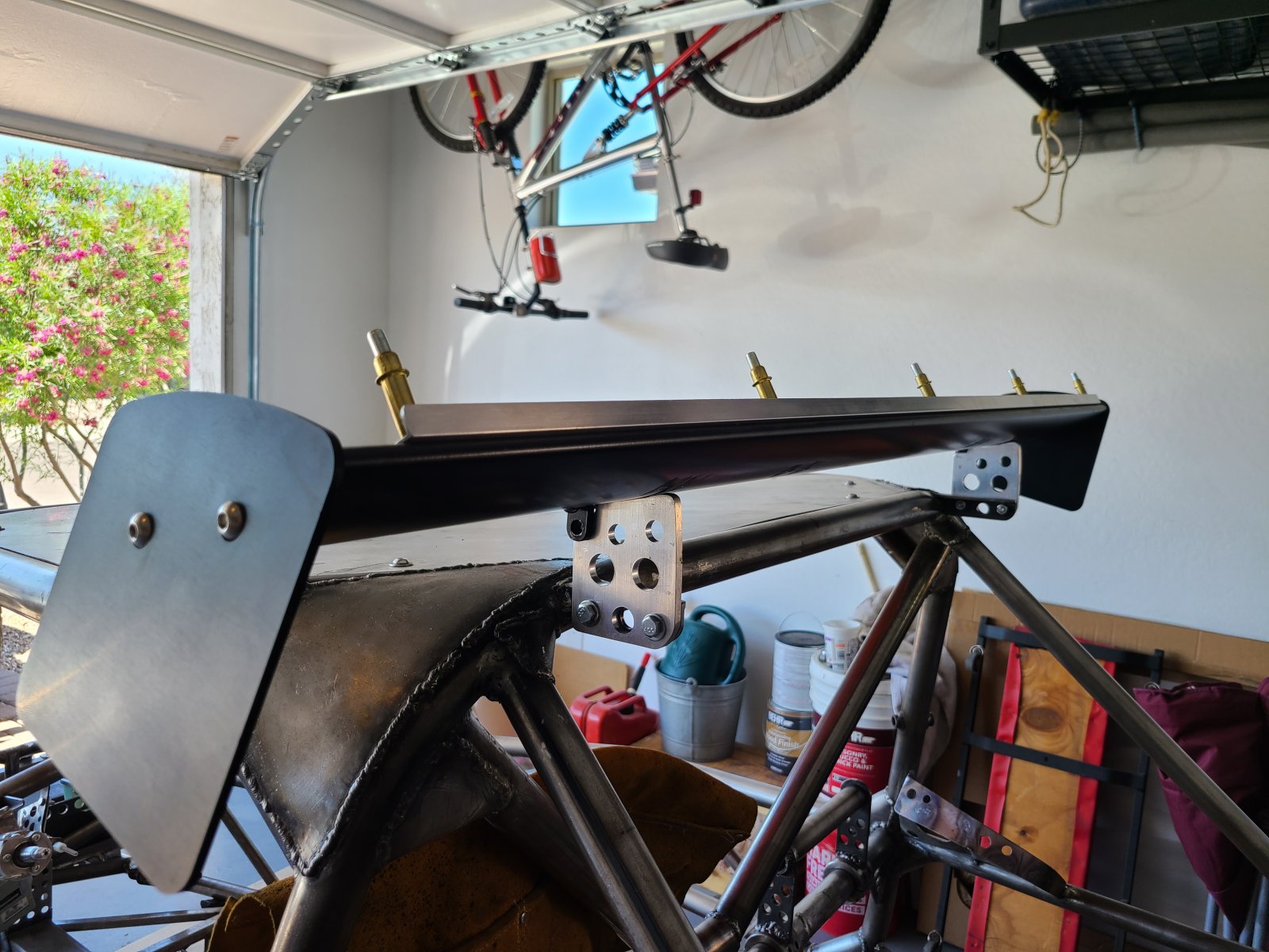

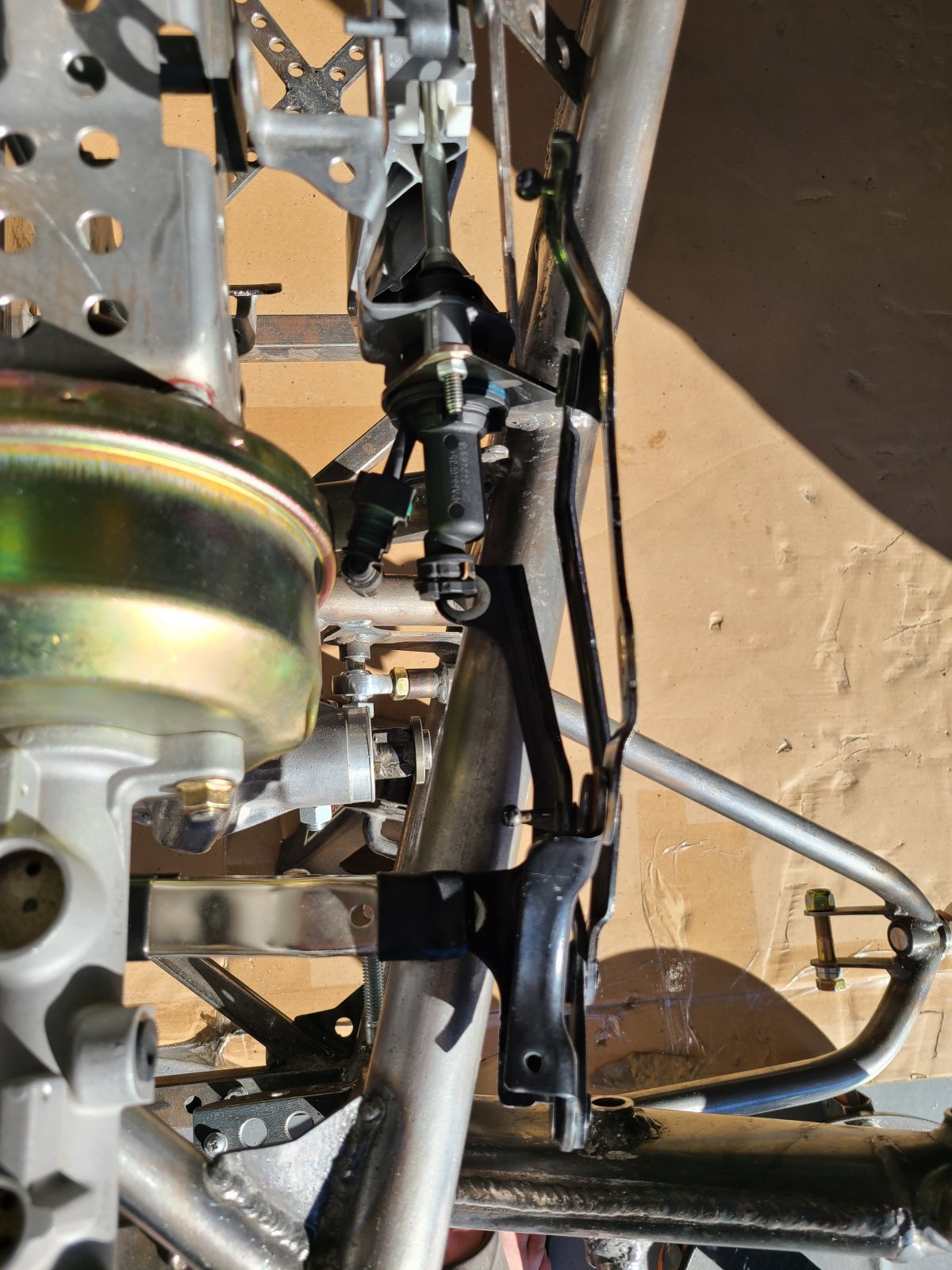

You see it here first - I've got my wing geometry finalized and finished up getting it functional, it is also an aerobrake. The wing is hinged and uses a pair of linear actuators to raise the wing from a nominal 8 degrees up to 65 degrees to create an increase in drag (aerodynamic braking) force.
The linear actuators are synchronized to extend and retract in unison, no twisting or binding. The wing extend and retract motion is less than 1.5 seconds, so it has little delay time to add braking function.
The calculated aerodynamic force at 75 MPH is about 125 ft.lbs. and being on the roof pushes the car down and toward the rear to counteract nose dive during braking.

Update 2:
View attachment 47827View attachment 47828
The calculated aerodynamic force at 70 MPH is about 125 ft.lbs. and being on the roof pushes the car down and toward the rear to counteract nose dive during braking.
That is so cool I want that too! Breaking perfomance of the Goblin is insane and with this even better!
PS:That looks like Florida not lake Michigan.
Mike, note the aerodynamic force I cited is the aerobraking force for my wing when it is deployed forward - this is drag force - and is not the aerodynamic downforce for my meager wing. But the down force can be calculated. To do this I would need to know the design (NACA profile), cord (width), length, mounting angle and airspeed to get in the ballpark.
My 48 inch wing operating in clean air across it's full span is about 45 ft.lbs. of downforce at 60ish MPH - best conditions. This does not take into consideration the Gurney flap on the rear edge of the wing which can add roughly 15% to this number (to 50 ft.lbs.). As you can see it's function as an aerobrake far exceeds its benefit to generate downforce - but a Goblin has to have a wing! Even Russell has one!

Update 2:
Tim, did you buy the linear actuators with a position feedback? I am pondering the idea of making my front and rear wing adjustable while driving.
