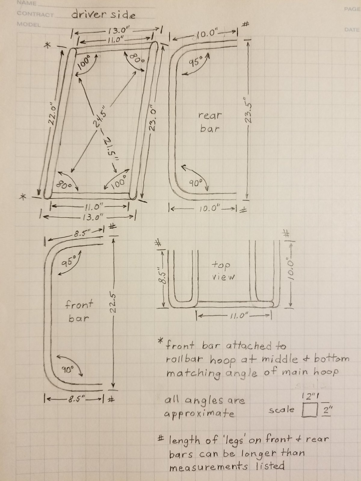

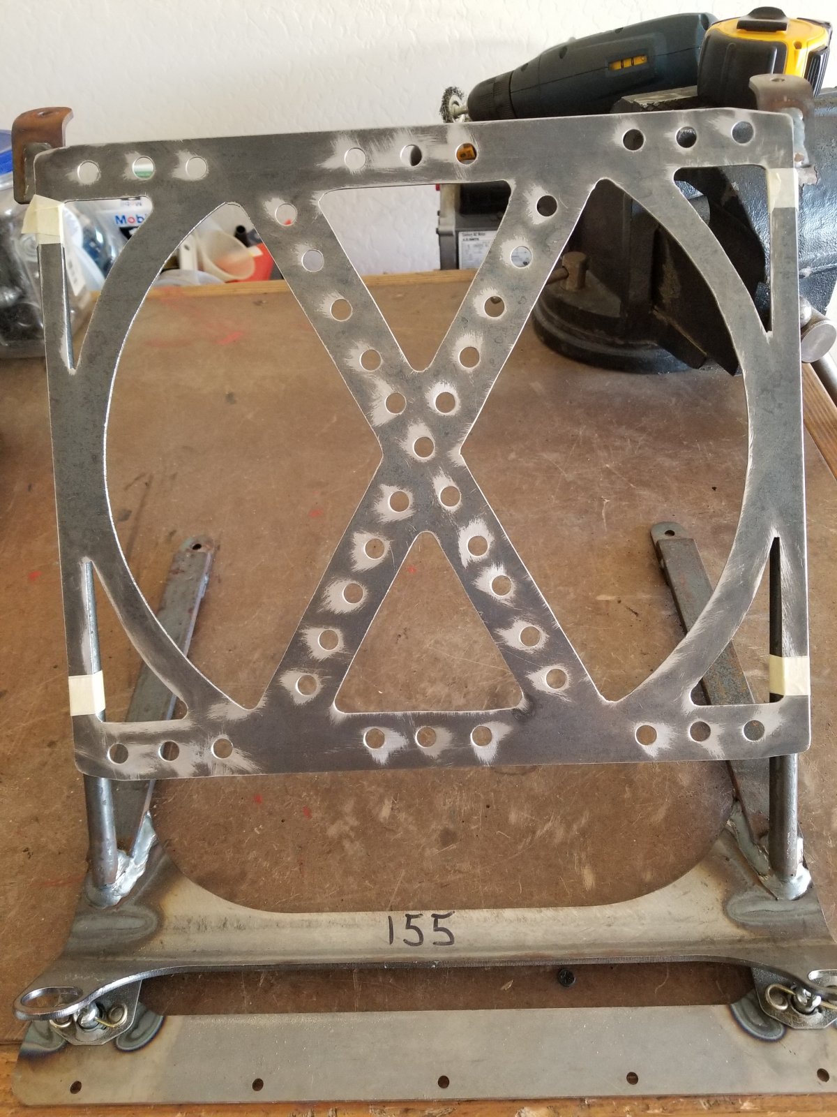

Justin,
I made the measurements on the mock up side pod I put together and put them down on paper. Hopefully the photo of my measurements is clear enough to see my chicken scratch and the 'scale' (one square is 2 inches by 2 inches). I made the drawing for 1 inch diameter tubes using a 3 inch radius on the main tubes. The drawing is for the driver's side, the passenger's side would be a mirror image, obviously. The 2 cross tubes are welded at the center of the tube bend arc, which may not be clear in my sketch. If more stiffness/support is needed additional cross bars can be added. Hopefully it makes sense.

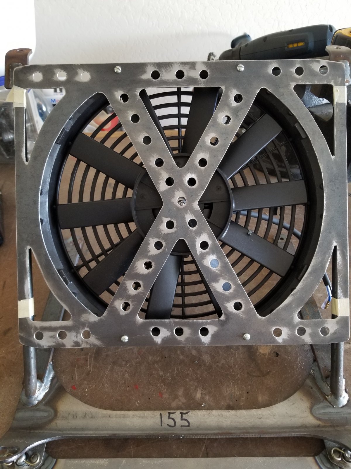

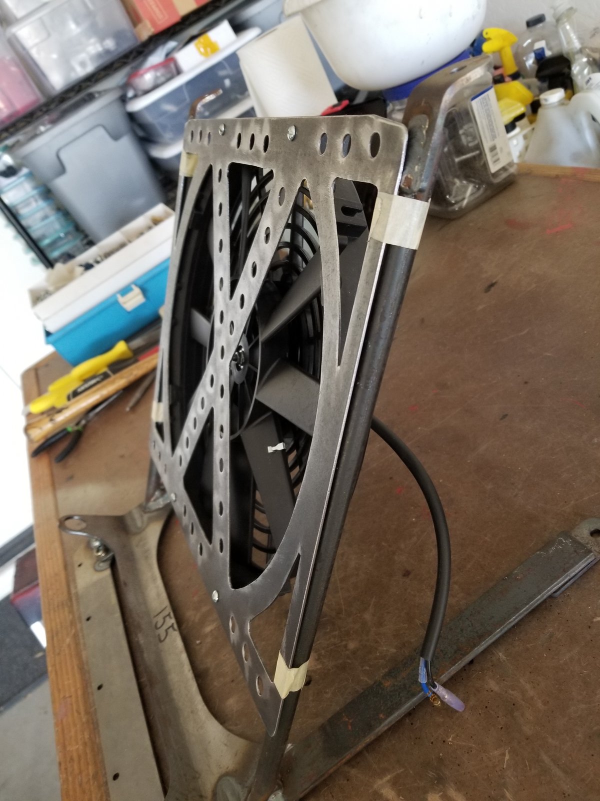

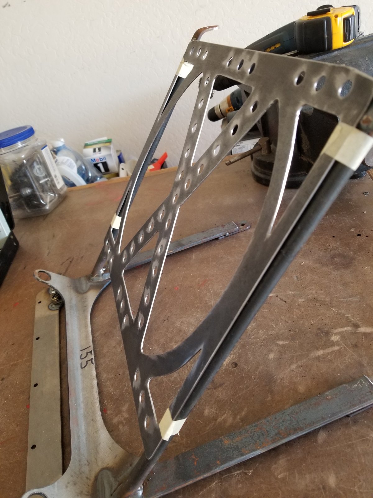

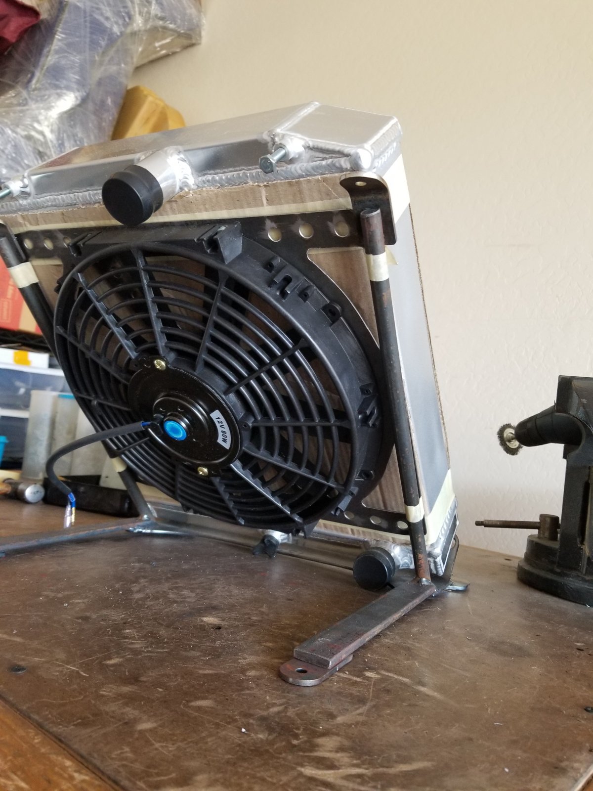

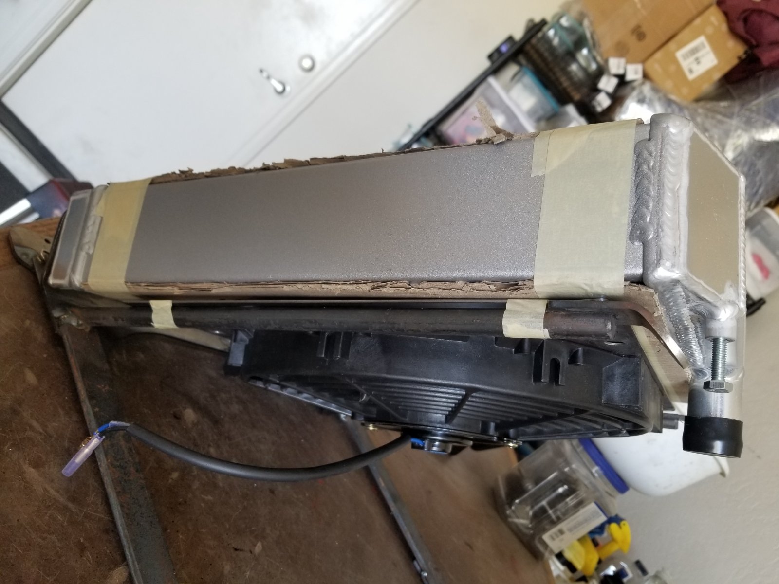

Several hours of tinkering today. Decided I didn't want my radiator fan attached directly to the radiator core. I've have radiator failures in the past using the 'through-the-core' mounting tabs, they are also plastic (something that does not hold up for long out here in the desert), and I just don't like to do the quick and easy that may fail at some inopportune time in the future.
I took a steel plate (about 0.060) and made a fan mount bracket. The bracket will be welded onto the stock front radiator brace/bracket so the fan is directly behind the radiator when it is bolted in place. The fan is 1/4 inch behind the radiator and will have a foam rubber gap filler to ensure all air is pulled through the radiator. BTW, the bracket weighs 16 oz. so it doesn't add any significant weight to the nose of the car - though that is the place you want to add weight. ;)

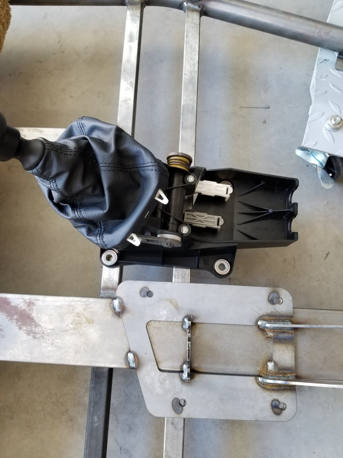

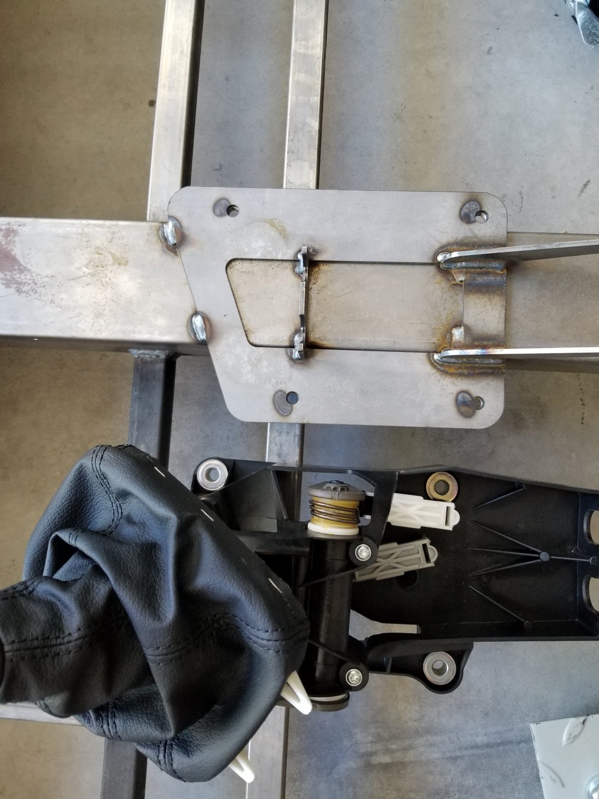

Found an issue that will only affect those with the F40 and using a new 6 speed shifter. The shifter mounting plate on top of the center tunnel has asymmetric bolt pattern to accommodate a 5 speed shifter. The 6 speed shifter has symmetric holes and it will only bolt up to 3 out the 4 holes in the shifter mounting plate. I have sent Lonny and Adam a separate message about this, but am wanting to know if anyone else with the F40 mod has seen this and what was done to correct?

Tinkles
I noticed it a while ago. I am planning on having the fab shop cut out and weld a new section onto the shifter base to gain the extra bolt hole in the proper position. I'll most likely have it done over the summer after I get the started on the assembly of my Goblin.
WorkinMan55

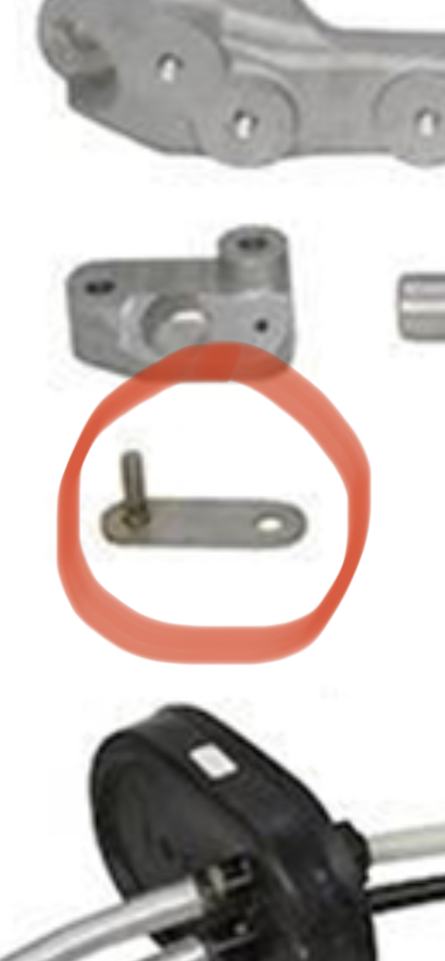

Hey desert. I have an 08 cobalt ss/tc that I have done an f40 swap in. The kit I used came from zzp. The way they addressed this problem was to bolt a small piece of steel that they welded a bolt onto. It works great in the cobalt but I can see how it wouldn’t look very good in a goblin.
