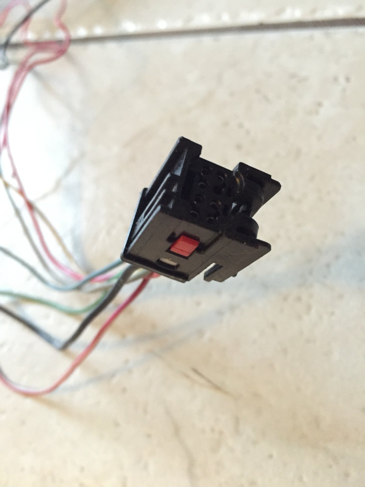

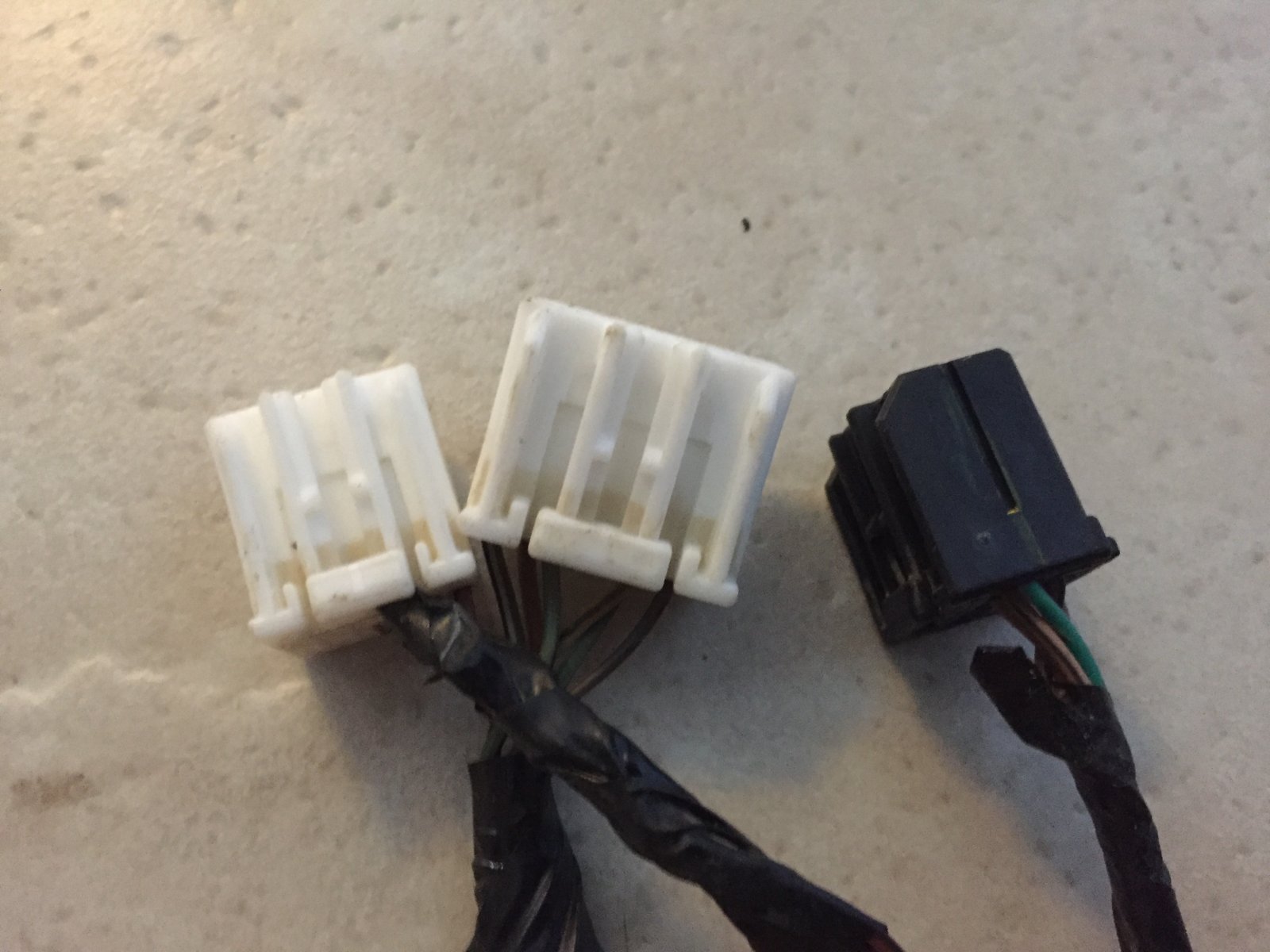

So I just completed thinning down the main and dash harness. The instructions helped a ton, but the real confusion for me was a few connectors that I did not see addressed, they were neither in the "remove" nor "keep" pictures. And I was hesitant to remove something if I didn't know exactly what it did. I was able to trace a few back to the plug using Bar-Airs drawing, but figured I would post the pictures of a few that were removed here.
These three connectors plugged into a Continental transmitter of some kind on the rear deck under all the carpet and such. Radio equipment, so removed.
More stereo equipment removed. I can't remember exactly but I think it was the last thing wired to that specific ground so I think I removed it too.
This is on the dash harness. It plugged into the Climate controls. I don't plan on adding it any time soon but I do hope to one day install AC so I'm keeping it along with the blower motor connection below

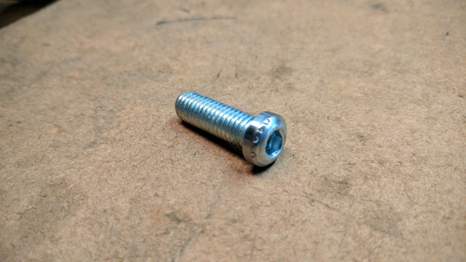

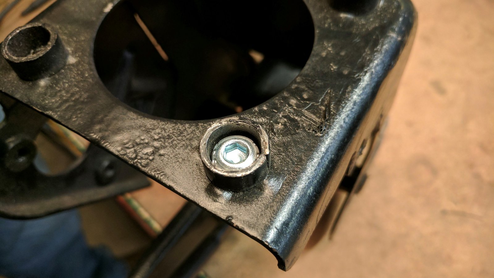

Also, I went to Home Depot and bought a M8-1.2 x 30 mm. Phillips Flat-Head Machine Screw. By doing this, I didn't need to use washers to hold the pedal assembly and I could use one of the donor 13mm nuts.
I'm sorry you had to do that. I never updated the instructions for how we do this step now. Instead of machining a washer, we machine the head of a bolt to mount the pedal box. Here's a photo of the bolt you should have:
And it should be installed without a washer from the front of the pedal box. You'll use a leftover nut from your donor on the other side.

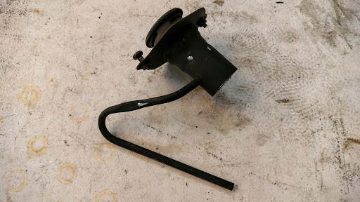

Adam said the baffle restricts the gas flow making it very slow to fill up. I guess since you already have it installed just try it out. I also thought about simply enlarging the vent hole in the baffle, that should help too.
You'll need a small piece of rubber hose to connect the nipple to the fuel neck vent tube, sorry I don't remember what size I used.
My rubber bushing bottomed out in the radiator mounting threads, so I found a little nut to take up the space.
You may be able to collapse the baffle enough to drag it out without removing it from the frame. Pull your gas cap off and use a hammer and a screwdriver. Lightly hammer the screwdriver between the baffle and filler neck in various locations around the baffle. This should collapse it enough to become loose.

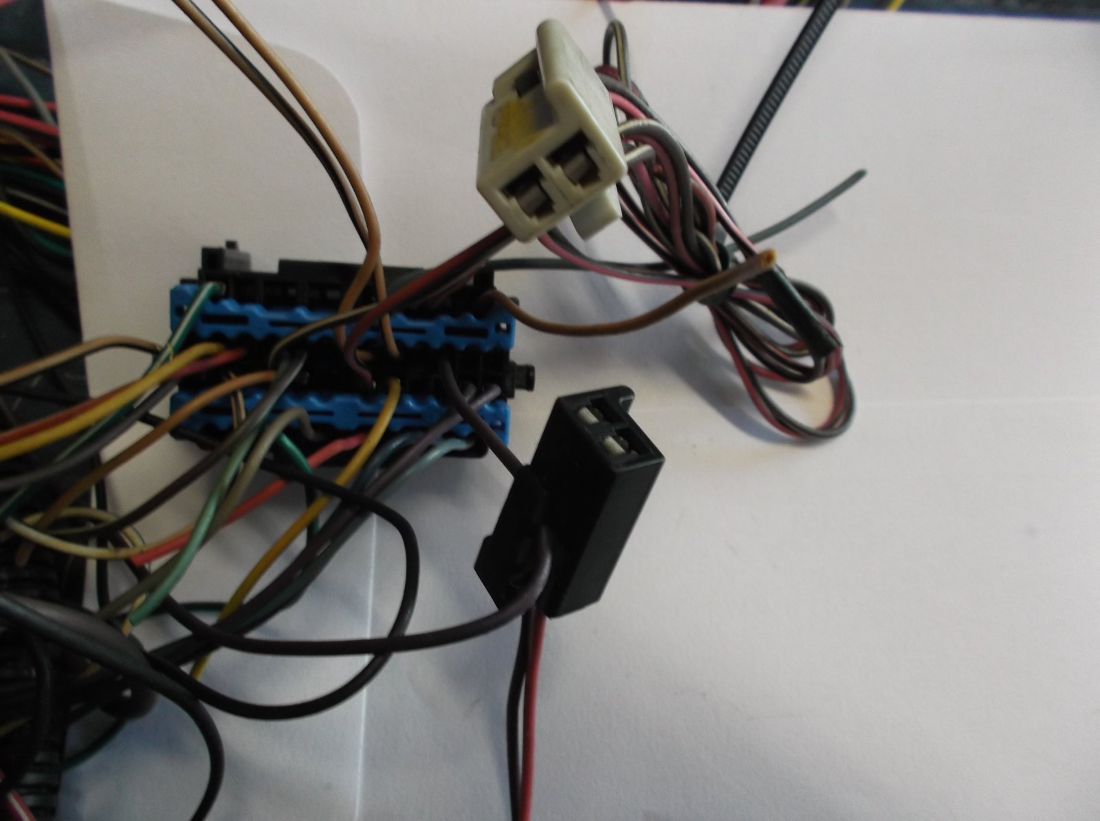

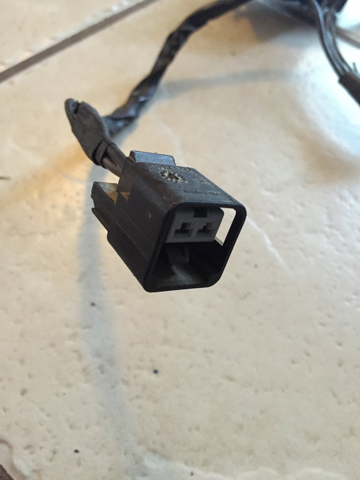

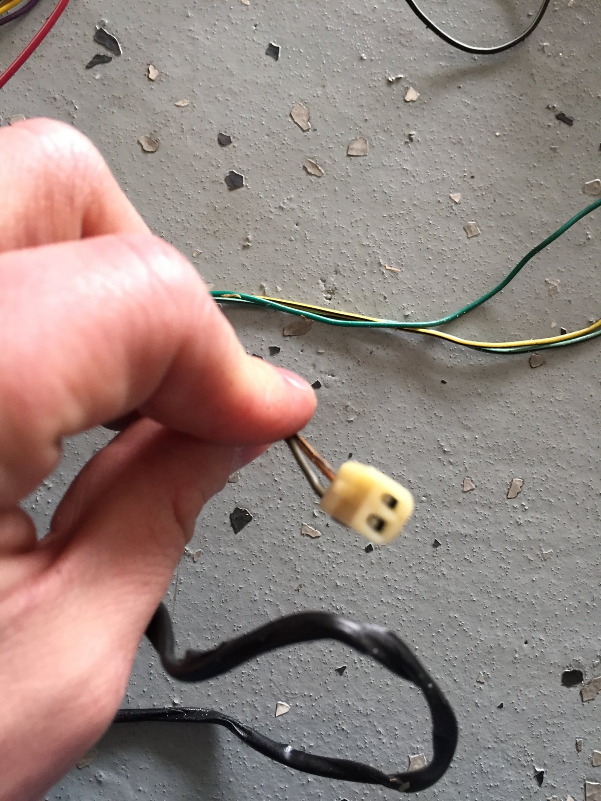

Now I'm almost done splicing the harnesses together. My labels fell off a couple of connectors. Anyone know what these 2 are for? This is the dash side of the harness. I've clipped the connectors to the wires on the harness plug. The black plug goes to a purple wire and the other wire on the plug is solid red to the BCM. The white connector is clipped to a red w/ black trace and brown w/white trace. Thanks in advance. :)

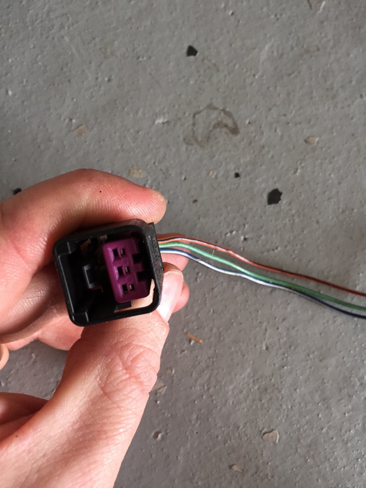

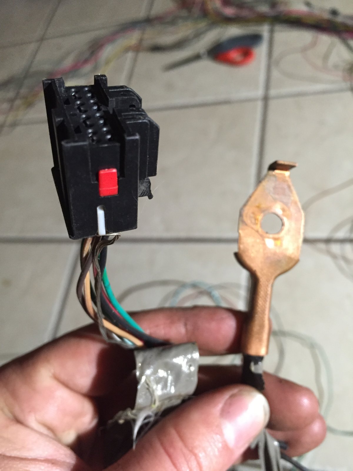

From the dash harness of an 08 LT cobalt, does anyone know if these connections are needed? I think the smaller one may just be the ambient light sensor, but I don't know what the larger purple one went to. Thanks!
