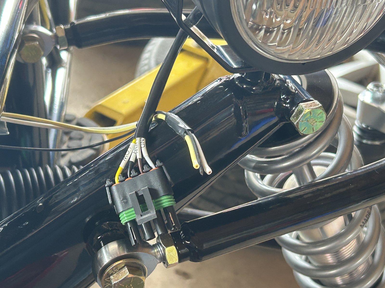

I got the DF Dominator headlights with my kit. They come with a 4-wire pigtail. However, the headlight harness has only three wires:
39941
Did I miss something in the wiring videos? I went back and checked, and it looks like Lonny's harness has only three wires, but its hard to tell.
Joebob
The wiring videos have the brown wire go to the side mirror as the parking light. Some have branched off and wired it to a parking light in the headlight as well and even turn signal wires as an option. It should not be too hard to add if you want that functionality.
