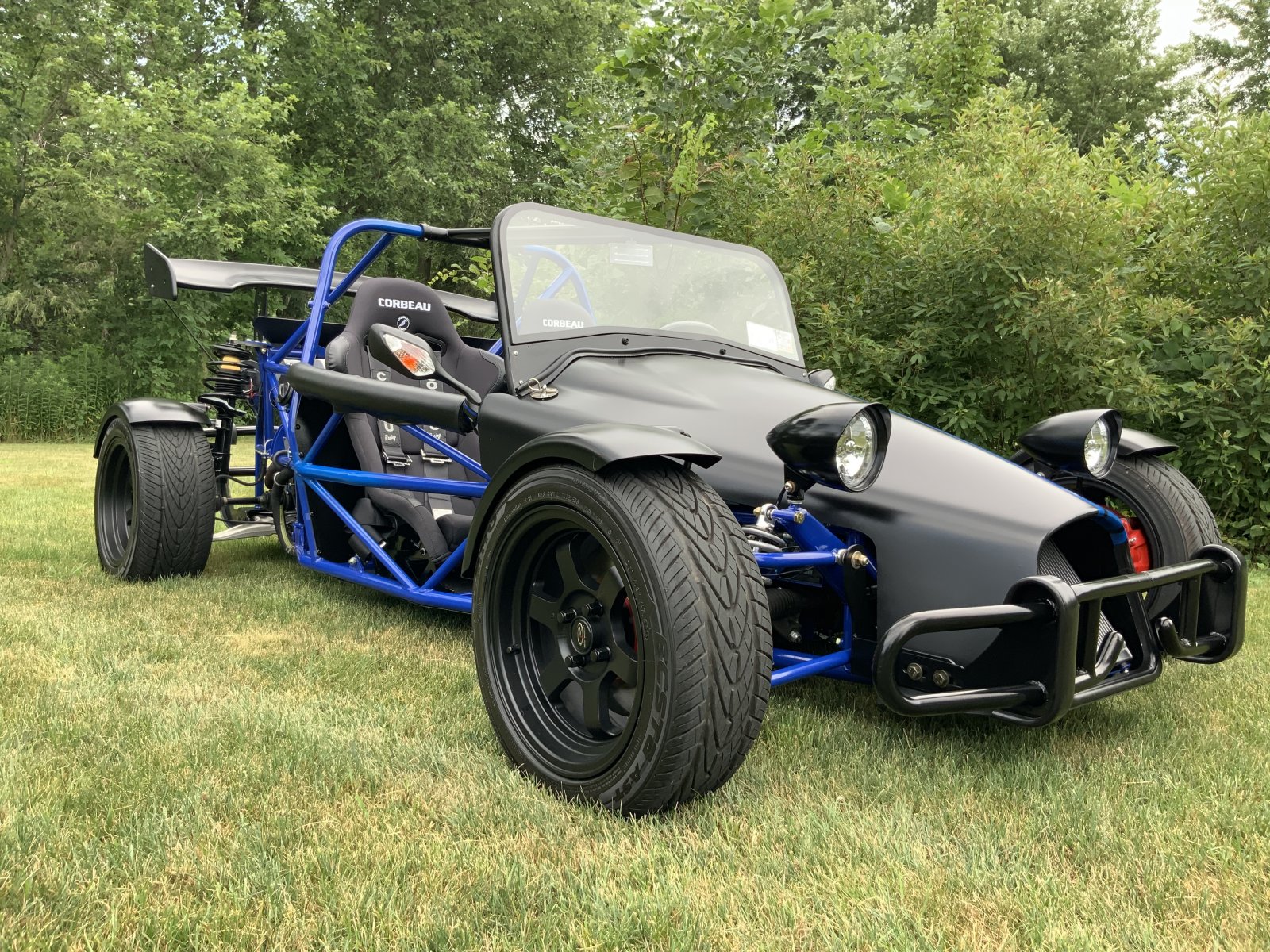

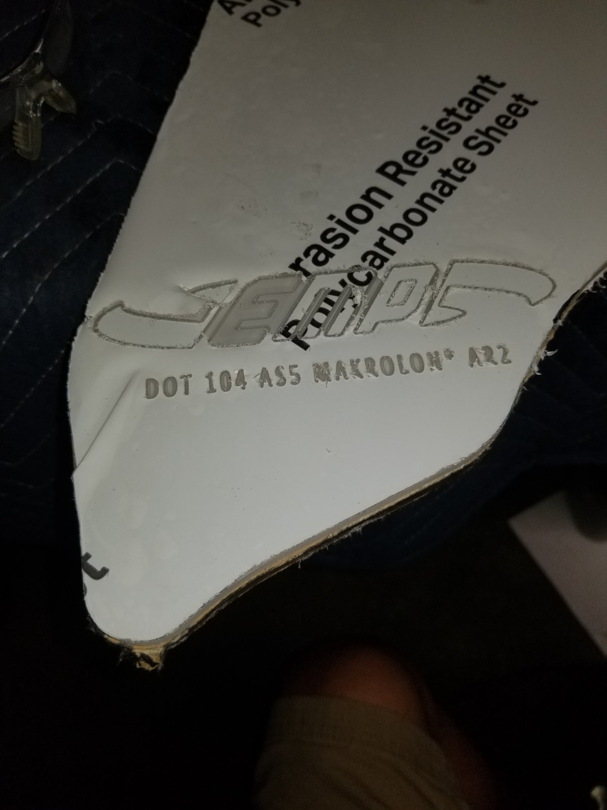

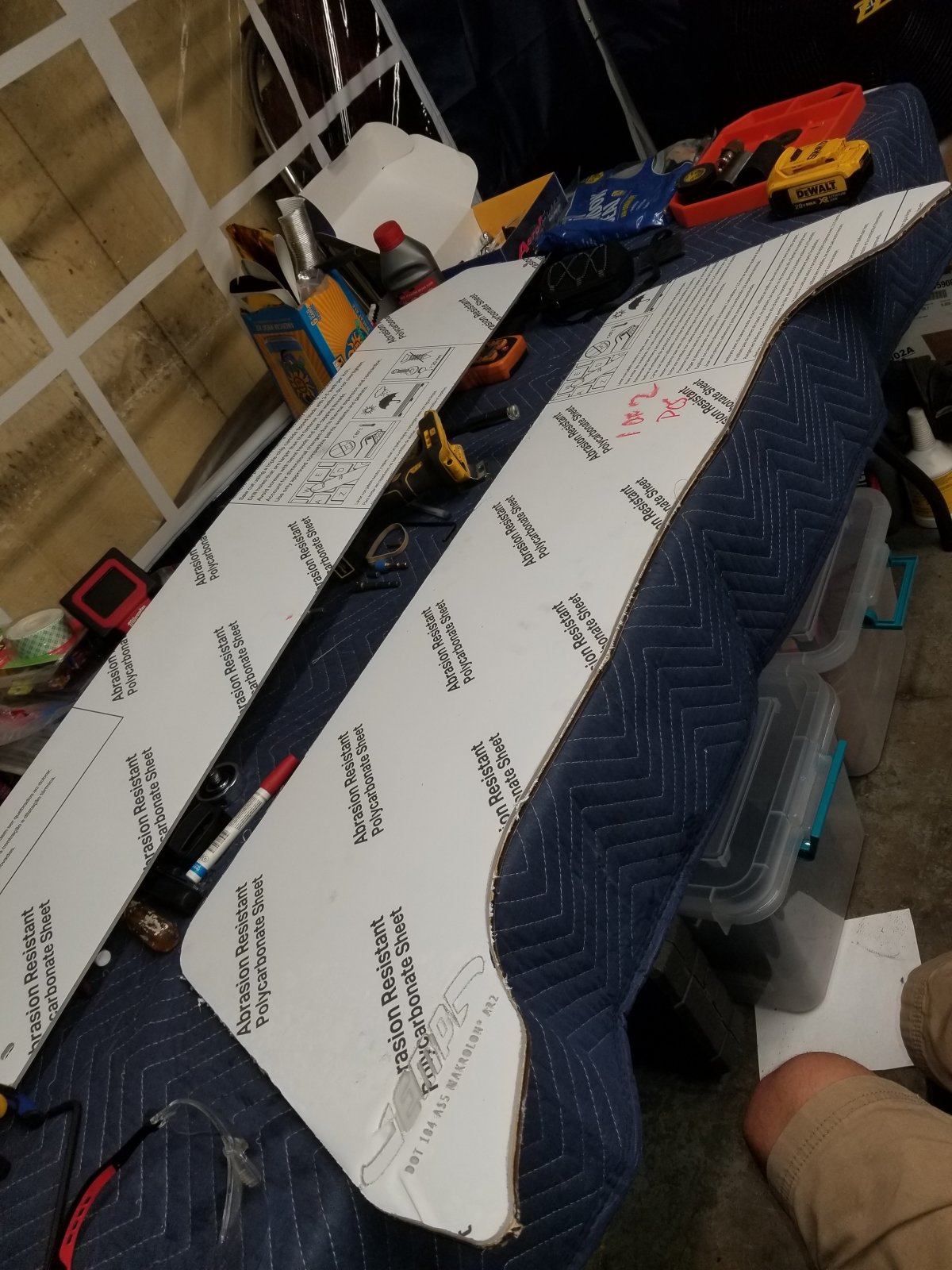

Although i havent had inspection done, I am very confident that this windscreen will do. I live in Michigan and these DOT Makrolon Hardcoated windscreens are popular. I have purchased a RZR windscreen with DOT Stamp and Recipt for Inspection and got it cut out for less than 215 Dollars all togeather. The Windscreen ran me $180 I believe. Mind you i found a seperate company to cut, than who i bought from. Should be great. The DOT stamp fits nicely inside our DF Supplied Windscreen Template.

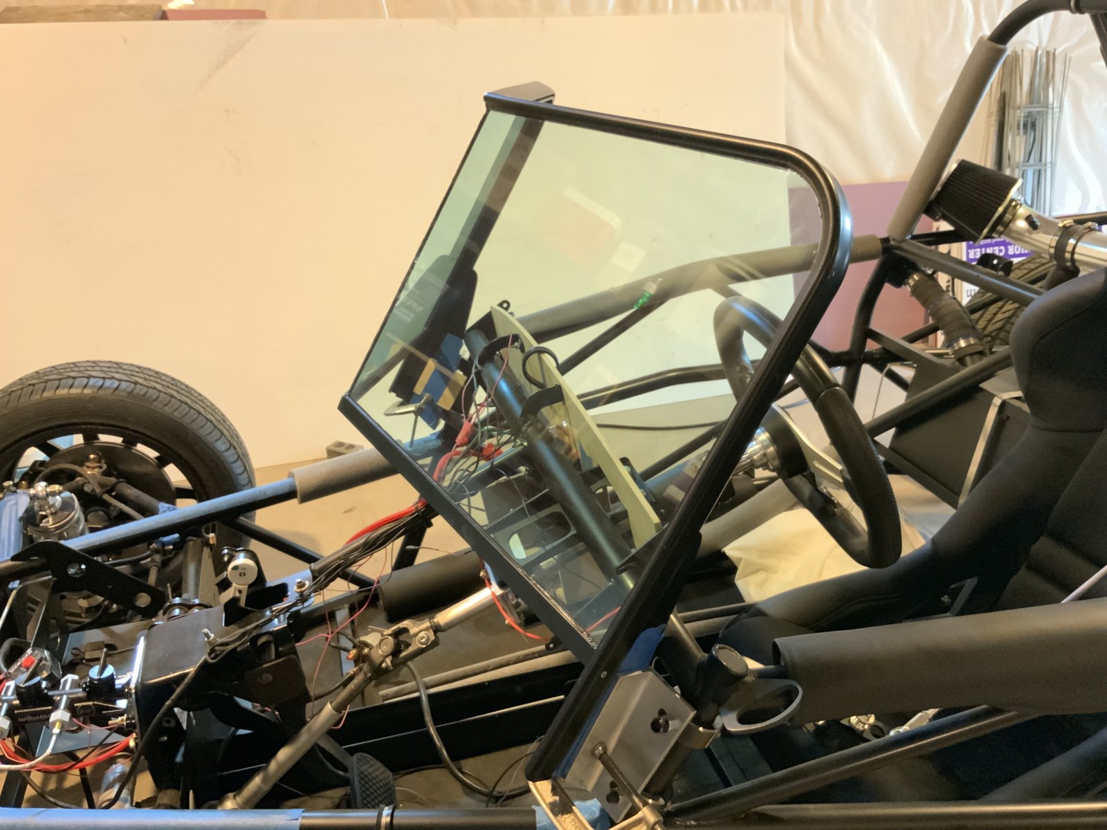

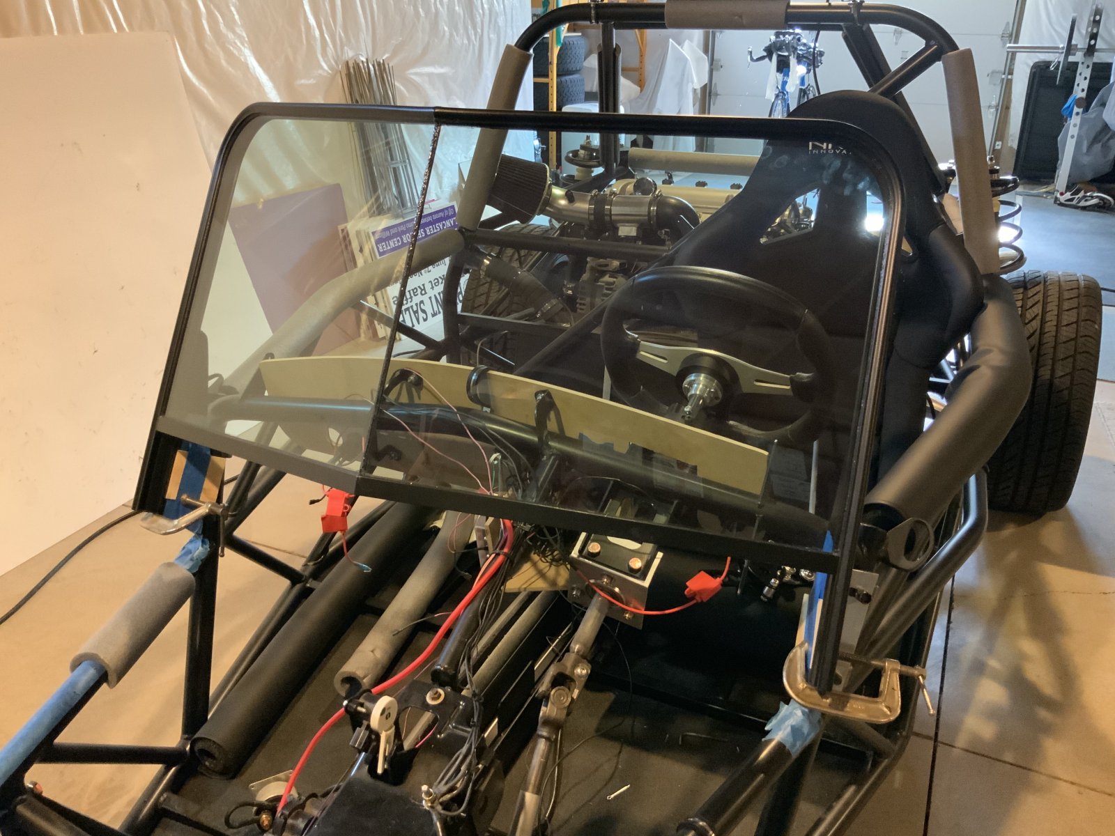

Here are a couple of laminated glass windshield we made for NYS DOT...
Full upper roll cage that is removable with the laminated glass windshield...
This is a VW Dune Buggy windshield frame that we modified to fit the Goblin....
THX,
Bruce
4
