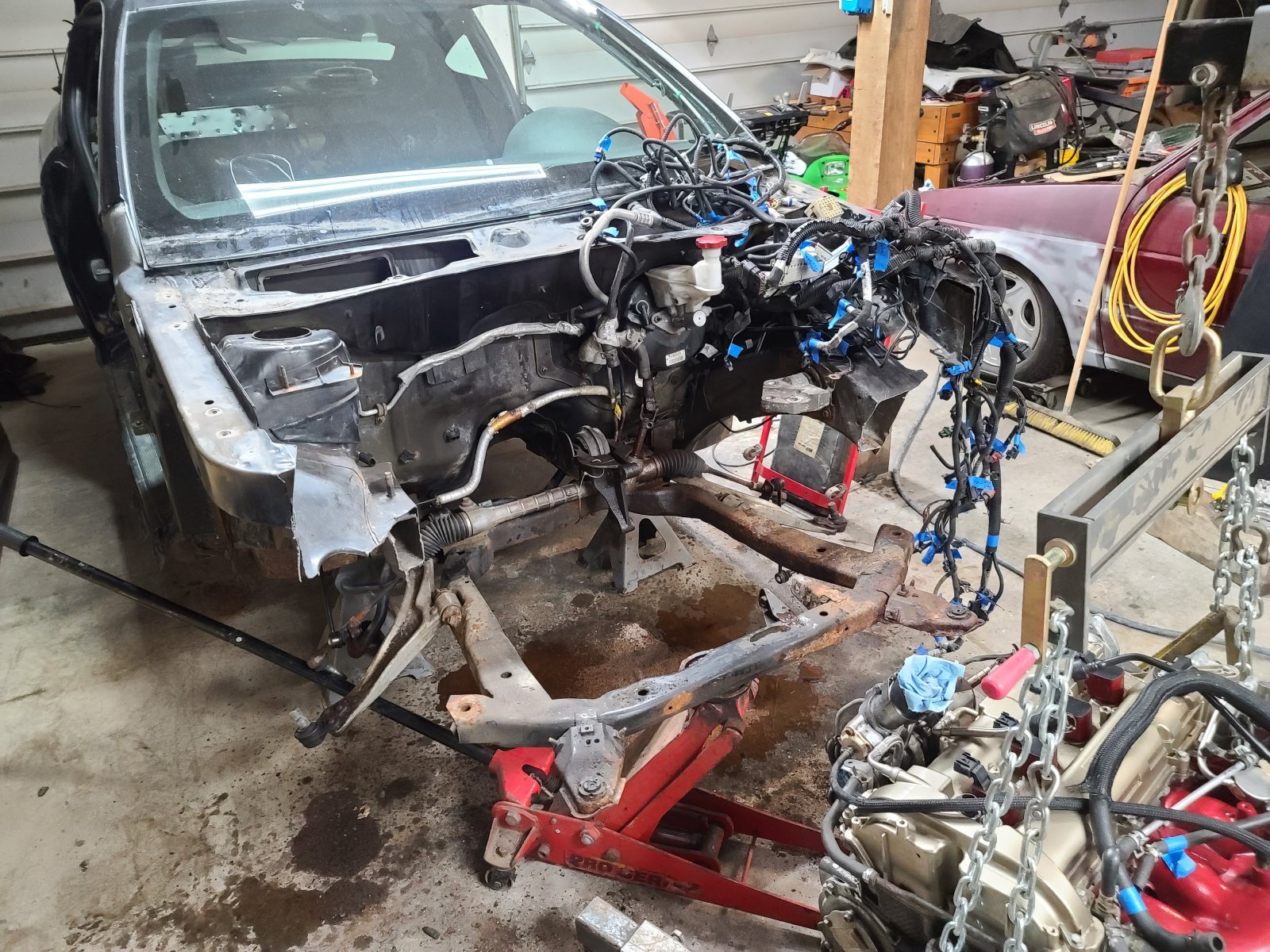

You could use the hoist to support the assembly, then lift the car. It’s just lifting it up and out like it’s an old small block, is not necessary. The assembly technically goes down not up.
R
Think of it like this, it’s easier to drop the frame over the engine while it’s on a moving dolly vs trying to engine house it into the frame (it can’t be done because of the roll bars and support bar) on the goblin frame that it

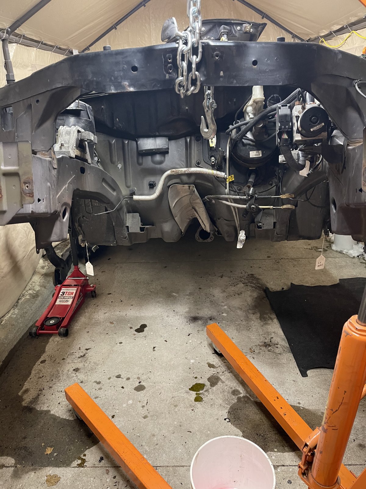

Rear sbframe bolts just spun so I hacked rad support and horns and pulled out front

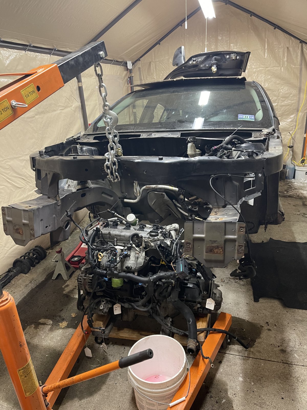

Here was my solo engine yank.
