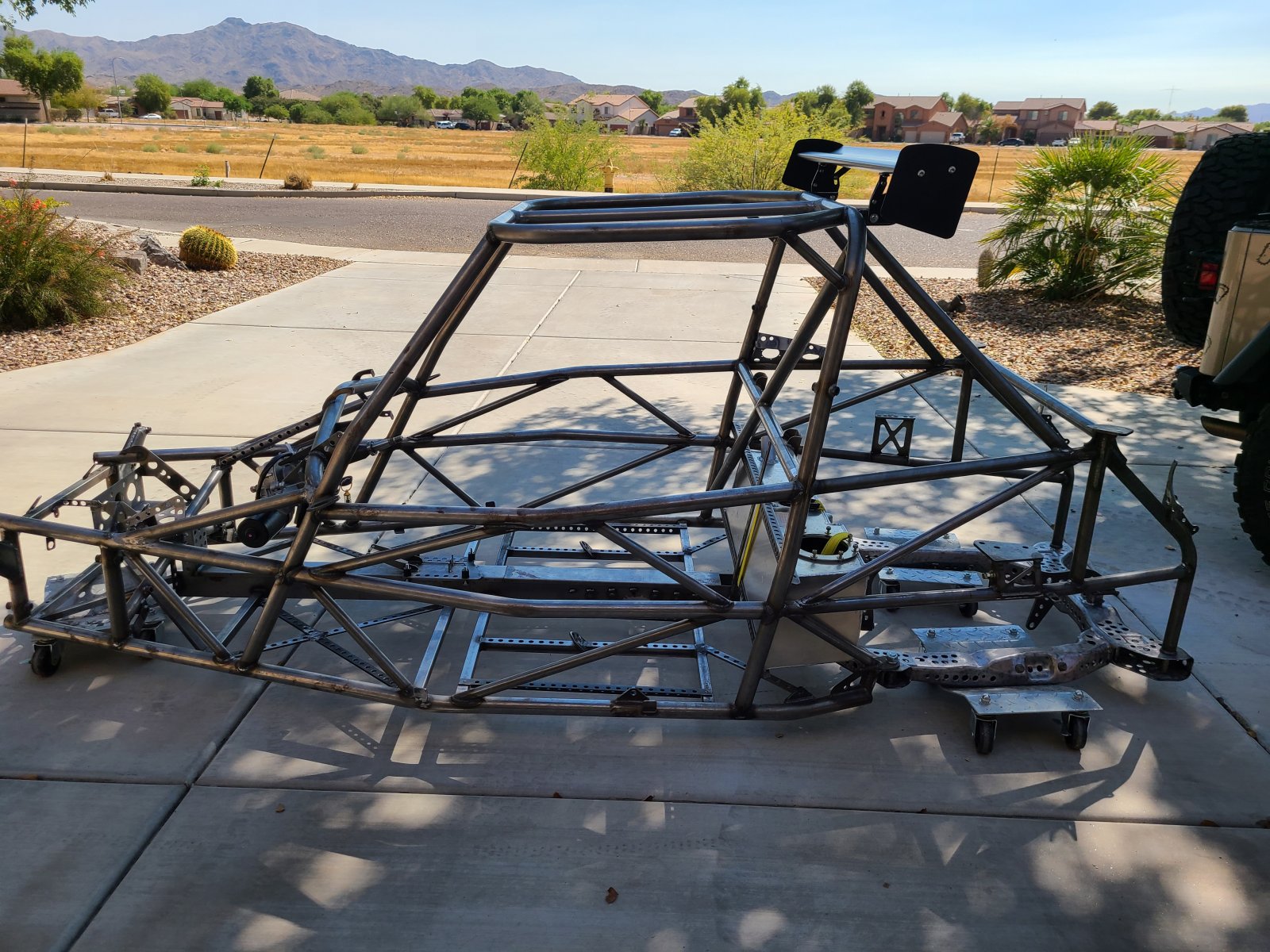

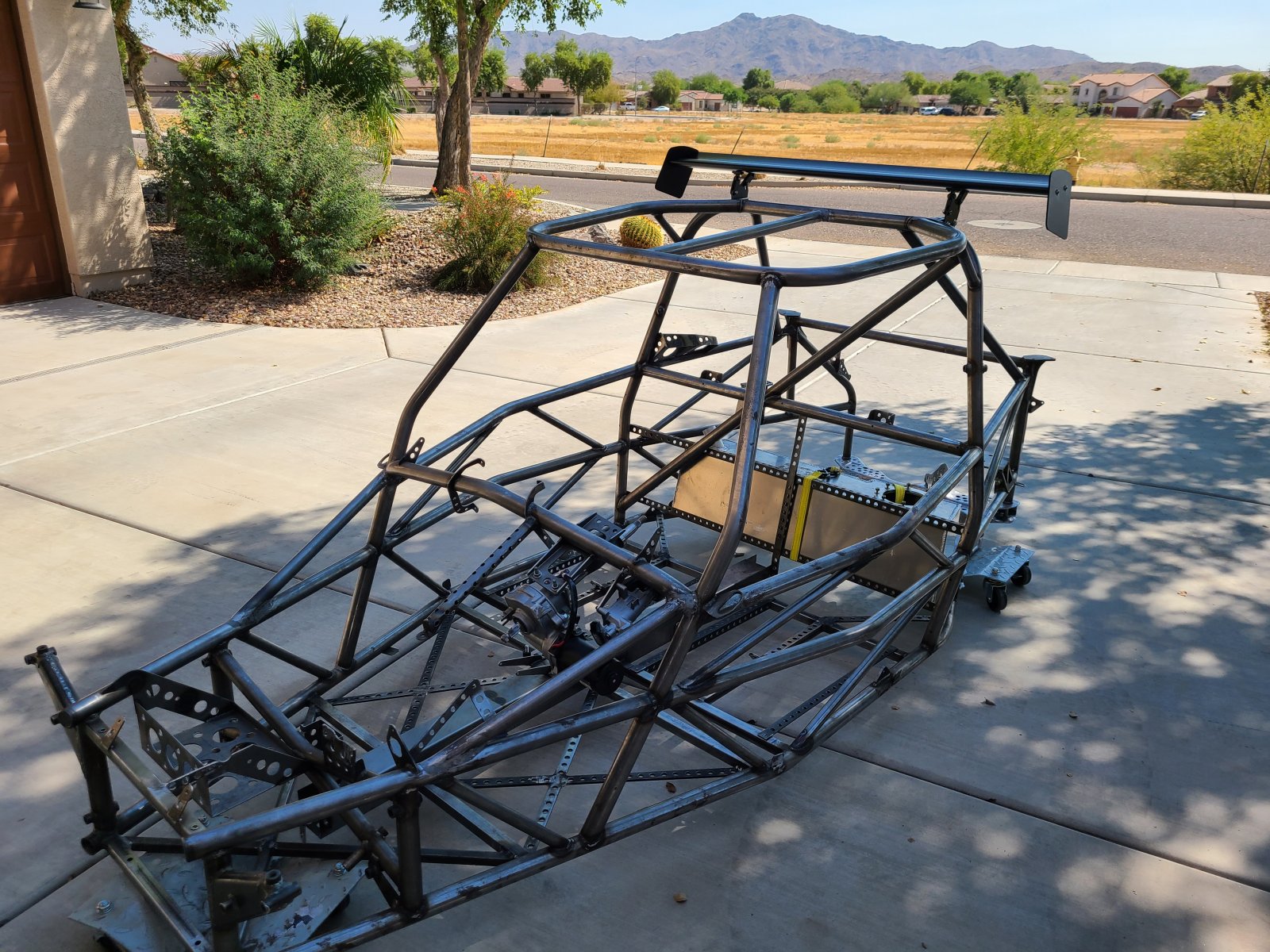

Seems like a business opportunity for someone capable of creating a carbon mold and baking some prepreg into high quality parts. Demand is obviously higher than supply....
Im with you! Lonny said it doesnt do a **** thing back there as there is no clean air for it so why pay $700+ for a name brand trinket that doesnt do anything more than look cool.
Put that Wang up here in the clean air and even a cheapie eBay $90 one is more effective than a $400 carbon fiber one sitting at the back in all that dirty air. And it is not pushing down behind the rear wheel centerline making the front end lighter.
