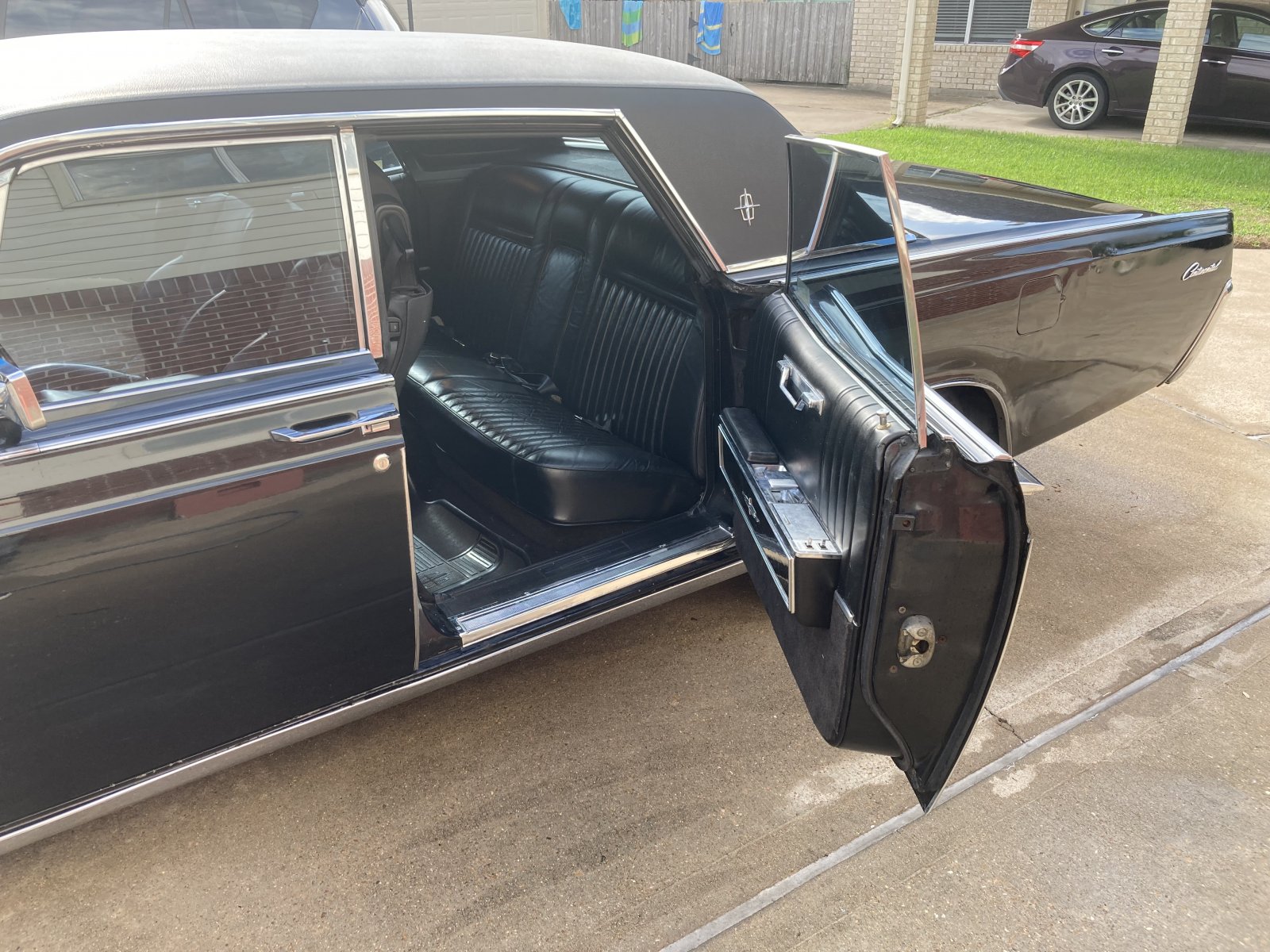

I bought my car already completed and honestly i really wanted the full cage, not the easy access. The look to me on the full cage look great compared to the easy access. HOWEVER!! After owning it i can see how much nicer it is to get in and out of the car. So i was thinking... why not have a door of sorts to fill the gap. I was thinking it could be a suicide door such as a Can Am X3. I think it could be done pretty easy with tubing and a welder. Might give it a try.
