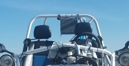

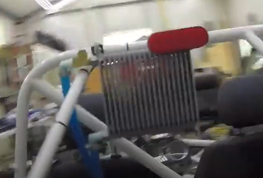

Move the intercooler where is can get some more air.
I did fabricate some new mounts (3 metal straps, 1"x4" and 3 hose clamps),
and I put a low profile filler spot at the top, which consisted of a street T and a plug. About $20, to relocate the DF radiator.
Clear blue fluid lines are optional.
