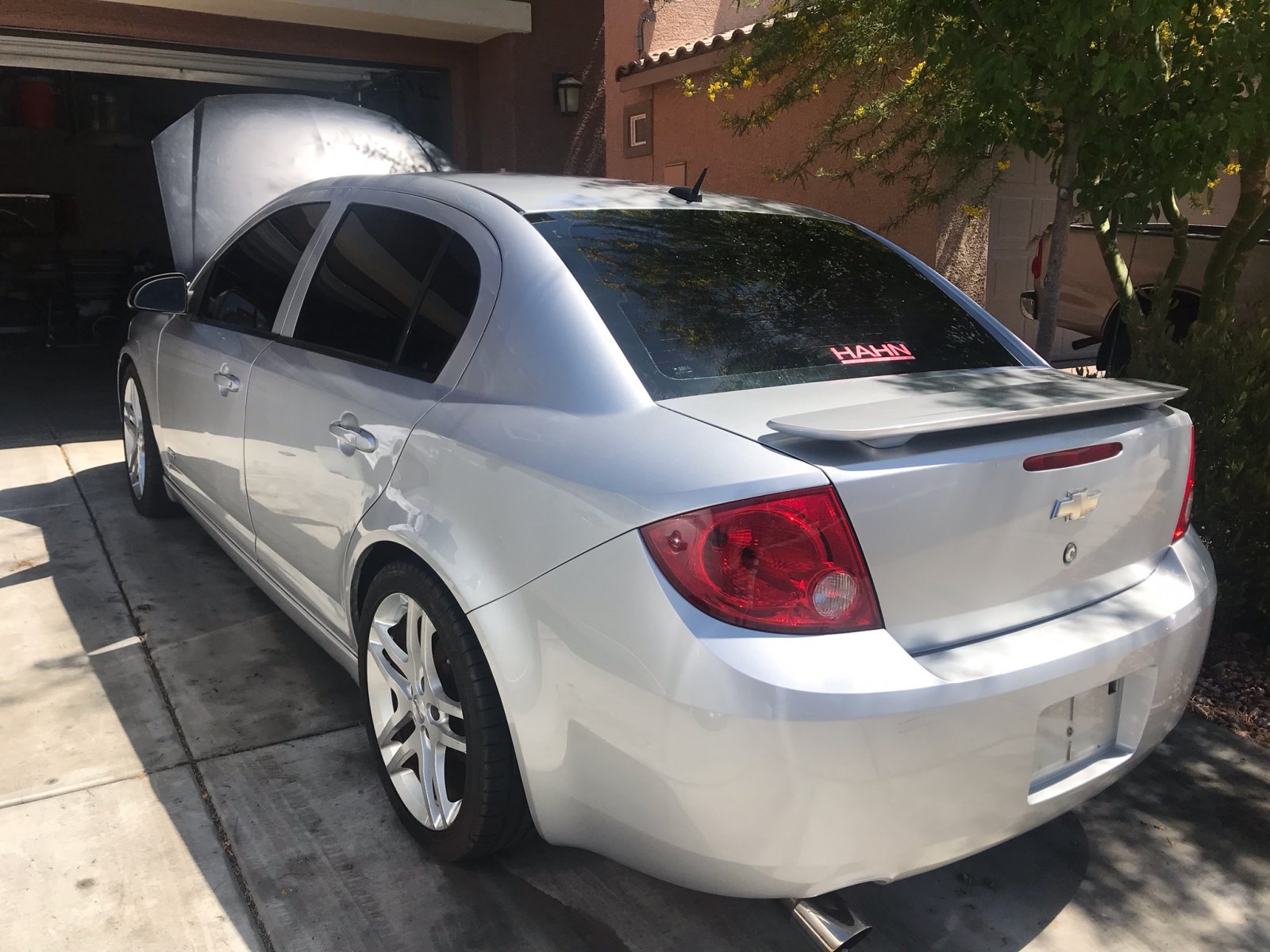

Hello to everyone, I am very excited to become part of the DF Goblin community. I just bought my kit, vin #161, and it should be here in 5 or 6 weeks. I have also found my donor car, a 2009 cobalt ss turbo, manual trans, but I learned after purchasing the car that a few things were disassembled under the hood. So here's the good and bad of it all:

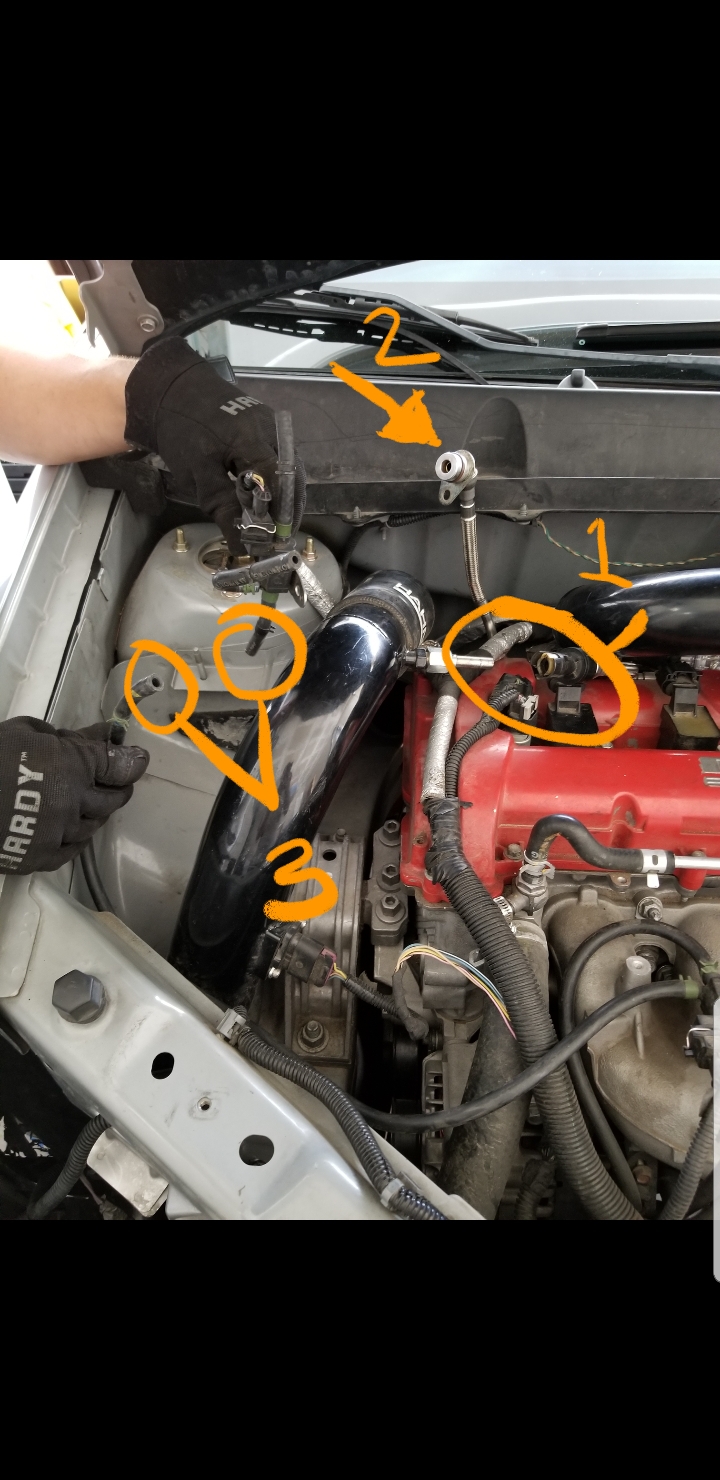

#1 won't stay plugged in.
#2 used to plug into the old turbo can I plug the hole?
#3 are the vacuum lines and sensor that attached to the wastegate and possibly thr old turbo and not sure of the configuration.
Would a website like alldatadiy.com still be a good resource to figure out where all this stuff goes?
Thanks so much for the help, I feel like I'm so close!

Wow, A lot to take in with that post. First congrats on the purchase and the club. Fun little builds.
#1 goes to your turbo. Basically where the circle is here:

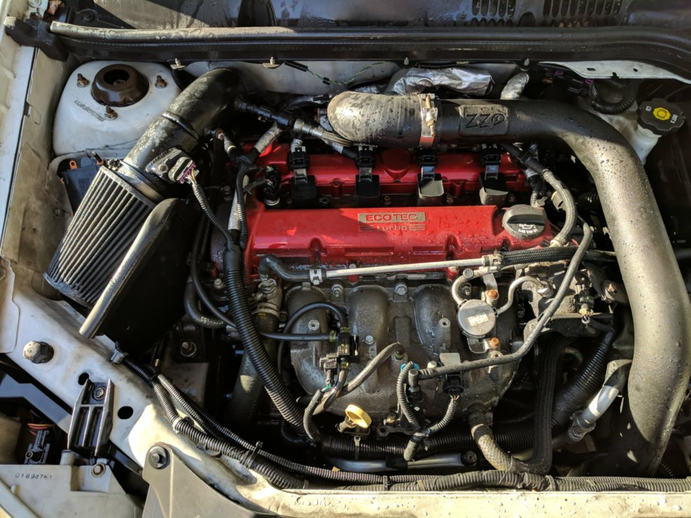

A picture of my old bay that may help...
8984

Thanks for the help! Yes, I think I may have gotten carried away. I think I just hoped someone could help me with where to plug those hoses into with reference to #3, where I could find the missing turbo plumbing, and if I really could just remove #2 and plug the hole. Now that I think about it, I could probably call ZZperformance and order the full kit but since I'm putting it into the goblin, I didnt want to spend a ton on tubing that I would get rid of and hoped I could just buy some rubber hoses to get it Dyno'd.
Also, a good dyno referral in las vegas would be super.

Since I'm sure everyone will be interested, I will add more pictures of the car and our journey. Is there a better place to do that, I don't want to post in the wrong forum. Maybe I should add a new thread of "the journey" and link it in here?
