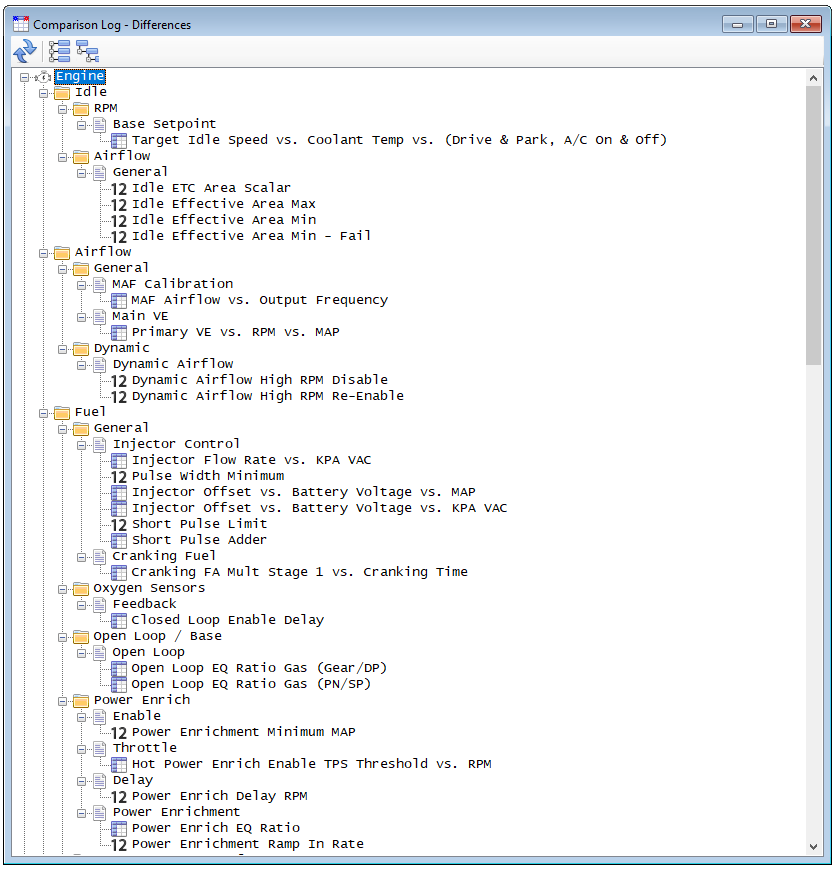

Here is a list of items that are not stock. Keep in mind, this is using the OEM stock file I have and your stock settings may have been different. This may contribute to more items not being the same that actually aren't causing an issue.
24459
24460
24461

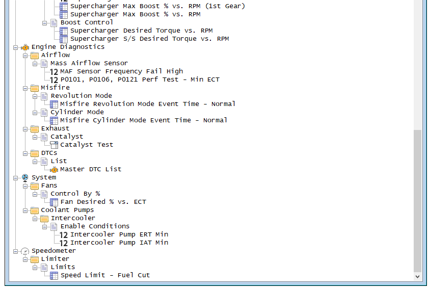

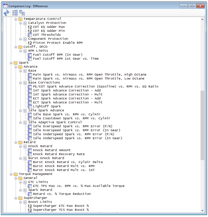

I'm not going to comment on every change, but I leave a few comments on a couple of highlights. Maybe we can work on a good base tune for you to try to get the car going again and then tune from there.
  1. The Idle Airflow has been tweaked a lot. This must be in an effort to fix the idle problem. I never touched any of these settings.
  2. The MAF Calibration is different obviously and it will be. It's not terribly off.
  3. The VE table has most of the values much lower than I would have expected. A good data logging and tuning will only tell you if it's way out of whack.
  4. As you mentioned, Dynamic Airflow is disabled.
  5. Injector flow rates seem reasonable for the 60lbs injectors. Along with the pulse corrections and min limits.
  6. Piston protection has been disabled. Not sure why they do that.
  7. Power enrichment has been increased in many areas. Typical of tuning, nothing wrong with adding a little extra fuel during long hard pulls so as not to burn pistons.
  8. RRM redlines are maxed out. Best to get the car running correctly before hitting the 'ol rev limiter!
  9. The entire spark tab has been adjusted. Some may be trying to correct idle issues.
  10. Without fail, ZZP loves to disable the Spark Retard in Torque Management, this makes the throttle undriveable in a Goblin. They just zero it out. Great for throttle response, but horrible trying to control the touchy throttle.
  11. And a couple of the boost limiters have been modified, not the worst thing in the world, I disable most of the boost limiters on ours.
  12. Many of the DTC (check engine) codes have been disabled. I guess if you can't fix them, disable them.
  13. The intercooler pump has been changed to turn on all the time. I like this, I have mine set that way. Easy to check if it's working when you start the car.
  14. Last, but not least, the speed limit has been raised.

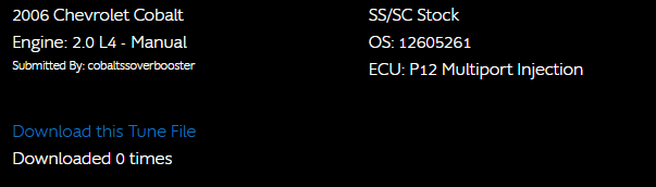

I found a stock '06 SC tune in HP Tuners repository. Is there risk (and if so how much), in starting over? Try putting that in and see if it will run?
Thank you @ctuinstra for taking a look!
Post that file. I want to see if it's the same as the one that I have. I think it would be a good idea to start with that but you will need a few changes to work well with the larger injectors. I will have to see if I can use some of the settings (before my BRFS) and modify the stock tune for a good baseline. For the best results, proper tuning will make it run the best.

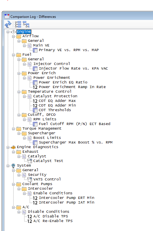

Here is a file to try. This is basically stock with a few changes for the 60 lbs injectors. A summary of the changes from stock.
  1. Used stock VE table but smoothed it out a bit. Most of the values are very close to stock.
  2. Increased the injector flow rate +10 from stock. The curve is the same, but maxes out at 62.2.
  3. Ramped the Power Enrichment and increased the ramp rate. This adds a bit of safety.
  4. Turned off the COT adder (catalyst adder since you don't or won't have a cat).
  5. Put the RPM cutoff back to 6500 for P/N.
  6. Corrected Max Boost % from 200% to 100% (limits of the adjustments?).
  7. Turned off the Catalyst Test, again since you won't have one most likely.
  8. Kept VATS turned off (stock was turned on and I didn't want to turn it back on if you needed it off).
  9. Enabled the intercooler pump to start immediately and not wait.
  10. Disabled the A/C (if you are going to drive the donor and want the A/C, you will want to turn this back on).
  11. Re-enabled ALL DTCs. You may very well get codes now that you didn't get before. This could be a very good thing. Instead of hiding some of the issues, let's see the codes and work on them. This can be changed again later.
I offer no guarantees that this will fix your issues and make your car run great. This is simply to get to back the basics and remove all of the "tweaks" to see if we can get the car to run again. If it does run, please do NOT go racing around without further tuning. Also, all of the timing has be reset back to stock, it was advanced for power gains, but it's best to put it back to stock and then work on the timing later as it's running well again.
I hope this helps. If not, you may have other issues going on that need to be addressed.
