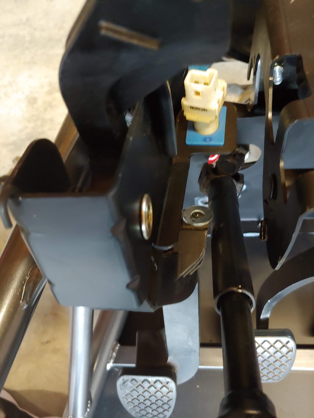

During my short initial trip through the neighborhood, I noticed the steering shaft u-joint hits the clutch pedal when it’s fully pressed. Is this normal and if so is it a live with it issue or is there an easy fix?
Most will hit the front bulkhead (formerly known as firewall), so you just trim a little bit of it.
is that shaft locked up or did it move freely? If it’s bound up it may be putting pressures where they shouldn’t be and it could hit the pedal. Plus you can loosen the pedal and try to move it over a tad, and do the same with the steering column. We are only talking fractions of an inch, but it may be just enough wiggle room for it to clear. After that you could possibly trim the pedal, but that would be last resort.
Brett
I had this issue and just pulled on the clutch pedal a little bit to bend the bracket and create some clearance from the shaft.
escapepilot
It barely cleared the bulkhead and I replaced the collapsible shaft with a new one. I'll try a combination of your suggestions and Brett's before trimming.
baustin
My build had the same interference with the steering shaft and clutch. I don't like angled pedals so I trimmed the plastic on the clutch pedal that hit the steering shaft. Once it was trimmed enough to clear, my pedal is straight. I then JB Welded a thick steel washer onto the clutch to still get good contact on the electrical switch at the bottom of the throw.
