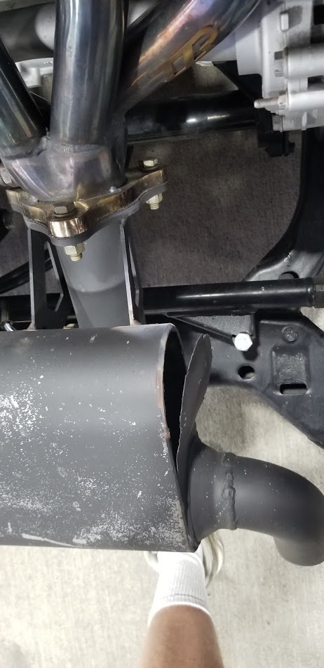

I'm trying to pin down a noise that sounds exactly like a loose heat shield on the exhaust. It happens around 2100 RPM give or take and sounds exactly like a loose exhaust. I've checked everything and it all seems to be tight. I'm wondering if the baffles in side are becoming loose. Has anyone else had an issue like this?
Jermey opened up the passenger side of his DF muffler at this year's midwest spring meet up.

someone else had the same problem and drilled through their muffler and riveted it to stop the baffle from rattling, cant remember who though.
I wonder how he found exactly where it is at and where to drill the holes to rivet. This sounds like something I may have to do.
Can you find spot weld marks on the outer muffler can? I will have to look closely at mine, but that would be my marker for a rivet.
