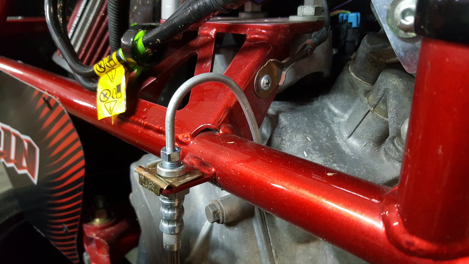

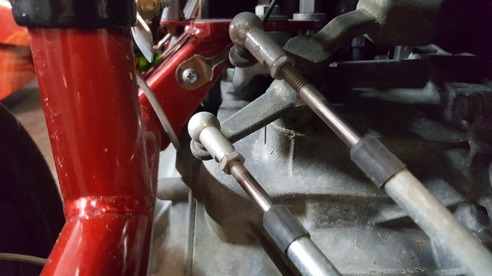

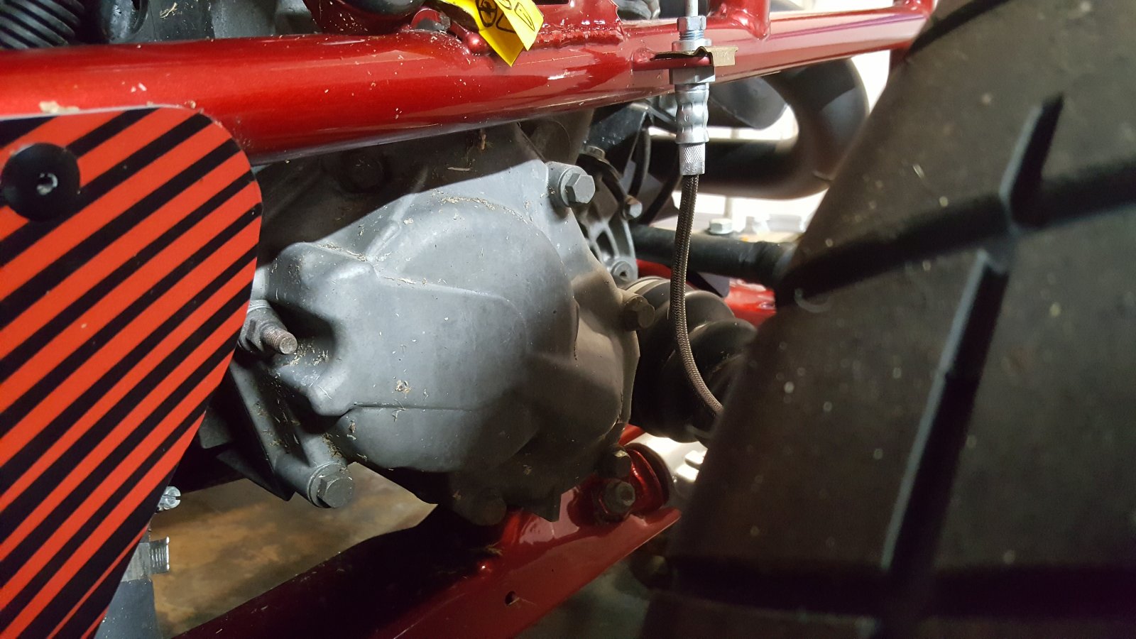

I don't believe the F40 it's a direct bolt in to the Goblin. You may need to do some cutting and welding. The transmission is very close to the frame and mounts.
Here are a few images that might help. It would be nice to have the two different transmission setting side by side for comparison.
